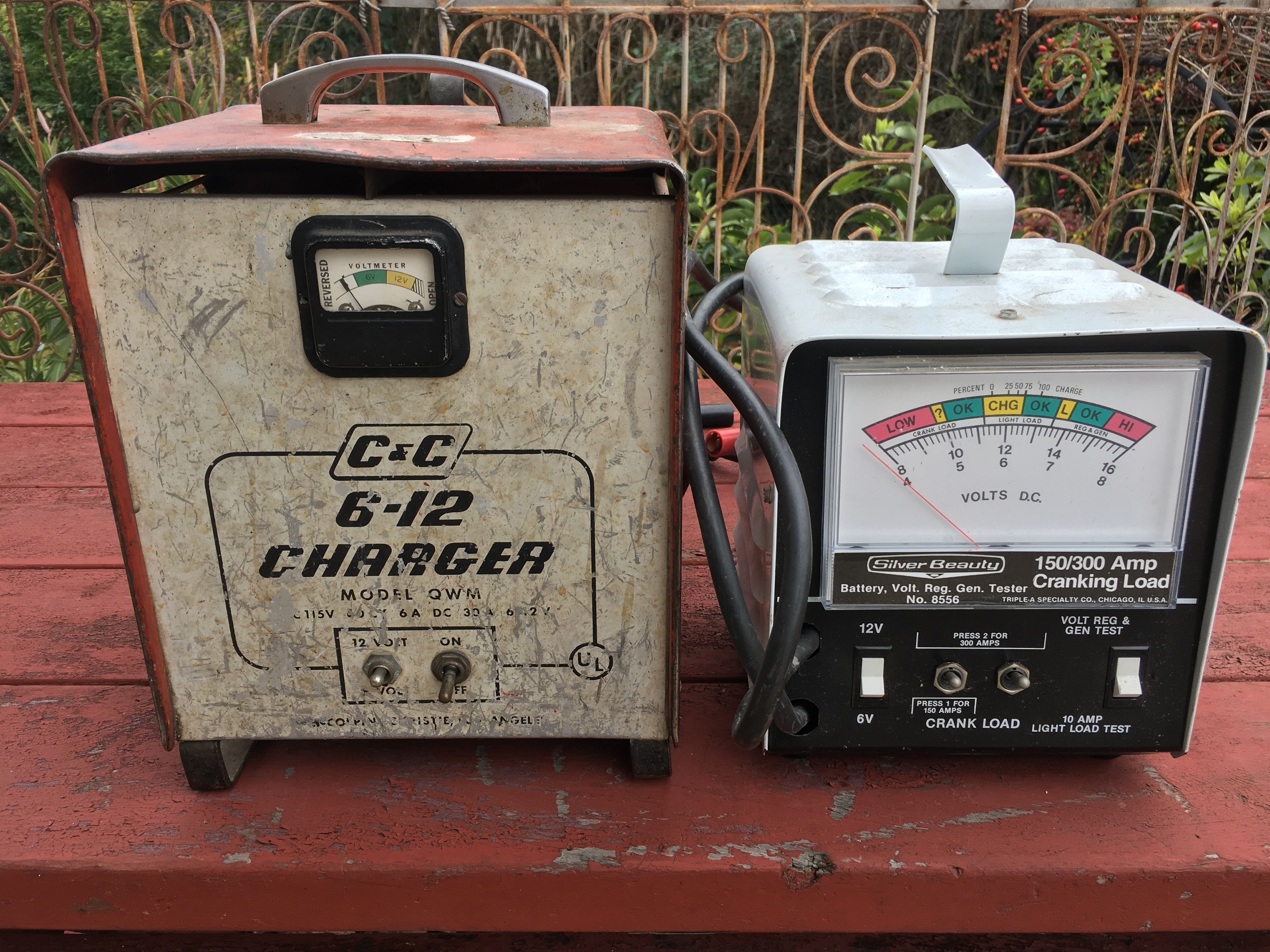

I've got one similar to this ...you just can't kill it..
I would look through FB marketplace or eBay before buying one of fancy worthless new chargers ...
With the sophisticated charging profiles the newer maintainers have I wouldn't exactly call them worthless.
Then again, I do have a couple of old style chargers that do come in handy a couple of times per year.
/ battery charger #37
Yeah I didn't figure you all would like that statement much ..but I said what I said ..
Done had my experience with them with helping family trying to charge different batteries in equipment ...
I'll keep ole faithful ..
I have and use both the simple transformer type and some new-fangled ones, depending on what needs done.
/ battery charger #39
There is definitely a place in my shop for an old style charger, particularly the ones that have the ability to do an occasional equalization charge.
