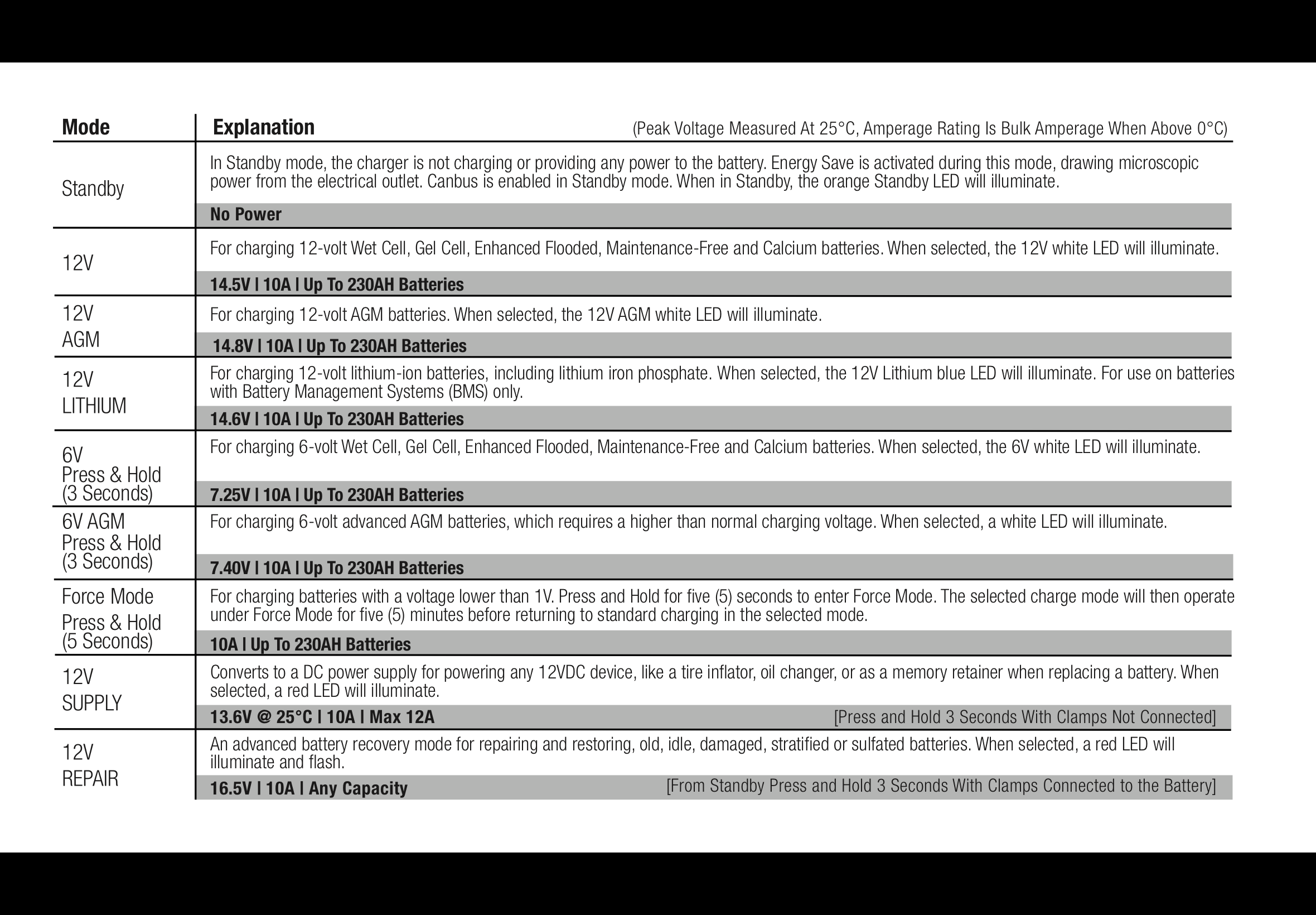

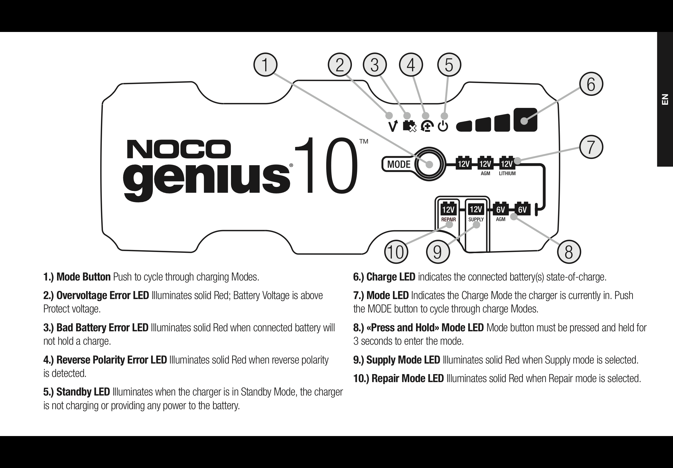

About desulfating:
The bigger Noco, Pulsetech Xtreme, BatteryMinder are excellent if given enough time. Problem is you gotta measure that with a calendar.
I pair Ctek with a homebrew small desulfator (kick back) and it works the same as the others. You need a calendar. Some batteries it isn’t a problem because they are parked a lot.
Why the whole jazz? Because I get at least double or triple the battery life than without it. Otherwise I go broke buying batteries every 2-3 years for ever machine or toy. Piles up fast!
I very rarely need a charger, but maintainers are a must for me.
Similarly, I don't expect desulfation to work overnight, but over years and decades it sure does.
I don't know the exact number at this point, but with some 100 batteries in vehicles, tractors, and trailers, like you I have had to learn what works and what doesn't.

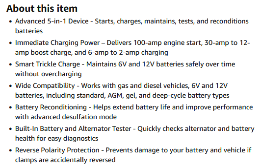

What are anyone's thoughts on this charger (I want the jump starter option)
Amazon.com
/ battery charger #103
Decades ago, Shumacher was top-of-the-line in chargers. Unfortunately, that is no longer the case. I just don't trust their stuff anymore.
However, I know nothing about this particular model. I'm sure it puts juice into the battery. Whether it does so reliably and in an appropriate manner I'll leave to one of those YouTube test channels.
