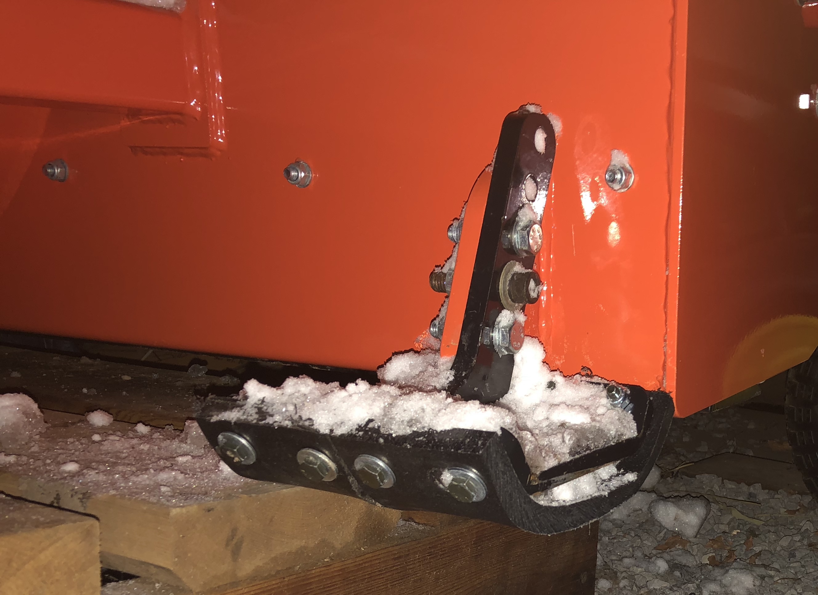

70E118A4-6238-4910-99E8-66D9EA587A6B.jpeg. This is the newer double wide feet they just stared delivering. Then I bolted on some 1/2 UHMW on the bottom of them and it worked well. Slides on pavement. When I get into my grass I lift the 3pt a few inches and off we go. Otherwise it would become a power rake.

View attachment 538175. This is the newer double wide feet they just stared delivering.
I have these on my SB72 that shipped in November 2017. I wouldn't want skid shoes any smaller than this, but they seem to be a good compromise size. Not quite slick enough on gravel (before allowing a snowpack to form) but work great once there is a snowpack. I don't have any payment to report on how they might work on pavement.

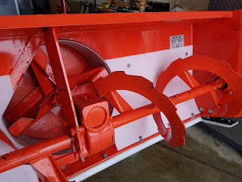

I have a front mount 5' on my B3350 cab. Lining the chute and blower housing with UHMW-PE netted an increase of perhaps 20% throw distance - and pretty much eliminated clogs. I get 40 feet (measured) worst case, and as much as 70 feet (estimated) with good snow.
/ anyone using a WoodMaxx blower?? #159
Can you add some close-up photos, especially of how the PE fits into the fan and is attached to its drum?
I was thinking of lining the drum with UHMW tape to minimize scrapes from gravel, but if you found a good way to use thicker material then that would be even better. The Woodmaxx already has HDPE lining for the chute, which seems like a great idea.
/ anyone using a WoodMaxx blower?? #160
With the rip-off from photobucket, I don't have convenient way to do that right now. The direct link to the photos is below. The specific info you're asking for is easier to explain, but I have done other posts on this: The blower housing is lined with 1/8" thick UHMW-PE. Since this material has a much larger thermal coefficient of expansion than steel, it can only reasonably be fixed at one end. that end is at the paddle entry to the housing as the paddle passes the chute opening. The UHMW is pre-bent at an acute angle to fit using heat gun. It cools slowly so you can hold the angle in position or speed the process with water spray or compressed air. Then the top edge of the UHMW is fixed in place with bolts (I used stainless #12 - not a lot of stress). The distal goes up into the chute and is held by a single bolt and washers. The UHMW is slotted so this end can move in with expansion contraction. 1/2" slot was enough on my blower, I tested by putting strip in freezer, then in hot tub.
If there is any risk of picking up gravel chunks, consider a design with an impact strip at the first acute bend. The UHMW though super tough, can be deformed in a really high impact incident that would also dent the metal underneath. Happened on mine, and I simply heated up a metal bar and used it to press the UHMW back into place. If the link won't work for you, let me know and I'll see what I can do.
