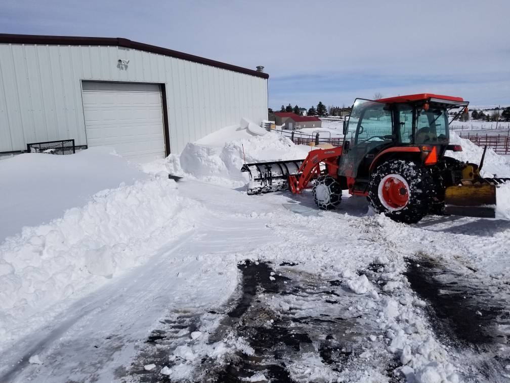

All the Kubota grand Ls (end in 60) have the same frame. I believe it's the L4760 and up has a beefier front axle. Obviously the higher the model, the more HP. There are 2 different engines I believe. They just slap turbos, intercoolers & what not to get more power. The bigger axle can take the bigger loader.
My l4760 with R4 tires measures 74" from outside of the tires. Contact patch is a little less, probably 72" but the sidewalls bulge out a bit. I may be able to move them in a notch, but haven't looked. R1 tires are narrower & would probably get you below your 72" desired width. I'm not sure if there is clearance for chains on my rears. My blower is 74" wide, which matches well.
I've got chains for my fronts I use occasionally. They definitely help me push more with my SSQA blade. But I'm not sure it's worth the hassle putting them on & worrying about damaging concrete or pavement (all the roads & almost all driveways out here are gravel though). They really help when it's icey though. Last photo I have with them on was before I got the blower, which makes sense.
I want more HP than the 40 I have. Well, I live at 7,000' so it more like 34hp. But with HST I have plenty of control & enough to plow or blow at a reasonable pace.
I had front chains only & didn't have the blower yet for the big snow back in 2019. Buried some neighbors F350 with a 8-10" lift. That was the final straw on me getting the blower.View attachment 4995873
