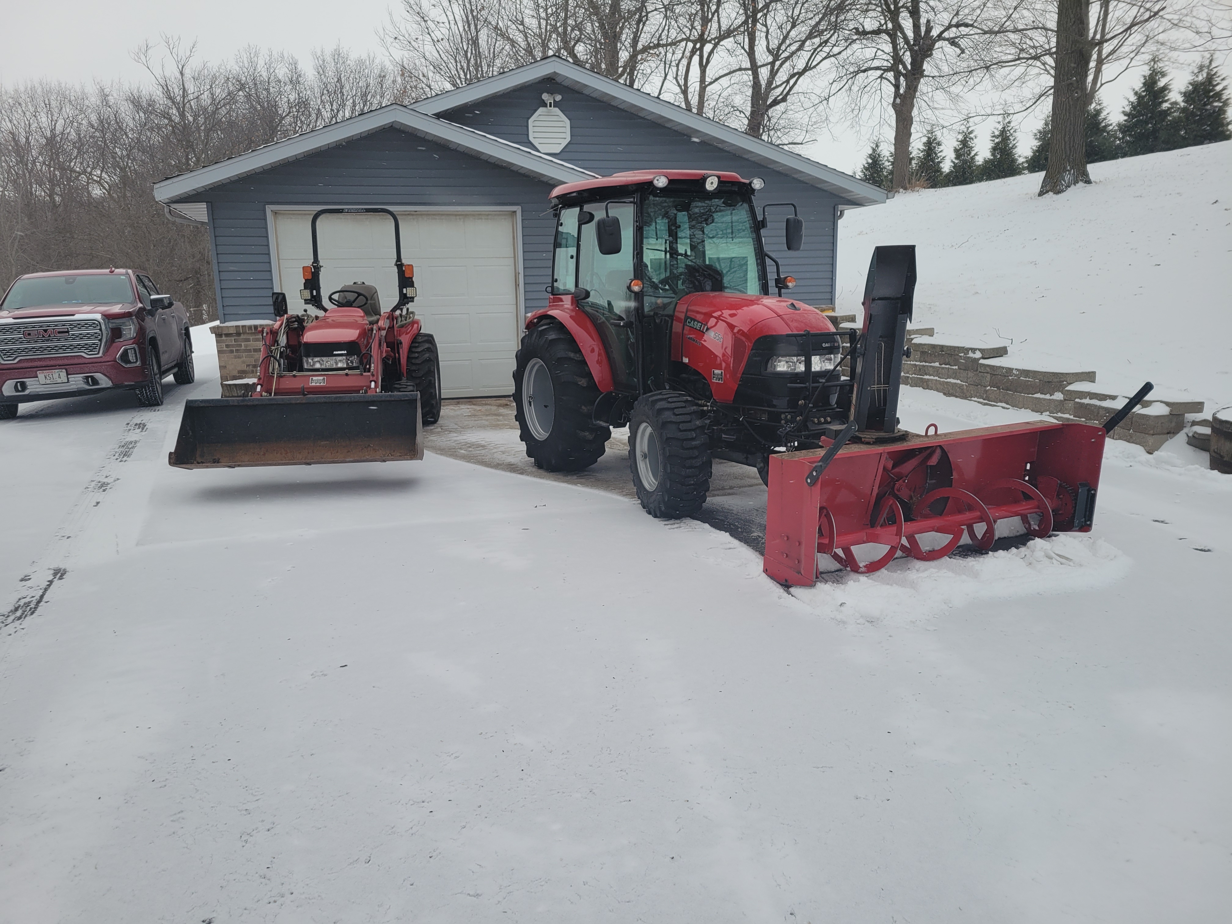

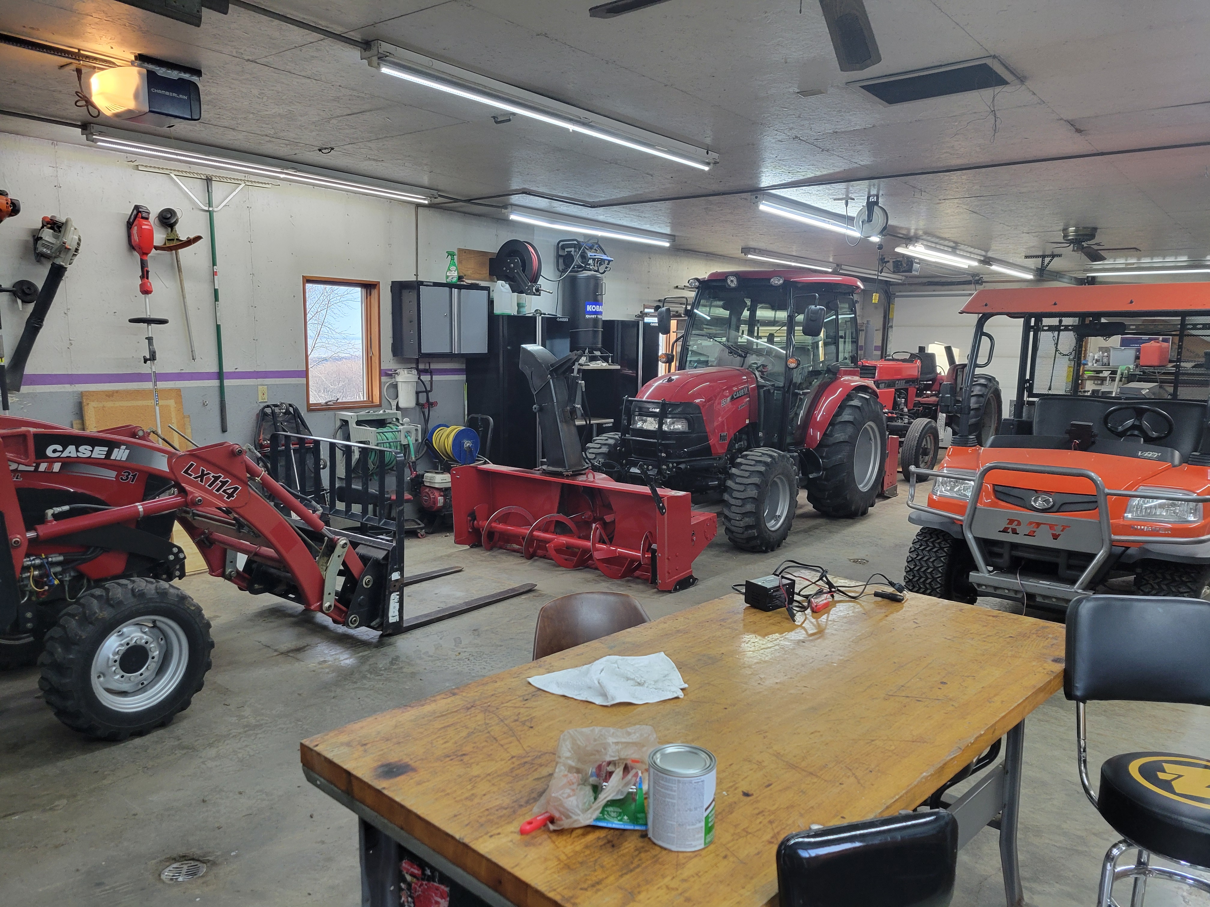

I run a 74" front mount on my Caseih Farmall 55c Tractor is about 45hp pto. Runs off the mid pto which is 1100 rpm. Unit does a fairly good job but there are times like today it has its hands full. The hydro by far is the best for blowing snow and gives much more traction than a gear tractor which I have also. I have a hydraulic dipper also i built which really helps in the windy areas.
