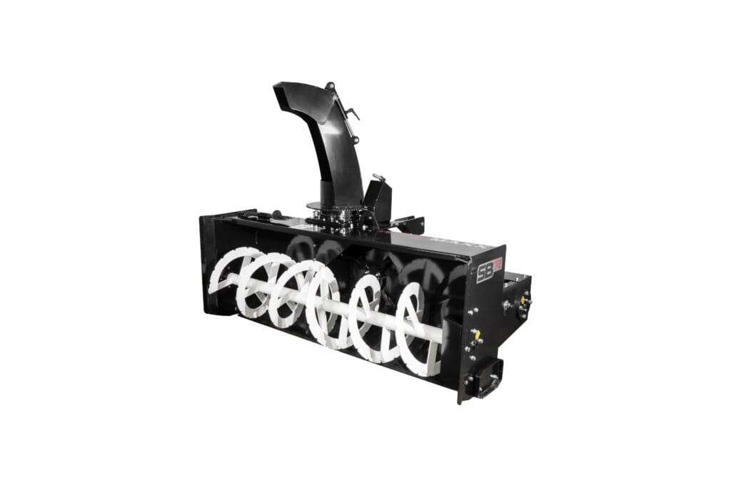

I'm looking for a hydrostatic drive tractor. The most demanding job will be the 72" snowblower. I'm currently using a geared tractor, a Siromer 304 which I believe is the same as a Jinma 254. This occasionally runs out of power. Ideally I'd like the new tractor have at least as much power, but I can't seem to get a straight answer about what PTO power the Siromer actually would be putting out.
So I thought I'd turn it round, what sort of power would people want/need for a 72" blower? There are lots of 25 or 26HP tractors around, but a whole lot less choice in higher power.

This woodmax wants 25 HP min.
Nice thing about a hydrostatic drive tractor is how easily the over the ground speed is modulated to suit the blower loading.
I might call 35hp a better match depending on snow type. Do you get wind drifted fill? That stuff can be hard and dense.

Cheers. My blower is rated 40HP max, min recommended 18HP. I assume those are PTO rating. But same as you I was thinking 35HP tractor, if I can find one.
I'm looking forward to the variable ground speed, and I'm confident that will save time by allowing me to run faster where possible. So theoretically I could afford to have to slow down sometimes, but that would kind of suck. I want the job done quicker all round.
When you say "wind drifted" do you mean lying snow picked back up again? We do get that from time to time and it sets pretty solid.

I have a 72 or 74" blower. L4060 cabbed machine with 40hp runs it pretty ok. I wish I had a L6060 with 60hp to go faster, but 40hp is fine. 32-35hp would be pretty slow but doable.
I'm in Colorado & we get lots of wind & pretty big drifts. I mostly use a plow on the loader. Faster with the plow, but I use the blower for drifts or windrows. A lot will depend on your snows & drifting. With a HST you can usually go slower & just let the blower eat.

I ran my 72" blower on a 27pto HP hydro and a 32pto HP hydro without issue.

I've used a 30 pto hp hst tractor with a 78" blower for the past 26 years, with no issues. I think you'll need at least 25 hp at the pto for your 6' blower..

I would not recommend a 72" blower and 19hp at the pto. Sure, you could slow way down with an HST, and take smaller bites, but it's going to aggravatingly slow going in all but the lightest snow conditions.

It needs weight, or at least our existing rig does. Blower is supposed to 270kg. The Siromer 3PT is rated for 400kg, any model I'm looking at now will lift more.
