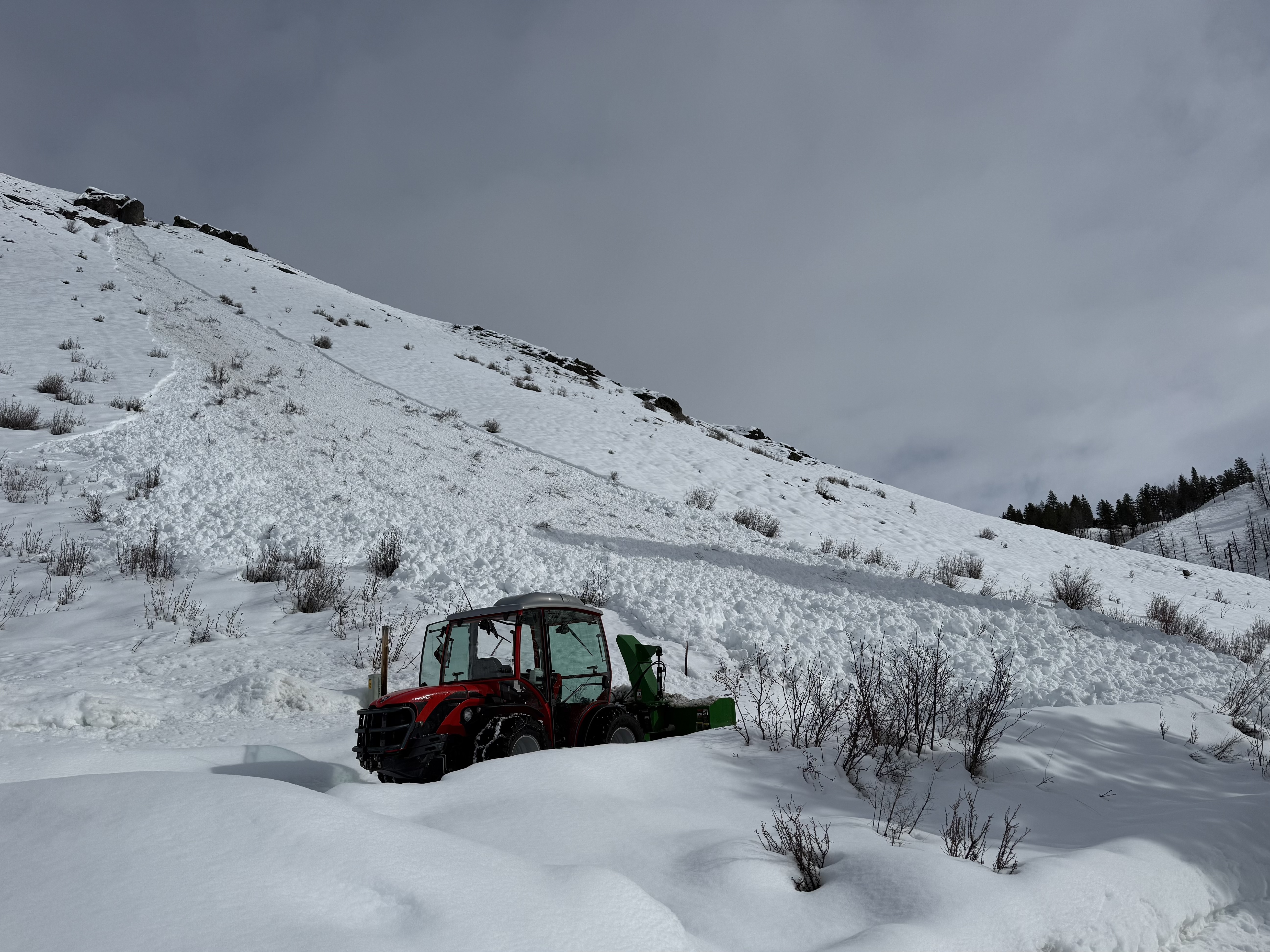

George, yes, the video is clips from different days. Long story, but I wanted to try a used blower for a while before deciding on an expensive one. I had a used snowblower lined up for a couple months that wasn't a big investment, but then the seller backed out and I had to scramble to find something. The local dealer had one without hydraulics so I bought that and had to wait for the hydraulics kit to come in.
Leon and Jon, I did look at the Pronovost with the rotating drum. My local dealer couldn't get Pronovost (only MK Martin, Lorenz and Frontier), and so up front I'd be investing a lot in something that I'd need to get shipped cross-country along with the premium cost and needing to fiddle with a hydraulic multiplier out of the gate due to not having enough remotes. For most of the driveway I don't care where the snow goes as long as it's off the road, but as I get closer to my neighbors I need to be more careful about where it goes (even if I'm not throwing in the direction of a house or car, I try to deflecting it downwards so it stays close-ish to the road instead of making a mess of untouched snow fields). If I had to splurge on a snowblower I think I might still go towards the euro-style, but the Frontier is working well enough for me so far.
George, it is pretty noisy when snowblowing. I haven't spent much too time on other tractors, but it doesn't seem overly noisy. When working with non-PTO implements, it has an "automatic" mode where the engine rpm modulates with the pedal to keep the engine speed only as high as it needs to be (kind of like a car), and I usually don't use ear muffs in this mode. When set the engine up to 2300 for snowblowing I definitely need hearing protection. The hydrostatic whine isn't as loud as the video makes it out to be, though, it's just the roar of the engine.
Jon, this particular model has a quite roomy cab. I've seen other models on the dealer lot, and AC definitely makes a lot of tight cabs. There are two sister models to my tractor (TR 7600 Infinity and SR 7600 Infinity). I think the TR cab would be fine, too, but only for one person. My model has steering tires, as does the TR (although the TR has room for bigger tires with chains). The SR is extremely narrow and articulated, and gives up stability on steep slopes. If I had to spec out a new tractor, I might go with the TR for the chain clearance, and it has a fancier joystick available that controls hydraulic flow based on how much you move the joystick rather than just being on/off.

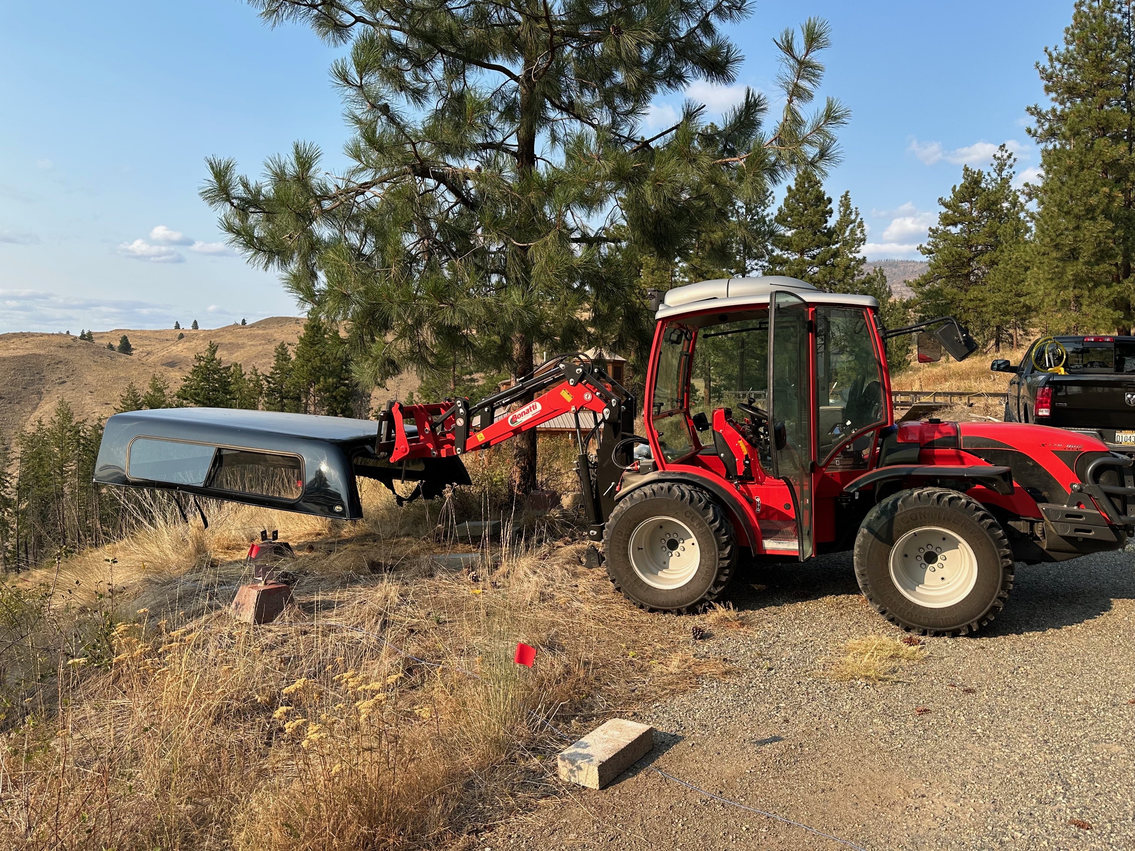

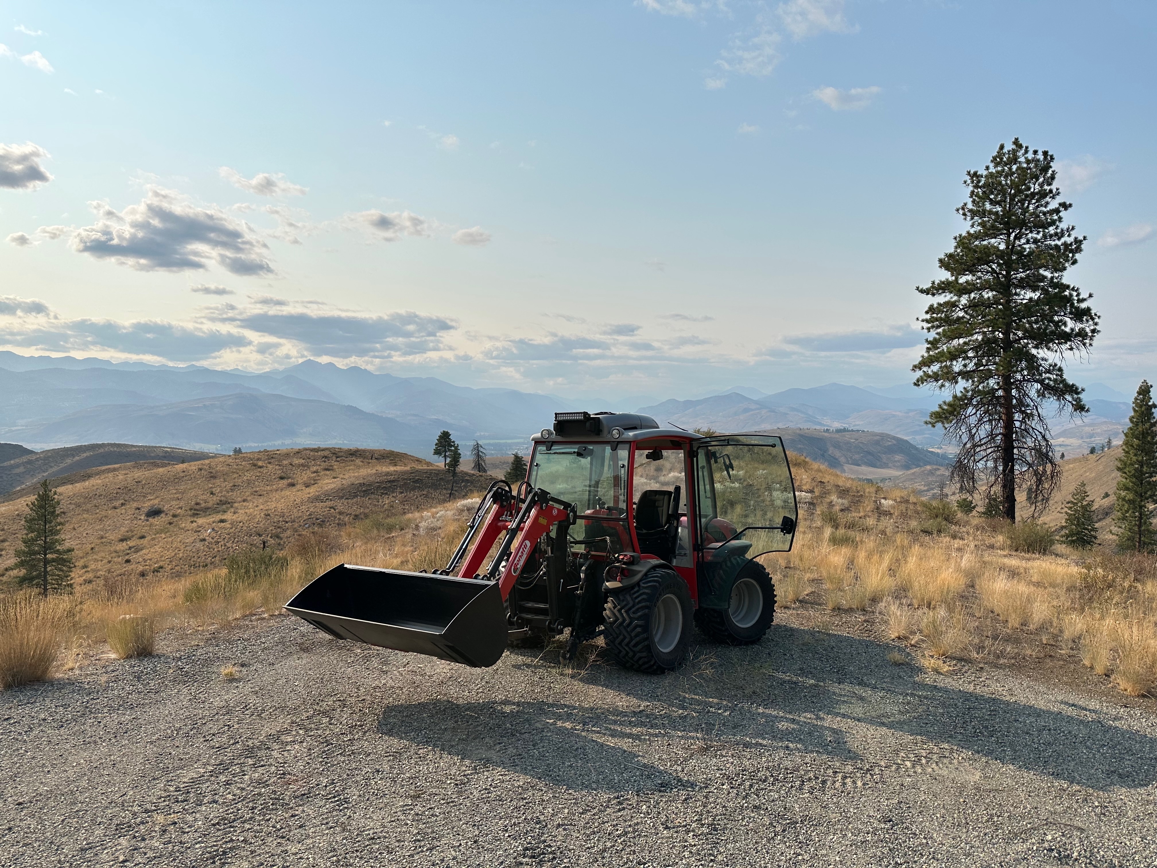

Jon, I don’t use the loader much. It’s not a bad loader, and the self-leveling is nice, but it’s more difficult to attach than a 3-point attachment and you can’t have it on at the same time as a 3-point attachment. It's way under-rated at 700lbs. I've lifted my mower (550kg) off the delivery truck at about the top of the lift range, and moved a ~1600 block of concrete around near the bottom of lift range (that was very tippy), and both of those lifts felt sketchy. Also, the tractor-side attachment bracket is huge and makes hooking up PTO implements more difficult (the PTO shaft has to hang in the right place to thread through the bracket). Also, my non-fancy joystick always has forward/back as the 3-point lift, so the controls are left/right on the joystick for curl/dump and loader lift is via joystick buttons which is a bit weird.

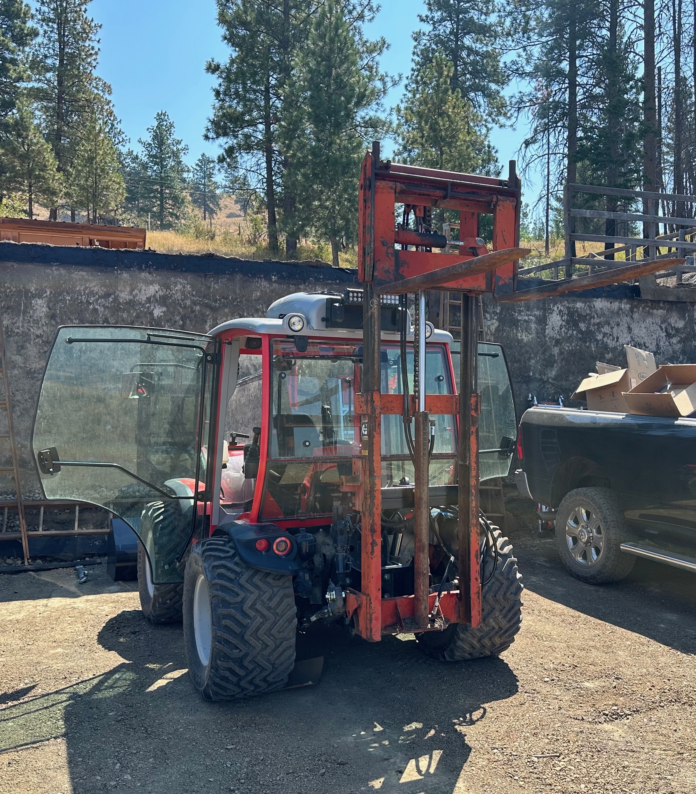

I used the forks way more than the bucket, and I ended up adapting an old forklift mast to the 3-point hitch which has double the lifting capacity and generally better ergonomics for doing forklift-y things. Bonatti offers a front loader that can stay on while using 3-point attachments, I was advised against it given how far back the front tires are leading to tippy-ness. If I had to do it again, I might have gotten the front loader for when I need a high dump bucket or downforce, and then use the forklift for heavy lifting. In any case, loader work is not a strong suit of the tractor.

there really isn't much space between the fenders and the back /front tires, lets say the tires on the three point end of the tractor. thanks for the extra pics. always nice to see other options. I wonder how much load that forklift mast puts on the top link mount. It sure does look handy to be able to lift pallets up high with more capacity than the loader.
