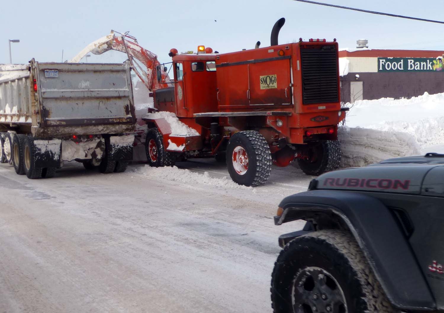

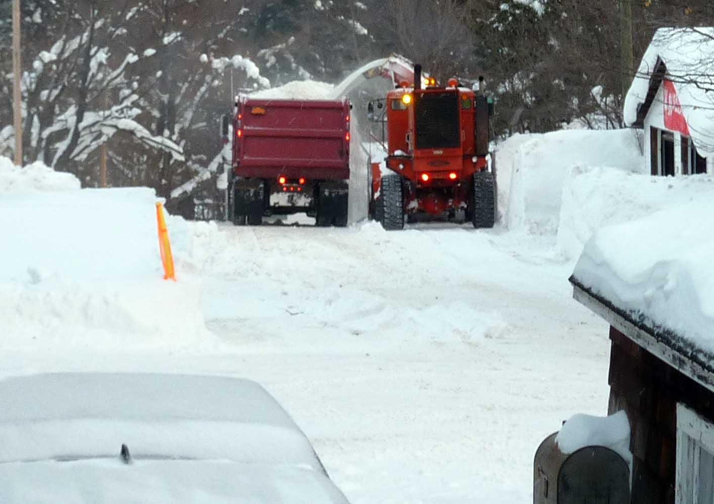

This size is what you mostly see. A serious and expensive unit that takes the same to push it around and a township or airport type of application.

Gee, we see SnoGoes operating here each year. Just following
