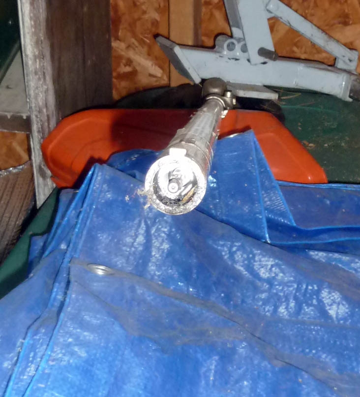

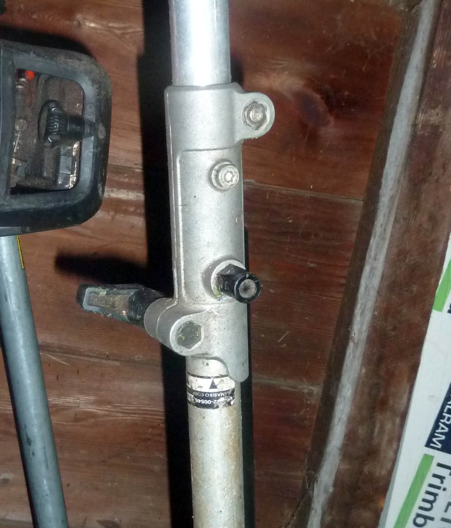

In response to the better connection system that Stihl uses, compared to the Echo. Below is Echo's that using a pin. The camp will not compress the connector onto the tools shaft. It stays slightly lose and its lock pin is harder to get tools on/off. Have broke them. View attachment 3619259View attachment 3619260

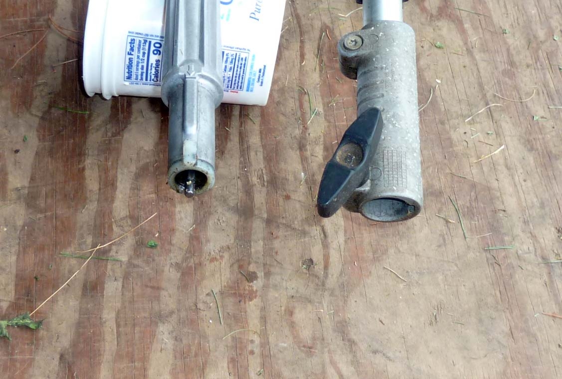

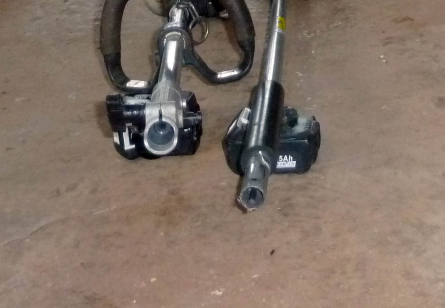

Below is Stihl's Kombi system. They use key and keyway system to keep it from spinning, then the camp does compress onto the tools shaft. These are much easier to get on/off and the drive shafts ends are designed differently and goes together better.
View attachment 3619263View attachment 3619264
Something is wrong if the clamp isn't tightening down on the tools shaft, if you weren't able to get it tight and the pin was the only thing holding it I can see where you would be having problems.
The pin is only there for rough alignment, not to hold the attachment.
Did you address the issue with your dealer?

Are you sure? I own 4 and we started using them 20 years ago, and they did the same back then. (Different machines) Echo designed the pin to hold it on. The casting has a spacer on it to keep you from crushing the tool shaft when you tighten them down. Check with your echo dealership. I do like stihl clamps better.

I own a PAS266 and have used other Echo pas units, all tighten down on the tool and have no play. On mine, once tight,the pin could be left locked open and it wouldn't make a difference.

I have a mixture of Stihl, Echo and Husqvarna power tools for trimmers, brush cutters, etc. For the Kombi systems I have both Echo 2620 and 266. Both have been flawless and enjoy the attachments. I also have an Ergo battery trimmer for just quick trimming around the pool and house. I love it for just quick jobs. Light and so quick to use but yeah, like you said it would get really costly to have enough batteries for serious run times. I only got it because I got the leaf blower too as a combo deal. Leaf blower handy to dry off car/truck/motorcycles after washing and blow out garage.

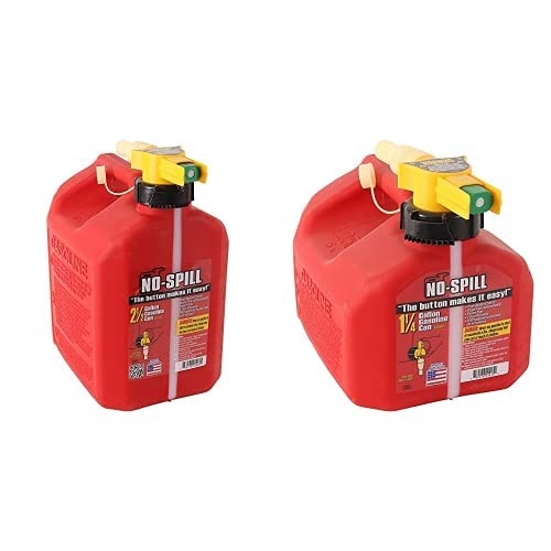

My cans are well marked in LARGE letters but apparently I cannot read my own labels or writing 🤨. Blaming SWMBO, she will not pick up any gas powered equipment, to heavy, even some of the battery tools the weight is complained about. So she bought her own lightest weight tools she could find, so she has hers and I have mine and any screw up... it's all on me. 😬
It took me longer than 10 years but I finally learned ALL mistakes are my mistakes... because I should have known my help was needed.
