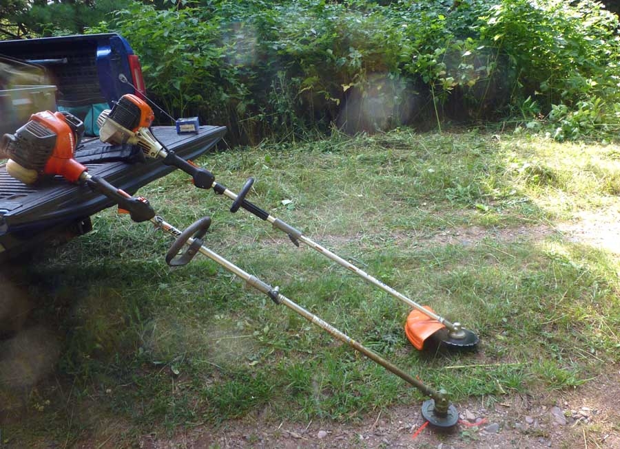

No matter what you think of its 2-4 stroke power plant, they have lots of other features we like over the Echo and Honda's we used and owned over the years. View attachment 3582206
In response to the better connection system that Stihl uses, compared to the Echo. Below is Echo's that using a pin. The camp will not compress the connector onto the tools shaft. It stays slightly lose and its lock pin is harder to get tools on/off. Have broke them.
Below is Stihl's Kombi system. They use key and keyway system to keep it from spinning, then the camp does compress onto the tools shaft. These are much easier to get on/off and the drive shafts ends are designed differently and goes together better.
