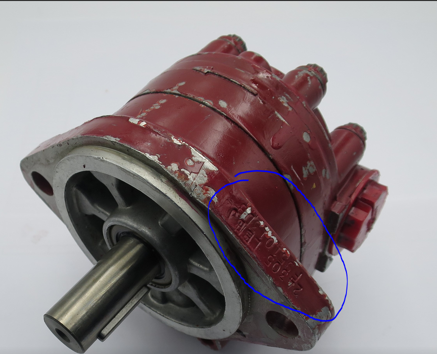

Well the piece about the front end loader changes everything. You most likely have a Freeman / Massey Ferguson 101 or 102 loader. These loaders came with multiple pump options. If you have a high flow (20gpm) pump then you will need to just replace the valve with one that has three spools and use the 3rd spool to run the snow blower. 20GPM at 2500 PSI is 33 hp less any loss. I would run 3/4" lines to the front with a flat faced coupler to reduce the losses. You can run 1/2" lines but the velocity of the oil leads to a pretty high loss rate making lots of heat. I Have the grandson of the 202, a 20C with a 32A loader and have looked into this before.
I loterally thought of this the other day. I need to verify the pump somehow any idea?
If i choose to avoid adding a 3 spool and just buy a single is it possible to use the plu on the side of the 2 spool standard if thats a power beyon?
From there go to a single spool on off detent to hold. Then to a relief valve then motor of blower? If so where does the return line go back to,? The resorvoir but if my pump is already hooked up to the gigantic return at bottom how do i plum both returns properly? Or is there a drain port under neat i can use?
/ Mf202 snowblower conversion to hydraulic #17
You might be able to pull some numbers off the pump. Generally they are stamped on the flange. Then use google to see what it says the pump is.
