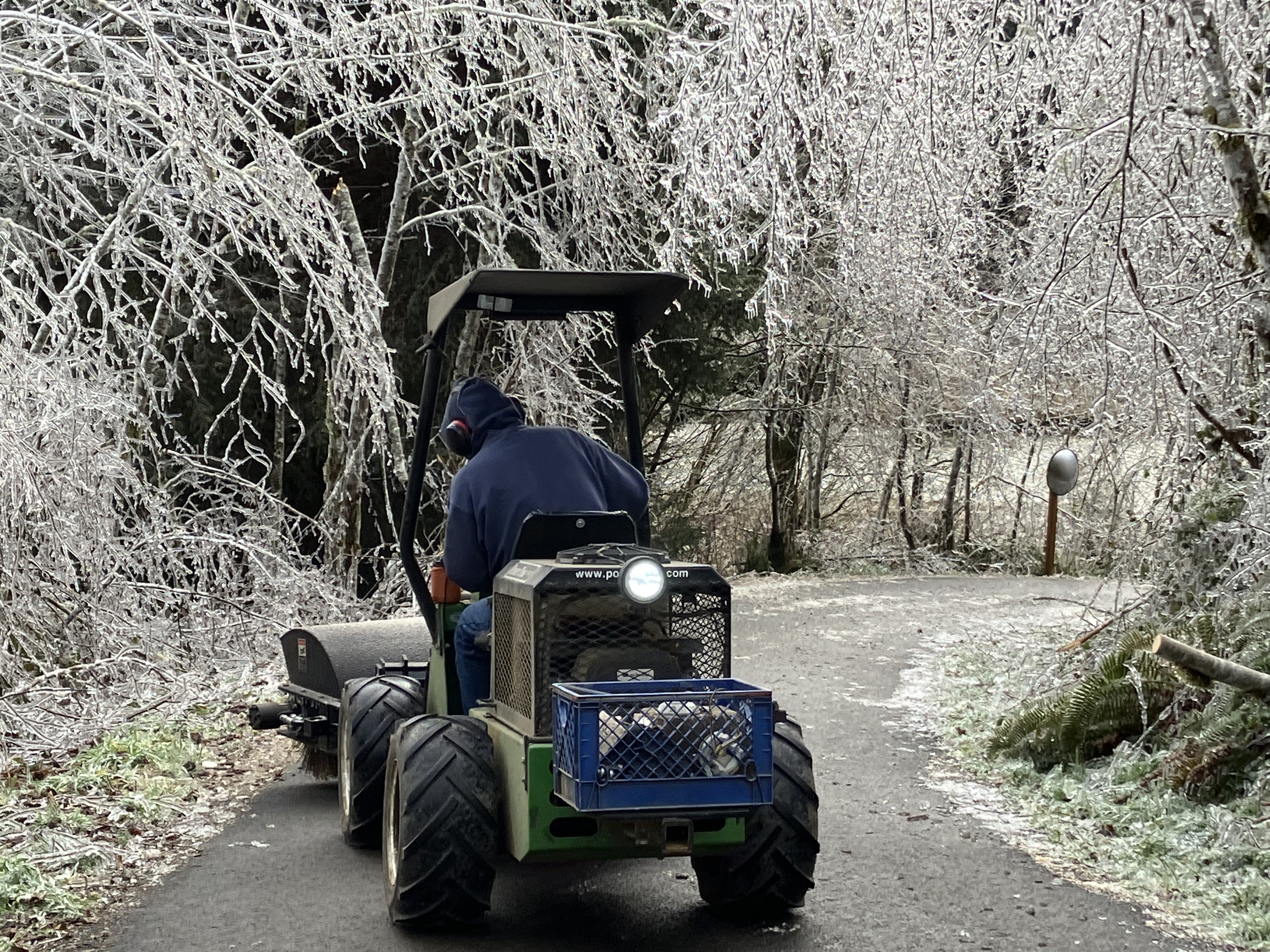

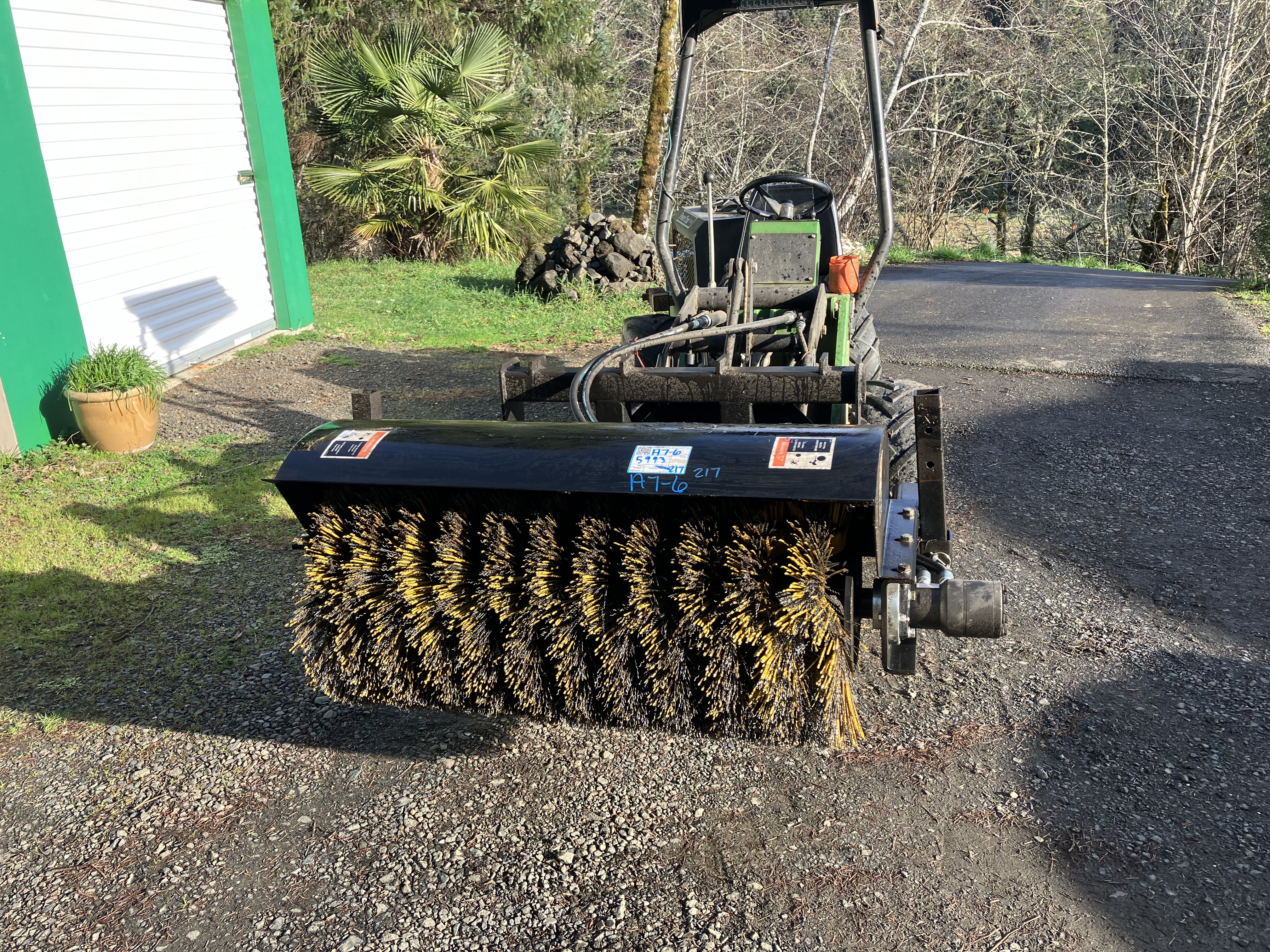

Here’s what I did. Though we don’t get much snow here in Oregon. I use the sweeper more often to clear the moss and detritus from our driveway.
