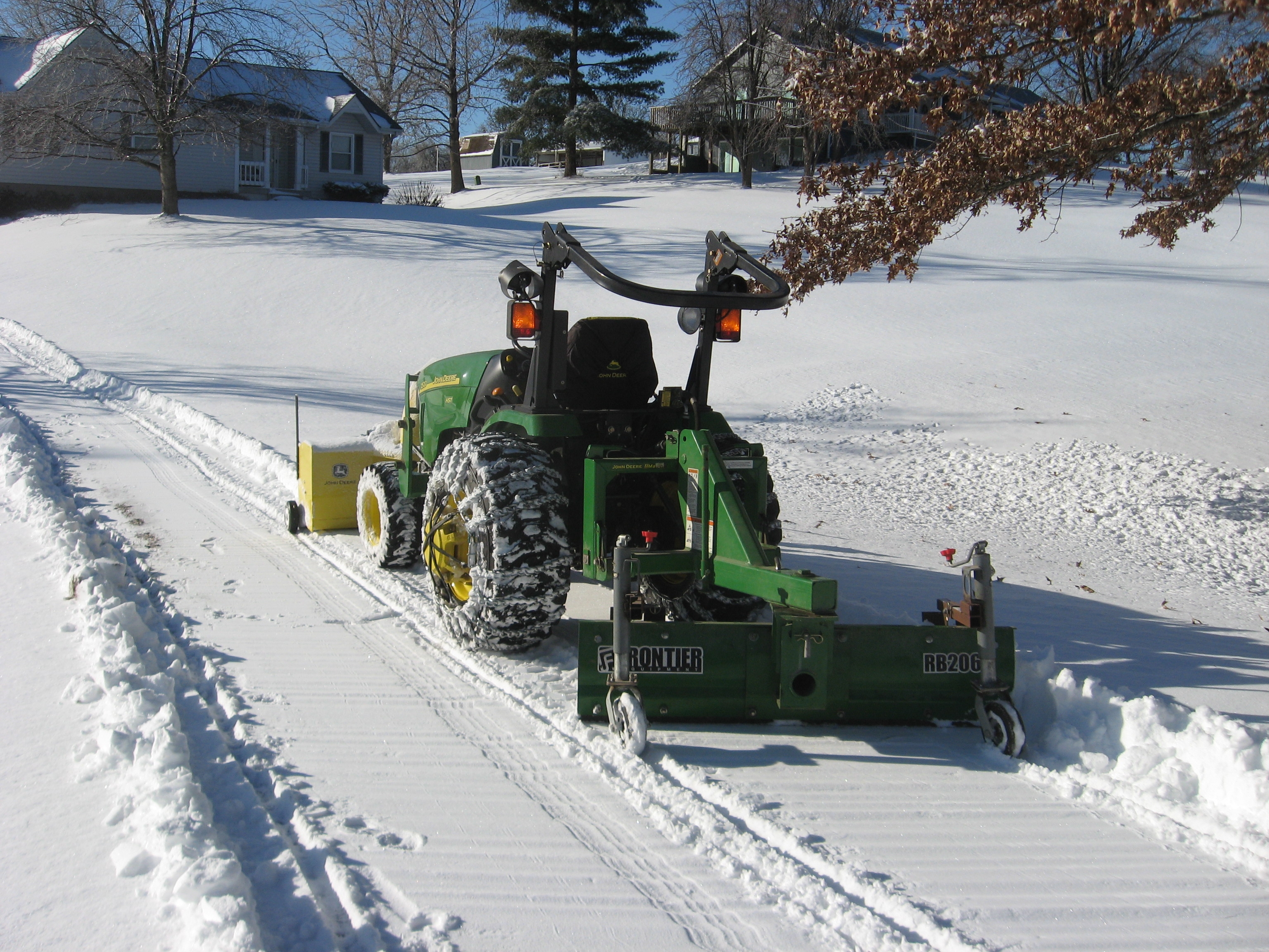

Here in Virginia we are having our 2 x per decade decent snow event. I have a #8 brownstone driveway and I've never been very good at getting the snow off with my JD 1025R.
I have a rear blade, which requires constant attention to keep from gouging. I have put PVC on my loader and use it in float mode. Not so great honestly. The best luck I've had is backdragging in float mode with the PVC installed on the loader edge. It doesn't get to the surface but it also doesn't displace the stone. I am thinking it's the best case scenario.
What am I missing, if anything here? Edge Tamers?

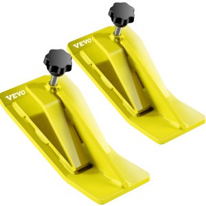

I use the tamers, these below, you may need 3 depending how heavy the bucket and how soft the ground is.
I can run in float at almost full speed with out digging in.

Turn your rear blade around 180 deg. so it won't dig in.

I couldn't pull the trigger on the "originals" so I found these to try and not hurt if it doesn't work. Paid $31 delivered, waiting on delivery now.

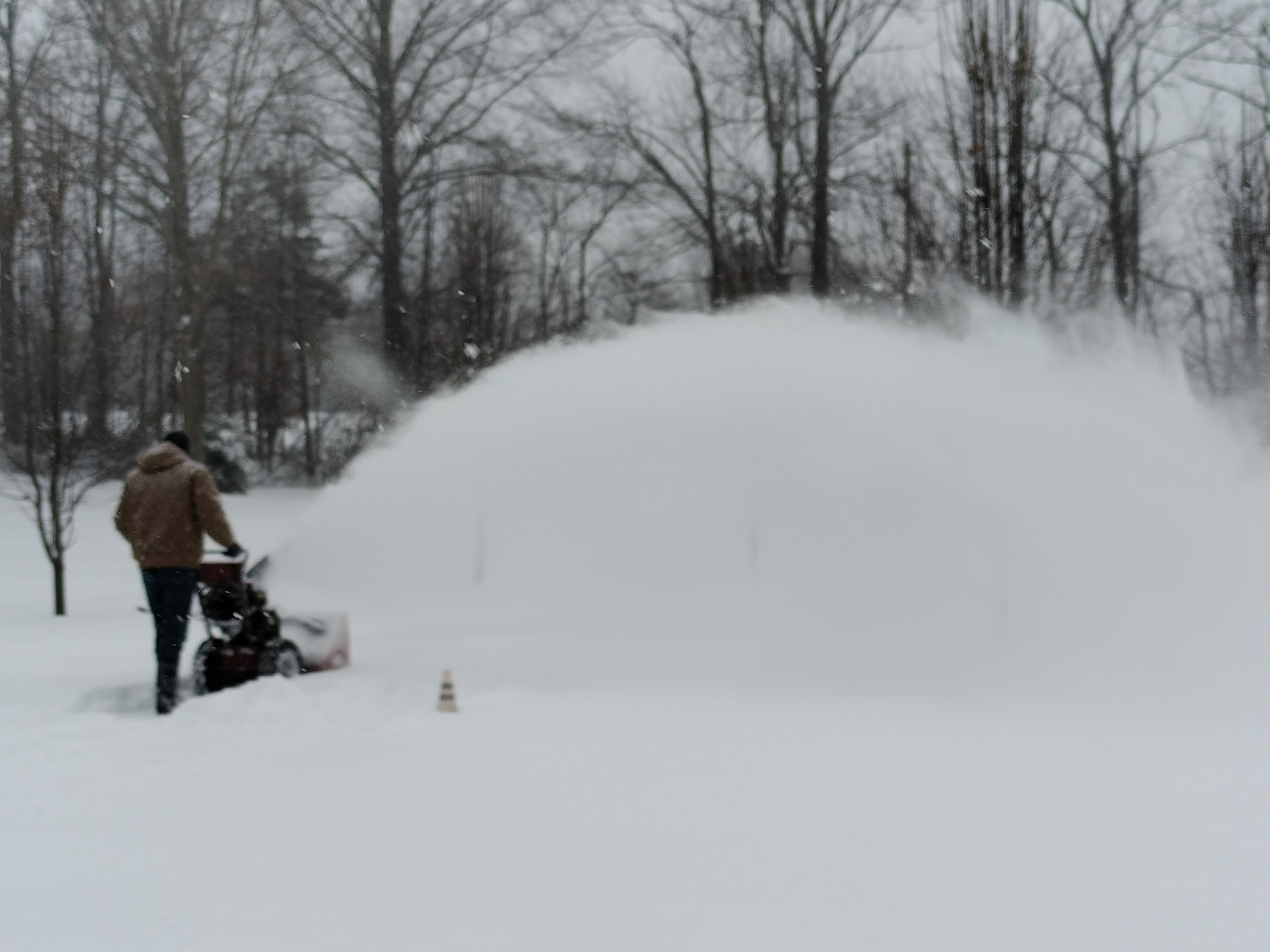

I got a $100 snow blower this week on Marketplace, then made wooden skids that are wide and taller. Leaves 1" of snow, but glides along nicely.
Decided it would leave the driveway surface in better shape than the tractor

Far as I'm concerned there is no reason to remove snow right down to dirt/gravel/pavement level. Keep your blade a couple inches above the ground and it won't dig in and you can still drive on it without getting stuck.

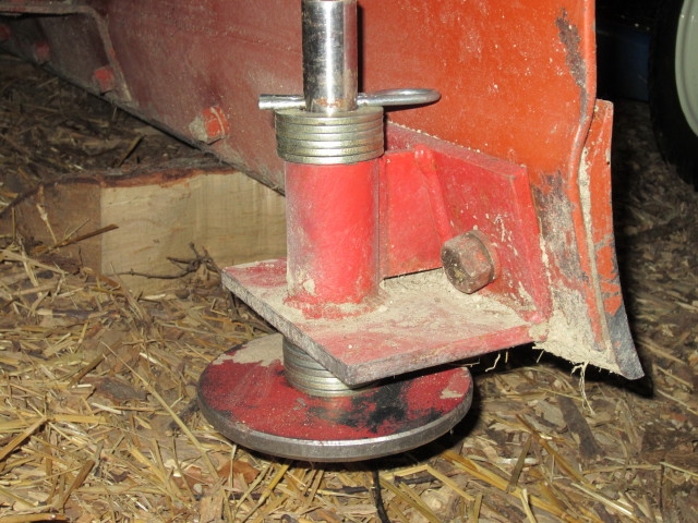

You can put gauge wheels on the rear blade to hold it up a little. I keep mine 1.5" off the gravel and have very little disturbance of the surface.
Also, if you're plowing with your bucket (and don't have edge tamers) you can set your bucket so the lip is about an inch off the ground and then put it in float. It will ride over the snow and you can "bump" your dump/curl function to make fine adjustments to get it to dig a little more or less.
PS: Don't be too hard on yourself, I've been trying to do it for 17 years and still can't keep the rear blade from digging it without gauge wheels.

An easy fix. Turn your rear blade around 180 degrees so the cutting edge faces backwards. The float the blade and drive forwards. This will remove snow without disturbing your gravel. If the snow is deep also hold your loader bucket 4 inches above the road to move the greater depth and follow with your reversed rear blade.
I NEVER use the blade in the "forward" position on gravel. Pushing snow with the wrong side of the blade won't dig in, as you say. (y) I did make shoes for the blade which works too.
