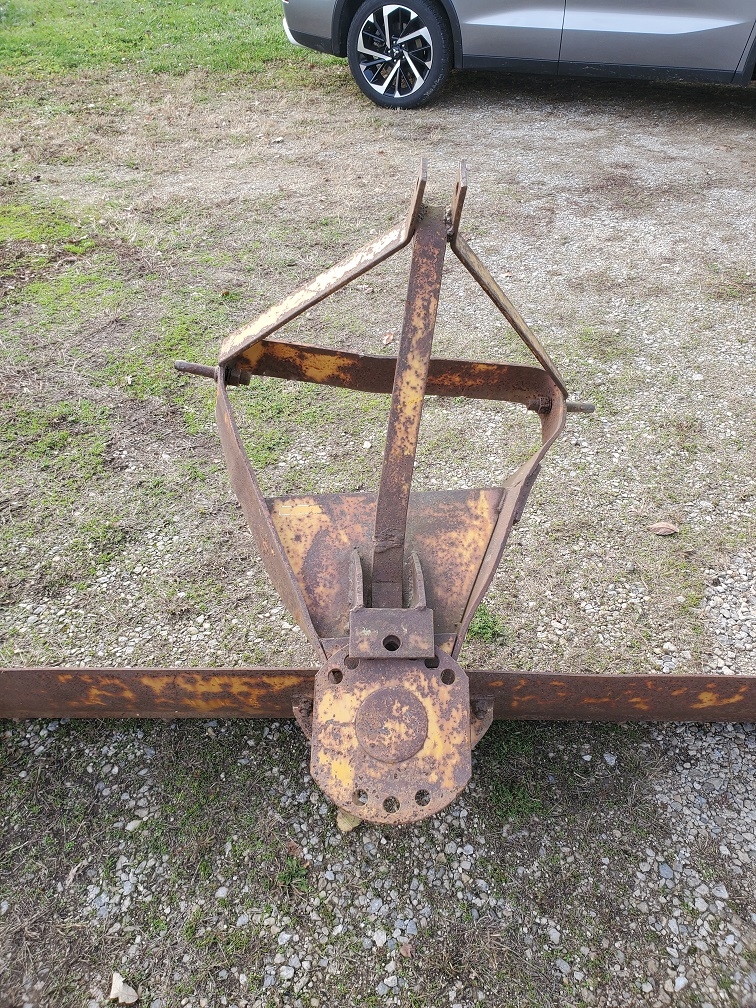

We're working through the set up of a compact utility tractor. No matter what way we go, it would have a loader and 3ord function hydraulics - specifically for this application and a few others.
We've looked at some purpose-built snow blade loader attachments and as nice as they would be, cost-wise we're just going to make do with what we already have - that is a 7' 3pt rear blade. It will do the job fine.
That said, I need to fabricate the cylinder mounts. I am not sure what that geometry should be or the dimensions therein.
The other big question is - what is a suitable cylinder for the task? Maybe I need to start there then base the mounts/fabrication/design off the cylinder dimensions. Additionally, if we use the blade beyond snow for grading and spreading gravel - is what ever cylinder we pick going to be up to the task? Or is that going to be asking too much of said 3ord function and cylinder?
See attached pictures for the blade we have.
The top view of the blade shows the swivel and pin holes for the angling. Note that this was as we got it - all bent up out of shape. I cut it apart last winter, straightened some pieces, and welded it back together. It isn't perfect, but it works very well now.

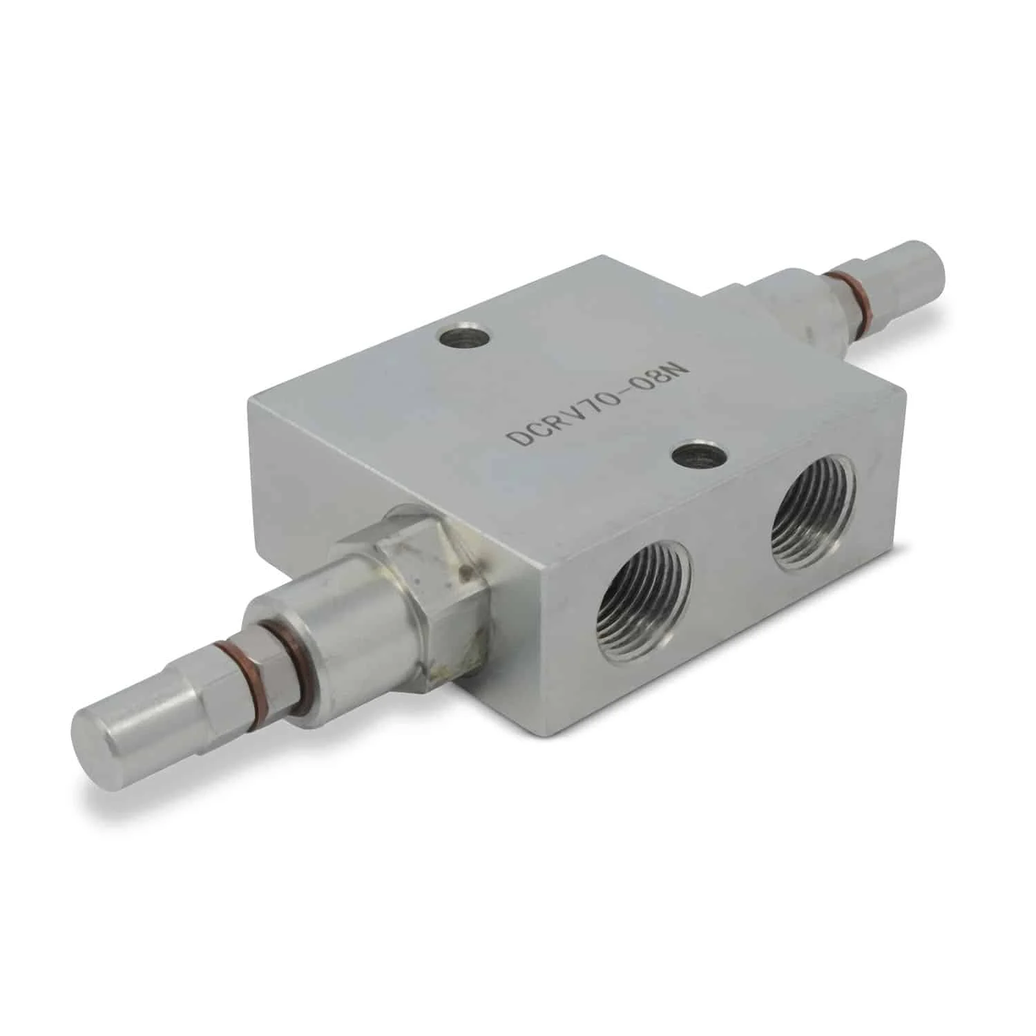

To avoid shock loads to your tractor's hydraulic system, you may want to add a crossover cushion relief valve such as this one:
This will protect both the blade and tractor from damage should you snag the blade on something.

As to the relief valve - I see the one in the link posted earlier has an adjustable bypass pressure of 150-2600psi. That sounds like it would be ideal. The trick is going to be figuring out what an appropriate pressure is for it. Is there a method anyone can come up with that would bring any reasonable accuracy to setting it? Maybe setting the blade against a solid object and running the hydraulics while having a pressure gauge in line with the circuit being tuned? I am not sure how the 3ord function solenoid will operate, however I would have to imagine there is a flow adjustment to set the speed for what ever function that is controlling (blade angle, grapple closing/opening). Maybe with that turned way down (low flow/slow) and the pressure gauge it would be conceivable to let the 3ord function flow a bit in each direction then calibrate the bypass pressure to a more ideal number? I guess I don't have any idea what that number may be, other than to throw something at the wall on the low side, try it, and increase maybe 200-250psi each time? If the blade grabs a pile of snow off the end and the pressure trips I'd say it would be too low.
Set the crossover valve to it's minimum and try plowing. If the blade trips too easily, bump the pressure up a bit at a time until it holds.
Another thought -
Would adding these relief blocks to the loader frame itself help also? I am not sure how that would work, but my idea is if the impact from plowing and hitting something could be deflected by hydraulic pressure release in either the lift cylinders or curl cylinders that might be a good idea. I just dont know that the physical geometry would work in that capacity?

However, I am looking at it and the design of the blade we have and the receiver hitch will be blocking the blade frame.
Are there any ideas on how to overcome this without loosing the receiver tube? I hate to do yet more fabrication, but it is looking like that is the only way around this one.
The only thought I can come up with is to cut out the cross brace of the blade frame and replace that somehow. The question is with what?
One idea would be to use heavy angle in a triangle pattern (angle as opposed to flat bar/plate as the 90deg legs will resist flexing at the point of the triangle, whereas a bent plate/flat bar would have more of a tendency to bend there). The goal would be that "triangle" point is far enough in towards the blade that it opens up the space for the receiver hitch to clear.
*The picture is as we got the blade. I cut it apart, straightened it, and welded it back together so it is functional, not this twisted heap you see. However, this is the best picture I have right now that shows the frame interference I am talking about with the cross bar between the lift arm pins.
