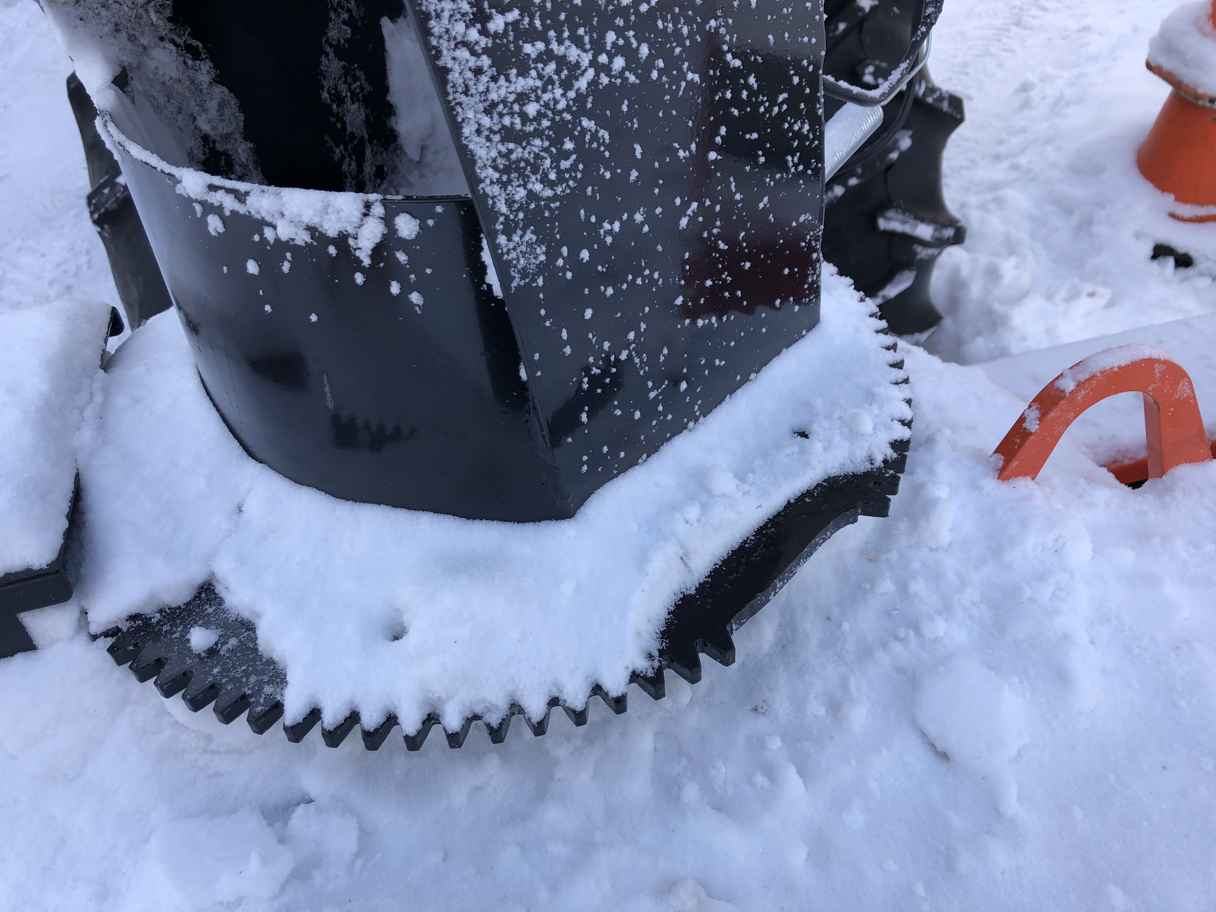

I also have the electrical controls. Very big motor and has worked well so far 0 degrees a few days ago. Only thing I did not like was no stops so could rotate forever and rip out my chute actuator wiring. Sure I could have wired up some limit switches but sawing off a few teeth do I have a dead spot when it痴 aimed at the back of my head has worked great. Better to give it a nudge to re-engage the teeth than rewire every oops. As said very impressive build quality View attachment 532510View attachment 532511View attachment 532512View attachment 532513and new skid feet are 2x wider.

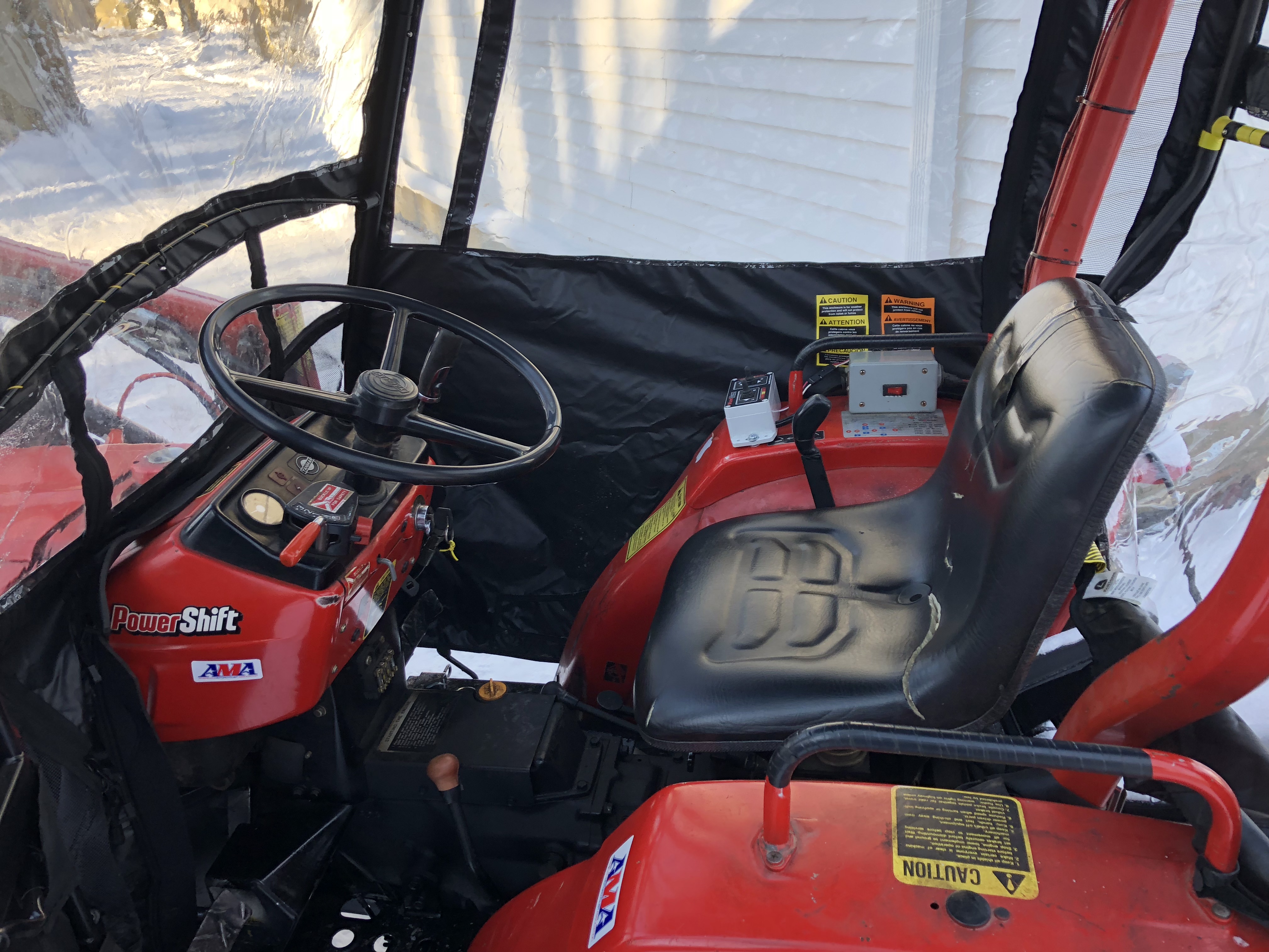

What is the switch box for that is next to the chute control box? Does it relate to the blower?
Looks like you have a plastic enclosure. Been thinking of that as a possibility. Are you happy with it? What brand? Are the visuals good enough through the plastic?
Thanks
That's the motor and gear to turn the chute. It's a metal box.
/ anyone using a WoodMaxx blower?? #131
Thanks but I think we are talking about different things. I was referring in post #118 on 12/18 in MarkSold's 2nd photo of the interior of the tractor where it showed the toggle switches for the electric chute motors mounted on the fender with a rectangular switch box adjacent to it that looked like they might be wired together.

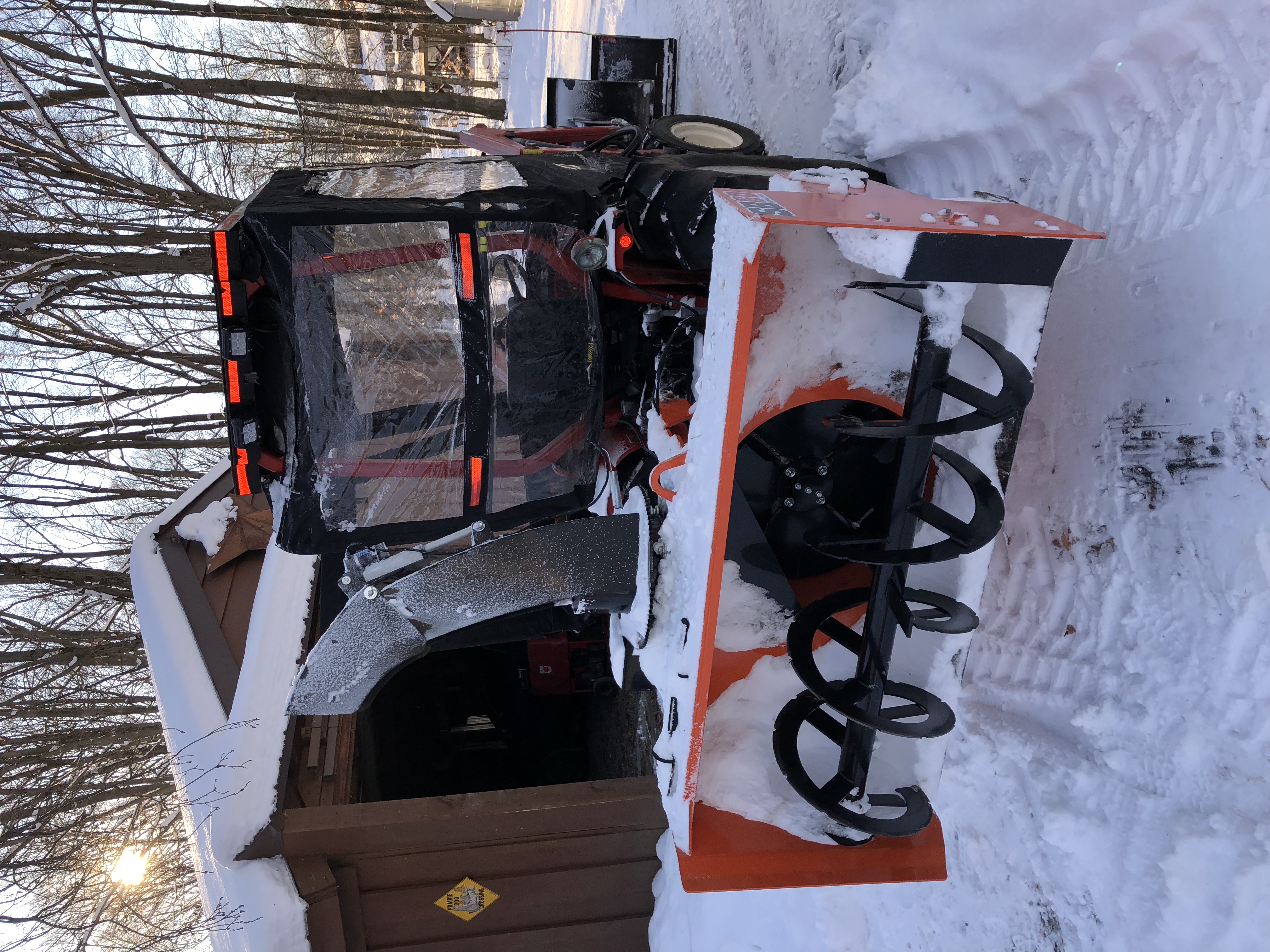

They are made in my back yard so maybe next year. I have a Canadian 66 inch for my ford but bought a 7 ft snow pusher for the Kubota FEL
Just tired of wearing 50% of the snow exiting the chute. Driving backwards also a pain for last 25 years. Kubota has a cab so pusher on front and rear blower might be ideal. The discharge fan on woodmax is very productive , forward thinking design while driving in reverse. Unles snow is more than a ft deep, a pusher is so much faster. Fewer trips to chiropractor as well.

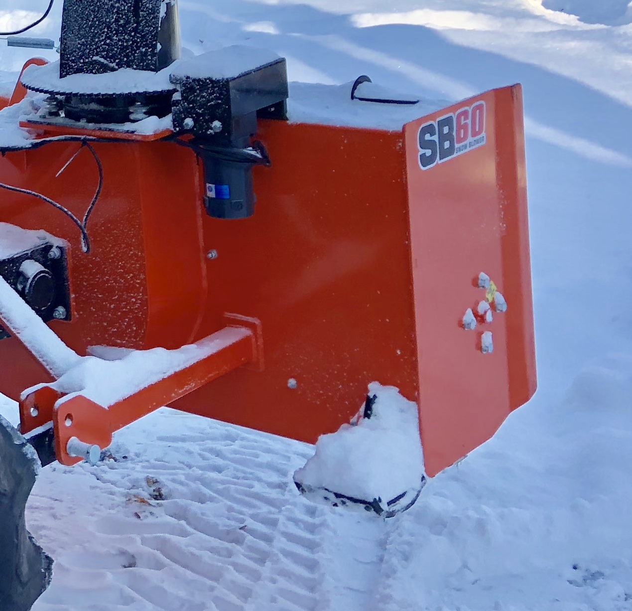

I placed my SB-60 into service yesterday, powered by Kubota B2650.There is no doubt that it is a good snowblower. The latest storm was snow followed by freezing rain so it was a real mess, and the blower got rid of it without any trouble. The leading edge of the shave blade dug up the grass a bit much so I need to adjust.
Driveway is paved 330+ feet, but I also remove snow from pavers, and also cut a few roads on grass to the sheds and propane tank. I plan to lower the skid shoes one notch, and try to tilt the blower (with top link) to get it as close to the ground without touching.

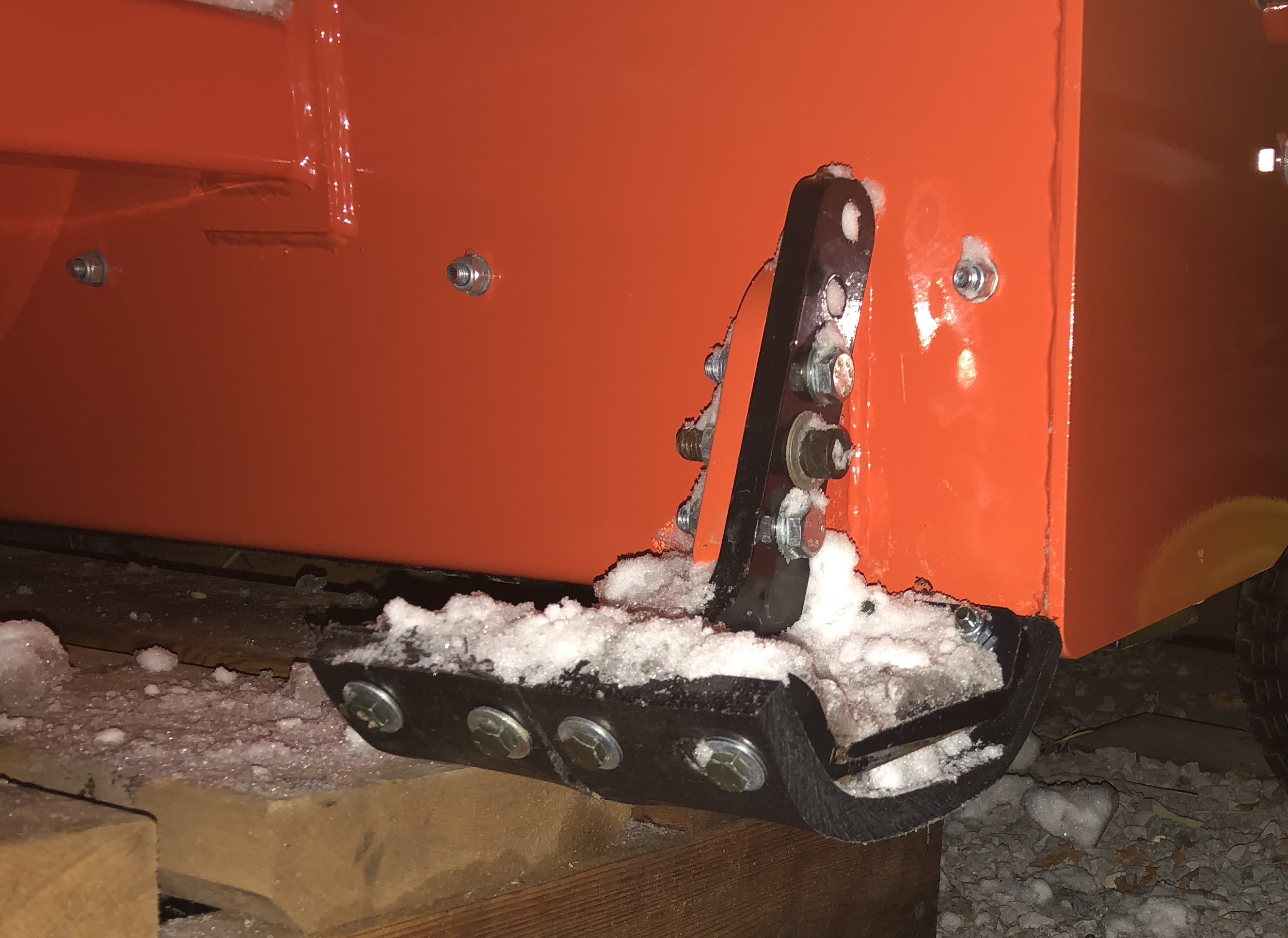

fullsizeoutput_3478.jpeg Woodmaxx new wider feet with my added 1/2" uhmw plastic added to bottom. Seems just right height for my imperfect paved / patched up driveway.
Thats funny you guys noticed that. It is actually an outdoor electrical enclosure box from home depot. I mounted it there so I had a cheap rugged box to hide a relay and electrical switch for my LED light bars I wired in. For the heck of it I wired a cigarette lighter in it too so I could power something if I needed to. Its next to the woodmaxx box I added recently.

We got 10 plus inches on Christmas and it stopped at 3pm. I adjusted the skid shoes down one position and the shave blade I’d now about 3/4 inch above grade. I like that, and it took care of the snow. It’s a good purchase, and am real happy with it.

2) Find some way of limiting the chute rotation like others have suggested.
