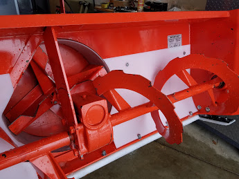

View attachment 538175. This is the newer double wide feet they just stared delivering.
I have these on my SB72 that shipped in November 2017. I wouldn't want skid shoes any smaller than this, but they seem to be a good compromise size. Not quite slick enough on gravel (before allowing a snowpack to form) but work great once there is a snowpack. I don't have any payment to report on how they might work on pavement.
