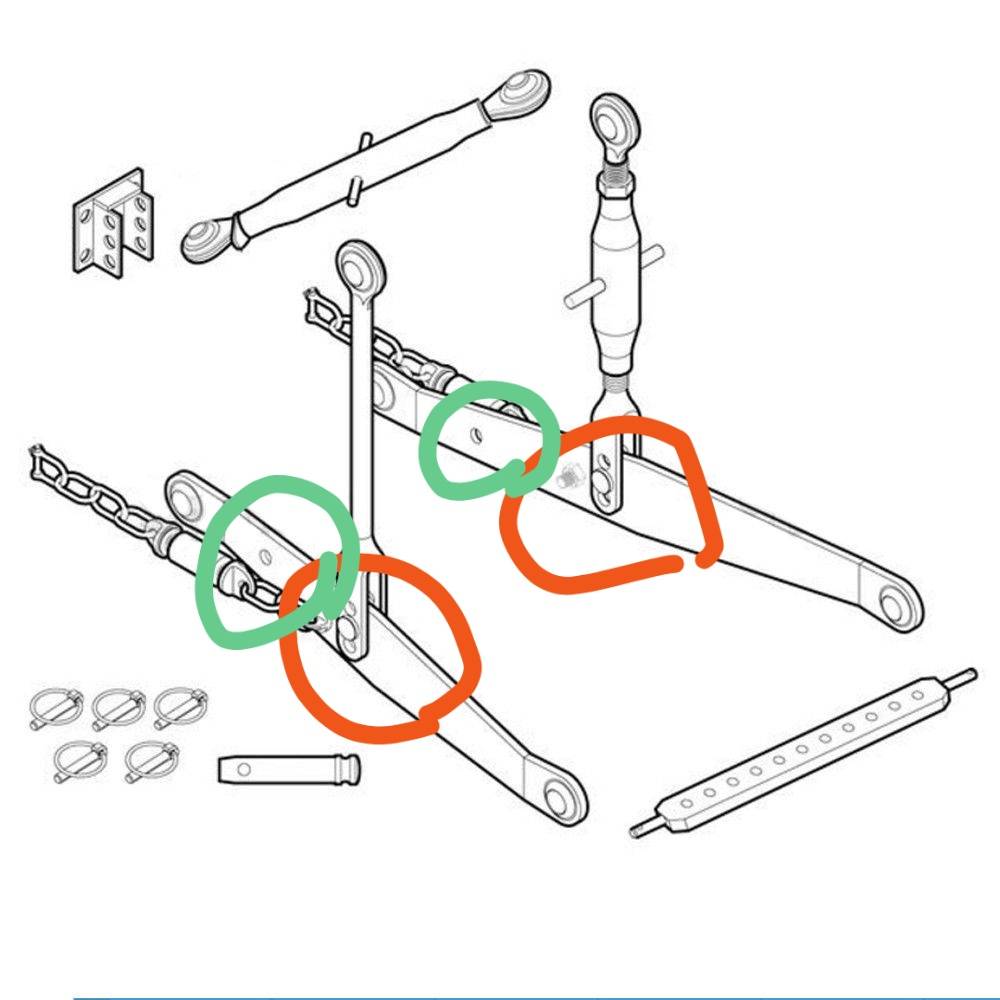

I may have to try that because what I just did does not work. I shortened the top link to make the blower level (inline with the tractor). The scraper blade is one inch off the floor and the feet don’t even touch the floor. In other words, the 3PH is positioned in its lowest dimension and the blower is still in the air. I even checked the drive line (disconnected it from the blower) and removed pins from the check chains. It will not touch the floor.
Do you have multiple places on the lower arms to connect your lift links to? Our Kubotas have that and in your case, I would move them to a lower hole in the lift link (red circle in the image below), or a hole in the lower link that is closer to the rear axle (green circle in the image below).

Aaron, The lower arms are attached at the orange circles, and I do have the holes indicated by green circles. So, I see where that would solve the problem. Thanks.

Make sure you don't have your 3point position stop set from the last time you brushhogged or something. The arms look really high in the picture if that is as low as it goes. I've done that before and cursed that I couldn't get an implement to unhook from the quick hitch before I slapped myself when seeing that I forgot to put it back to float/0.

I did check that on the 3PH lever and it was in float. The selector valve that regulates the speed of the 3PH was screwed in almost all the way to slow but that should not figure into it. I have nonetheless opened it all the way up. I’m sure somebody has the same arrangement of SB60 attached to a Kubota B2650.
