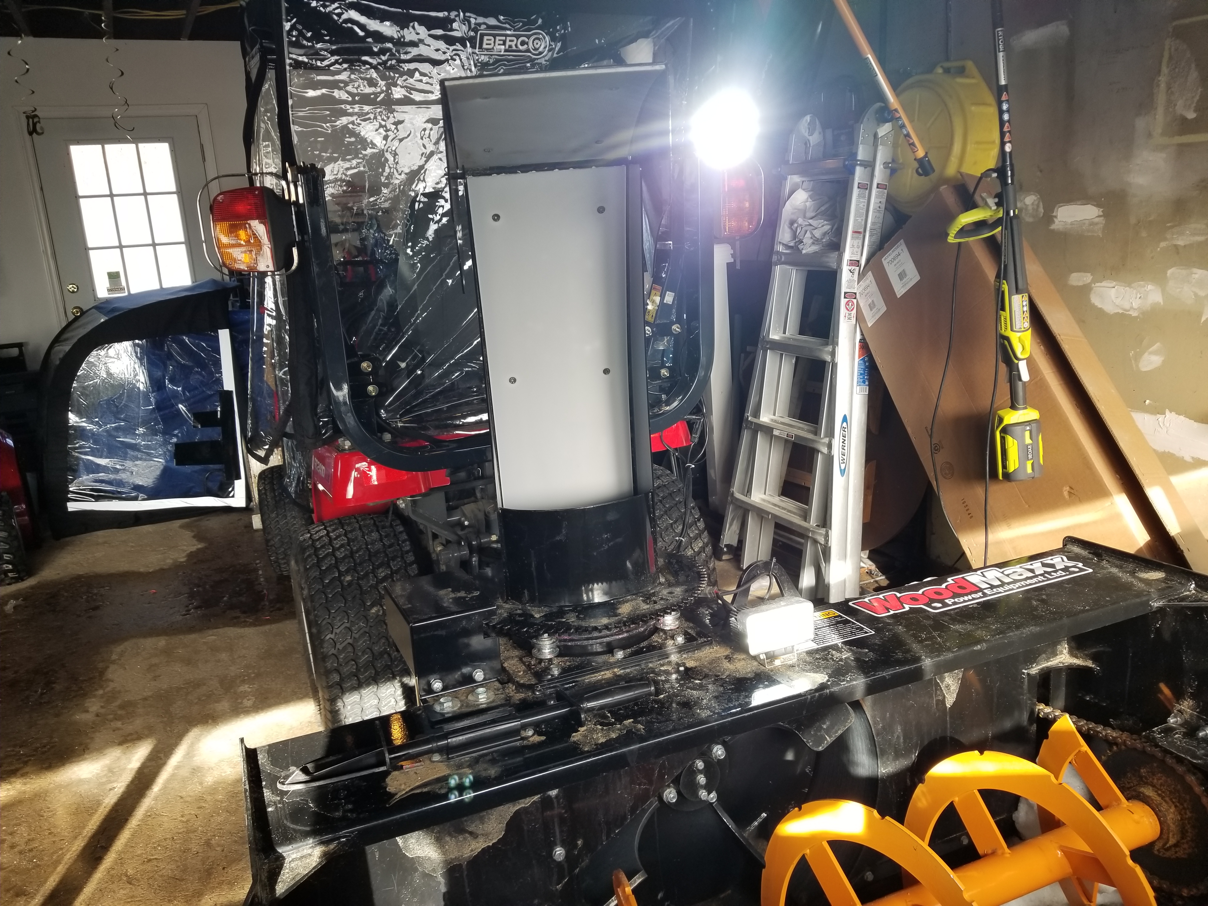

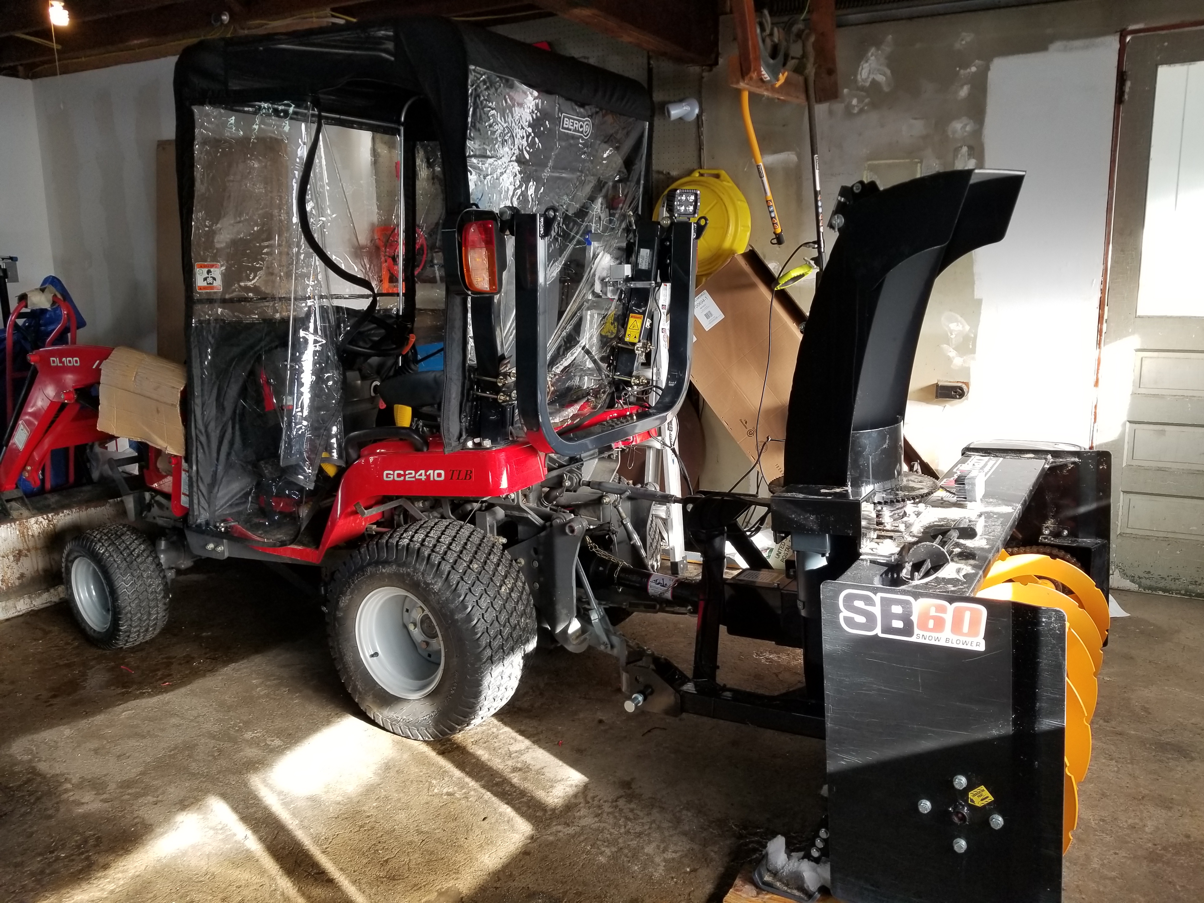

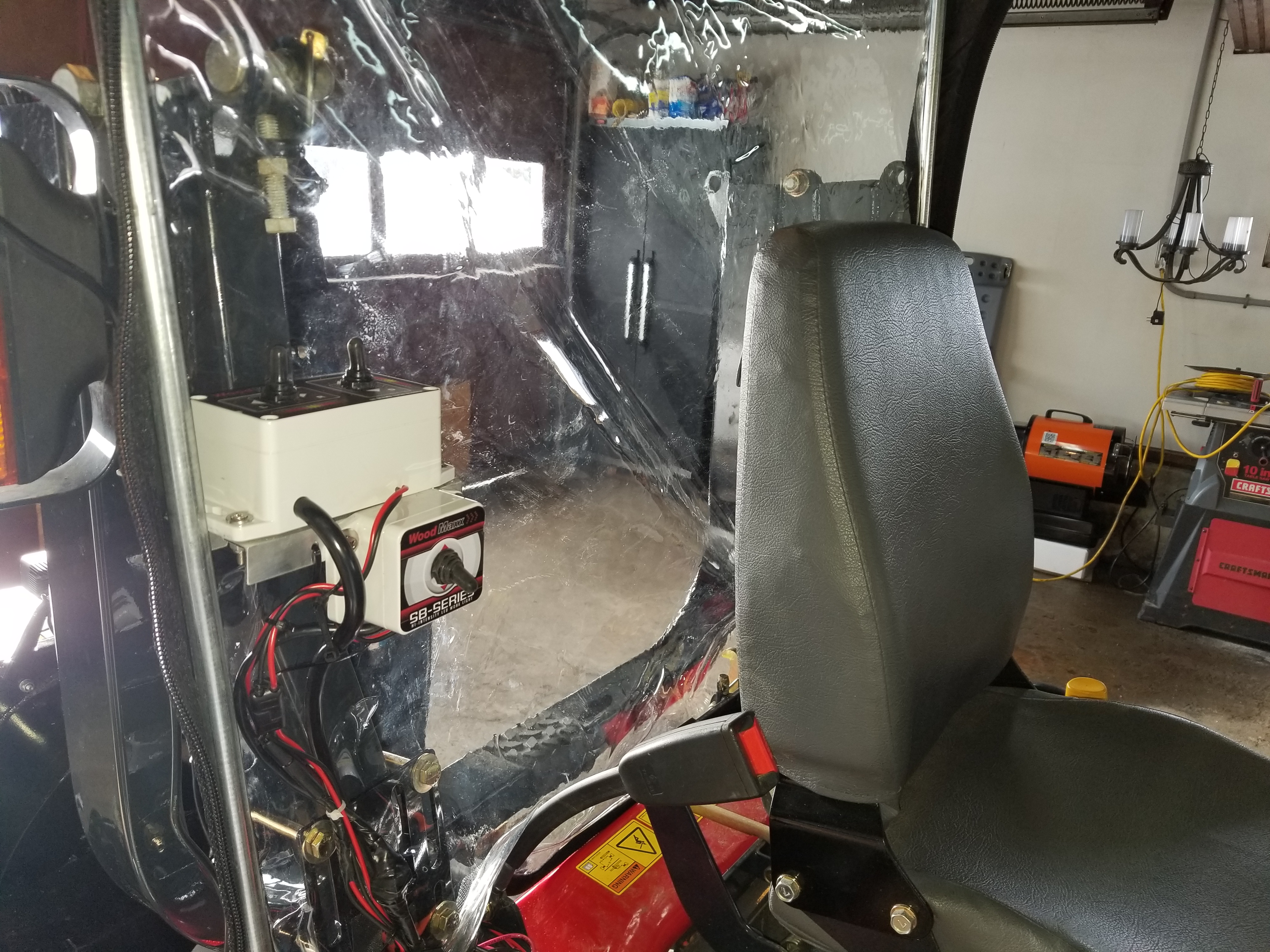

Just finished installing the cab and extra led light. Let me know if you see something wrong.
1515948116141.jpg1515948132861.jpg1515948147414.jpg1515948164647.jpg1515948186971.jpg

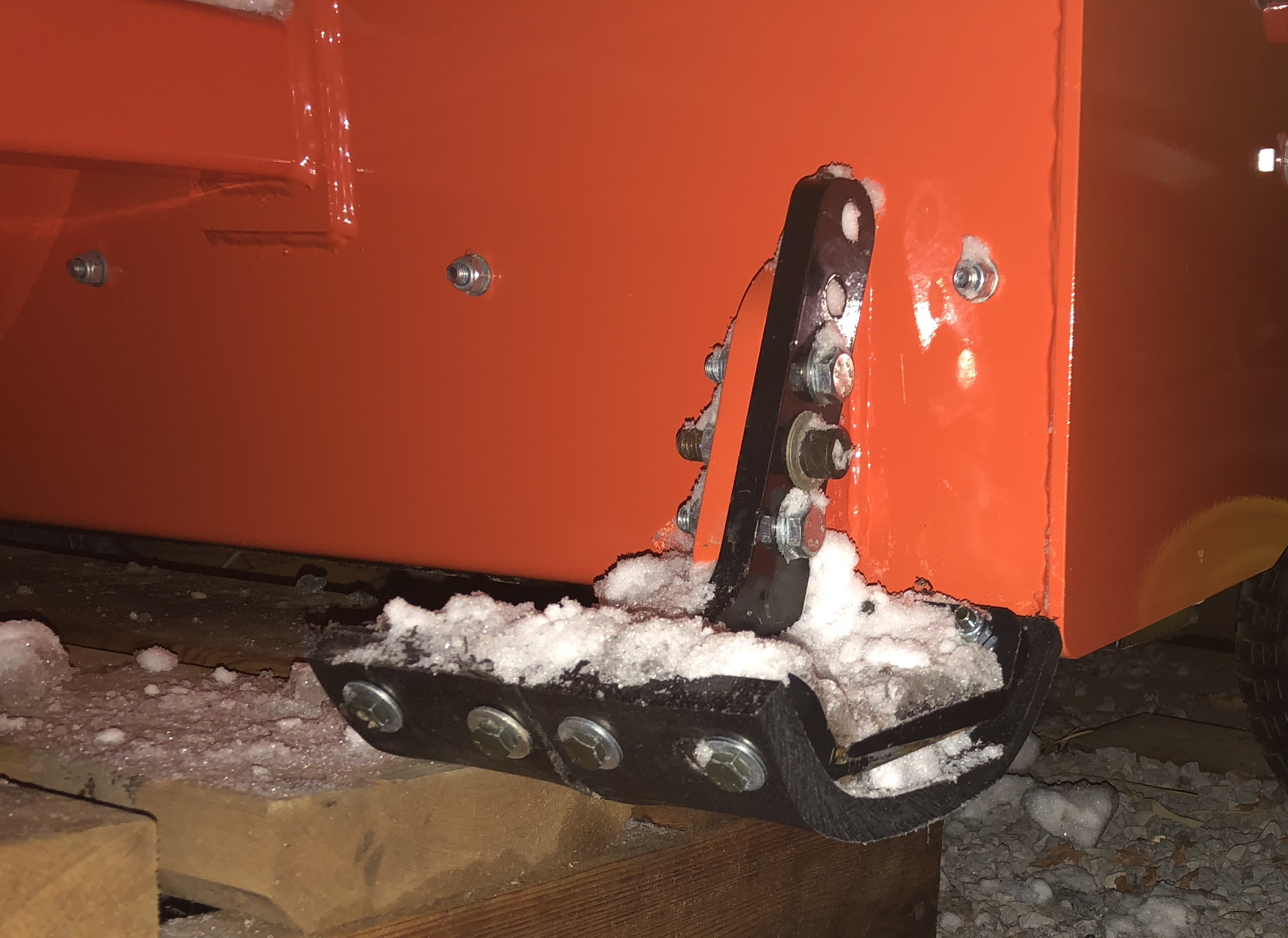

70E118A4-6238-4910-99E8-66D9EA587A6B.jpeg. This is the newer double wide feet they just stared delivering. Then I bolted on some 1/2 UHMW on the bottom of them and it worked well. Slides on pavement. When I get into my grass I lift the 3pt a few inches and off we go. Otherwise it would become a power rake.
