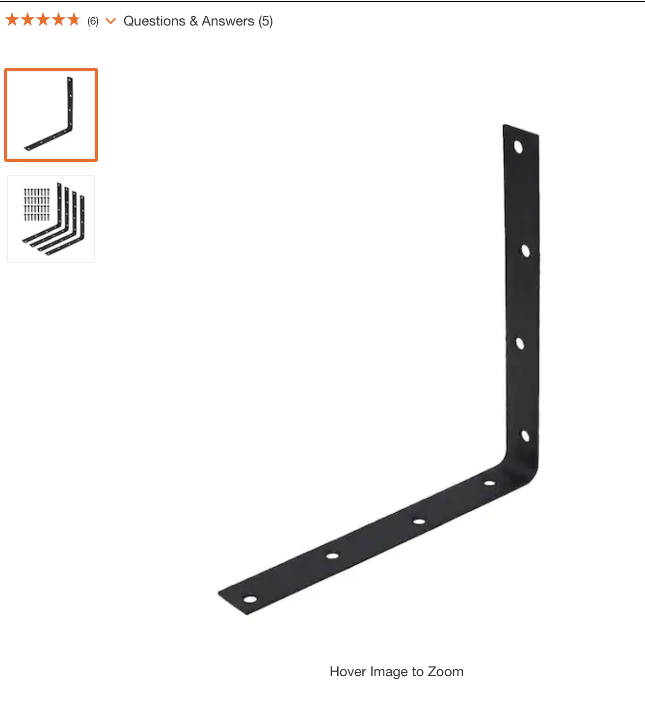

Hey seriously thank you guys. Especially the last three from DaBear3428, ddbackhoe and JPRambo. I am going to try one of these ideas. I especially like this eyelet idea.
So basically you are saying to add two eyebolts at each corner of the building on the under/inner side? Then place the largest washers I can find on the outside of the building, then crank a nut down so they can support the pressure?
So my main questions would be:
1.) What gauge cable should I be looking for?
2.) How do I tighten and crank the cable to pull the structure back?
3.) If you were me and doing this would you lift the building or no?
Regardless I am going to try to get as much out as possible, whatever I do I believe less weight will make it more persuadable.
I have never heard of these Simpsons Strongtie bracket connectors either. They seem like if I could get the structure back they would solve my issue, especially on all sides. The back side I am less worried about because it is only inches off the ground, it is touching the ground in some areas so more worried about rot. I guess doing it on all four sides can only strengthen it.
I used Simpson strong ties to mount the handrail posts when I rebuilt my deck a few years ago. It is a similar idea to the cable idea without the cable. A bracket is mounted to the joist and there is a bolt that goes through the bracket to the outside. As you tighten the nuts on the bolts everything is pulled together. I purchased the Strong ties at Home Depot. Check them out at Simpson Strong-Tie.
