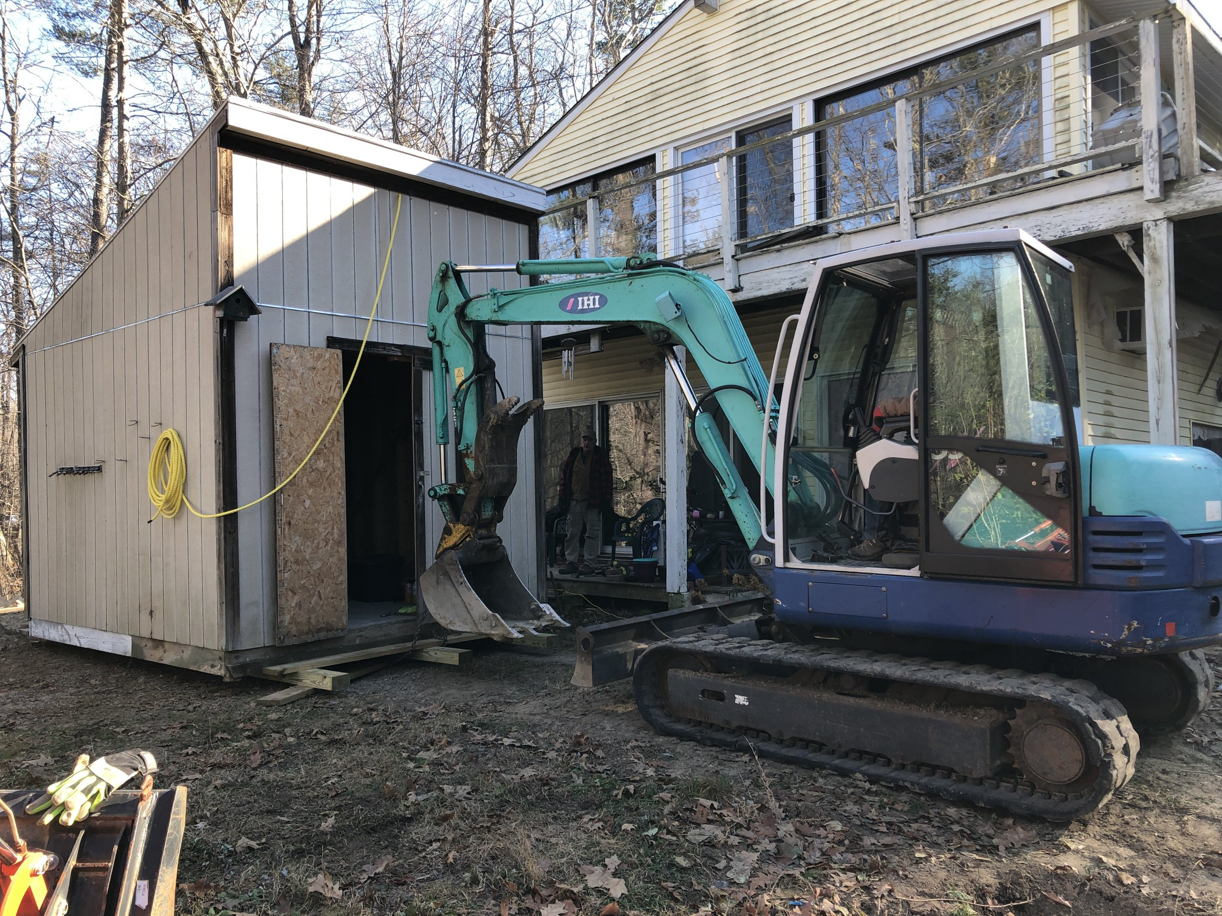

We moved a 10x12 shed recently. Moved everything out, jacked up each side with bottle jacks and/or automotive floor jack and slid 4x6x16 sliders under (on the flat and perpendicular to the floor joists, in about 6”-8” from each edge), also slid one under the middle for extra support.
We screw cleated a 2x8 board across the front and back of the 4x6’s to block the shed from shifting while being moved.
We then laid 2x8s on the ground across and under the 4x6s every 4-6’ to keep the 4x6 sliders from digging into the ground. We used a small 5 ton excavator to slide the shed about 125’ to it’s new location, jacked each corner up to level, blocked it and set it down leaving the 4x6 sliders as added support for future use.
The shed was easily moved with the small excavator. We did cut four small holes through the floor inside near each corner and ran chain down through and around the joists to hook to the excavator.
I’ve seen cables with turnbuckles strung diagonally from floor to roof to firm and reasonably true up old barn structures to add years of life. It seems like a cost effective method.
