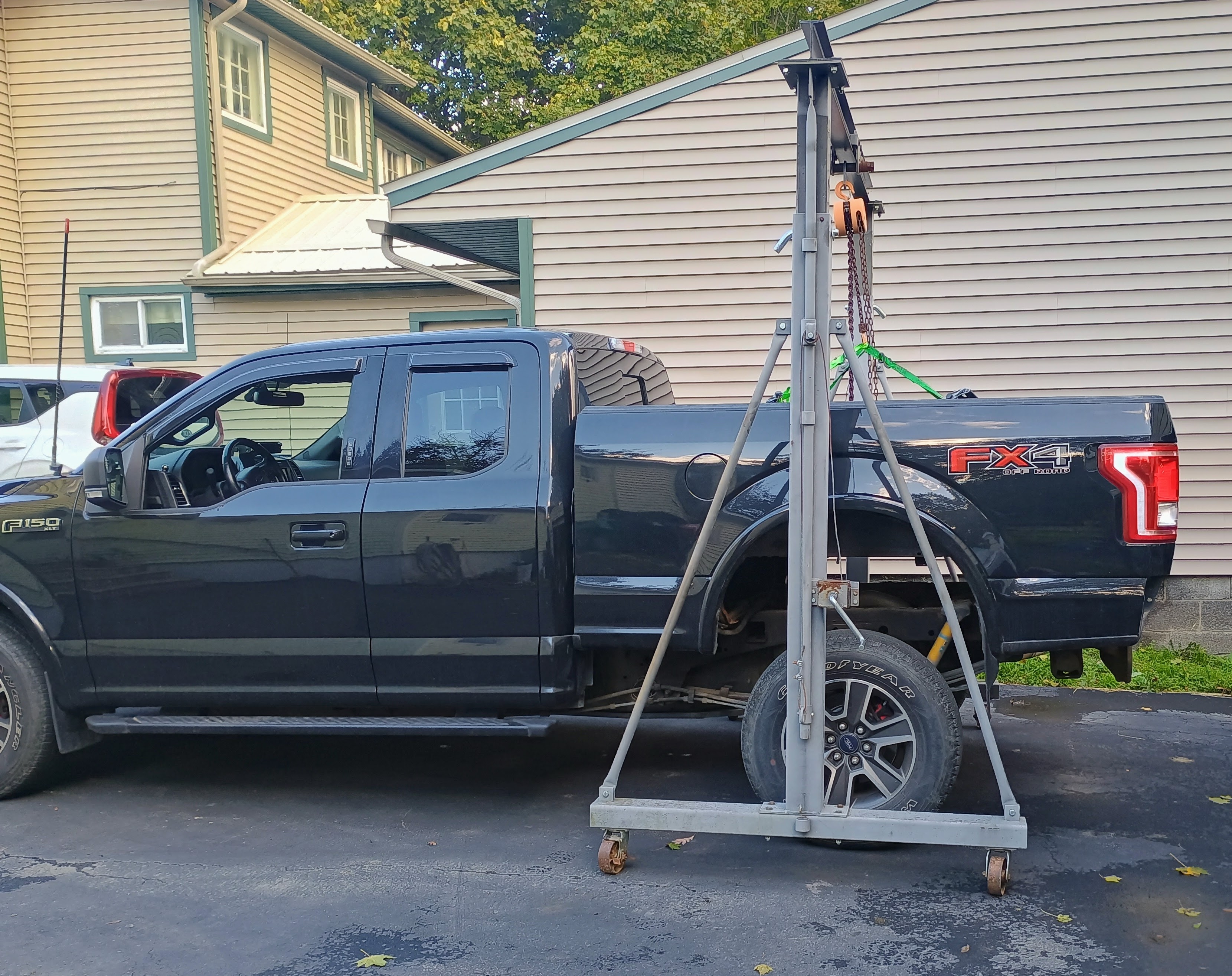

/ Pickup fuel pump replacement - lifting bed #18
