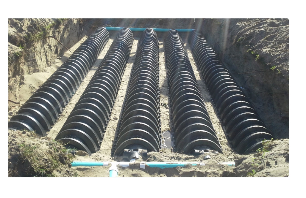

Well to answer my own question, it is not only possible.... I did it. Had the help of a New Holland FEL as well. Carefully researched my plans and went over them with the inspector with my county before I started.

Many jurisdictions only count sidewall surface area to achieve the square footage for a system. So a trench that is narrow is the least expensive. I used to argue with them about counting the ends when I was designing them.

CONGRATS!
Looks great.
Can you give us a rough estimate of the man hours it took?

Digging the hole took a full day with two tractors at time or 1 tractor and a man on the laser level. Day two was putting in the 6" of gravel and then laser leveling the pipe. Also on day two the pipe was covered with 2" of gravel with tractors riding on 2x12 lumber. Got it all the way to being ready for inspection on day two leaving just the header uncovered.
It took about another 6 hours with two tractors to carefully backfill using heaving 3/4 plywood with 2x12's on top of that to backfill. Had one tractor running on the lumber in the pit and another dumping dirt in from the side.
Not counted in all of this was the time to add a effluent filter at the tank outlet, fine grading with rakes, and dealing with buying all the pipe and doing engineering drawings of the layout.
/ Dig septic bed with front end loader #71
Heck, I could have done that in a couple of months :)
Looks like a job well done.
Thanks for the numbers.
By your description that might figure up to about 3 plus full days for 2 people and 2 tractors.

That's about right. Keep in mind that the digging here was easy. Almost 100% sand except for a tree stump that had to be removed.
