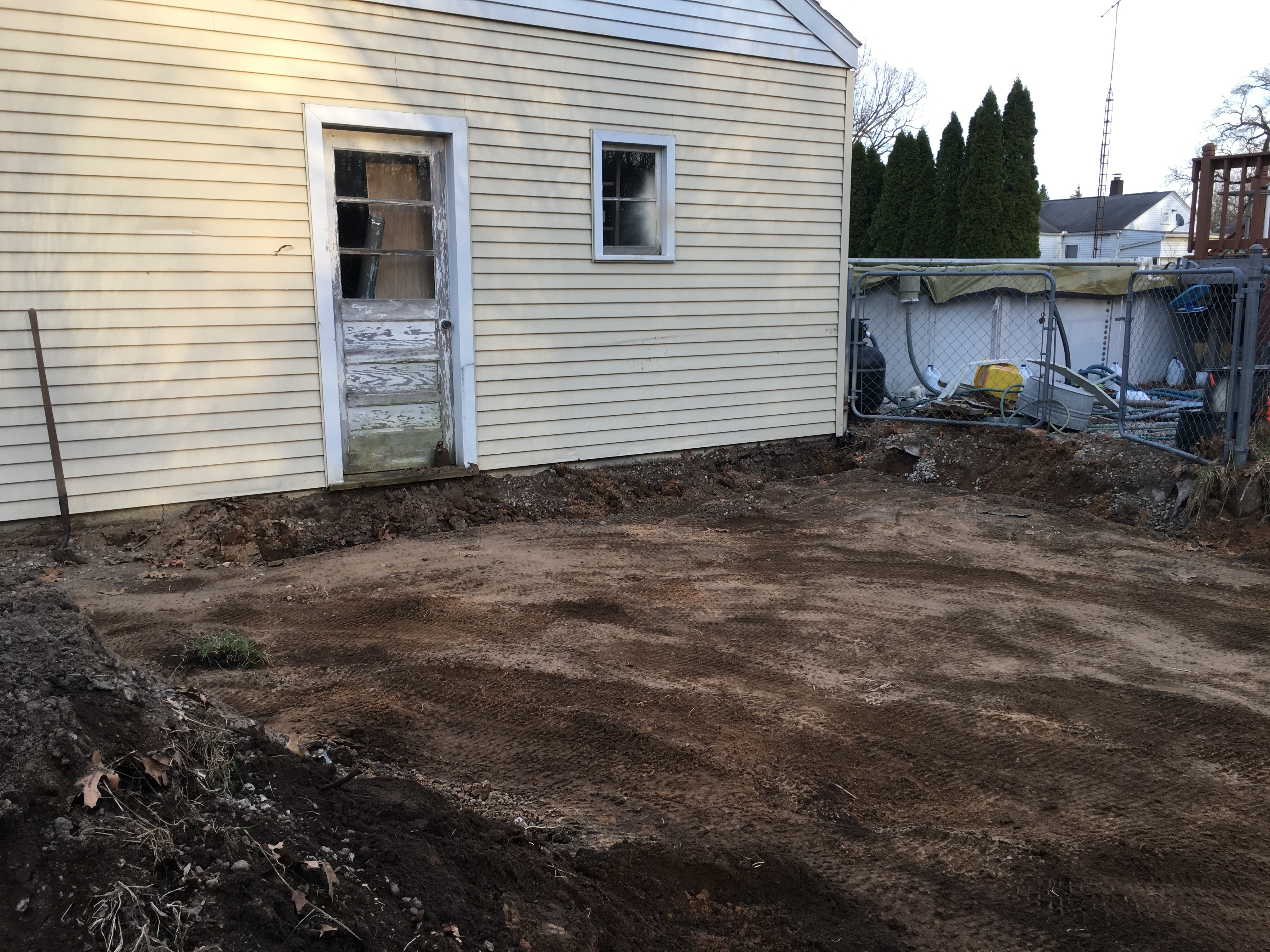

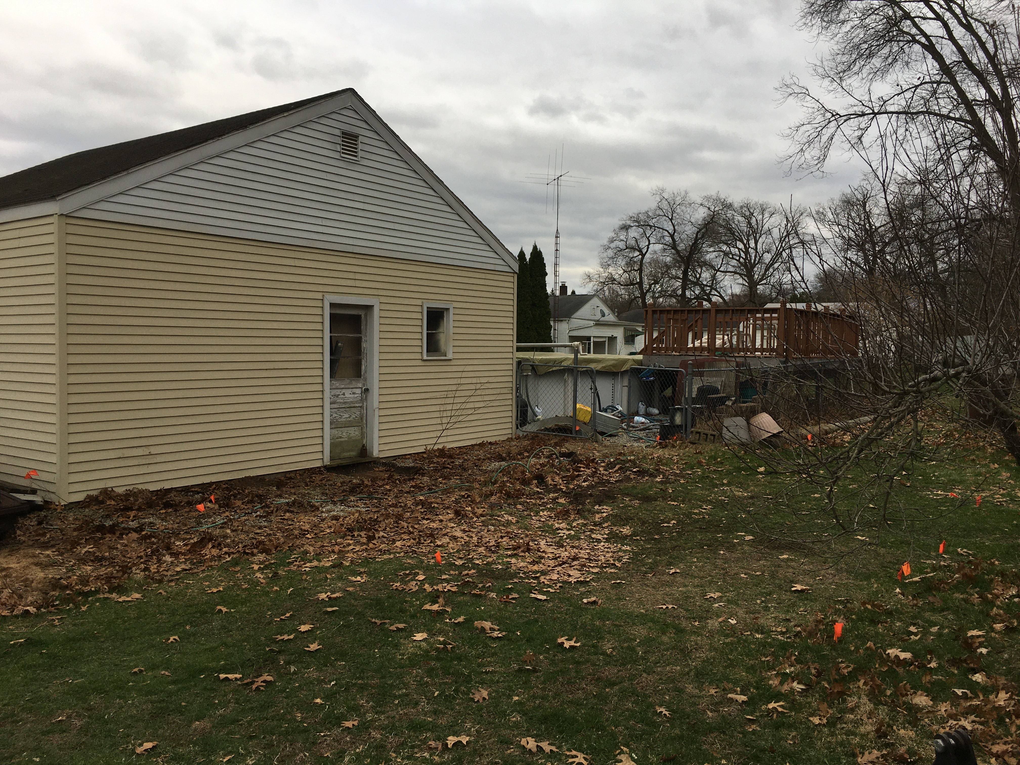

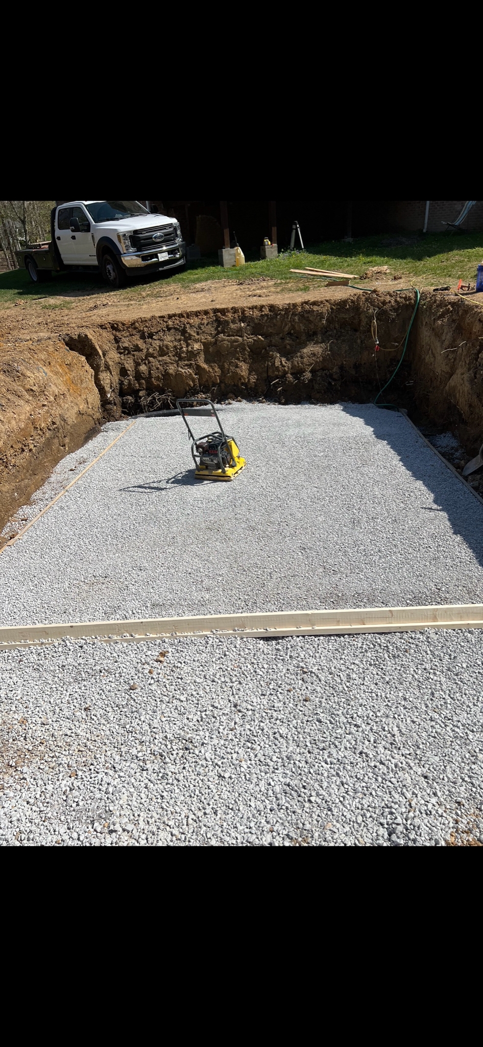

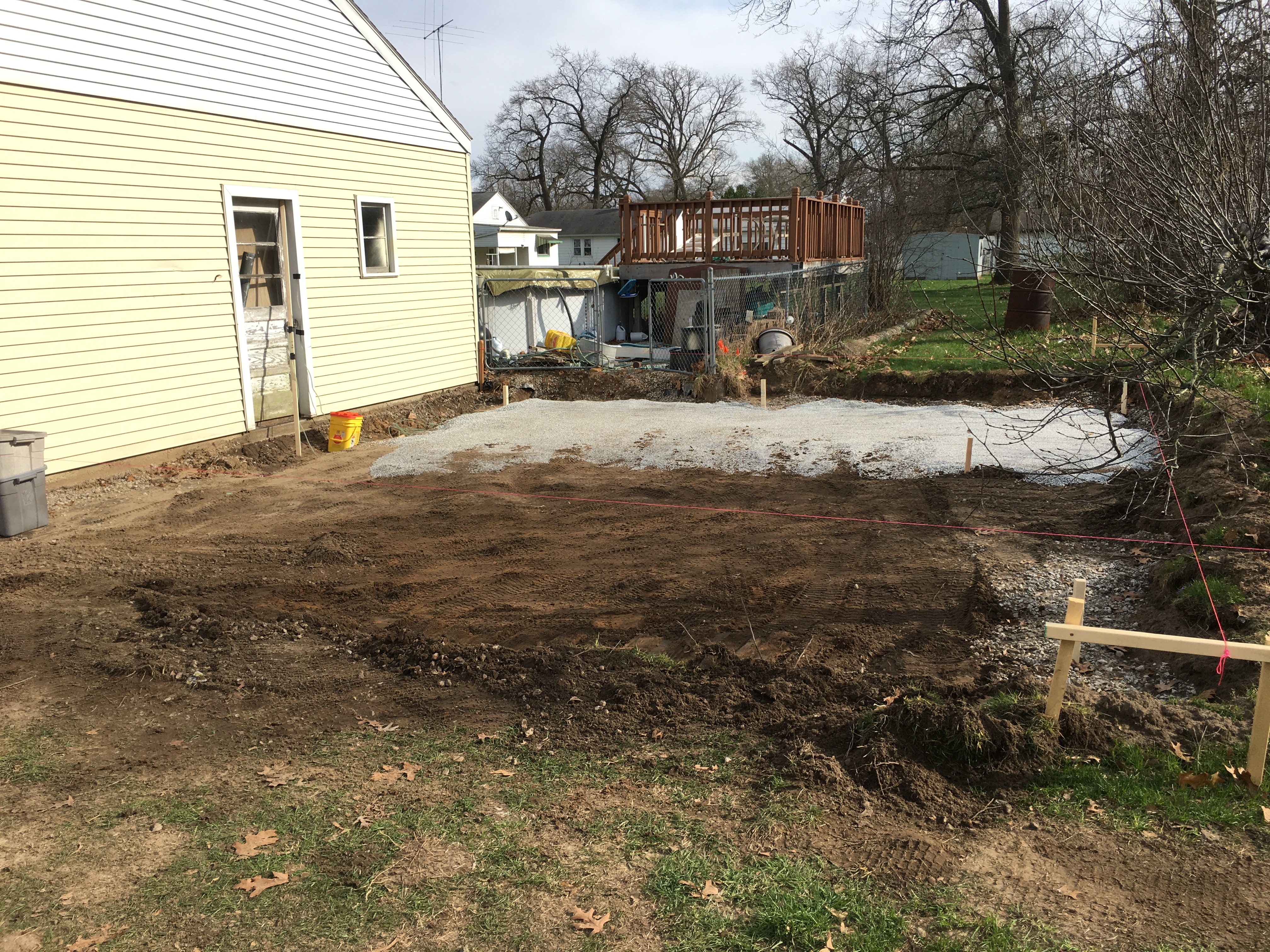

Given that I'm digging a bed and not a trench I tend to agree. My sandy dirt is easy digging. Only difficulty is keeping things level with a FEL. Once the tractor is tilted, so is the loader.
Dig the ramp down to the final level first. ;)
With that said, I also live on sand and would have no problem doing what you're doing with my FEL. I dug out a 24x24 pad for a garage addition about a foot deep in an afternoon with my little PT425.
(click to enlarge)
Last photo shows water level on stick I used to set grade lines on 2x2 stakes to set limestone base depth and start of spreading.
Good luck with your decision process.
Don't discount an excavator. They are designed to dig. ;)
