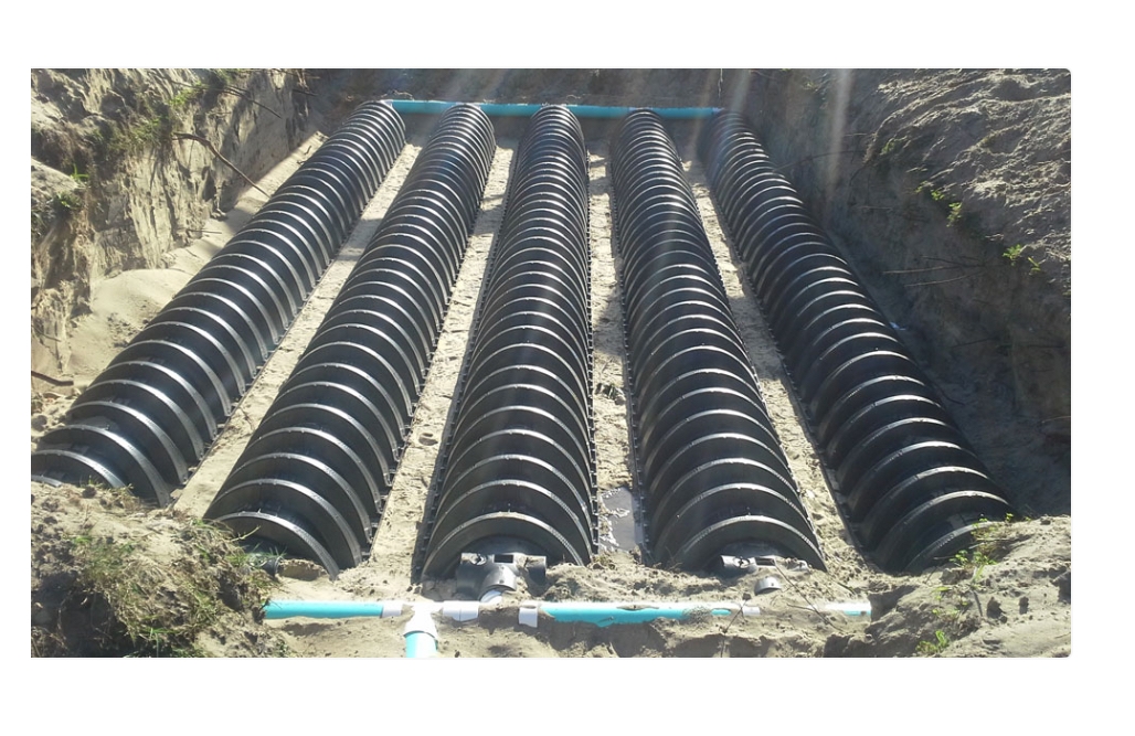

Im not sure what you mean by septic beds. If your referring to infiltrator beds, there popular up my way. My system is like the one pictured, its 29 years strong. It was covered using large excavator. We dont drive over it with anything larger than lawn mower.View attachment 3534353
See my earlier post. My Infiltrator system was only 12 years old, used seasonally, and was almost completely filled with sand.

Scrap the pipe and stone bed system. Install an “Infiltrator” drainage dome system. Installation is simple, no truck loads of stone and should be on a smaller footprint.
The post above yours he said he had that system and it failed.

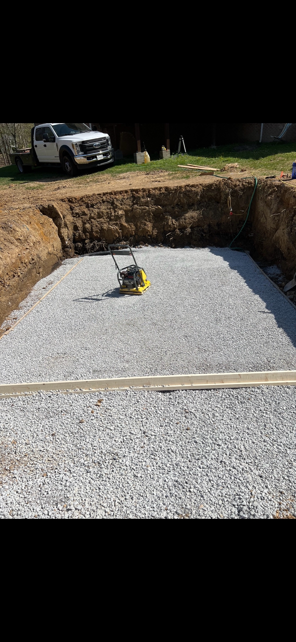

Hello, I am faced with digging a rectangular septic bed with size of 14' x 40'. Inspector requires open bed as opposed to trenches. All I have is a Kubota 2650 with FEL. Not sure a backhoe (at least ones without a lot of size) would be of much help anyway with a bed.
I do have a box blade with scarifiers to loosen up the top soil and grass.
The soil is pure sand. Anyone tackle such a project with a FEL? I know I will need a ramp to get down the desired depth. I don't know how long the ramp will need to be. I'm really stressed about keeping this level with a FEL. I suppose I could use the box blade to help with that.
Getting the rocks and the backfill in around the pipes is another story!
There are so many videos on YouTube on doing this with trenches but I can't find any with an open bed design.
I would treat it as a simple trench. Drag dirt with the blade past the end of the bed and when the spoils pile up too much to drive over, use the FEL to move the spoils out of the way. Lots of passes needed, but you'd be able to keep the bottom plane flat and tidy. you didn't divulge the important dimension (the depth) but your spoils pile will probably get pretty large. Unless you have a lot of time to invest, I would instead get a local guy with a medium to heavy skidsteer. He'd have it done in a few hours and it wouldn't cost all that much

Reading the thread, my only comment is, quit trying to be cheap and have a professional do it. You lack the equipment to do it and if it's sand like you say, the more you remove to get to depth, the more the it will fall in.
All you will accomplish is beating up your tractor and burn a bunch of diesel fuel.
Some tasks are better left to people with the right equipment and experience.

Infiltrator systems have their tricks like anything else. Infiltrators are usually better. Sounds like his was an installation failure, not an infiltrator failure.

That's what I'm replacing. I would never recommend that junk to my worst enemy. Mine are only 12 years old, only used seasonally, and are almost entirely filled with sand.
In order to do chambers so they won't fail, I would recommend stainless steel chicken wire underneath to prevent burrowing animals from messing with them (don't think this was my problem), and geo fabric over the top to prevent sand infiltration (maybe that's why they call them infiltrators, lol), from the top. If you are going to do all of that, just use the old school pipe and rocks and get something that will last!
About 20 years ago I installed my own septic system. Where I live, Island County WA, standard gravity septic systems had to be of the infiltrator type when I installed my system. I check my system now and then by looking into inspection pipes that stick out of the infiltrators. The inside looks the same as it did when I first installed the system. The dirt inside the chambers is undisturbed.I can't imagine how sand or dirt could get through the infiltrators. As I recall the infiltrators are just these plastic clam shell things with some perforations. I don't remember putting any sort of filter cloth over the infiltrators, but I may have. Do you know if there is something I should be looking out for to prevent the problem you had? When I installed my system I had never even sat on a backhoe and had to learn how to dig a flat and level ditch. I asked the guy who installed my first septic system for advice and he told me to get a 10 foot length of ditch flat and level and then use that as a reference for the next 10 feet and so on. I used a laser level on a tripod and a rake with the handle marked every 1/2 inch with a line drawn with a Sharpie. I would just get the laser to shine on the rake handle and I would use a rake and shovel to take down the high spots. I was not allowed to add material to make the ditches flat and level.
