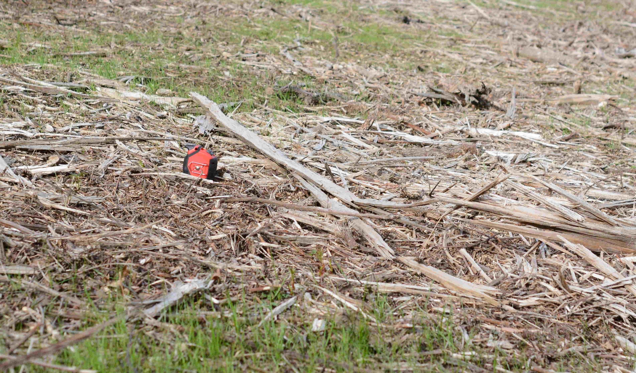

Do you have a photo of the forestry mulch with something to size it for us?

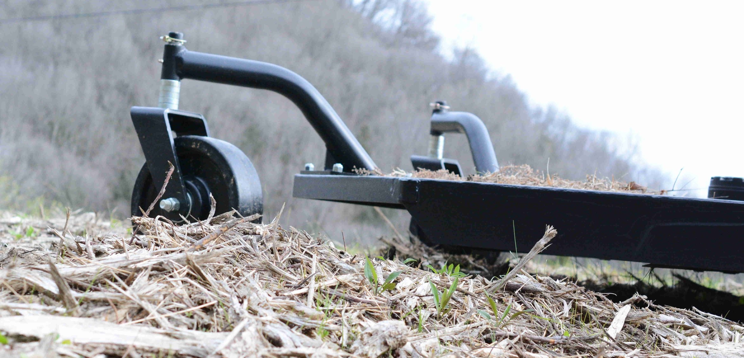

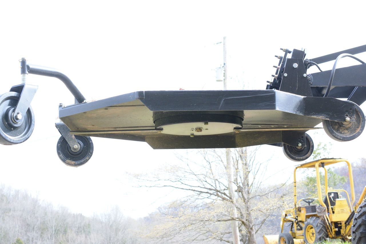

Couple of pictures showing some of the chunks on the hillside and the depth of the mulch relative to the cutting blade. The body of the tape measure is 3.5" tall.
I raised and tilted the deck as far as it would go in both directions. The problem is the discharge area is directed towards the operator if I drop the deck down to cutting height, but attempt to raise it to clear obstacles.
The blade tips are pretty close to the edge of the deck. Any discharge chute would have to clear the blade tips and not contact the lift arms when the deck is raised. The edge of the deck already hits the lift arms when the deck is raised and tilted backwards.
For those interested, I've included a picture of the underside of the deck. IMO, this is a light duty brush cutter. My J-Bars have thicker blades and bolts.

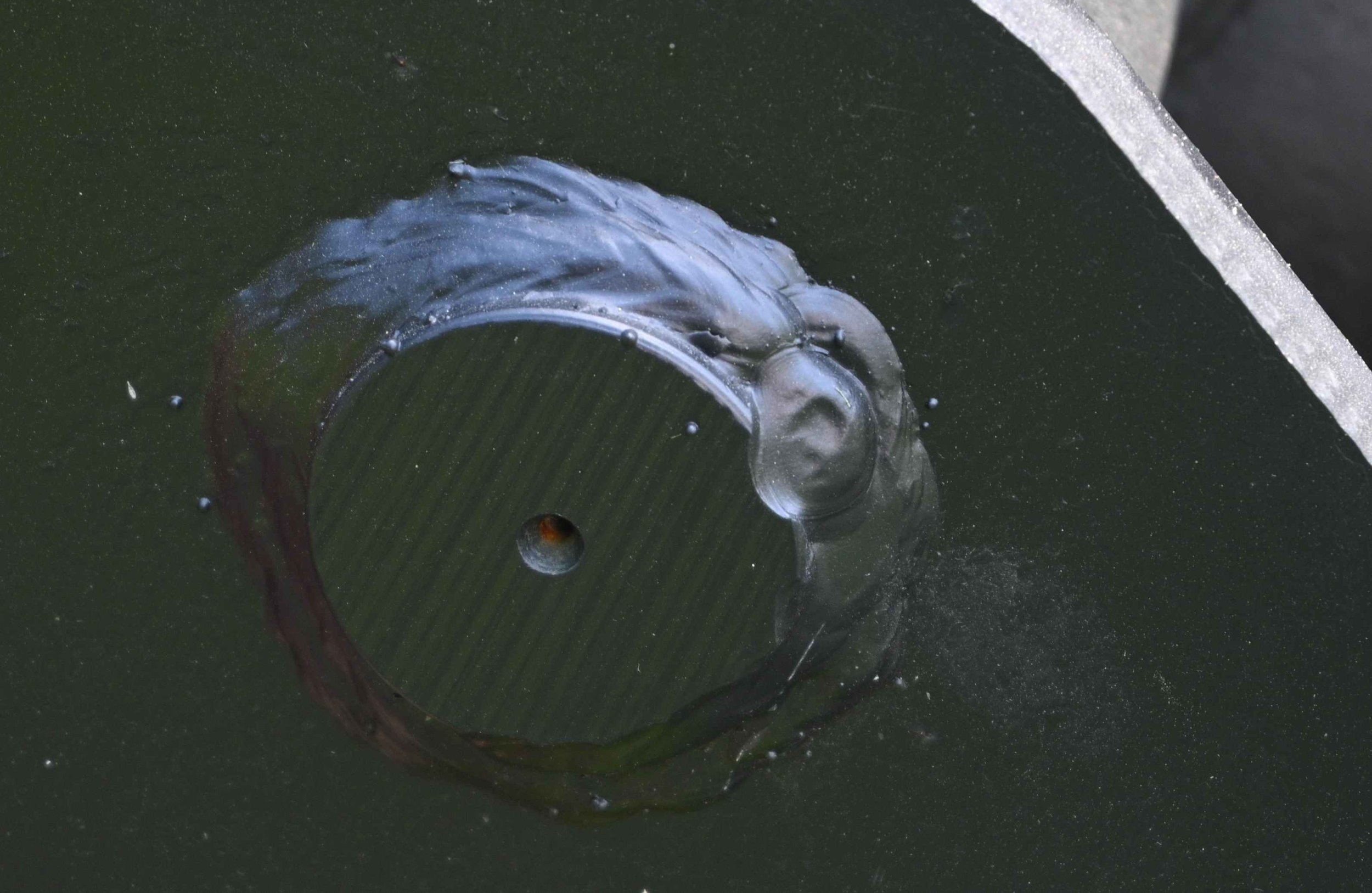

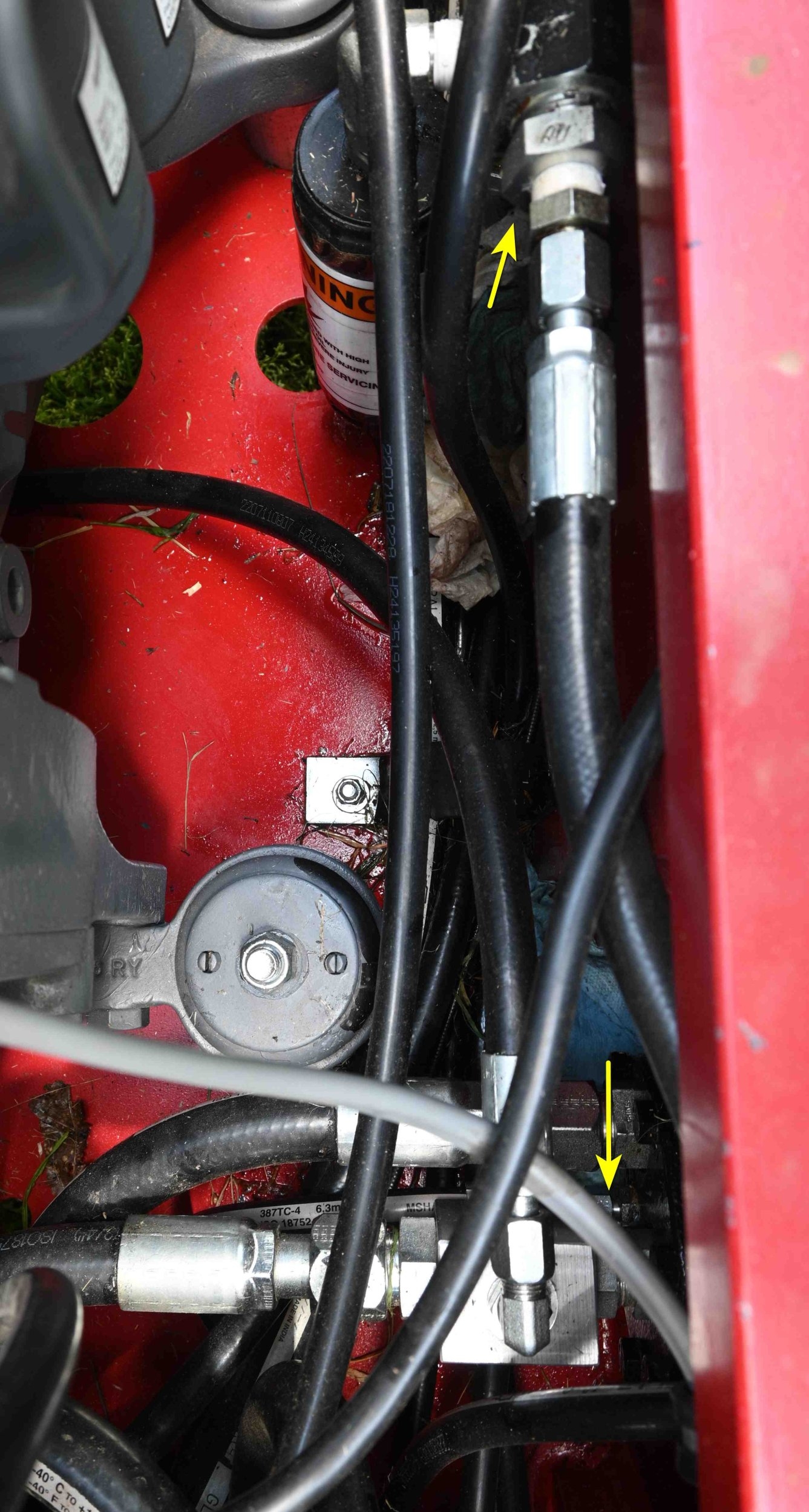

I called Terry a week ago to talk about the delay in moving after start up, but haven't heard back. In the meantime, now I am seeing oil on the rim of one of the rear wheels which I am guessing may be a leak in the wheel motor at 8 hours?

I would check to see where the oil is coming from to the best of your abilities. I would use the bucket to lift the front end, put enough support(s) under the front axle frame area to support the tractor safely, and then take the wheel off. It may be the hydraulic hose on the outboard end of the motor. At the moment, I can't recall if it is a drain or brake hose, but I think it is the brake. If your brakes aren't working (well), a loose / leaking fitting there might also explain the slow to move issue.
I would call Terry Estep again, and keep calling until you get through to him. He is often out in the workshop and warehouse, but not all day.

The rain held me up from further investigating until today when I removed the left rear tire to look for the oil leak.
It looks like the worst leak is from the smaller hose fitting on the back of the wheel motor plus another leak from the bottom hose on the box (brake?) on the frame. The oil seemed to be leaking through one of the holes under that box and then running back to the wheel area where it dripped onto the wheel rim. My 1445 is usually parked on a slope in a shed where an oil leak would tend to do that.
I tightened the fittings and tried to make some pictures, but then the rain started again. Had to put the machine up for now.
Haven't called Terry back until I have a better understanding of what is actually going on.
9.2 hours on the 1445 so far.
Thanks for the update. Small leaks are one reason why I try to keep the hydraulic hoses and fittings really clean at all times. It makes finding a leak quicker, and it keeps the leaks smaller, at least for me. If you have done so already, I would go around tightening every fitting about now. The ones on the steering mechanism are a pain to get to, but if they leak, it tends to get everywhere under the dash/console area.

Dismayed to see the same or worse oil leaks after tightening the loose hydraulic hose to the wheel motor and attempting to tighten one of the smaller hoses under the assembly beside it on the frame. Is this the auto brake? I noticed that the PT will roll backward on an incline if I take my foot off the treadle pedal.
Still having the delay in movement after first start up.

If you raise the engine "hood", and then stand in front of the dipstick, you should see a gizmo bolted to the tub wall, with several hoses going in and out of it, a large (3") diameter metal tube (the brake accumulator), and towards the back end, a large spring. Chock your tractor so it can't move, preferably with the bucket edge straight into the ground. When you start the tractor with the hood open, does the spring move? When you flip the brake switch off, how long does it take for the spring to move? If you watch the spring, with the brakes off, does it periodically go in and out?
Do you have photos of the particular hose end(s) that are leaking for you? Have you tried jacking the PT up, removing the wheel, getting everything clean and running it briefly? Can you see exactly where the oil is leaking? If it is the brake line, did you clean that end getting it super clean and then remove it to check for dirt on the flare surface, or a cracked flare end? (I have had that happen to me once.)
