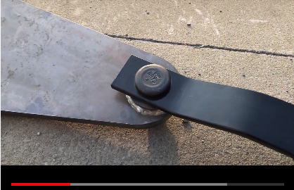

I have the PT1445 brush cutter.
I always check the bolts and grease the bushings every six hours or so after I lost a bolt or two. Personally, I haven't sheared a bolt (yet), though after other folks experiences, I do stock the bolts and bushings. The bushings tended to wear out in my usage as I cut when the soil is dry, and I think that the grit gets in the bushing and causes wear, which is why I check and grease the bushings/bolts frequently. The checks and grease have basically stopped the wear for me.
Do I wish the blades were bent in more of an offset "Z" so the bolts aren't the lowest point? Sure, but I recognize that would make the blades more expensive and the mower heavier as the perimeter would have to be deeper. I repair my blades myself now with a welder, adding material back in around the bushing and to the blade edges. I also weigh the blades after sharpening to make sure they are close in weight.
The mower is very effective, and in my use will take out 3-4" saplings, and a few back and forth passes tends to chop up the remaining pieces. I don't mow near buildings with it due to flying rocks and branches. I do wear a logging helmet with face shield when mowing, just in case.

I have had a couple blades come off when the bolt head broke. The didn't go too far. I was more mad that I lost the bushing. I ended up buying a length of DOM tubing the correct ID and OD and made my own bushings. I think I made 12-14 of them over 10 years ago. I still have 3-4 left, last I looked.

Actually, yes, grade 8 bolts. I haven't broken one in the last 14 years. I also use washers large enough to cover the bushing in my quest to keep dust/grit out.
From McMaster-Carr, the links should work.​
1​
4 Each​
SAE 863 Bronze Sleeve Bearing for 5/8" Shaft Diameter, 1" OD, 1/2" Length​
$2.75​
$11.00​
2​
2 Packs​
Grade 8 Alloy Steel Hex Flange Cap Screw 5/8"-11 Thread, 2-1/4" Length, Fully Threaded, Packs of 5​
$5.24​
$10.48​
3​
2 Packs​
Plain Steel Extra-Thick Flat Washer 5/8" Screw Size, 1-1/4" OD, .24"-.26" Thick, Packs of 5​
$8.17$16.34
(2010 prices...) I would double check newer mowers to make sure the bolt sizes are correct.
I have a pair of steel saw horses that make it easy for me to raise the mower and put the deck on them (in the line of travel for the tractor, so if something catastrophic happens, the other will provide support). An air impact wrench makes it easy to get the blades on and off; I don't have to try and wedge the rotor. It takes very little time to remove the bolt/bushing with blade, a bit more to grind the edge on the blade (if needed), wipe the old grease off, add fresh grease to all surfaces and reassemble. Five minutes or less per blade. The only welding that I have done lately is on the leading edge of the blade to replace worn material.
I haven't bought blades since 2010 either... So down from four blades in the first three years to zero blades in the last fourteen.
I did at one point spend some time looking for a bolt with an internal grease path, but in the end, I convinced myself a) it would be weaker, and b) it would need something like a grub screw to seal it while mowing which would be unlikely to last. The greased grade 8 bolts and sintered bushings system seems to work for me, but I don't mow every day or every week.
(And thanks to @MossRoad for the hitch idea; I bought one, and while I don't use it very often, it is the bees knees for parking trailers in tight spaces!)
