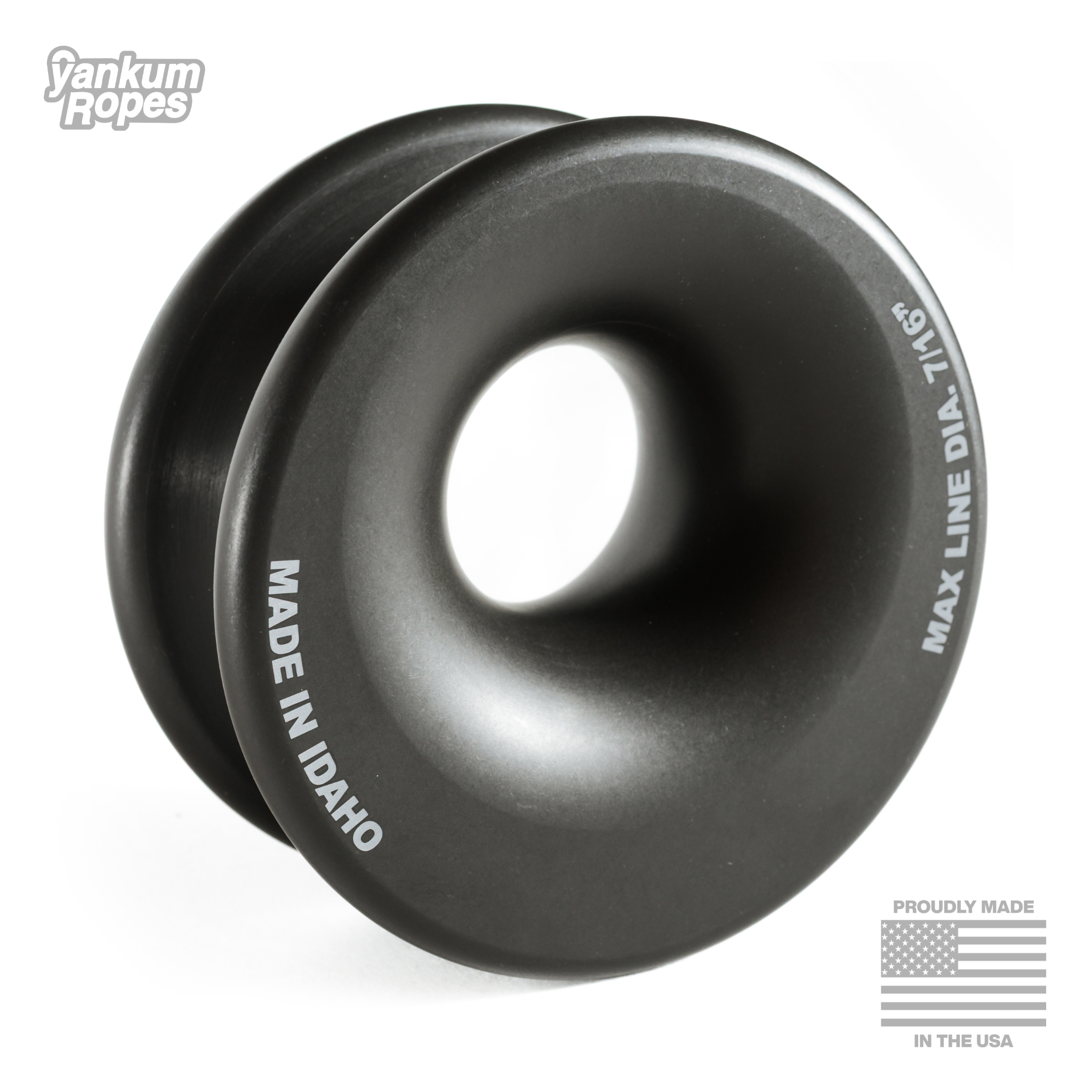

The great thing about capstan winches is that you can get long rope(s), and use snatch blocks. Have a look at some of the rope rollers and snatch blocks that Yankum ropes sell. Not cheap, but quick ways to change the angle of pull, and if needed multiply your pulling power. There are some nice forestry capstan winches that are specifically designed to be anchored to tree trunks, and are, I think, really useful for pulling over trees, and use in trees.
I think that UHMWPE have really transformed winching; I just wouldn't let them be abraded by ground contact. They are so much safer than wire rope or chains.
