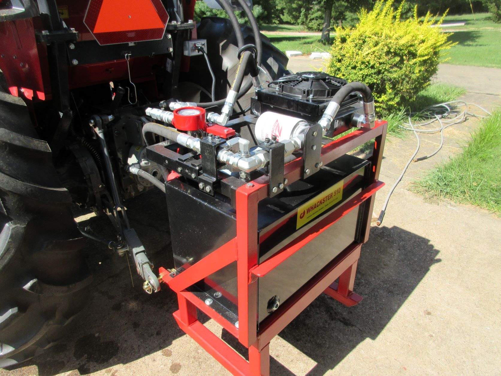

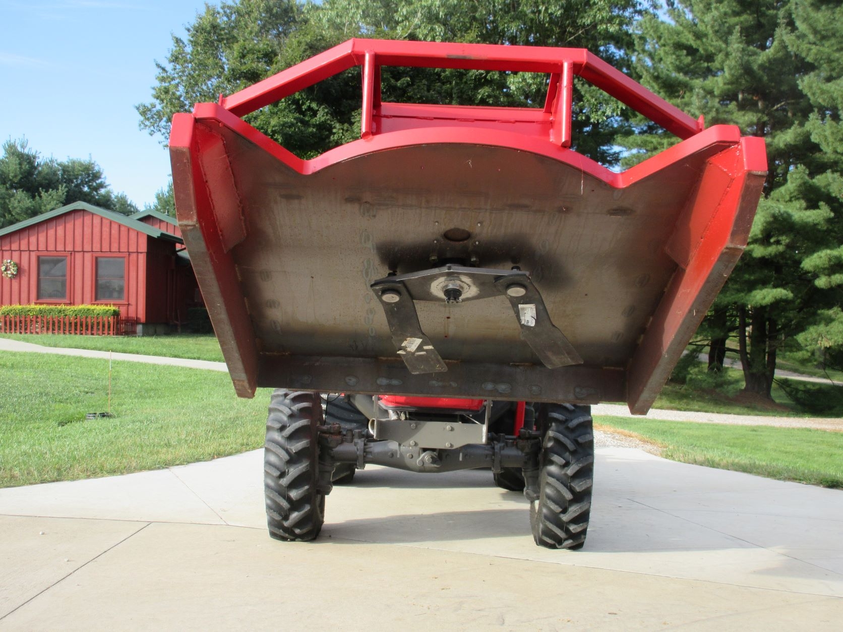

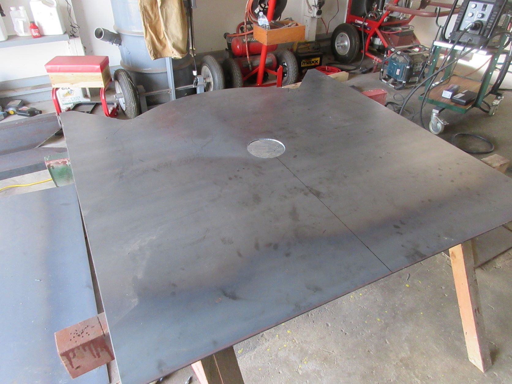

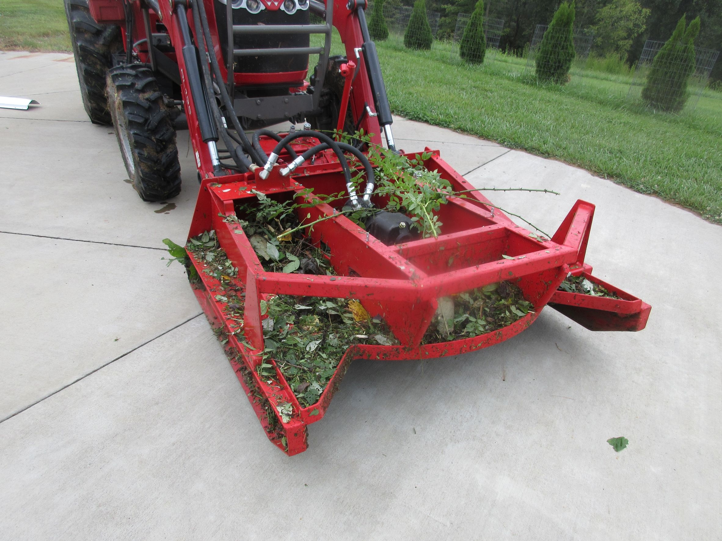

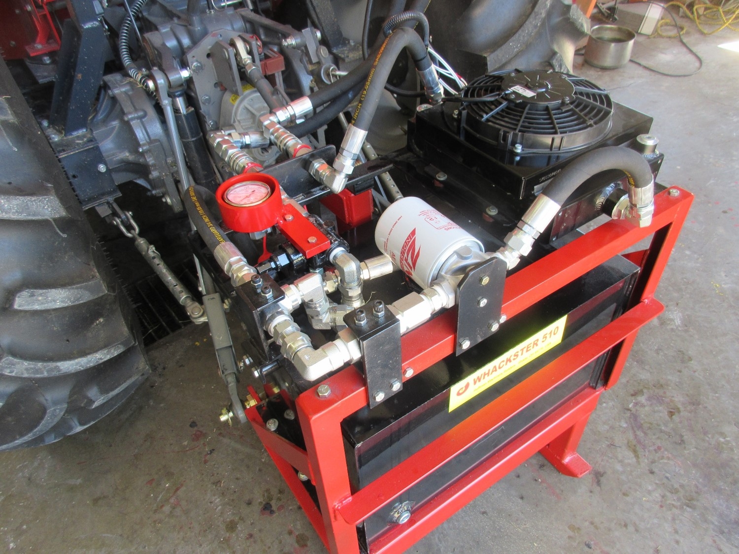

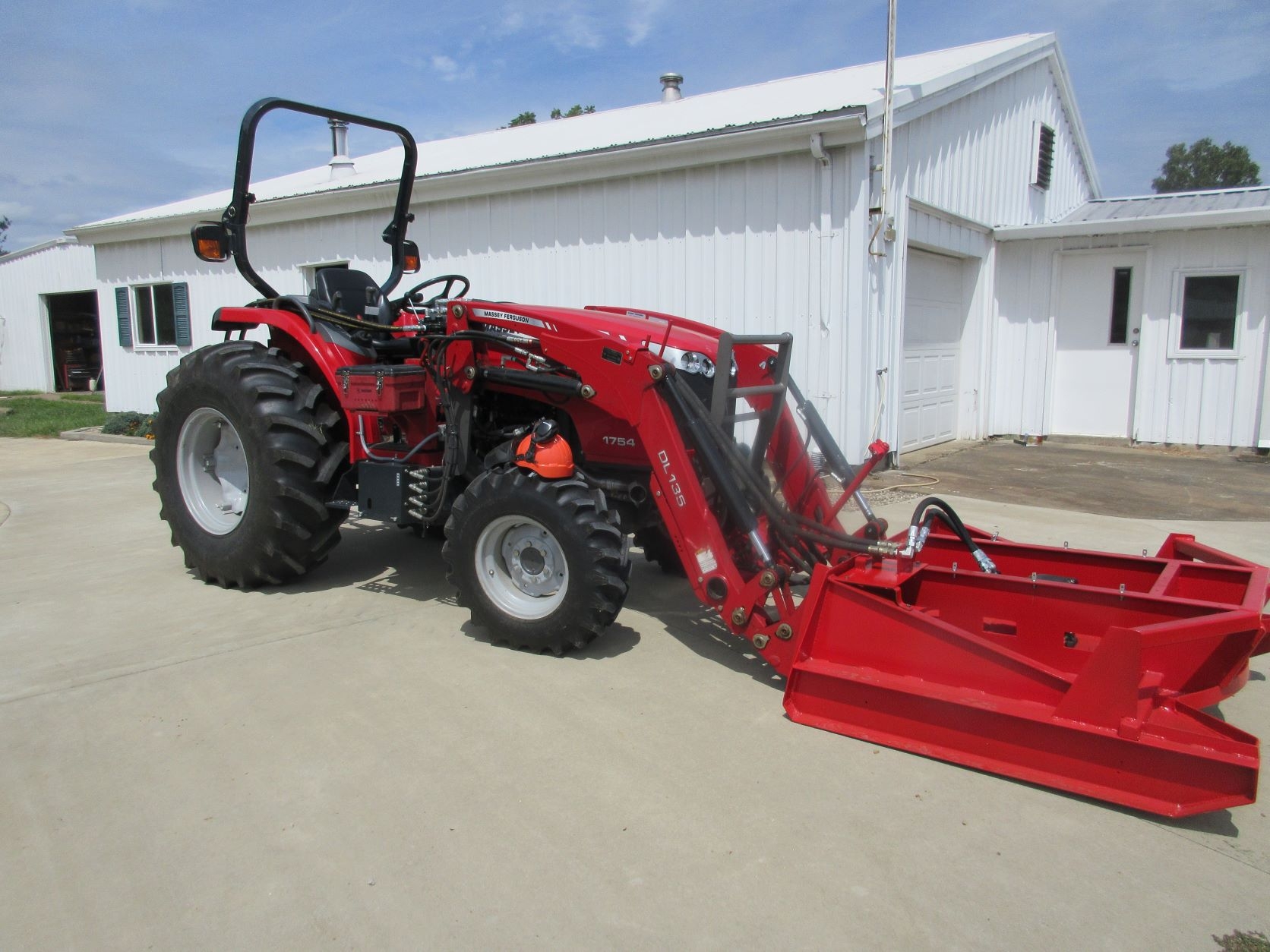

A few pictures of the skid-steer-mount hydraulic brush cutter that I built for use with my Massey Ferguson 1754. It is adequately powered by the 3-point mounted hydraulic power unit with a Prince pump driven by the tractor PTO. I also built this attachment, and the reservoir holds 20 gallons (should be bigger) and there is an oil cooler on the unit. I'll admit the tractor is just a bit light for this application, but the WHACKSTER, a name I have given it, has performed incredibly well so long as the tractor centerline stays approximately perpendicular to banks or hillsides being attacked. In addition to taking down small saplings and heavy brush, it has been very useful in mowing banks by backing out with the front loader valve in float position. The blades are double-sided and can operate in either rotation.

That looks really well designed and built. Thanks for posting the pics.
Very nice. The Wackster looks mean. Great job on the pump setup, why more fluid capacity though?

Thanks. The capacity or flow is adequate, but a bigger reservoir would allow the system to run cooler. The 12-volt fan-powered oil cooler can't keep up with the heat load. I just keep an eye on the oil temperature the old-fashioned way by placing my hand on the hoses, an easy reach while running.

Do you think you'll add some hose protection? Brush wrecked a gearbox seal on my regular old cutter backing into a pile of vines last fall.

Not to ruin your day but reservoirs transmit very little heat vs a bigger heat exchanger. Adding cooling fins to reservoir will help but that also requires air movement to work. I would suggest taking an infrared heat gun and check various points in your circuit to see if possibly one area is creating more heat than others. I have had hose ends not drilled the right diameter or not drilled clear through. Fittings same thing, etc.

One way to reduce heat build up is to eliminate all of those 90 degree fittings. They generate a surprising amount of heat.
Here's a good read on it.

Yes, the original hose guard/motor cover could not be installed due to hose interference. A new design is in process. I agree that guards are necessary.

Thanks, an excellent article. The very nature of a setup like this, a front-mounted motor powered by a rear-mounted pump involves way too many fittings, some of which are 90 degree and include a number of sets of quick-connect couplers. All of these contribute to pressure drop which translates to heat and I agree, it adds up. As both the cutter and the power unit are attachments or temporarily connected devices, the use of quick connects are unavoidable and the routing of heavy hydraulic hose that must be unrestricted in movement required some 90s.

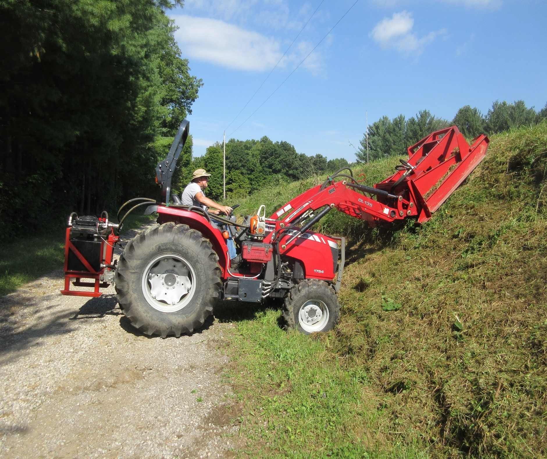

Thanks. A project like this has its unique problems as the power unit and the cutter are both attachments and must be capable of being disconnected. I chose to have a set of hoses that connect the control valve to the power unit remain on the tractor while the lines for cutter stay with the cutter. Other issues involve packing so many components in a designated space and allowing for freedom of movement for the heavy hoses. Correctly, a commenter lamented my use of 90 degree fittings as each fitting creates a pressure drop which translates to heat. i chose to use one-inch hydraulic hose which is not very flexible and the use of 90-degree fittings often becomes unavoidable. It has been several years since I built this and it has worked extremely well with zero problems. I would be pleased to answer any questions and I do not claim qualified engineering expertise--I just read the performance tables like everybody else does. Keep in mind a rotary cutter takes a lot of power and the Prince pump is rated at 21 GPM.

Looking at commercially built equipment such as the Quick Attach 3-point power units, they all use a 25- gallon reservoir and the Tiger boom mower with a 50" cut has a 42-gallon reservoir. Comparatively, my 20-gallon tank is undersized. Right, heat dissipation by a steel tank cannot hold a candle to a good oil cooler, which again I have undersized. Consider that in cold weather, this unit runs at a "normal" temperature which means there must be some useful dissipation going on. I once placed my hand on the township boom mower tank and it was really hot. I'm just a conservative old geezer that worries about hot oil. I will definitely take a heat gun with me next time I use this thing and take a look out of curiosity. Thanks for the comment.

A few add-ons since the WHACKSTER was built. It was always difficult to bend over and lower the cast iron pump in position while simultaneously attempting to slide or force it onto the splined shaft and in very tight quarters. The Rube Goldberg winch arrangement makes the job a whole lot easier as I am 82 years old. It also provides a means of storing the pump and the disconnected return line at an elevation above the reservoir to prevent draining.
The other improvement is the fabrication of the bolt-on rear skids which make backing up a lot easier and smoother. Operating the cutter backwards has proven to be an efficient approach to finely mulch trees and vegetation after being knocked down. The capability to "climb" on top of brush or attack vegetation at varying angles is certainly a positive feature of a loader-mounted cutter.

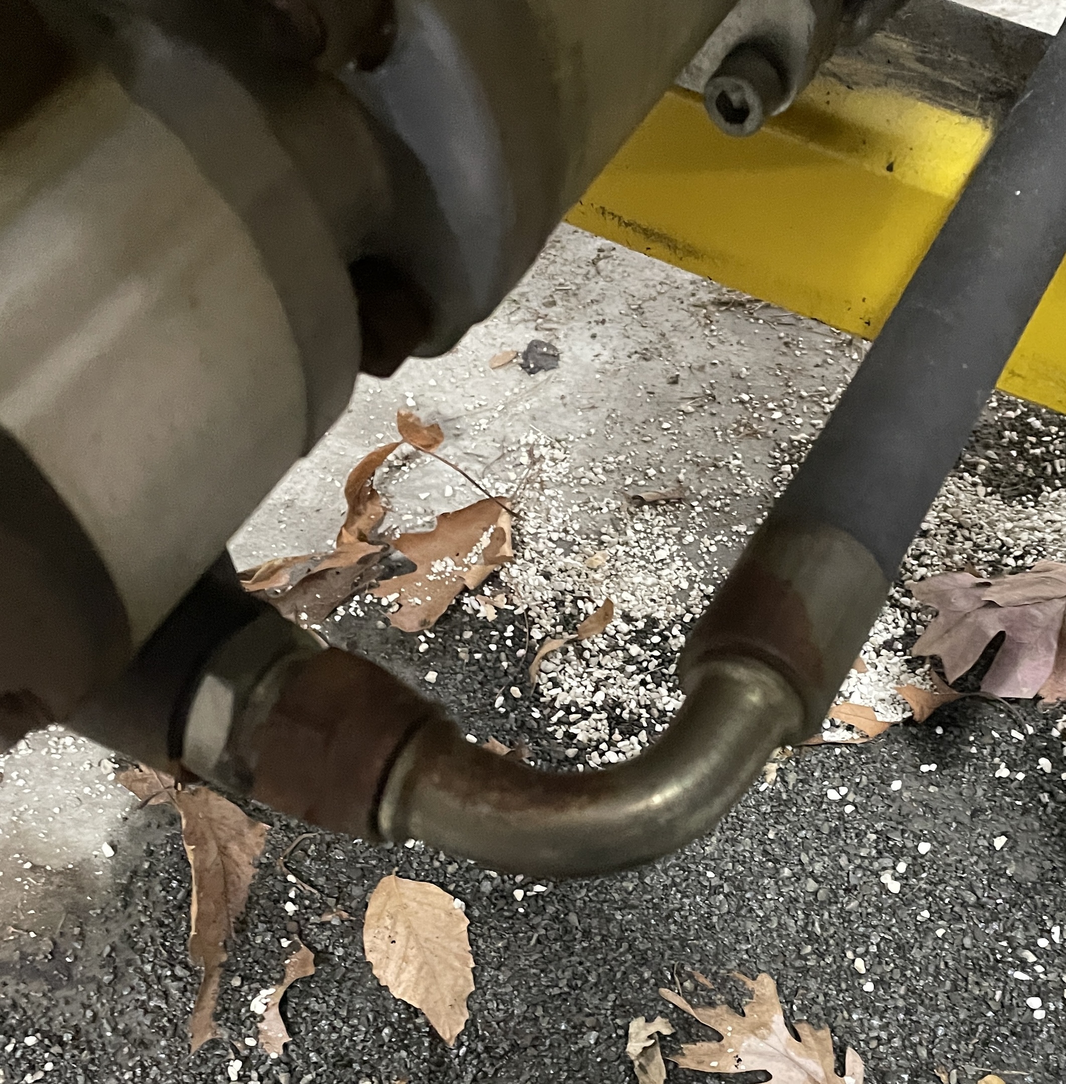

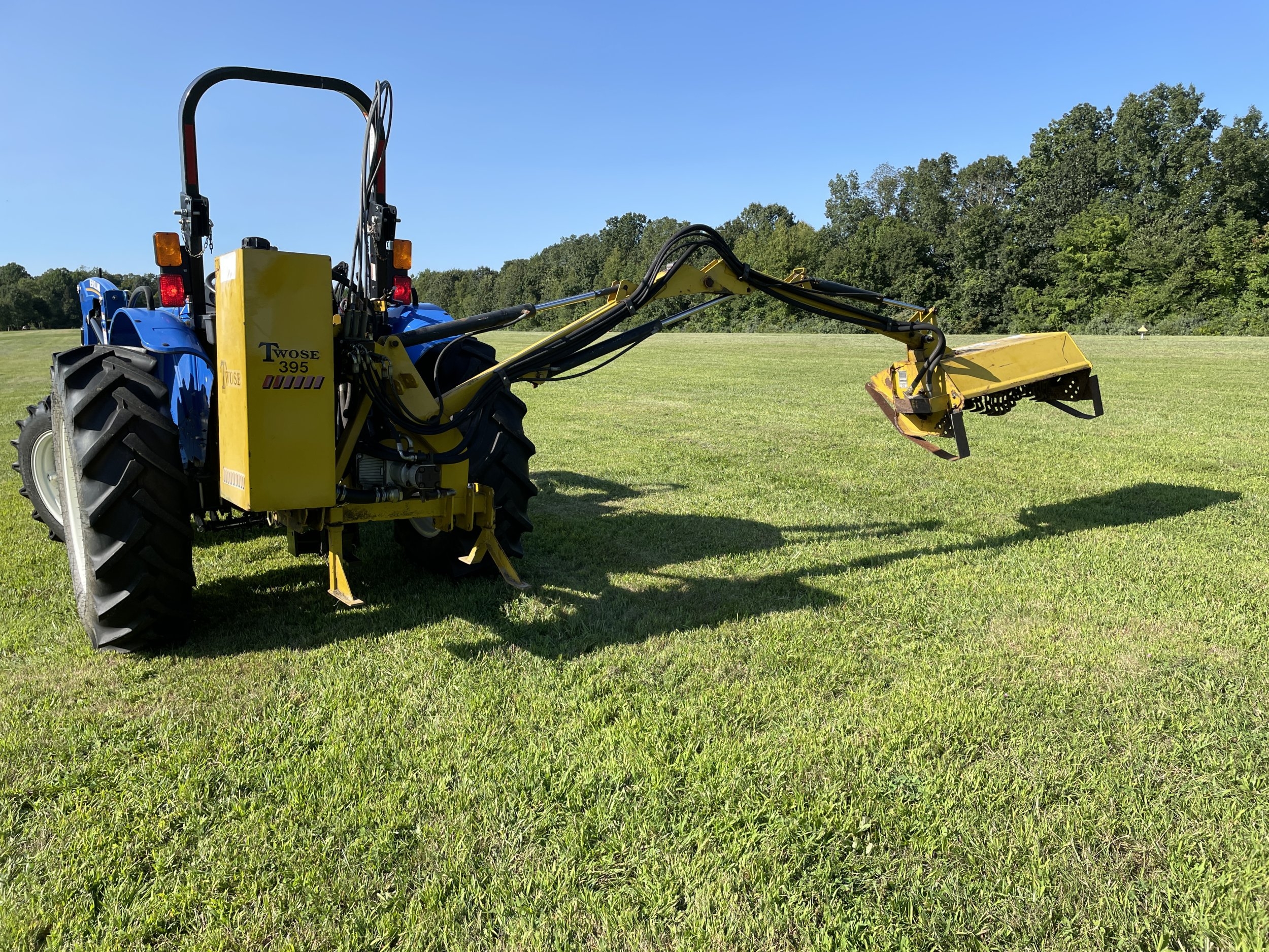

If overheating is a real problem you might try getting some hydraulic line bent up to replace as many fittings and elbows as you can.
I don’t think there’s an elbow on this Twose.
/ FRONT MOUNTED BRUSH CUTTER #17
This is how the Twose did it.

I really like your loader mounted brush mower. I have always liked the idea of the mower in front of me, especially so, since my neck and back have become much less flexible to watch the 3 point hitch mounted brush mower behind me.
Great job.
