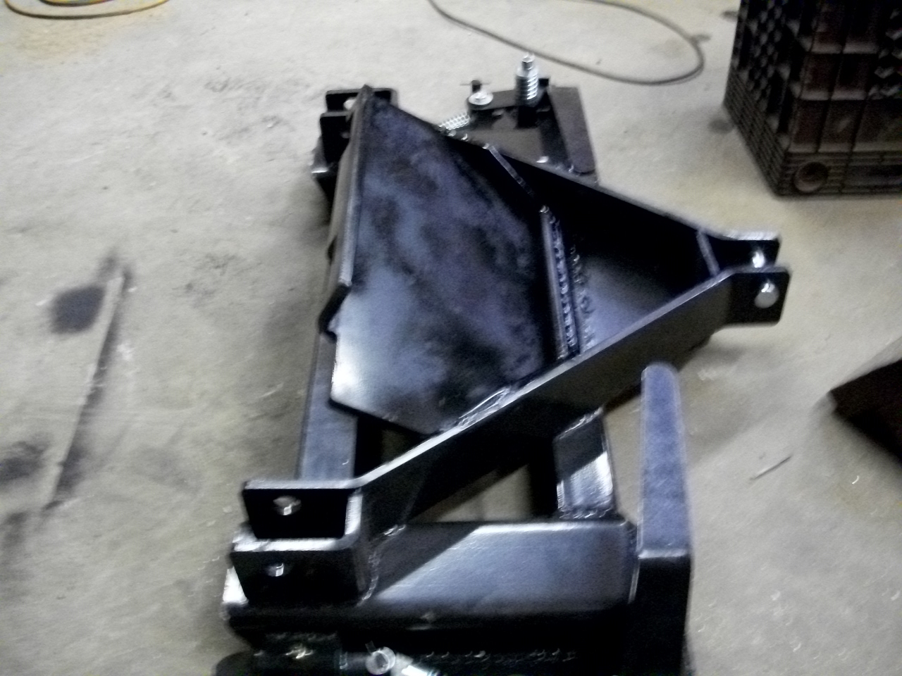

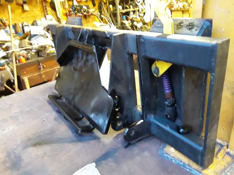

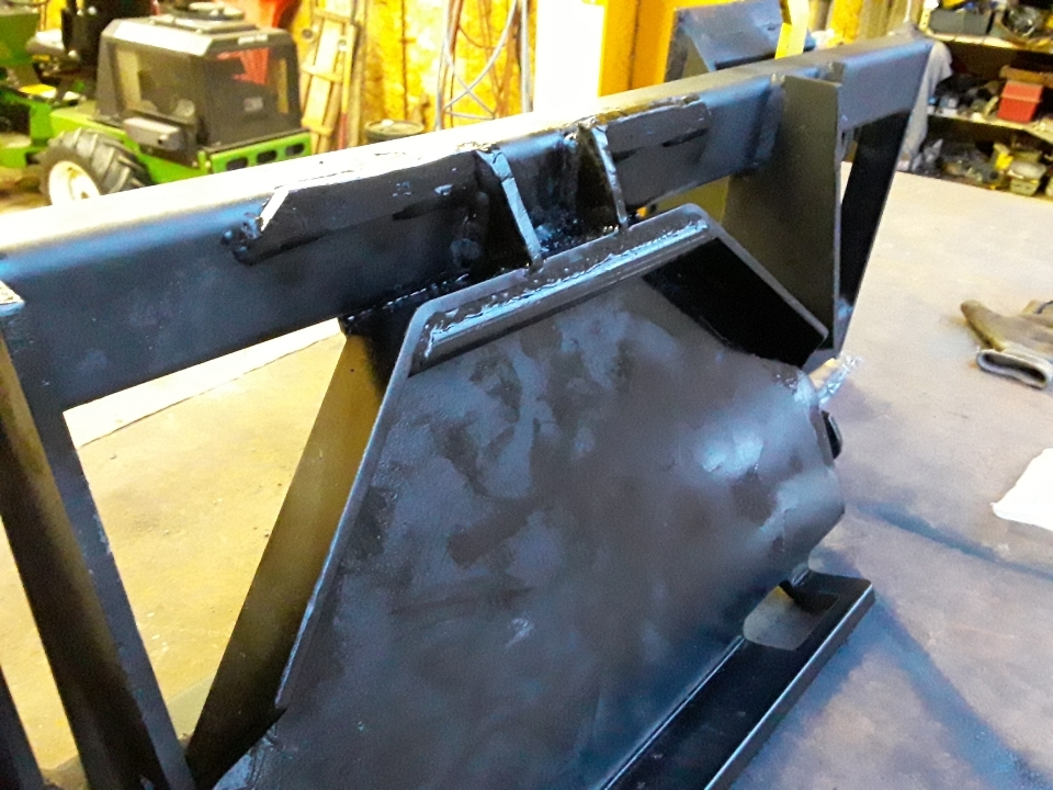

My home made adapter in the foreground. More over on the PT modification thread. I bought the pin assemblies from eBay.
/ Useful attachments adapted to PT ?
Seems like you added quite a bit of steel? Not just a simple weld the pin assembly to the PT plate?

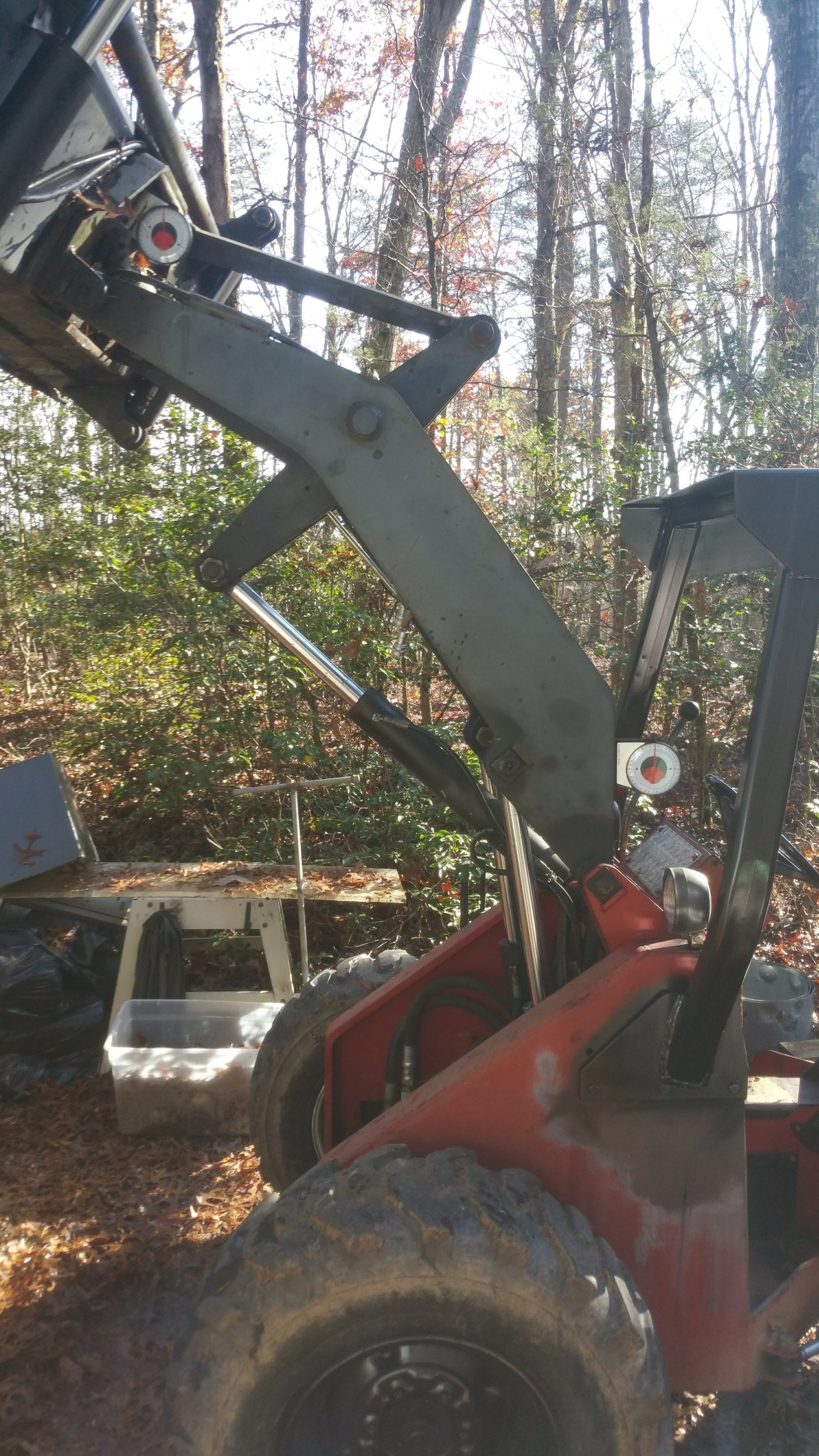

I had a PT adapter plate welded up to a ssqa forklift implement. Cost me 400 for the welding. I thought that was reasonable??
I put a little angle into it so it would have a nice range of motion as my PT is designed with an angle at the PT implement connection mount. See attached photo and you can see how it was done and the angle.
This gave me 3 implements:
1) Forklift
2) Remove the forks and the forklift backing plate has a 2 inch receiver welded into it. Use this quite often to move trailers.
3) Log grapple slides over the forks and gives me an "add a grapple" feature.
I definitely plan on doing a PT adapter plate to SSQA in the future and would probably build the same angle into it.

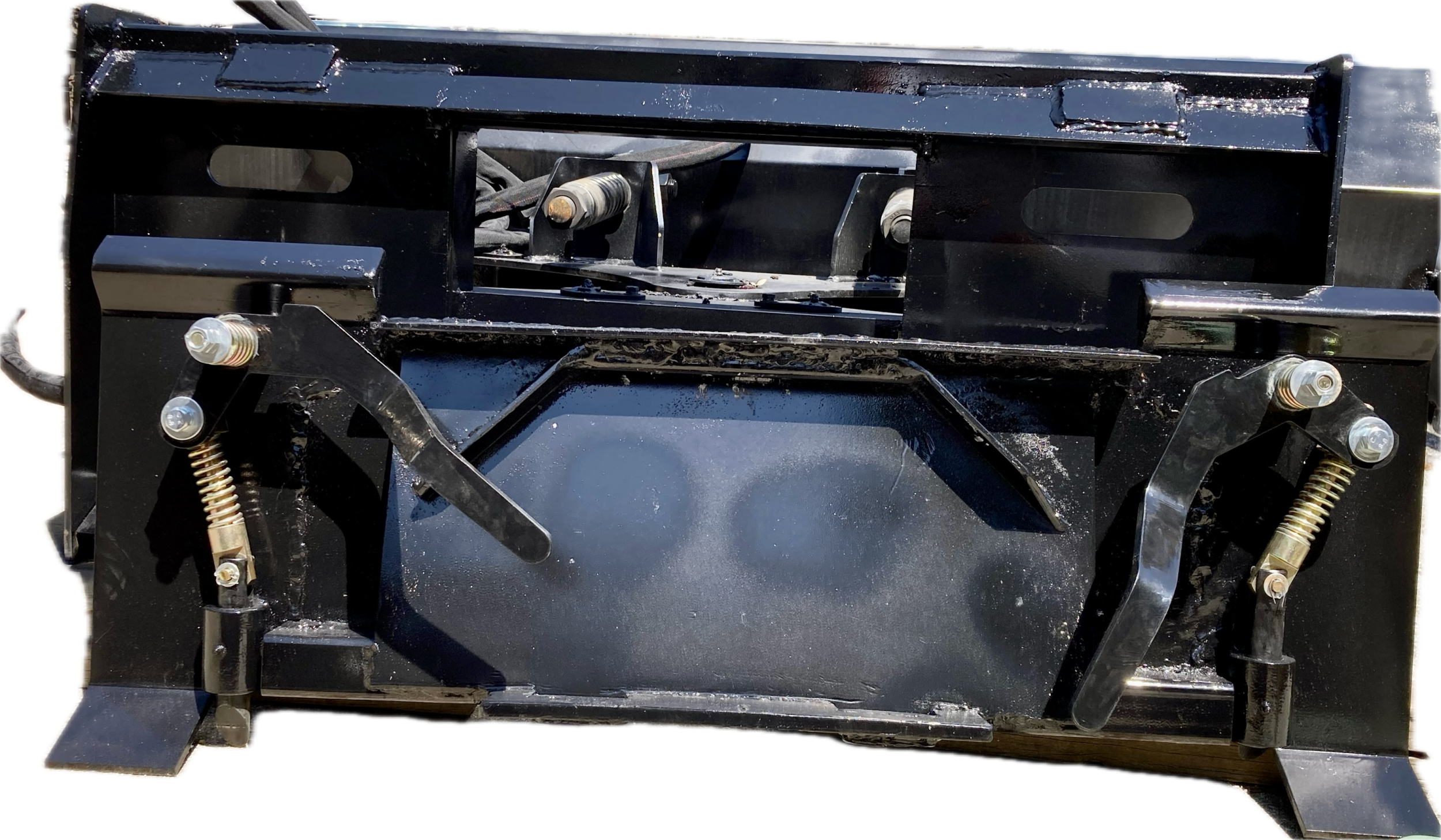

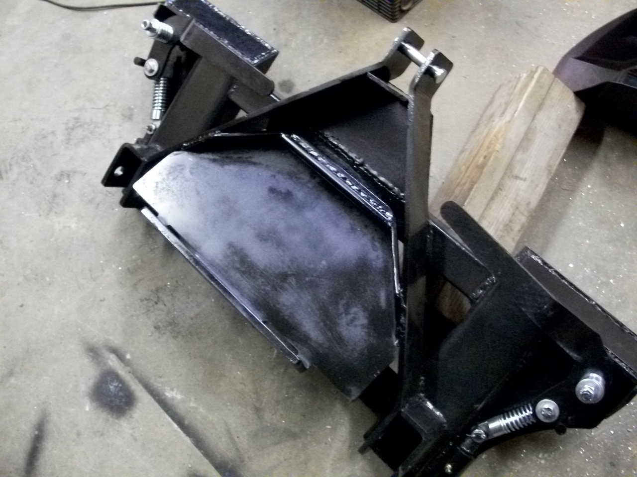

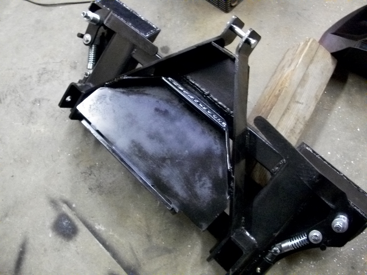

My version of a 1430 adapter made out of a ebay 3pt to SSQA. I had to cut the top portion off as it would pinch hoses on curl back. I matched the angle "neutral position" of the PT grapple bucket I bought with the machine

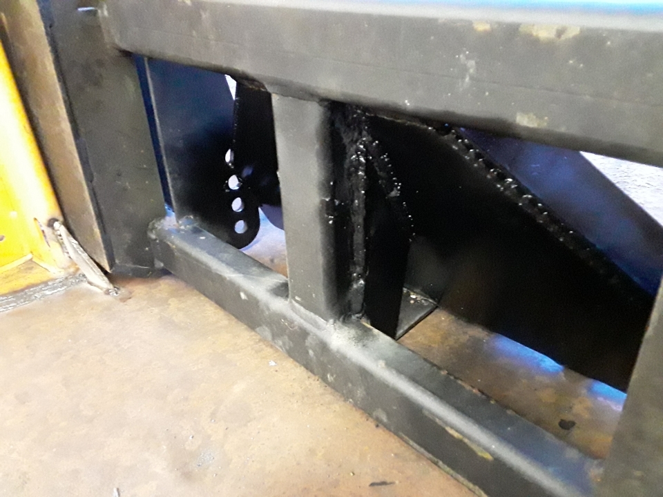

1460 adapter, same story. This was heavy to start with. For some reason they made it about 6" wider then it needs to be. I plan to someday cut off the excess but then will need to reweld up the holes in the box tubing.

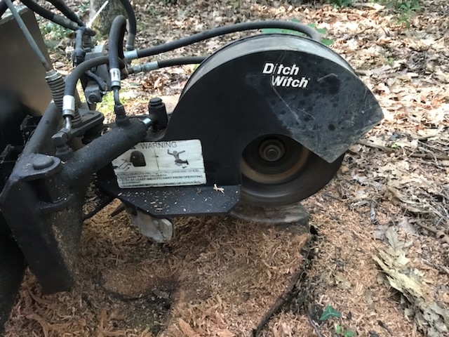

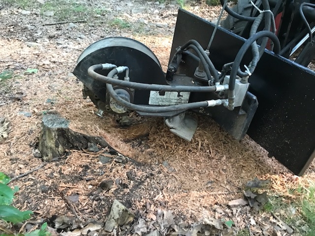

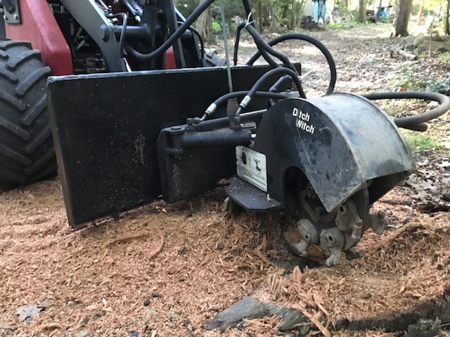

Ditch witch stump grinder on 1430 via the adapter. It works great as it moves right and left using its own hydraulics you don't have to move the tractor.

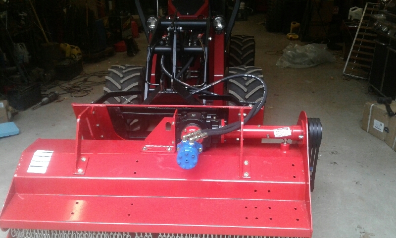

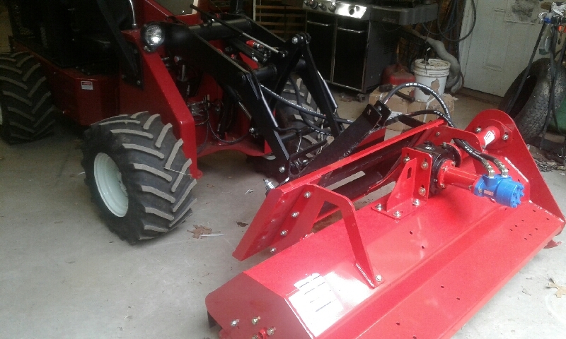

1430 with a Titan flail mower I use for brush.

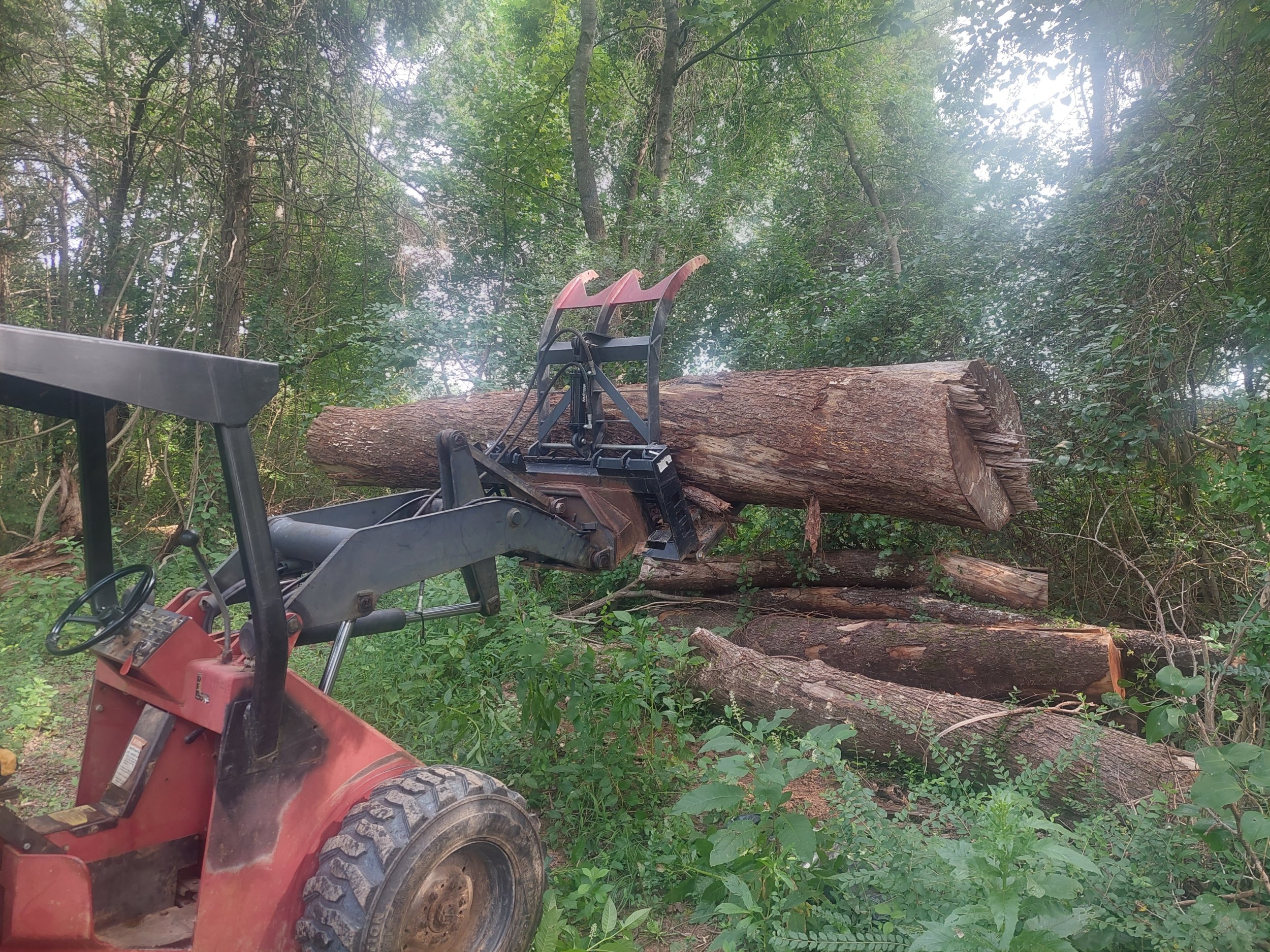

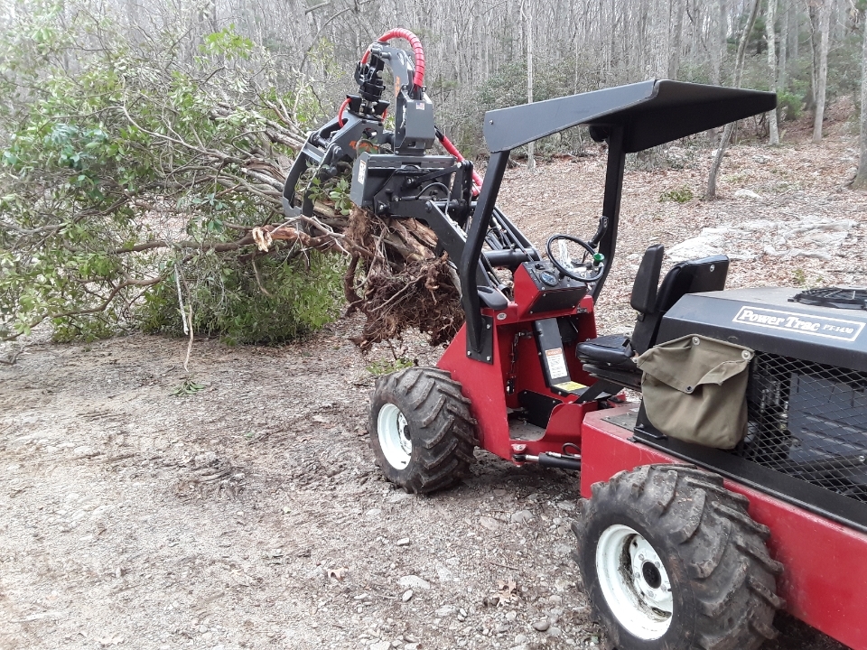

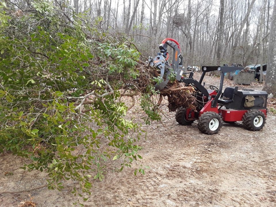

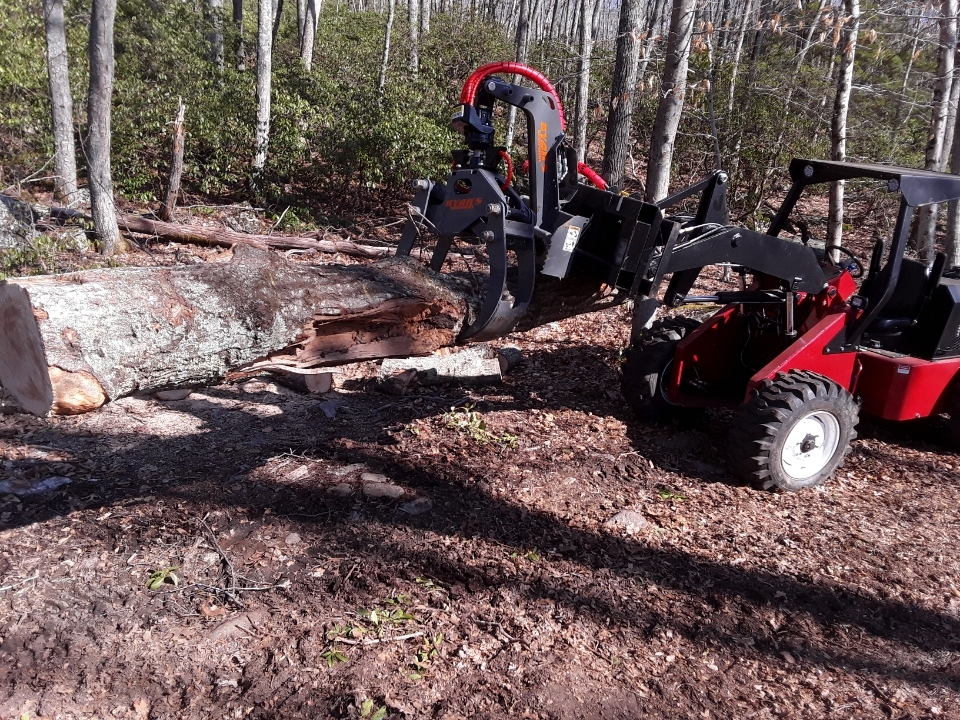

They are pricey but the Ryan's rotating log grapple is the best I have used. It allows you to approach the pile in any direction (instead of only at right angles). I use it on both the 1430 and 1460 depending on the anticipated weight. You can also carry very long/wide objects down narrow roads by keeping the pile parallel to the tractor.
I'm guessing that you adapted a hydraulic motor to drive the flail mower, but how did you do it? And how does it compare to a rotary brush cutter? Doesn't throw debris as far? How does it compare to a normal rotary cutter when it comes to weight distribution and stability?

What did you do to handle the angle?
Here is the sort of item that I bought;
So, yes, the rest of the steel I added. The cost of shipping on many of the other skid steer adapter versions just wasn't worth it. You have to get the spacing right, but the measurements are all over the web. I used 1x2 tube to space off the base of the PT QA plate away from the adapter. If I were doing it again, I would at latch locks at the closed position, and a little more angle. I used about 4 degrees (toward the SSQA), and I think 8 degrees (2x2" tube) might have been better, as vertical items like an auger don't care as much about angle, but horizontal uses like forks and brooms do. YMMV.
