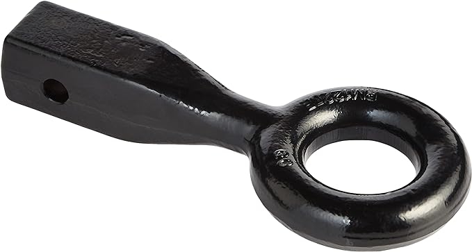

I ordered the ring hitch. Would you suggest tongs that have two tongs or the ones that have four tongs? Swivel or no swivel if I am using a chain like you are using?I have a 2" receiver welded to a quick attach plate.
I put a ring hitch in that and hang the chain with the tongs on that. It's easy to adjust the length of chain...
Short for just dropping the tongs onto a log from the seat, or I can feed it out to grab logs I can't get the machine close enough to.
I have an angle iron welded vertically to the QA plate that I can wrap the excess chain around and hang the hooks on.
After I get a few to the landing, I drop the QA plate with the 2" receiver, chain and tongs, pick up my forks, and use those to pile the logs.Thanks. Something else that would be handy would be if I could incorporate something to push the logs into final position after dragging them with the tongs.
