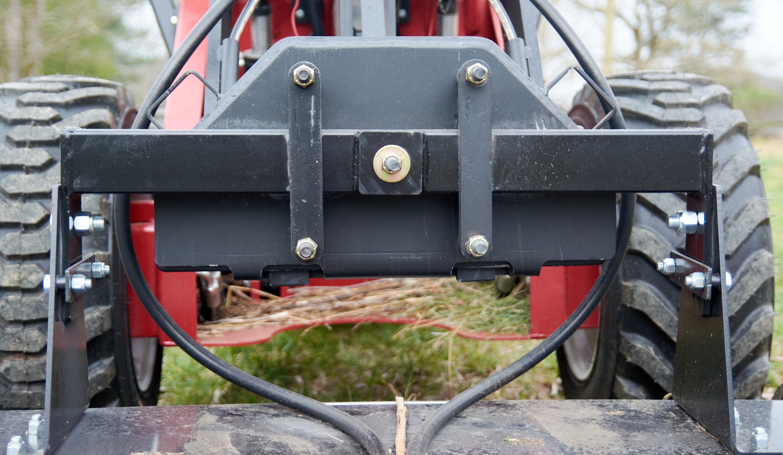

@2manyrocks Can you take a close look at the deck of your brush mower. Can you photograph the bolt pattern at the base of the tower that meets the deck? Can you also photograph the inside and the outside area of the swivel at the Q/A plate to show the lower bolts there? Thanks!

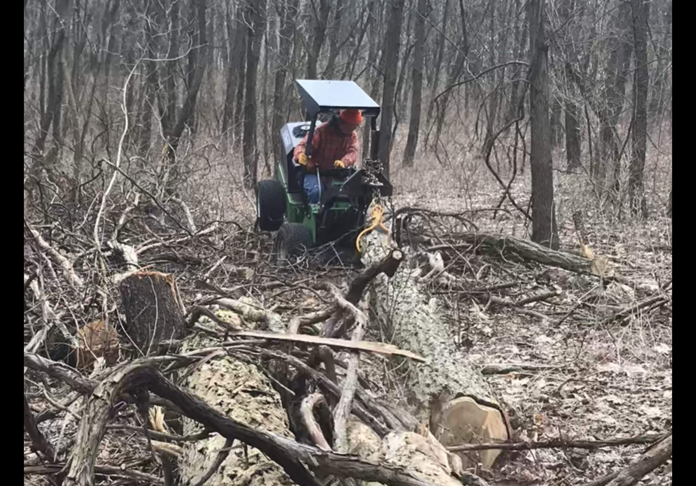

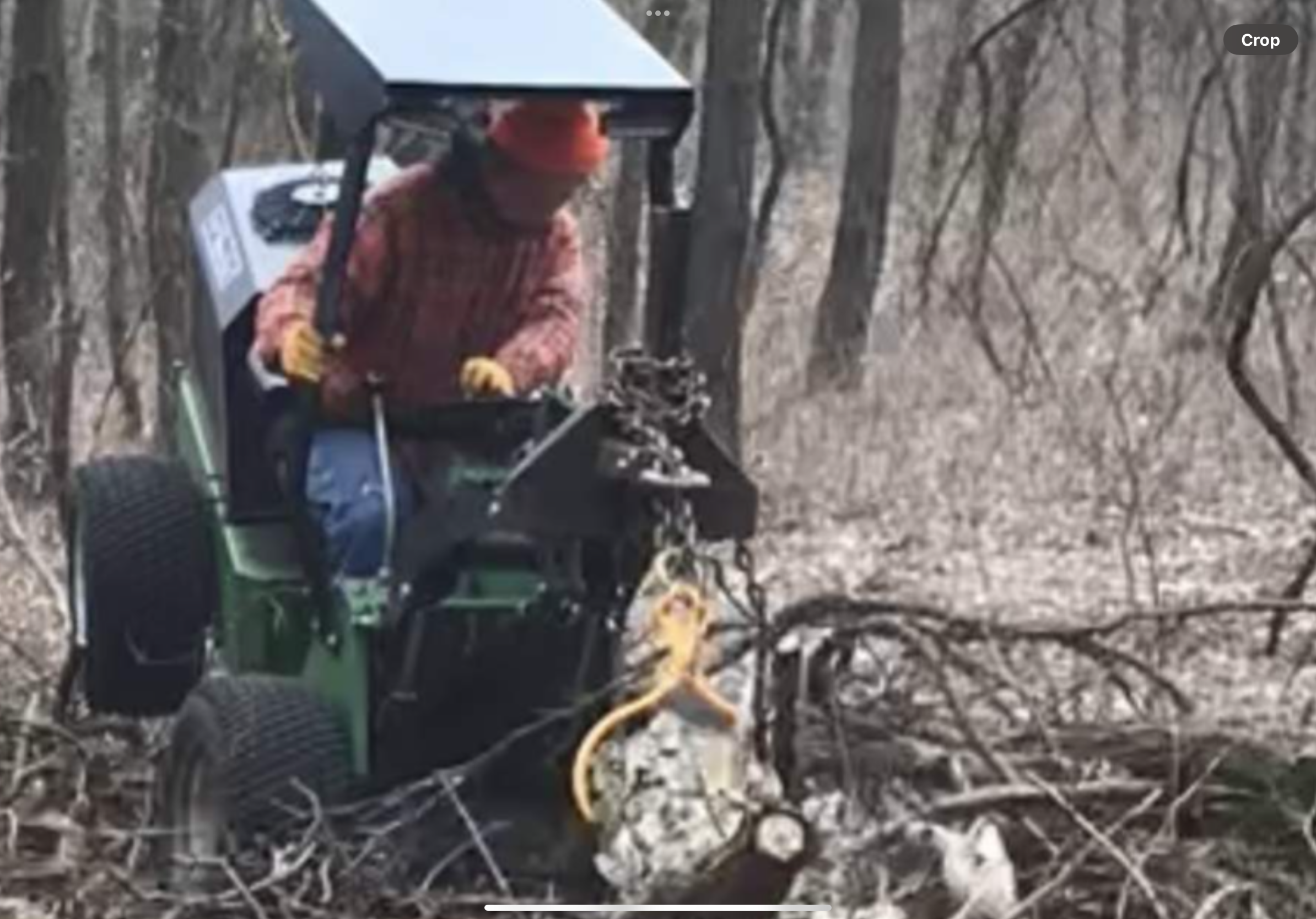

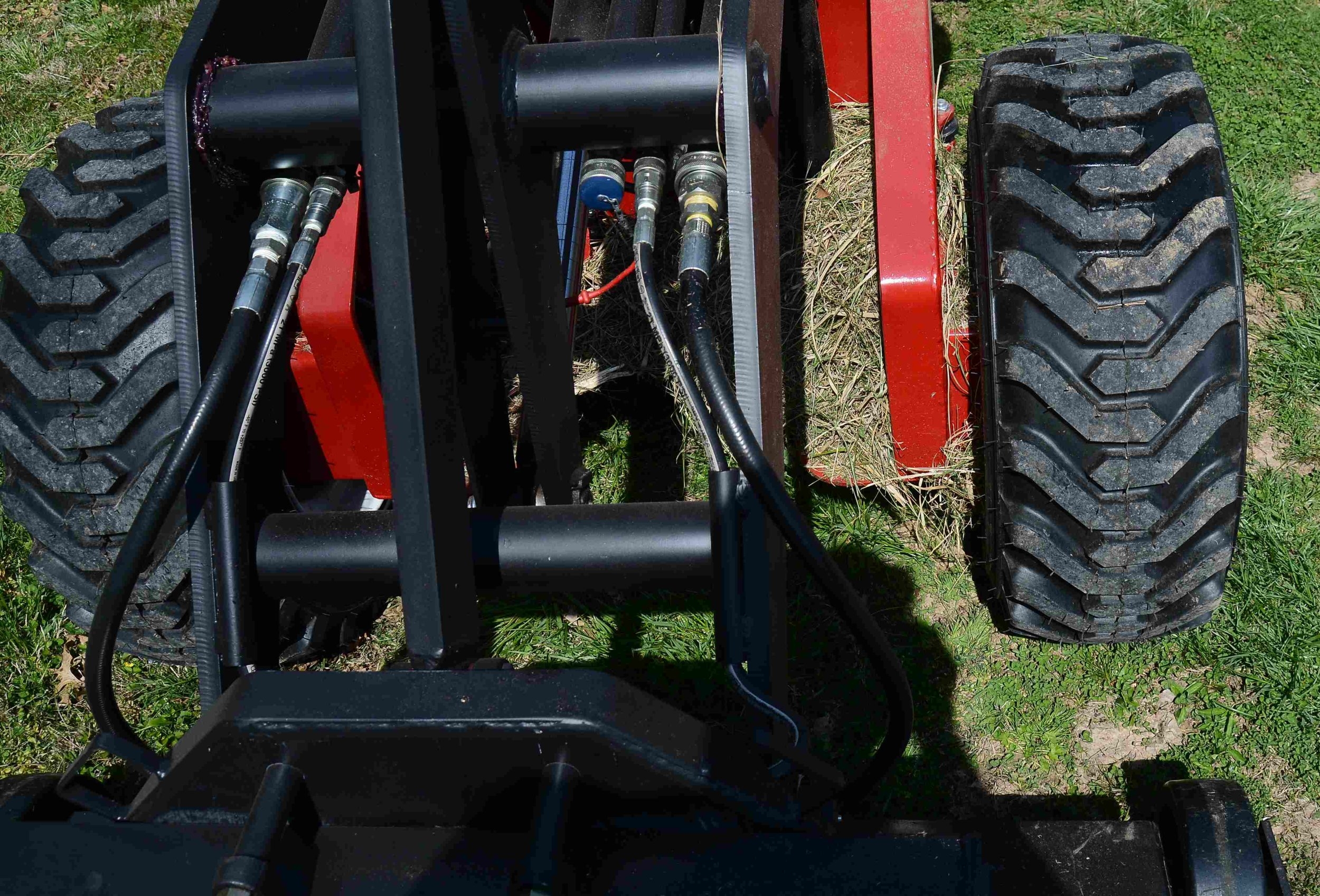

I have a lot of sizable wood chunks laying in the fields after having forestry mulching done. If I were mowing an established field, it wouldn't be so much of a concern.
The rear of the mower is aimed pretty much at the operator position when the deck is raised to the point where the front wheels are just starting to lift off the ground. I'd rather see the front of the deck tilted up and the rear discharge pointed downwards.
Is there something else I can try?
/ Useful attachments adapted to PT ? #68
You can, and probably should, call Terry and ask if the following works on your model mower and tractor.
I think that you can unbolt the six bolts holding the "tower" on and slide them forward one hole. There is a bolt hole to do that. Not all tractor/mower combinations support that. I would check that your mower wheels, the blade, and the rear of the deck clear your tractor, especially when crossing a swale, or ridge. (i.e. try crossing a ridge/swale with the mower off at low speed watching the potential pinch points.)
I don't know how big your forest mulch is, but is there the possibility of letting that area slide for a season to start composting them?
I have to say that when my mower has tossed big items, they have all gone forward. I get small pieces coming back. Because there is always a chance, I do brush cutting wearing a logging helmet with a face shield, just in case.
View attachment 858503View attachment 858504View attachment 858505

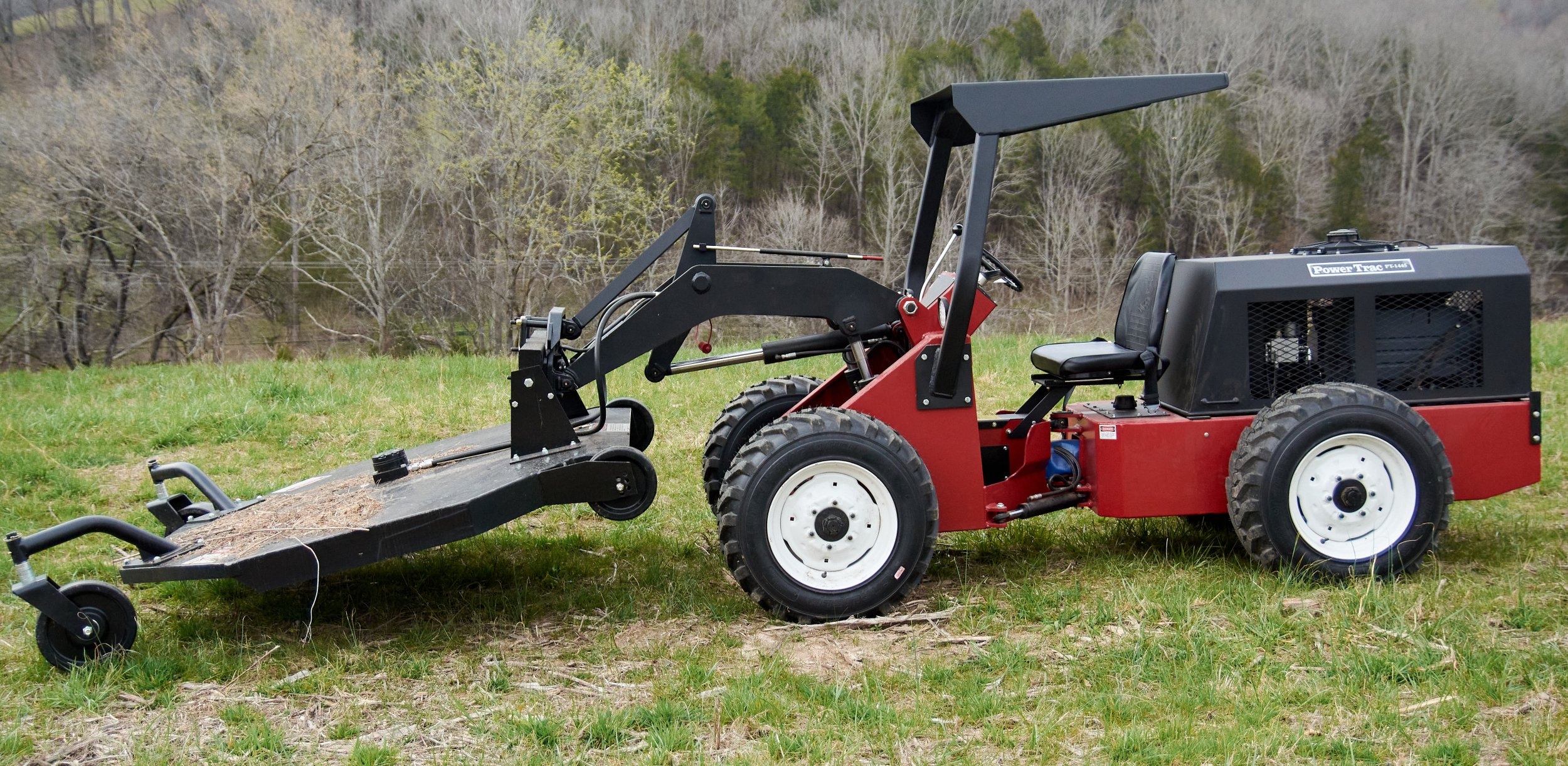

Oh.... now I understand. Your brush cutter is much different than mine for the little PT425. My mount is almost in the middle of the deck over the motor, while yours is at the rear.

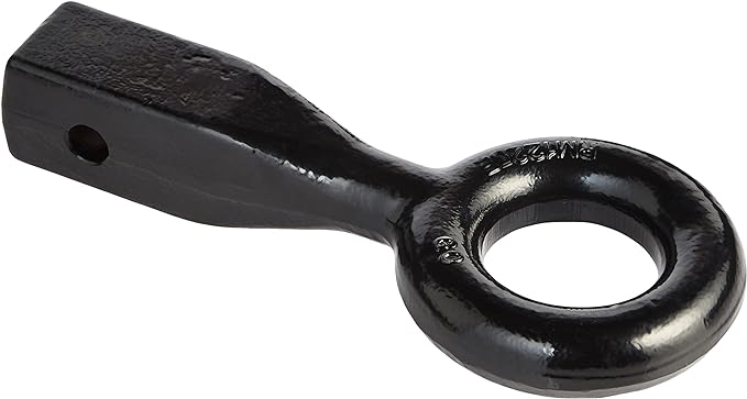

The older PTs came with a 3 point top link like this : Top Link 13
It replaces the round bar link that connects the top of the attachment plate to the tilt dump swivel point on the loader arm. The screws allow you to shorten the length of the rod which will bring the back of the mower down. If you go this route, it is a good idea to have a spare on hand because the ring the pins go thru is a bit weak and they break ocassionally.

I think with your stated background and such, you probably know all this, so don't take offense if I sound like I'm asking you if you tried turning it off and then on again? :p
It's just my basic trouble shooting nature from being in I.T. support for so many years.

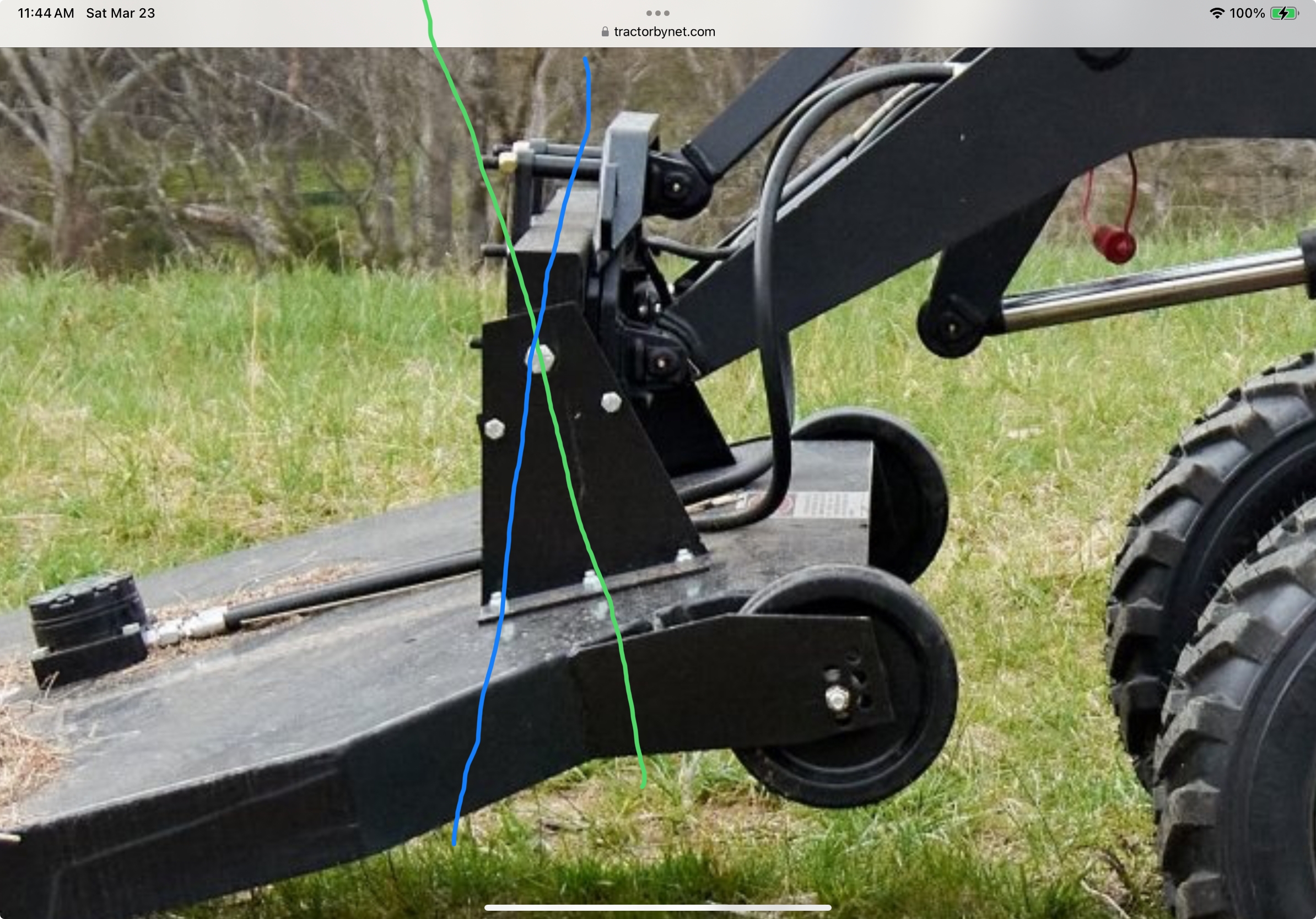

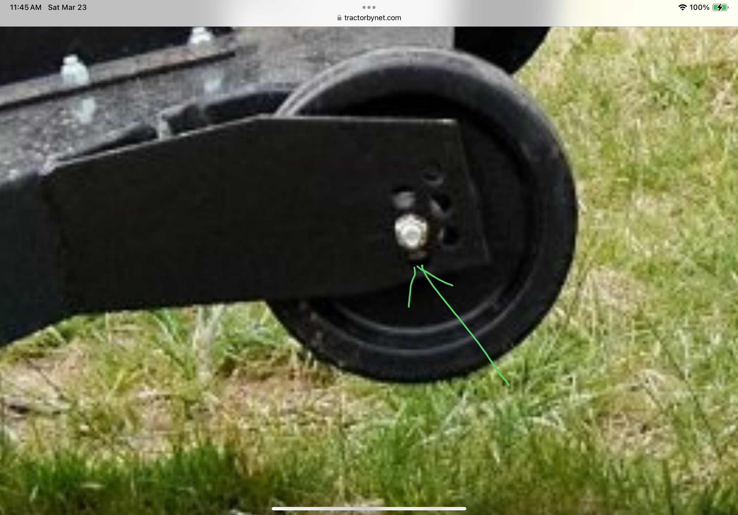

Looking at the photo, your front wheels are spaced as high as they go. (y)
The rear's have two more holes below the wheels. Move the rears down to the bottom holes. That gives you another inch or so in height at the rear.
(click to enlarge).
The dump/curl is currently adjusted to the blue line in the photo, as you were testing how far you could get the front to come up by curling back, I think.
So push the joystick all the way forward into float mode to set the deck on it's own 4 wheels and adjust the dump/curl to the middle of it's stroke on the green line.
(click to enlarge)
That's give you as much free swing fore and aft in the mount as is available from that neutral position.
I do not know how to adjust your draft control, as I don't have it on the PT425. So proceed from that point with the goal of keeping the deck on all four wheels all of the time. If the deck starts to drag VS roll over the ground, the way I understand it, the draft control should sense the forces of the implement against the tractor and lift it up off the ground enough to overcome those forces.
Try cutting the area with the deck level. Move through it slowly. It will destroy anything in it's path that it can roll over.
If there are just loose pieces of debris there, it should just beat the heck out of them and fling the pieces.
Are there still stumps sticking out of the ground? That's another animal.
If the stumps are under 2" my PT425 will just splinter them to toothpicks. I don't know anything about the deck you're using, so others will have to help you there.
The key for me is going slow the first few times through an area. Backing off on anything that starts to seem impossible and clearing the area around it to see what it is. If it's a 4" stump, it'll get dug out or chainsawed level with the ground. 2" or smaller and I'll attack it from the side again.
And again, that's just my experience with the PT425. Your's is a whole 'nuther animal.

As @MossRoad wrote, I suspect that you probably need to curl back farther than you were in the photo. Look at the tower. There is a limited range of motion for/aft by the tab under the plate with the two bolts. To have the maximium flexibility, the curl should be pulled back until it is in the middle on flat ground. If you want to lift the mower, pull the curl as far back as it can go before raising the arms. I would play around with it a bit on level ground, low to mid throttle, and try working it long enough that the hydraulic tank warms up.
Once you have curled back, how does lifting go? BTW: don't use draft control and float at the same time. Also, don't try to lift in draft mode. Both have draft mode working against your desired actions.

As ponytug posted, there is an unused mounting hole in the deck about 4" in front of where the support is currently bolted to the deck. Nothing about the deck in the manual I received with the 1445. You'd think Terry would get tired of having to answer questions that they could have addressed in an owner's manual?

Based on my experience with my brush mower, I suspect that bigger wheels are not the solution. My rear wheels are in the second lowest bolt holes, I.e. second highest deck height.
