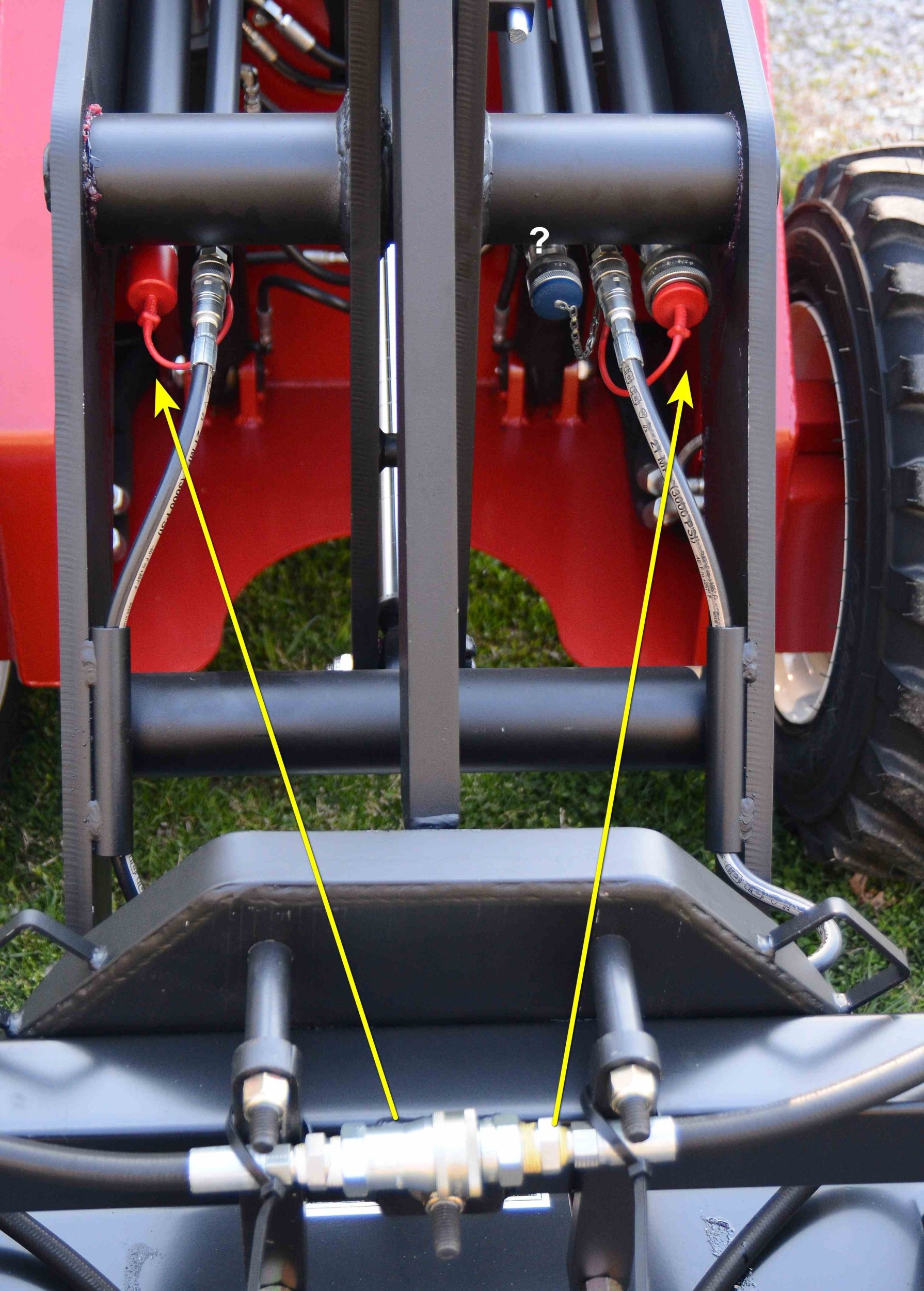

That pic you showed of the missing fitting, I believe is just a machining "center hole" when the pin was turned on a lath before it was welded in and is not threaded and doesn't need to be. Does that pin go across from one loader arm to the other with the Z-bar linkage pivoting on it?
If so, that Z-bar itself has two fittings, one on each side (right and left).
Purchase a good quality grease gun Zerk connector at an auto parts store, make sure it is small in diameter. Some can be very bulky.
Don't forget you need to buy spray lube as specified in the manual for the joints that don't have a grease fitting as THEY NEED LUBE TOO. I think those are the steering cylinders and the fwd/rev foot control at the pivot. I also spray the ball sockets of everything that has a fitting because it doesn't look to me that the grease zerk doesn't lube the ball sockets.
Very general rule is that everything that moves needs lube.

I have found that only certain brands of grease gun nozzles fit the loader arm recessed zerks.

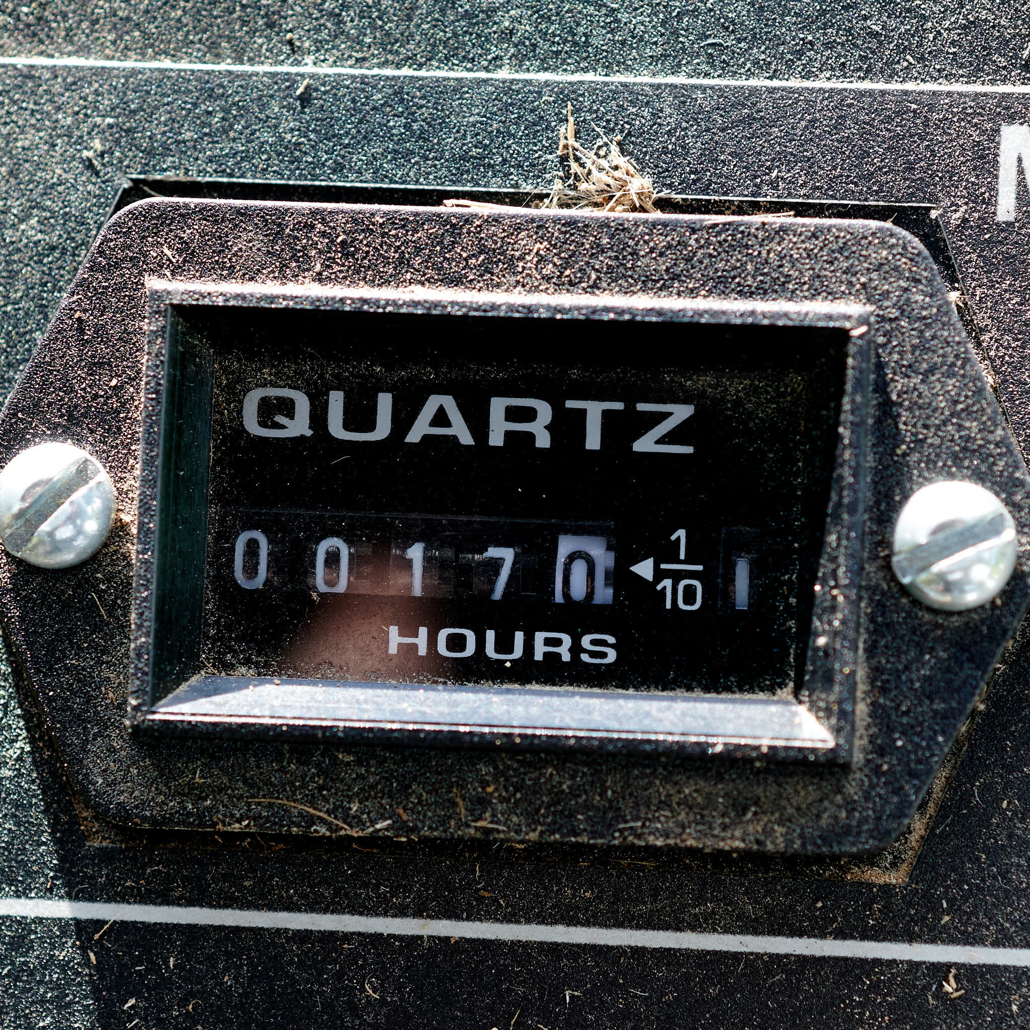

Now at 16 hours, I am hearing the brush mower blades clanging. The mounting bolts appear tight, but some play has developed that is allowing the blades to move, and that's the source of the clanging. Are these some bushings in there that already need replacing? Do I have to remove the entire hub to remove the blade bolt and replace the bushings?

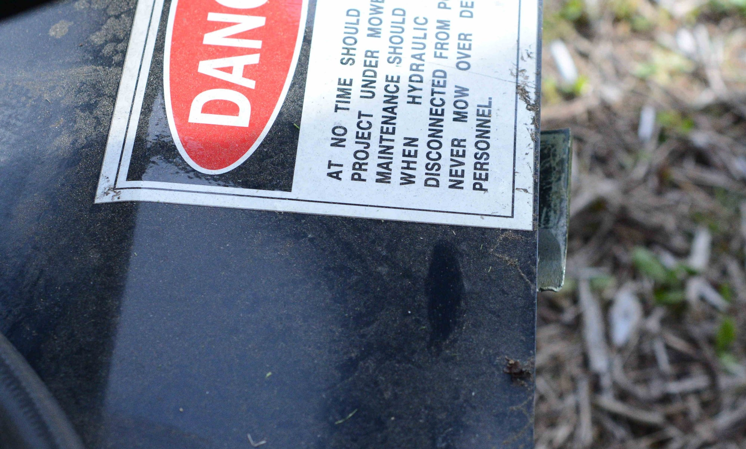

I may be wrong and others can chime in, but on my PT cutting decks (3), the blades do not extend beyond the deck/cover. This tells me you have the wrong blades. The noise may be the blades hitting your deck.
If your picture reposted below is just an illusion and the blades dont stick out, check your center hub for lateral and axial run out. All that heavy use may have bent something or something could be coming loose.
I WOULDN'T USE IT UNTIL YOU FIGURE OUT THE PROBLEM. Blades have been know to come loose and fly out.

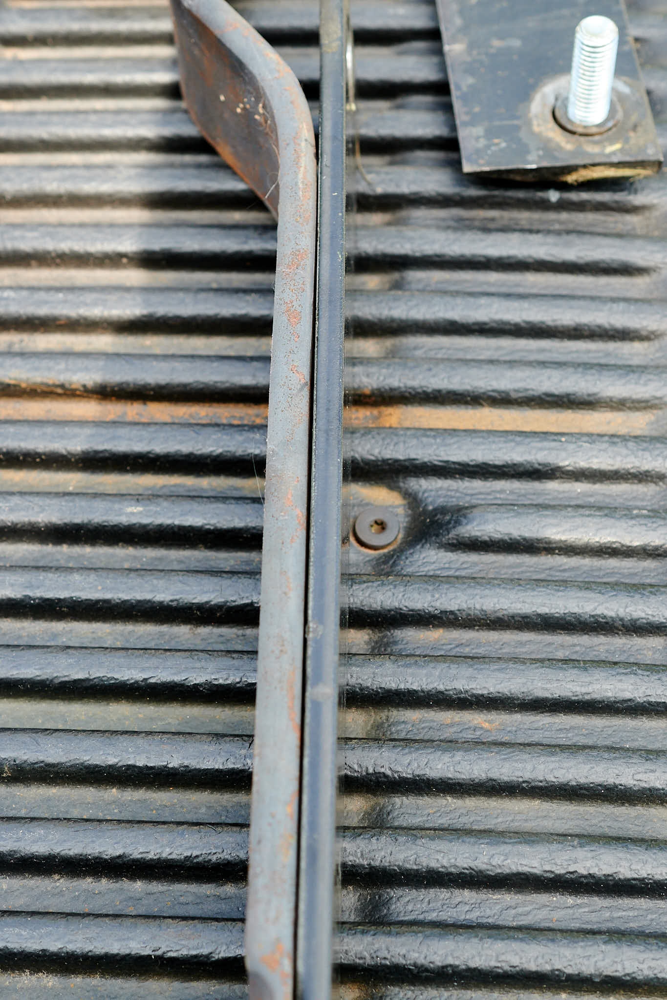

The blades are near the deck housing, but don't extend past it. The angle of that photo makes it look like the tip extends past the housing. Nonetheless, the blades come very to the edge of the deck housing.
I think there is some wobble going on and it has to do with the blade bolts or bushings if it uses bushings. The free play that has developed seems to be allowing the blades to hit something when spinning. Surely some idiot didn't install the wrong blades at the factory?
The use is just typical field mowing, but this deck is lower to the ground at its maximum height settings than my other cutters. I have hit some rocks.
I have a couple of J-Bar rotary cutters, and both are better cutting decks than this one from PT in design and construction, in my personal opinion.
It also stinks to spend this much for a brand new machine, and it being leaking hydraulic oil at only 16 hours. My Kubotas have nearly 300 hours on them with no leaks.

That's basically where my 1445 blades are. They come right to rear edge of the deck. When I first bought the machine, I did consider putting a chain guard spaced out a little, but in the end, I realized that debris doesn't come up and out directly. I still wear a chainsaw helmet, just in case of ricocheting debris, having seen how far the brush mower can hit chunks.

I think it helps with the cutting effectiveness, but it's scary how close the blades come to the edge of the deck.

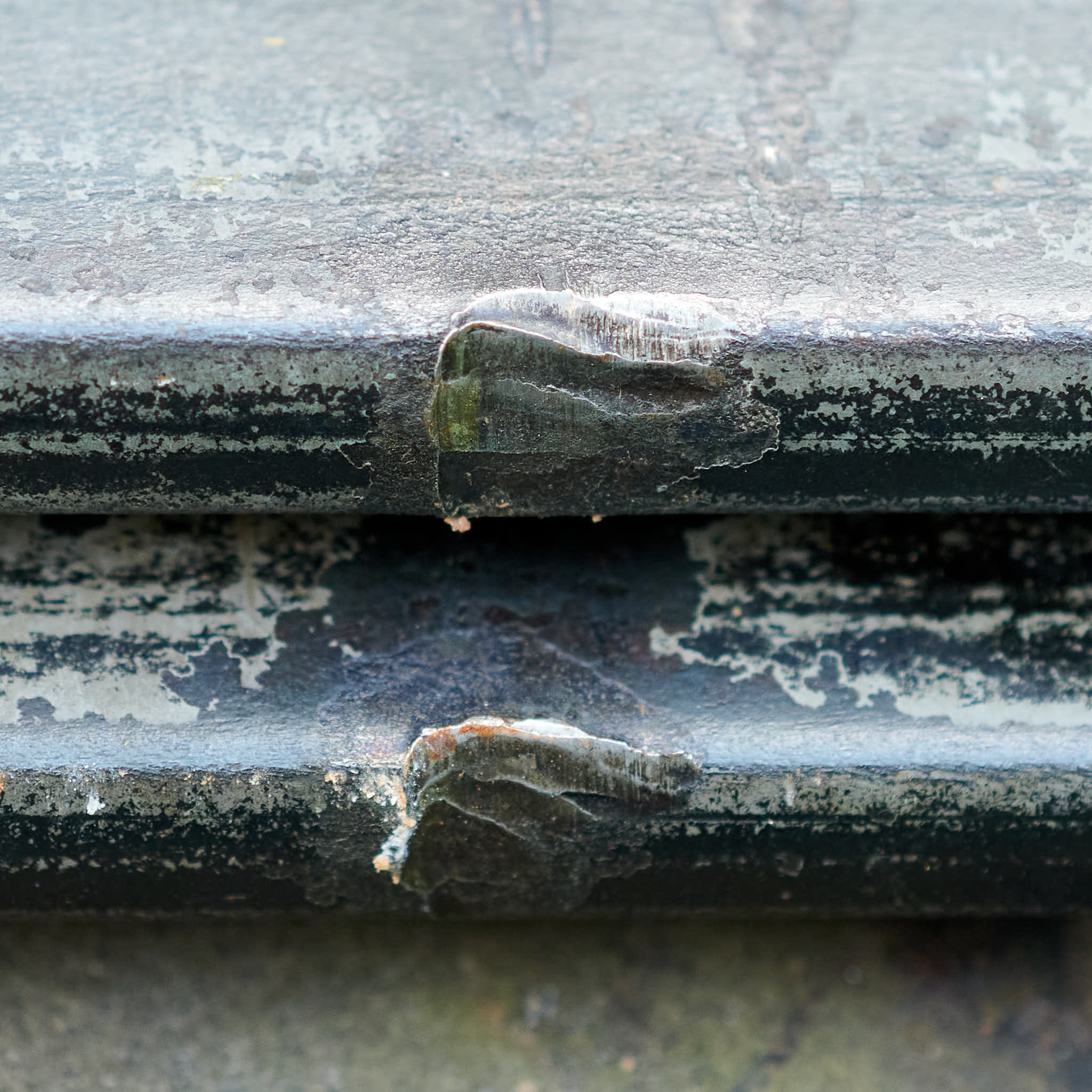

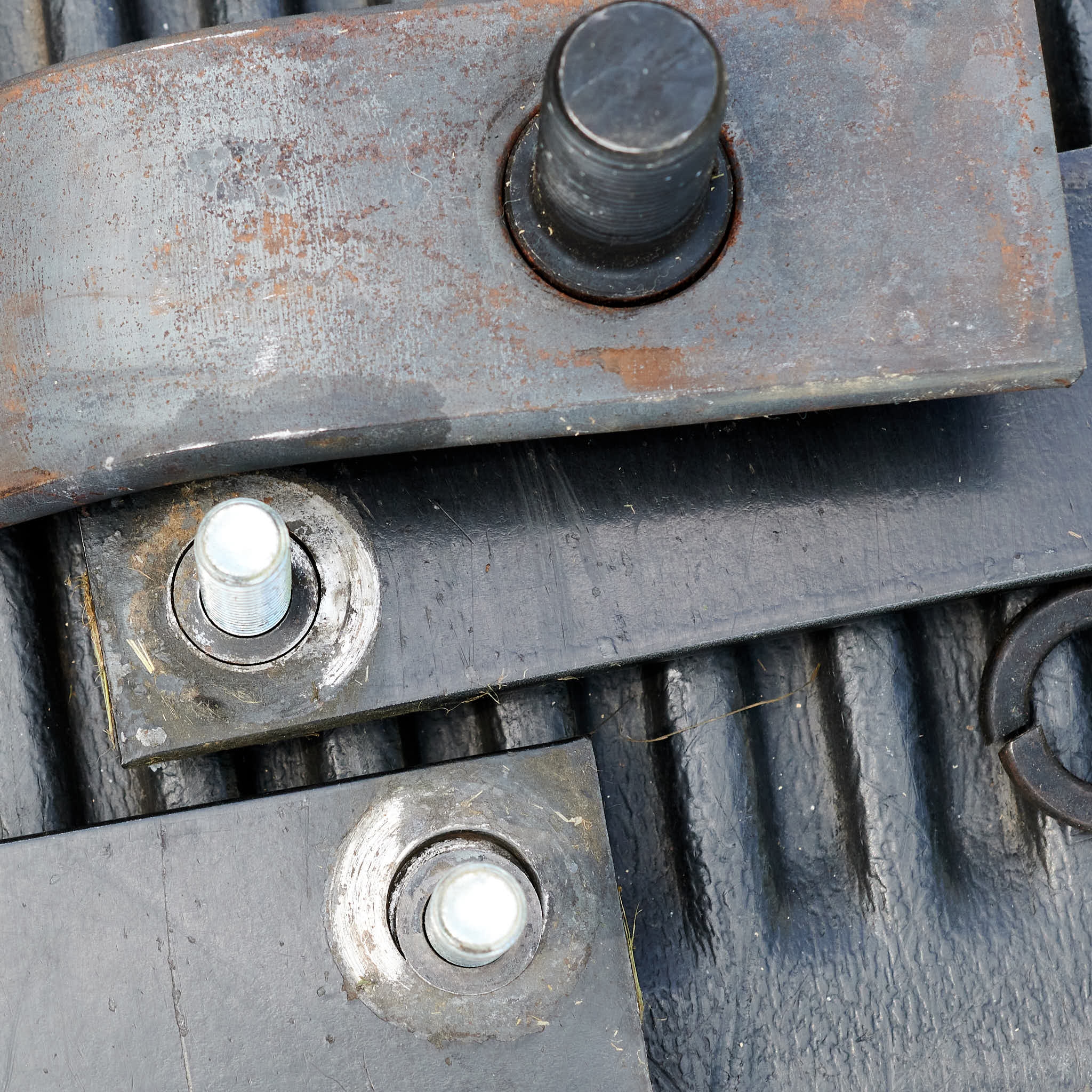

Sun came out today. Used a stubby ratchet and a crows foot wrench to attempt to tighten the leaking hyd. hose fittings. Will see if it worked.

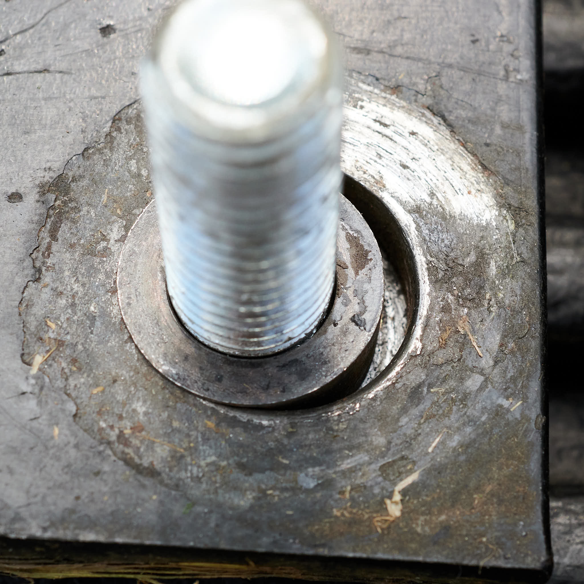

Removed the OEM blades, bolts, and bushings with an impact wrench to find one of the bushings severely wallowed. The McMaster Carr replacements haven't arrived yet.
Noted impact damage on one side of each blade in the same area that must be from the blades hitting the bolts in the hub.

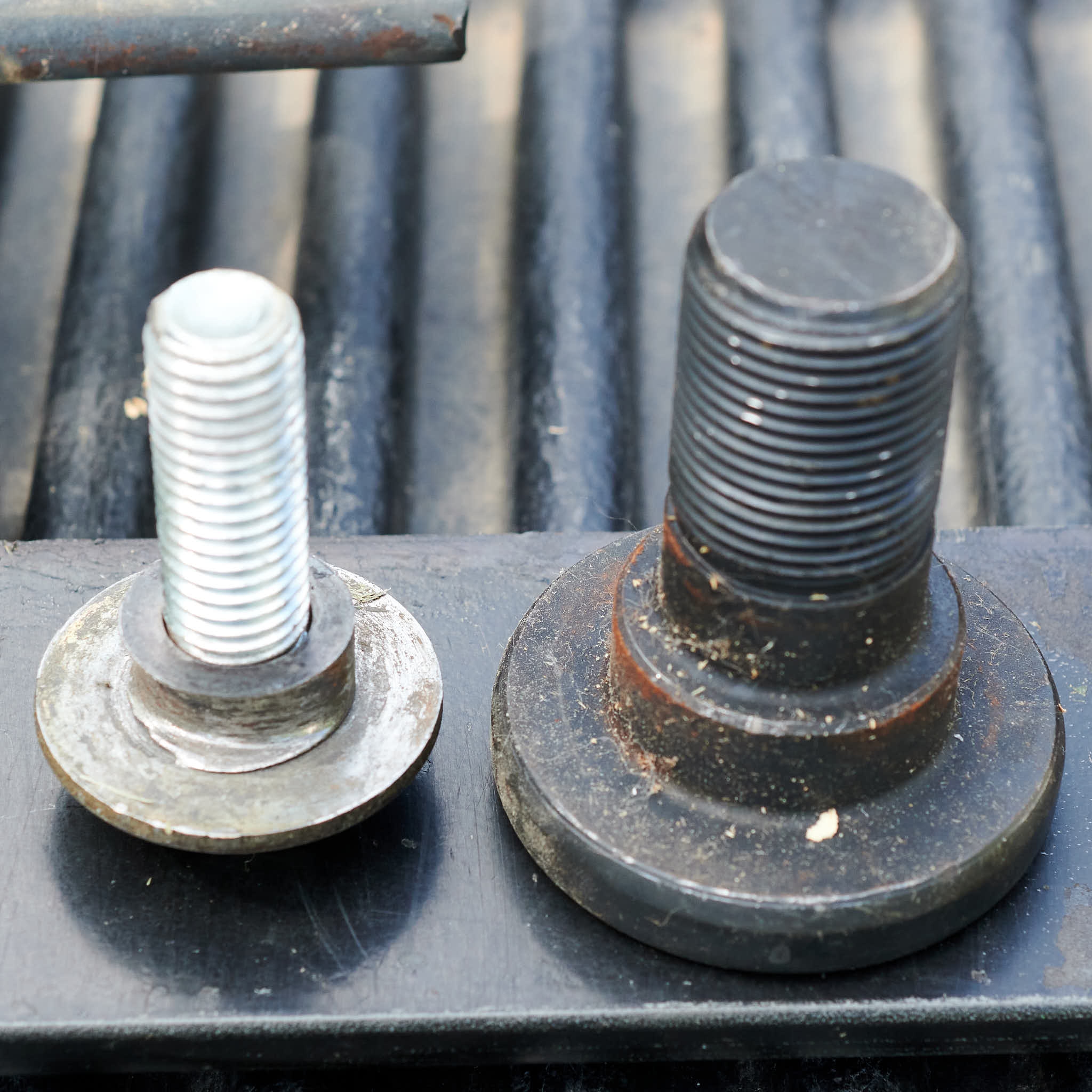

For comparison sake, I included a photo of a new cutter blade for a 6' J-bar and its bolt with the integral bushing. The J-Bar blade and bushing design is much beefier. One odd thing I noticed is that the hole in the PT blade for the mounting bolt and bushing is offset from the center of the blade width instead of being centered.
To my eye, it looks like PT used a soft metal bushing without any grease from the factory, and this is what it looks like at 17 hours.
I don't know how hard these blades are, but they are beat up already.

I think that the mower blades are the same metal that PT uses for the bucket edges, and yes, I agree I think that it is not very hard. I do keep my blades sharp and balanced (one blade to the other, and with the center of mass in the same place +/-). I removed the two bolts that weren't being used. Terry said that the bolts were there to keep the blades from swinging all the way around. Other folks(@woodlandfarms?) have put things like hockey pucks on the bolts. I stick to never starting the mower with engine at anything other than idle, and it hasn't been an issue for me.
I have welded material back into the wallowed holes to bring the hole back to the required ID. That plus the McMaster oiled bushings and regular greasing made welding a one time fix. I think I used 7018, but don't quote me. I have used 7018 to fill in large divots in the blades, and to make up for wear along the outside leading edge.
