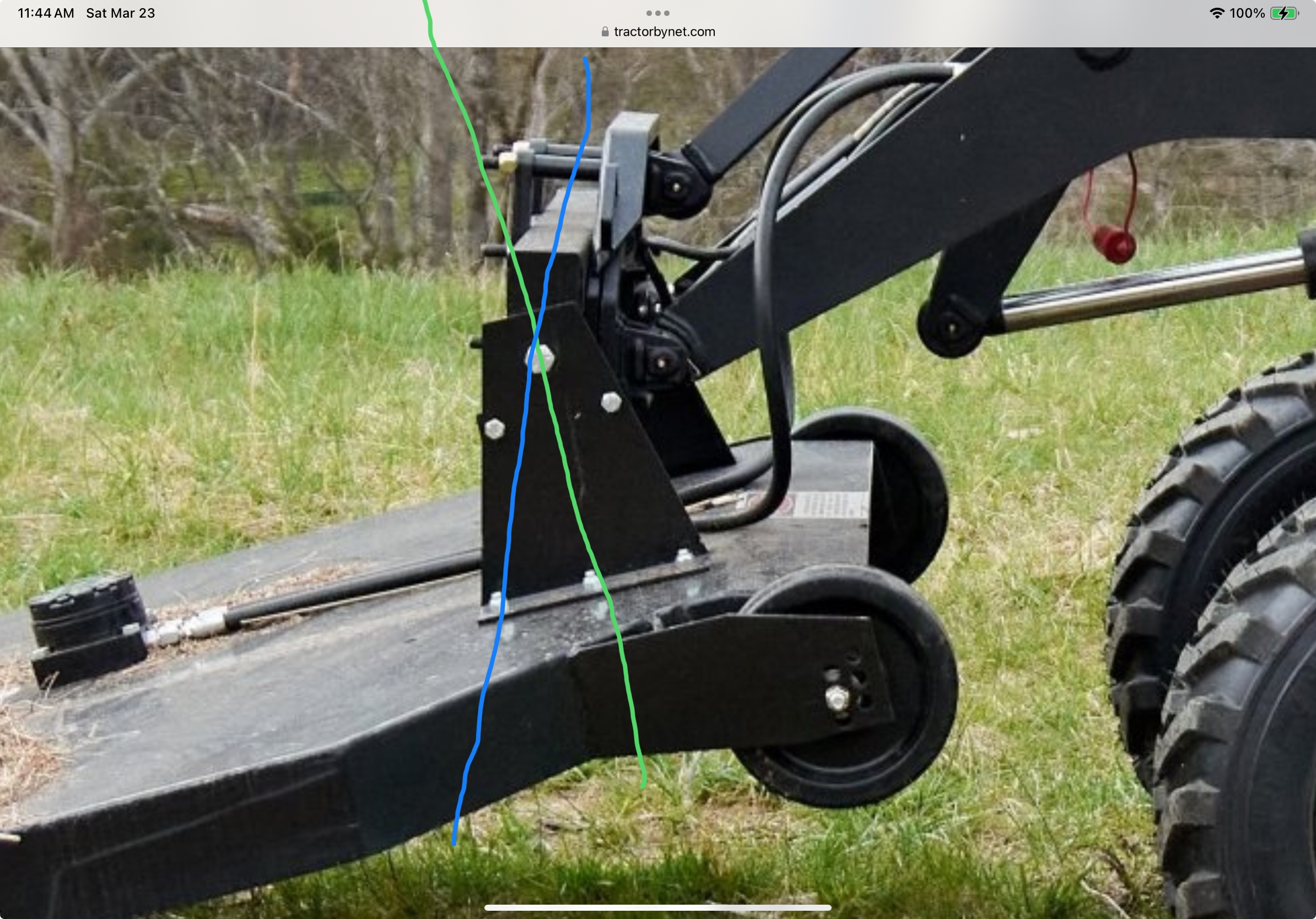

Ran the cutter for a few hours today. The larger front wheels have pretty much cured the issues I was having with scalping plus to me they seem much better at riding over stuff than the smaller diameter OEM wheels. And the laminated rubber wheels don't chatter on my gravel driveway.
Still intend to change out the rear wheels on the deck, too, but that will require some fabrication.

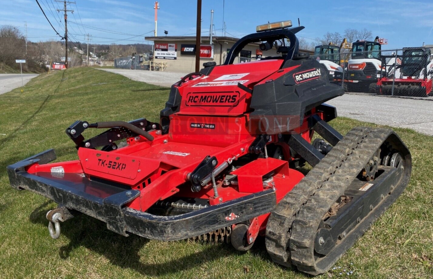

Yes the commercial remote controlled mowers have been pricey; $5k for a lawn mower size mower, and the larger ones seem to be PT-1860 cost, for not a lot of utility. E.g. this one
While this claims up to 50 degree slopes, the Kawasaki FX1000V has a limitation of 25 degrees. There's no claim for an enlarge oil pan or dry sump, or nothing that might help the Kawasaki run well, but perhaps it is a man behind the curtain thing...It lists new for more than an 1860.

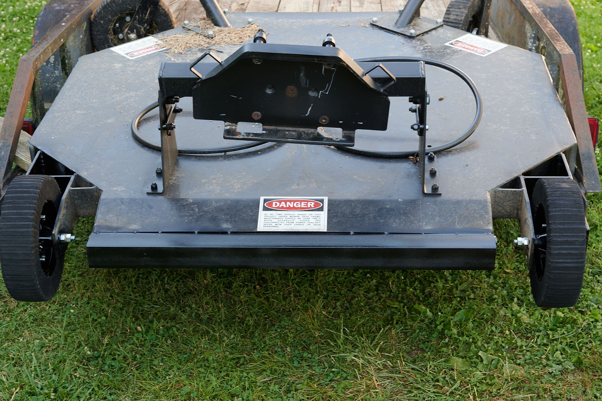

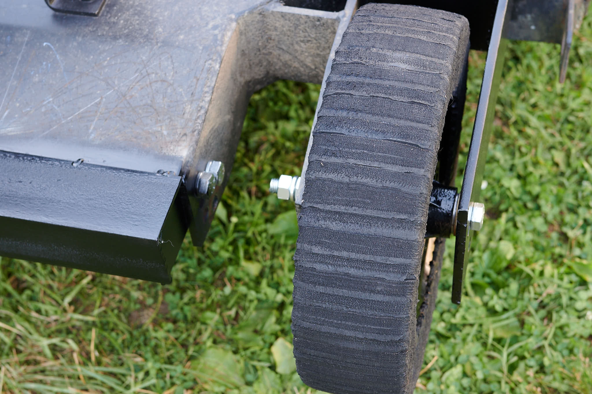

Current status is I installed the 15" laminated wheels after using a wire wheel brush to knock off the paint on the 1 1/4" yoke.
Next, fabricated new wheel mounts at the rear wide enough to mount 15" laminated wheels. Thought I could use 3/4 axle. Wrong. Not enough metal in the OEM 5/8 to bore out comfortably so I bought hubs with a 5/8 bore.
While I had the mower off the PT, decided to fabricate a debris guard. I meant to use chain, but wasn't comfortable with measuring the clearances needed to make sure the chain could never impact the cutting blade in any position. With the blade being so close to the deck anyway, I made a temporary guard just to see if it made any difference and how it might affect cutting performance.
