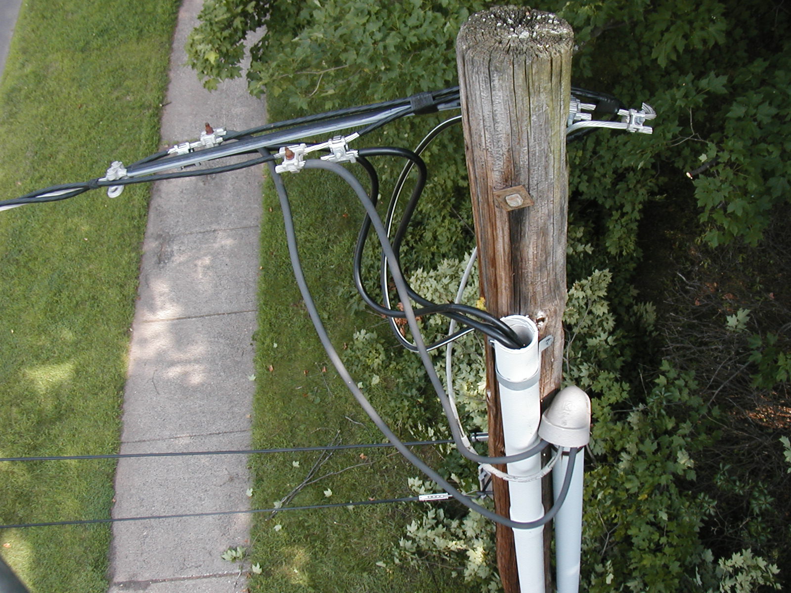

4/0 al. with 2/0 nuetral will get you 200 amps all day long at 400 feet. If your concerned use 350 with a 4/0 nuetral. Menards has 4/0 for less than $2 per foot. Don't want to start a debate on direct bury or conduit as you will get people telling you conduit is the only way to go. I've been installing overhead and underground for over 25 years, both direct bury, in conduit or conventional
Underground in duct packages thru manholes. For a simple house service useing urd al. Cable direct bury would be by far the cheapest and many, many times easier for a homeowner to accomplish. It is an industry wide used practice to install direct bury, no matter what you hear ( so is conduit). The hard plastic insulation is very very durable( sharpen your knife or get a urd 4-way skinner). In the unlikely event it does get hit, a machine will go thru conduit almost as easy as the conductors unless you use rigid (unlikely). The major difference on a "hit" is your damage will be limited at the location of the hit for direct bury, a few splices and 5 feet of cable. Unlike a "hit" in conduit, repairing the conduit and repulling the repaired cable will be your easyest part of job. Replacing your service entrance , meter cabinet and the bill fron the utility for replacing the transformer when the secondary bushings get yanked out of the can will be major expense. I could go on and on but I'll let some others chime in.

While I would never install al. Inside my house. It is used my most utilities for sec. And primary. The leads coming out of the cutouts, transformer bushing and other taps are usually copper and then the wire or cable is tapped onto the leads. If you have utility owned lines on your property than it's probably al. Unless it was installed before 1960. Another benefit of al. Is that it will corrode fairly quickley at the hit and you will halve a part out or half power letting you know. With copper it will just keep on pimping and may be years before it could cause an outage, but if the hit is downstream from the meter it will register as load and really up your utility bill
