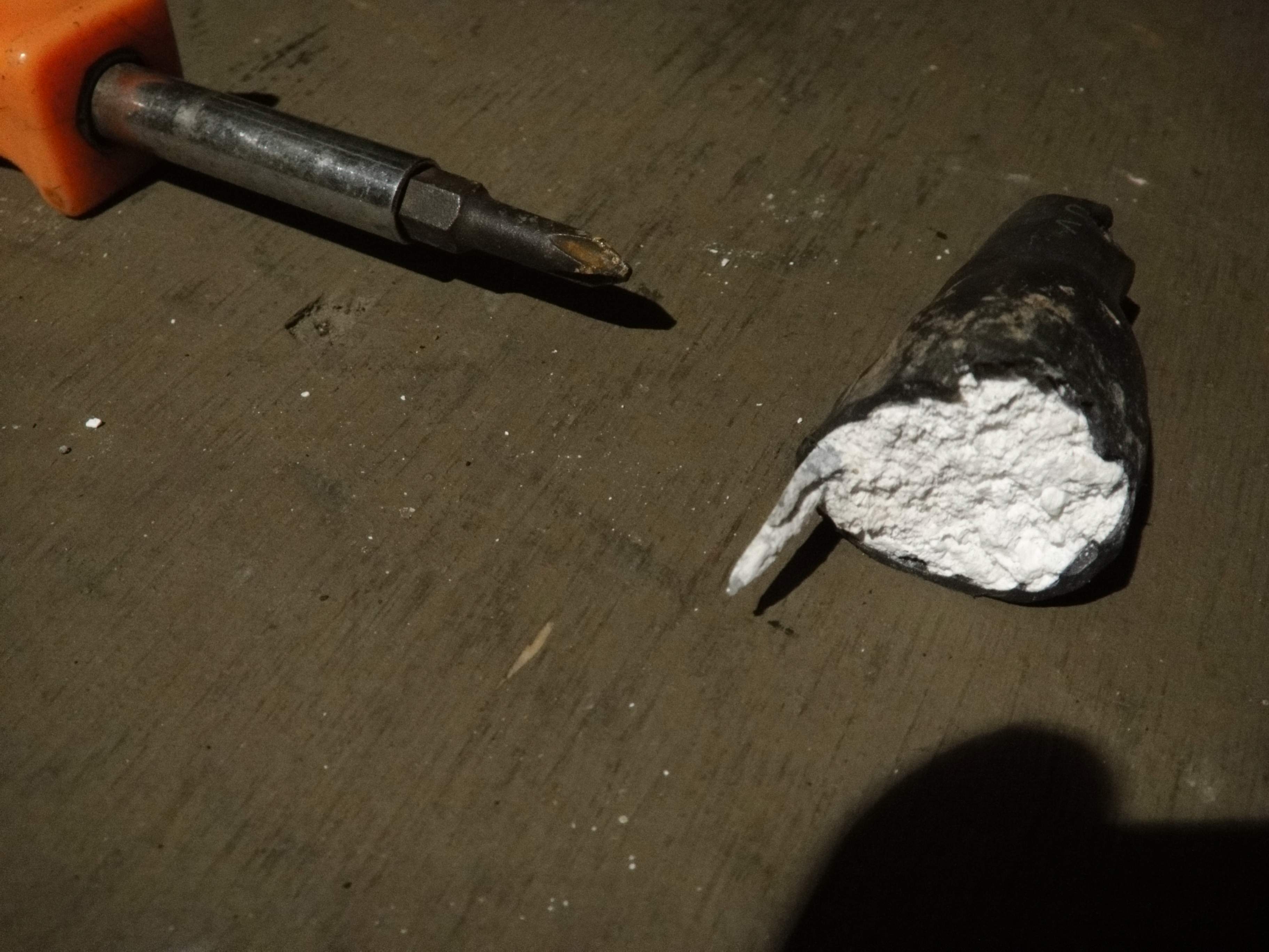

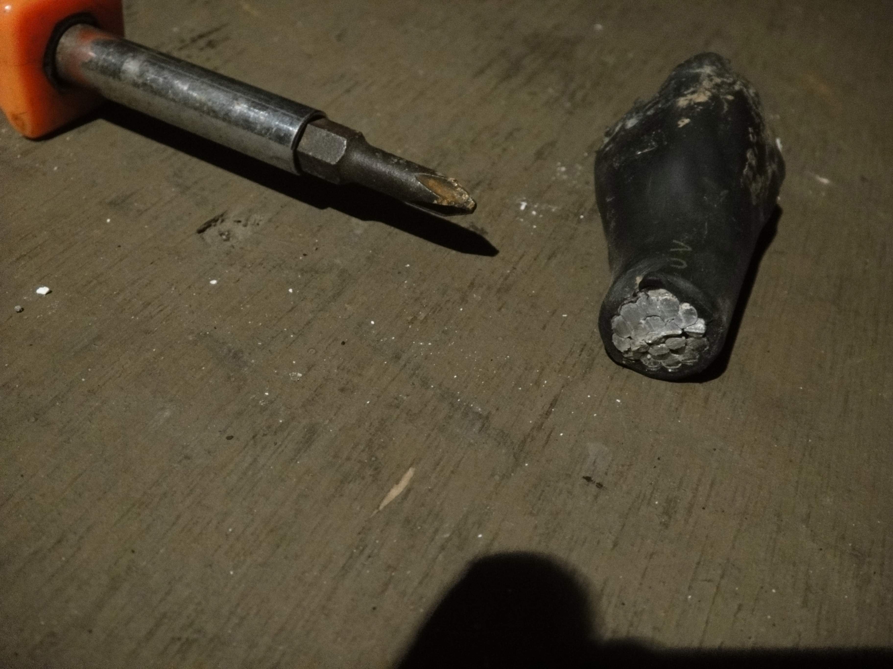

I've got a small shop behind my house that has it's own direct burial service.
It's about 350 ft run, the shop has a 100 amp panel and the wire is 4/0 AL. I didn't put this in but I think this size wire is capable of more amp capacity at this distance.
My house is 100 ft in 3 inch pipe, 200 amp service and also 4/0 AL.
I did have this service redone when I renovated the whole house 5 years ago, so I know this is up to the latest standards and codes.
Make sure you don't let the wire insulation get damaged and back fill with sand around the wire to prevent future damage.
I had a failure on one leg of that DB run caused by a tiny nick that let water in and oxidized the wire to a white powder.
JB.
