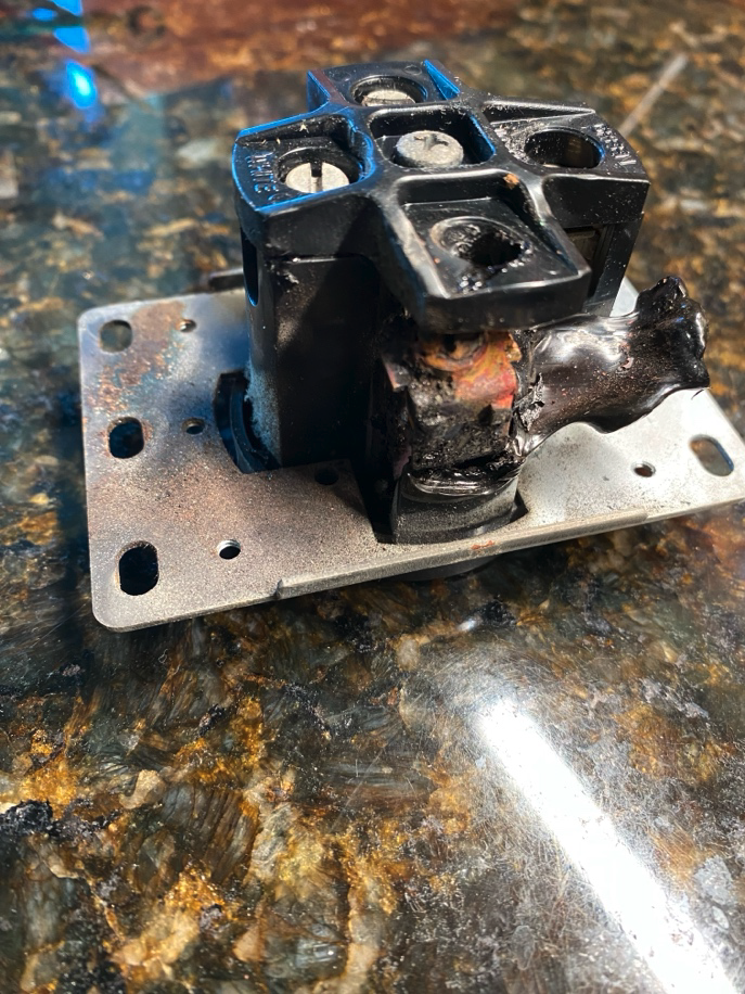

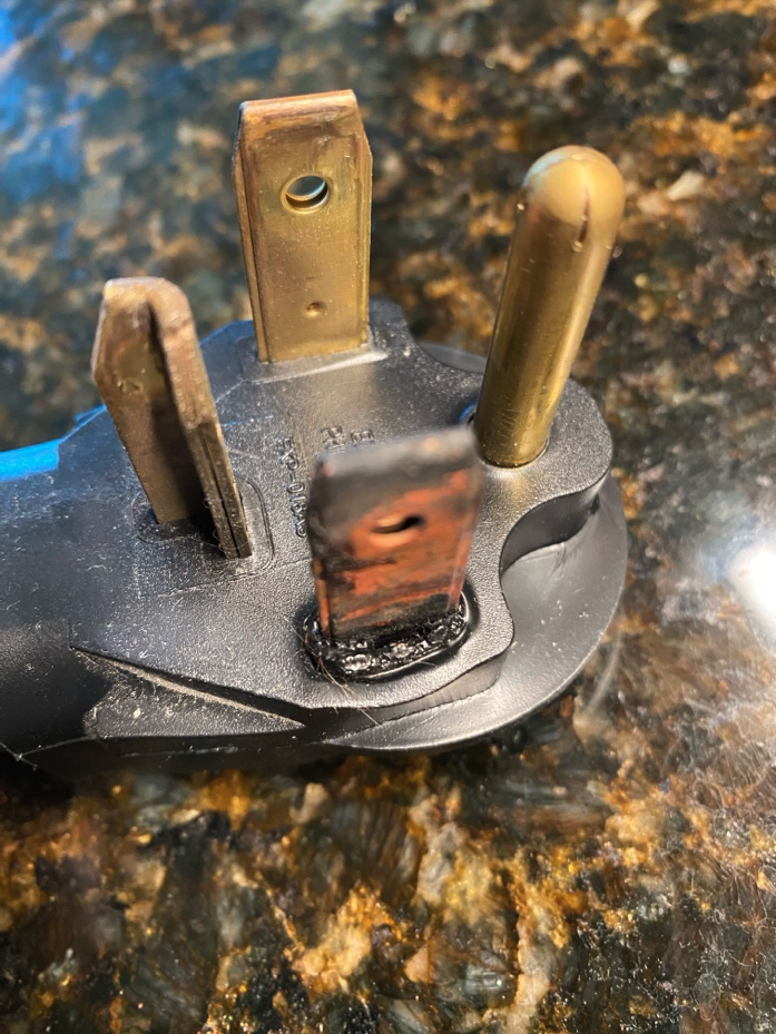

ENSURE TECHNICAL UNDERSTANDING/QUALIFICATION AND REMOVAL OF POWER AT CIRCUIT BREAKER PRIOR TO DOING ANY ELECTRICAL DEVICE INSPECTION OR REPLACEMENT.
I recently encountered a potential electrical fire risk associated with my home clothes dryer. This incident could manifest with most any higher current devices such as electric dryers and electric stoves/ranges that utilize 220 volts alternating current (Vac). Even lower voltage high current devices may be subject to this type of failure mode. Gas ranges may be susceptible to this risk for those that use 220 Vac to heat the oven. Without going into all the details, in a previous life I had occasion to wear the hat of that of a Mishap & Accident Investigator, so I had to scratch the itch nagging at me to understand the root cause. From my cursory examination, user manuals and electrical codes either fail to mention this or adequately throw caution to conditions that can pose these kinds of risk.
Namely, Surface Oxidation can lead to increased contact resistance that in turn creates hot spots produced by localized off-nominal power dissipation.
P watts=(I^2 amps)(R ohms).
One evening while running the electric dryer, an odor not unlike that of burning plastic became noticeable and upon turning off the dryer, that odor soon dissipated. The odor was that of melting plastic. Upon further investigation, the below photos show what I discovered.
View attachment 5504163View attachment 5504164
Initial examination of the dryer plug showed one leg of the 220 circuit plug contact (nearest in photo) having oxidation over entire surface and scorched arcing burns about the tip. Removal of the wall receptacle revealed melting of the plastic housing most pronounced about the 220 contact associated with the oxidized/burned dryer plug.
You might be saying, ” That can’t be! My dryer only pulls 26 amps and the plug and the receptacle are rated for 30 amps!” True, but keep in mind whatever assurances this gives is only good for nominal operating conditions.
Quick back-of-the-envelope estimate of what I encountered after measuring plug-receptacle contact resistance of 15 ohms was around
19,140 watts. Wow...that’s hot. Granted, the actual thermal initiator most likely occurred when the contacts went into an arcing phase as set up by the oxidation. And the initial onset of oxidation likely led to more rapid cascading by the heating of the entire set of contacts, but I haven't tried to replicate that. Good subject to explore for an enterprising STEM student.
Cause and Solution? I live on the Chesapeake Bay in Virginia. House is 70 feet back off the water. Lots of wind...lots of salt laden air that
everything is exposed to, which no doubt accelerates oxidation faster compared to more benign environments. Older installations should also be examined for oxidation, no matter their location. My installation was less than ten years old but was exposed to a lot of salt air.
Replacement of plug and receptacle with every exposed contact getting a thin layer of Ox Gard will hopefully mitigate future occurrences
To further scratch my curiosity as to fires attributed to electrical sources, I ran across the following U.S. statistics. *Fire departments responded to an estimated average of 46,700 home fires involving electrical failure or malfunction each year in

Also, circuit breakers are rated at 80% of stated value for continuous, prolonged use, such as a 240VAC clothes dryer. That is why the circuit breaker did not trip-out, yet the receptacle melted. The normal cause of this in the RVing world is the springy contacts in the receptacle were worn out, which it turn caused poor contact between the plug and receptacle.

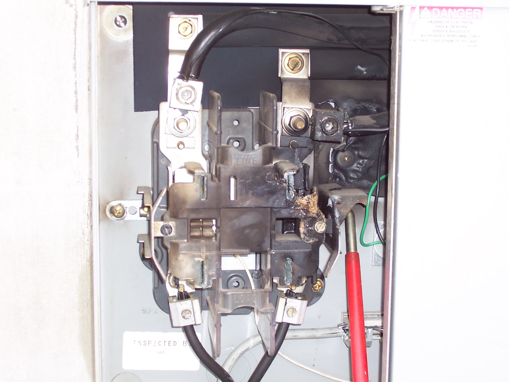

Even electric meter sockets aren't immune from this. Came across this at a work site maybe 20 years ago...
/ Surface Oxidation Increases Electrical Fire Risks #11
@Oaktree Was that one of a series of meters? The upper wiring/busbar configuration looks interesting.
All the best, Peter
