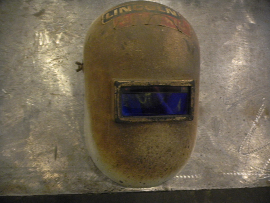

Picked up a box of supplies from a guy off Craigslist. Paid $40 for a hood, slag hammer, gloves, cotton jacket, two boxes of 7018 and a box of 6011. Still planning for the 220 outlet before I can really get started.
The supplies also came with some soapstone sticks. What are those for? The 7018 is low-hydrogen, which means it's supposed to be stored in an oven, right? I don't have an oven, of course. What should I do with it?

Man that sounds like one he!! of a deal!:thumbsup:
Soapstone is to write on steel, concrete floor, etc, etc.
Yes 7018 is suppose to be kept in an oven. But only if you're doing code work! Or if you are going to be welding fairly thick material. Just keep them in a dry place, a lot of people keep them in the house on top of the hot water heater. Below is a link to some testing I did with 7018.
http://www.tractorbynet.com/forums/welding/211904-7018-break-test.html

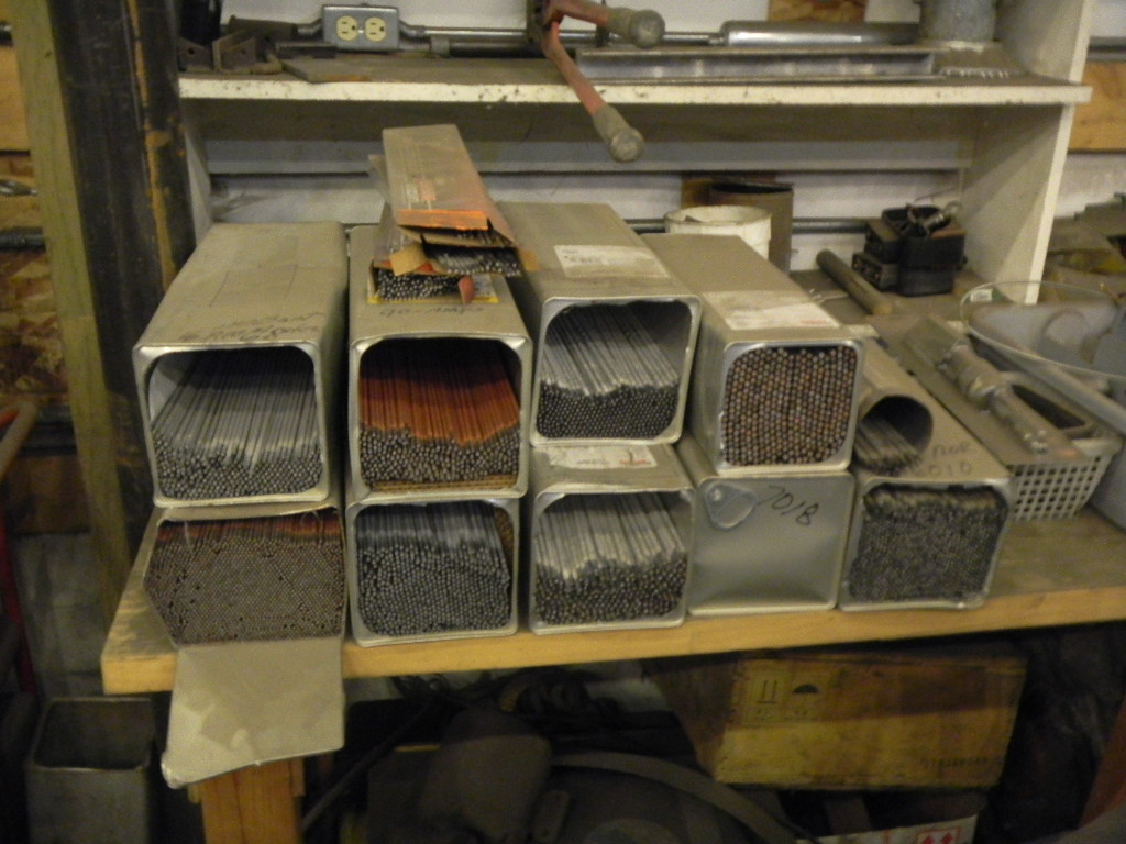

The soapstone is for marking on steel. you will notice not a lot of other things work very well, expect maybe a blunt sharpie.
Now the 7018, If is is still good, and not sat out too long in a damp enviorment put it in one of those harbor freight orange welding rod holders. it is sealed up pretty good with a rubber gasket.. It will be OK for your work.. wont meet code, but you are not doing code work, and neither am I. If it has sat out for too long or gotten wet,.. oh well.. If the rod is rusty inside... well peck off the flux and use the rod for something.. still pretty good steel, just not a welding rod anymore.. What I do is get a fresh small batch of 7018, and put them in the holder right away, take out what I am going to need quickly and seal it back up again. it seems to work for me.. I get good welds.. Don't start off with the 7018.. it is harder to get going, and can be very hard to re-strike (start back up). You can do one of several things to make the re-strike work better: you can fling the rod as soon as you break the arc.. to let blob of "stuff" fly off onto the floor.. not highly recommended. You can file the end of the rod before you re-strike, or you can do what I do, break the "corn" off of the end with my thumb (gloved hand) before re-strikeing. But all that said 7018 are a little harder to learn on than say 7014 or 6011 or maybe 6013,, I am not a big fan of 6013, as it is a low penetration rod, but I keep some 1/16 inch 6013 for that purpose, and they are easy to tack up with also. Then weld the joints with 7018:) Get some 3/32 7014 too to practice with, they make a broad weld bead, and you must turn up the heat a little more and move faster, but they run pretty smooth. Don't buy too much rod at one time.. until you settle in and your skills develop. Plus fresher rod is always good, and 7014 do not require an oven either. 6011 are good for AC or DC and make a little rougher bead but will penetrate dirty metal if you have too.. of course all rods weld better with clean metal. You need to keep some 1/8 6011 around for use on that heavy stuff that might be dirty or rusty. You can use your higher AC settings too with this rod, and you can cut off metal with it if you dont care what the cut looks like.. Just turn it up on AC :) and start poking holes.
Welding Rod Keeper

Over the last few years I've played with several different brands of 6010, and 6011 rod.
With the same joint design, same welder settings, (amps, arc force, hot start) I found Hobart's 335A 6011 to be the best penetrating rod of all of them. Funny thing, Hobart's PipeMaster 60, (6010) is the worst:confused:. But it has the easiest slag removal!
