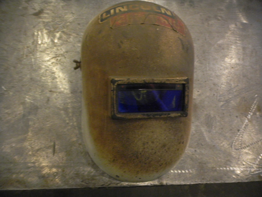

/ Thoughts on this used welder? #32
Well I'm not a pro either, and I was against the auto hoods for years. Main reason was the cost of the clear cover lenses, and the few I had tried I didn't like the head gear. But I bought a fixed shade auto lens that fits my hood, I couldn't be happier! Good thing I'm not a pro huh?;)
