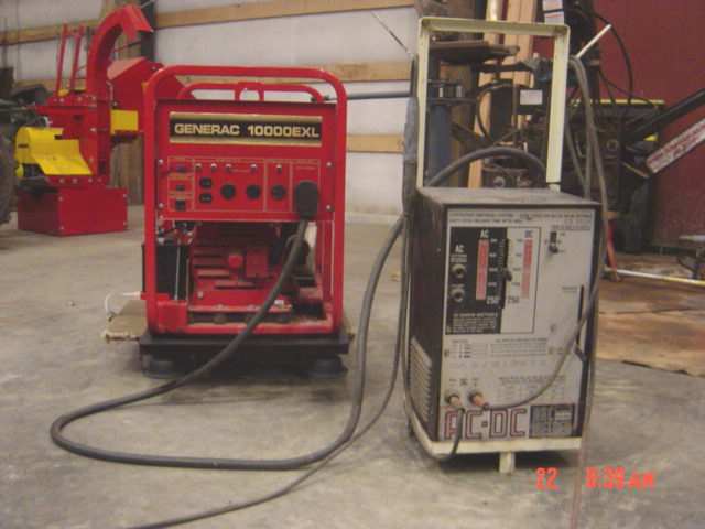

See if you can find the manual, for the wards 220 volt welder, online and get the input current rating needed for it.. but it may be close to 50 amps. so 220 volts X 50 amps =11000 watts.. so you are not going to run it full bore on the genny.. BUT you can likely run some of the smaller electrodes like 3/32 6011 on AC and try some 3/32 7018 on DC at about 75 or some 7014 at 100 amps. That should be maybe 20 amps input on 220 volts. for 4400 watts input. Your genny is likely to work here. But ideally you get some 220 out to the shop. New Inverter welders are a little more efficient than a transformer unit like this one, but $100 is hard to beat if everything is working.. DC is one heck of a lot better than AC, especially for a beginner in my opinion. So much smoother arc, and opens up more electrode choices. The old Wards is infinitely adjustable by moving that lever in the middle. I have heard they can get dirty connections wise, but it is a chance you take, Overall tho, I think it is worth the risk.

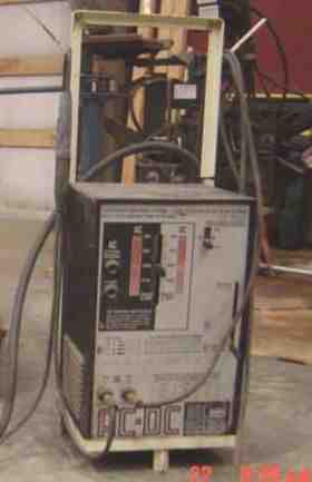

I bought this welder back in the 70s. Really not a bad welder at all! Did a lot of Tig welding with it. Only stone I could throw is when Tig welding and you only want 3 or 4-amp change, the slide arm can be aggravating! I ran this welder on a 30-amp dryer outlet in the garage for a while. If I remember correctly I could only run about half of a 1/8-inch 7018 before it would trip the breaker. But if I didn't stuff one rod after another I could run 3/32-inch 7018 OK.
I tried it on my 10,000-watt generator just to see if it would work, it did.

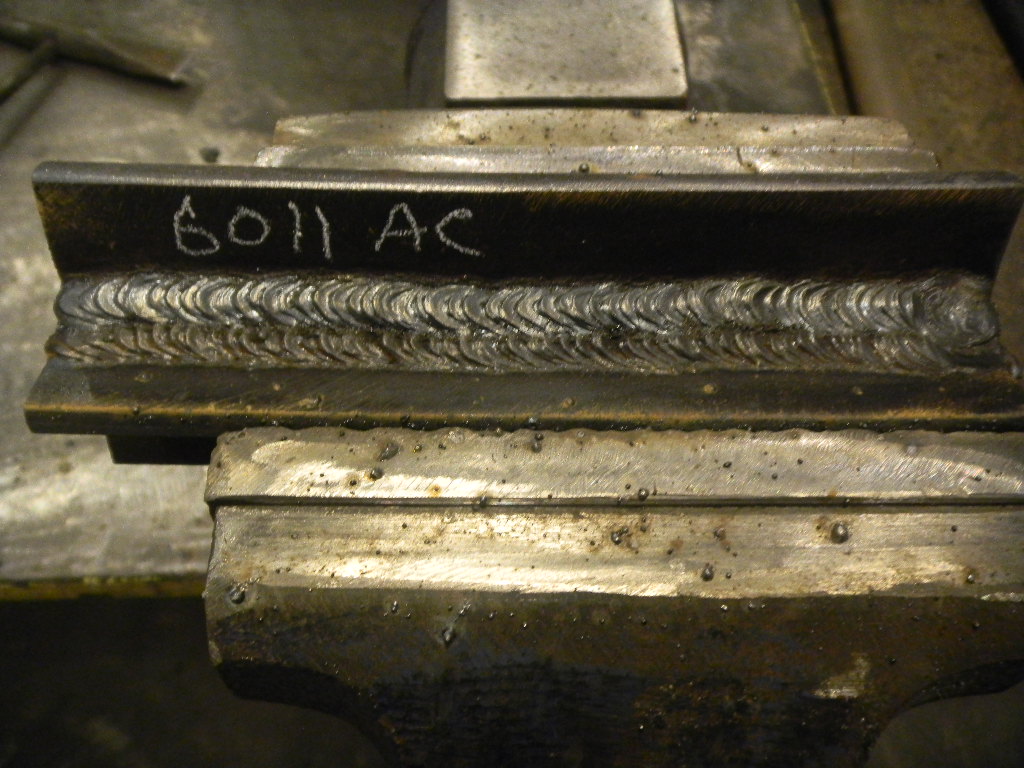

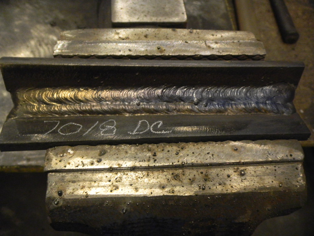

Here is some welds I did awhile back, after digging my Montgomery Wards welder out of the back of the barn.
