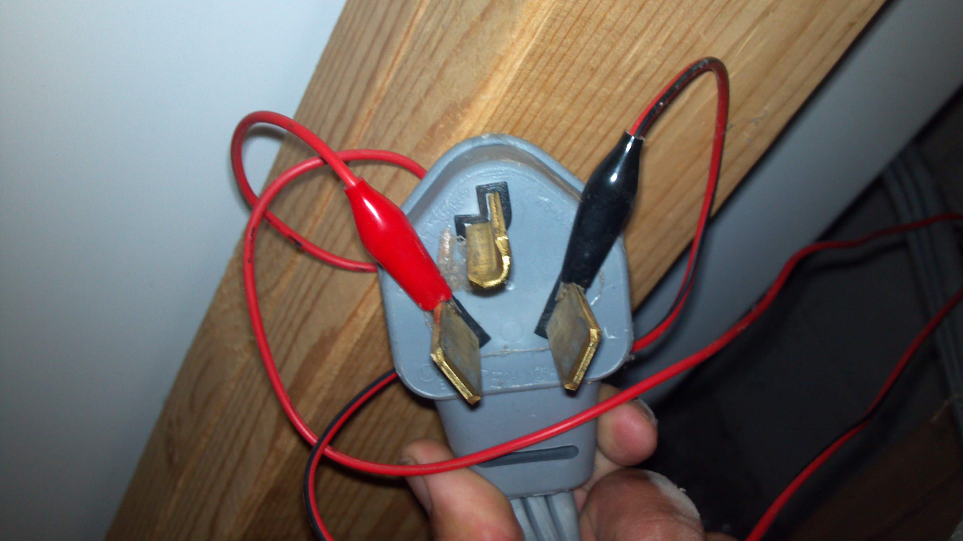

#59
Good news! I rigged up some leads to just the fan (not the welder) and alligator-clipped them to my dryer plug's hot pins so that I could continue to work on the fan. A little WD-40 brought it back to life. It looks like this one's a keeper!
Whooo Hoo!.. got her going! Now I gotta say.. You have guts enough to do that, I bet with a little help you can hook up that box and and put in a 50 amp breaker.!
