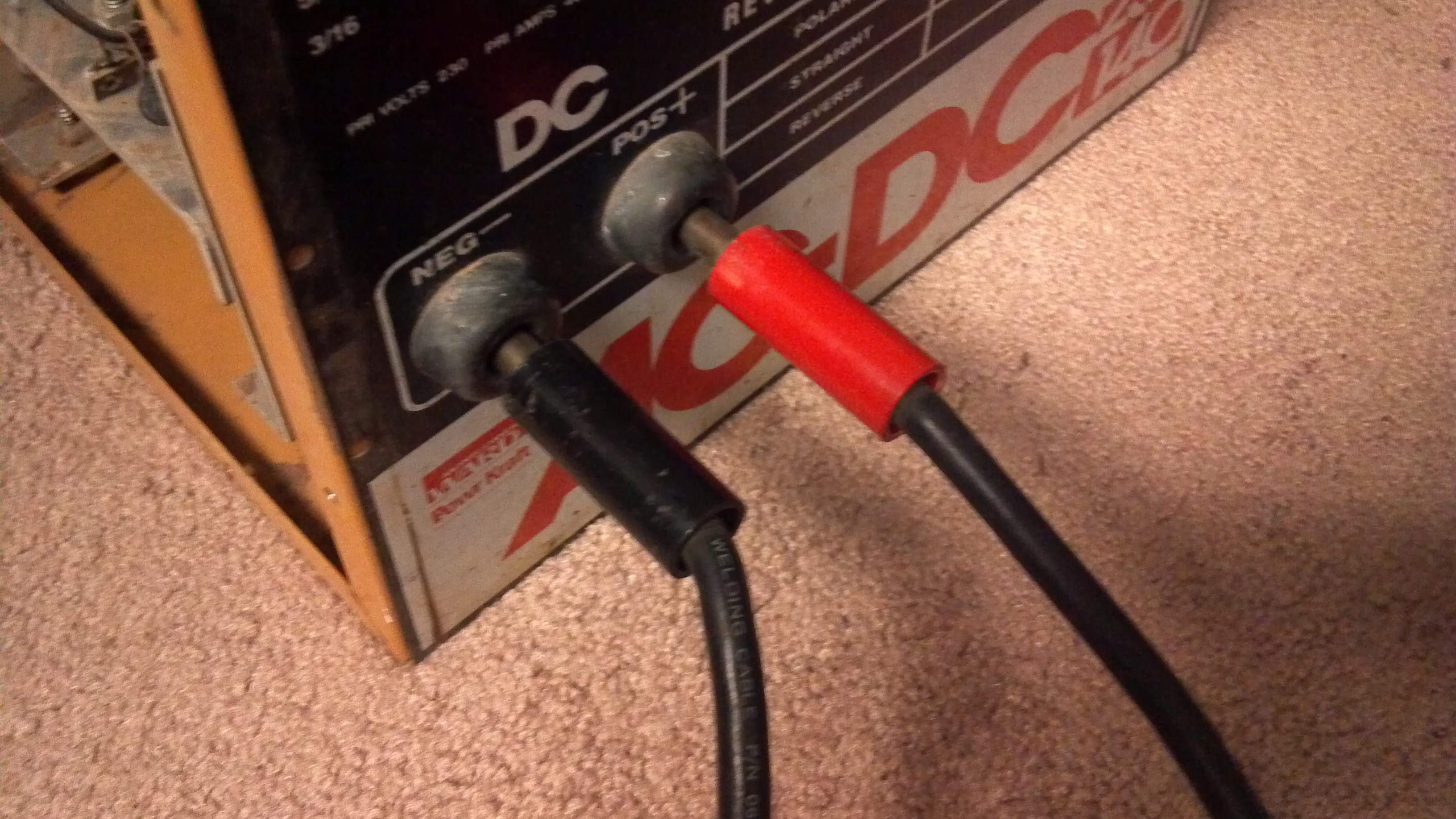

can you post a picture with the leads plugged in {dc}.oil the fan bearings.get some 1/8 6011 rods.burn them about 100 then burn some at 120.maybe we can figure out why dc is not working.

Here's a photo of the leads plugged into the DC terminals.
I am looking into whether I may have a bad rectifier. As a start, I put a multimeter on the DC terminals. I measured 55 VDC, which if I understand correctly is about the right range. On a hunch, I set the multimeter to AC and measured 22 VAC. I don't know a lot about rectifiers, but should any AC at all be coming out of there?

I did a little more testing with a multimeter. The rectifier bridge has four diodes as near as I can tell. Two of them show 3.3 MOhms through them and 0.44 volts drop using the multimeter's diode test function. The other two show 2.5 MOhms and 0.41 volts drop. Not knowing the specific model of the rectifier (I will have to get a mirror to read it, I think) I don't know for sure whether this is within spec, but it passes the most basic diode test: you have a voltage drop one way and an open the other. (I verified the opens too.)
EDIT TO ADD: Of course, with mega-ohms of resistance one way, perhaps it makes more sense to conclude that the diodes are open both ways.

Best way to tell is test the diodes and see if they are good. Not real hard to do once you locate the diodes. There should be 4 of them. They may look like this DIODE. Here is a description of how to test the diodes. DIODE TESTING.
According to your test, the diodes should have a resistance of between 0 and 1 ohm. Mine have a resistance between 2.5 and 3.3 mega-ohms. That certainly would seem to cause cold welds. However, I have not disconnected them from the heat sink (would require desoldering) and I read that that may cause incorrect readings.
EDIT TO ADD: A thread on the Miller forum indicates that diode resistance over about 1 mega-ohm should be treated as "open" and indicative of a bad diode. Sounds like I have four bad diodes and the next step is to replace them. Good thing I know how to solder! Now to figure out what the correct part number(s) are. Urgh.
I know that heat is one of the main things that causes diodes to fail. What do you want to bet a previous owner operated the welder with the broken fan and toasted the diodes? Oh well. I said when I bought it that $100 was a fine price for an AC-only welder in this range. Looks like that's what I ended up paying for. It even came with a nifty hand truck included! :rolleyes:
