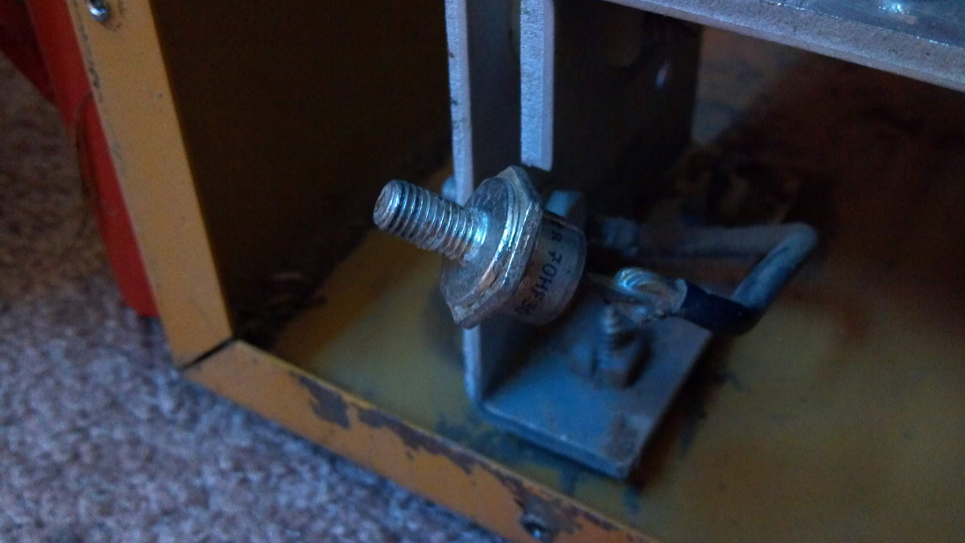

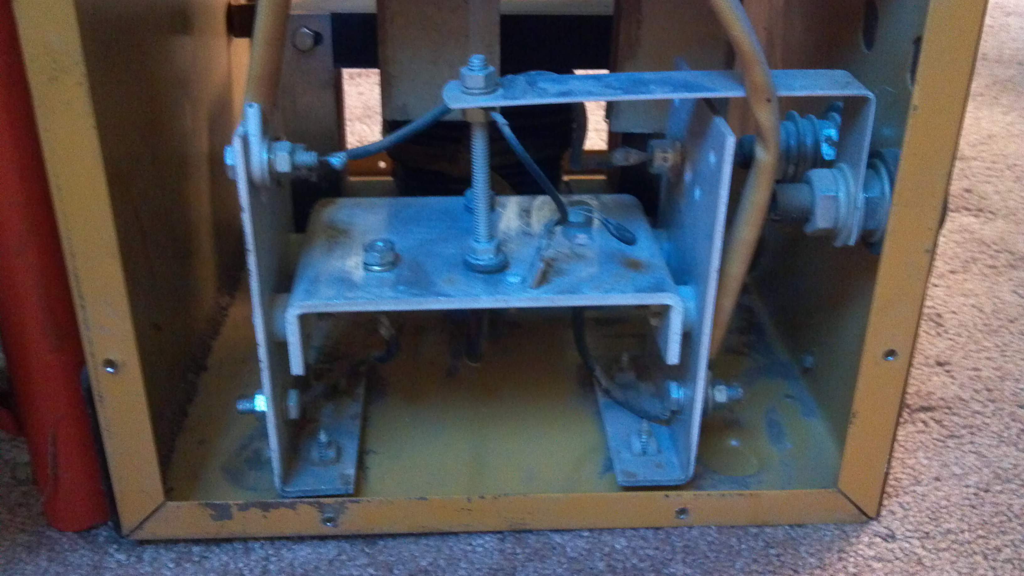

The diodes are labeled IR 70HF30, and then on the other side, 80 32. A little google searching turns up this thread on WeldingWeb. The innards of that welder look identical to mine and the label on the diodes matches.
Photos below show my entire rectifier array, and then a single diode.
Looks like that WedldingWeb thread has links to replacements. That may be my next step. I'm a little befuddled because the diode test function on my multimeter shows a "correct" value of about 4-5 volts for the diodes, but the resistance function shows 2-4 Mega-ohms, which my understanding is should be treated as an open. I don't know how to resolve that. If I had to jump right this minute, I would say, "Well, it doesn't weld right on DC. We know the AC transformer is good. What else could it be than the diodes?" It looks like there is an additional transformer as part of the DC circuitry. Is there some way I can test that? What other tests could narrow down the problem before I just pull out my wallet and cross my fingers?
View attachment 281870View attachment 281873
Joshua, that "other transformer" is likely just a choke. In other words a coil with a iron core. An inductor.. Should just have 2 leads.. and they should have a very low resistance, maybe an ohm or less. I would check the diodes by un-soldering one connection to each of them and make sure they conduct one direction (low resistance)and reverse the leads and they should look open. I always use an analog meter, for checking semi-conductors, less confusing that way. I would use the Rx100 scale. Part of being a good diagnostic tech is being totally familiar with your equipment and from checking hundreds of diodes and transistors, knowing exactly what a defective one and what a good one look like on the meter. Easy for me to say, having checked thousands of semiconductors. But if you do have some known good silicon diodes, you could compare them to your International Rectifier 70HF30 diodes to be sure before you invest in new ones. Have you found a schematic for the unit, to verify for sure that this other device is a choke? Hopefully we can get this machine going again and get you some welding practice.
I think you're right about that. I will double-check, but I think you're right.
Since the diodes are soldered on on side and bolted on the other, can I just un-bolt the "bolt" side and avoid desoldering? Or do I need to completely disassemble the diode from the array?
Coincidentally, I just a few months ago had to replace the rectifier on a motorcycle, which is basically the exact same thing we're doing here, so I have some idea what a good diode should look like. In that case, though, they gave a specific voltage range that the diode should read on the diode test function of the multimeter. Here, we only have nominal values to go off of. In my previous test, I found the following:
The rectifier bridge has four diodes as near as I can tell. Two of them show 3.3 MOhms through them and 0.44 volts drop using the multimeter's diode test function. The other two show 2.5 MOhms and 0.41 volts drop.
That was with the diodes connected to the array. I un-screwed the nut from one of the diodes and half-way disconnected it from the array (would have to desolder to do the other side) and verified that the result was the same. If I need to desolder the diode and test it on the bench, I can do that too.

Just the unbolting should be fine for the ohm test. The higher voltage rating will be fine.. In fact more than fine.. better,, as well as a higher current rating would be good. But first lets ascertain for sure that the diodes are in fact defective. They are most likely the culprit, but we need to know for sure.

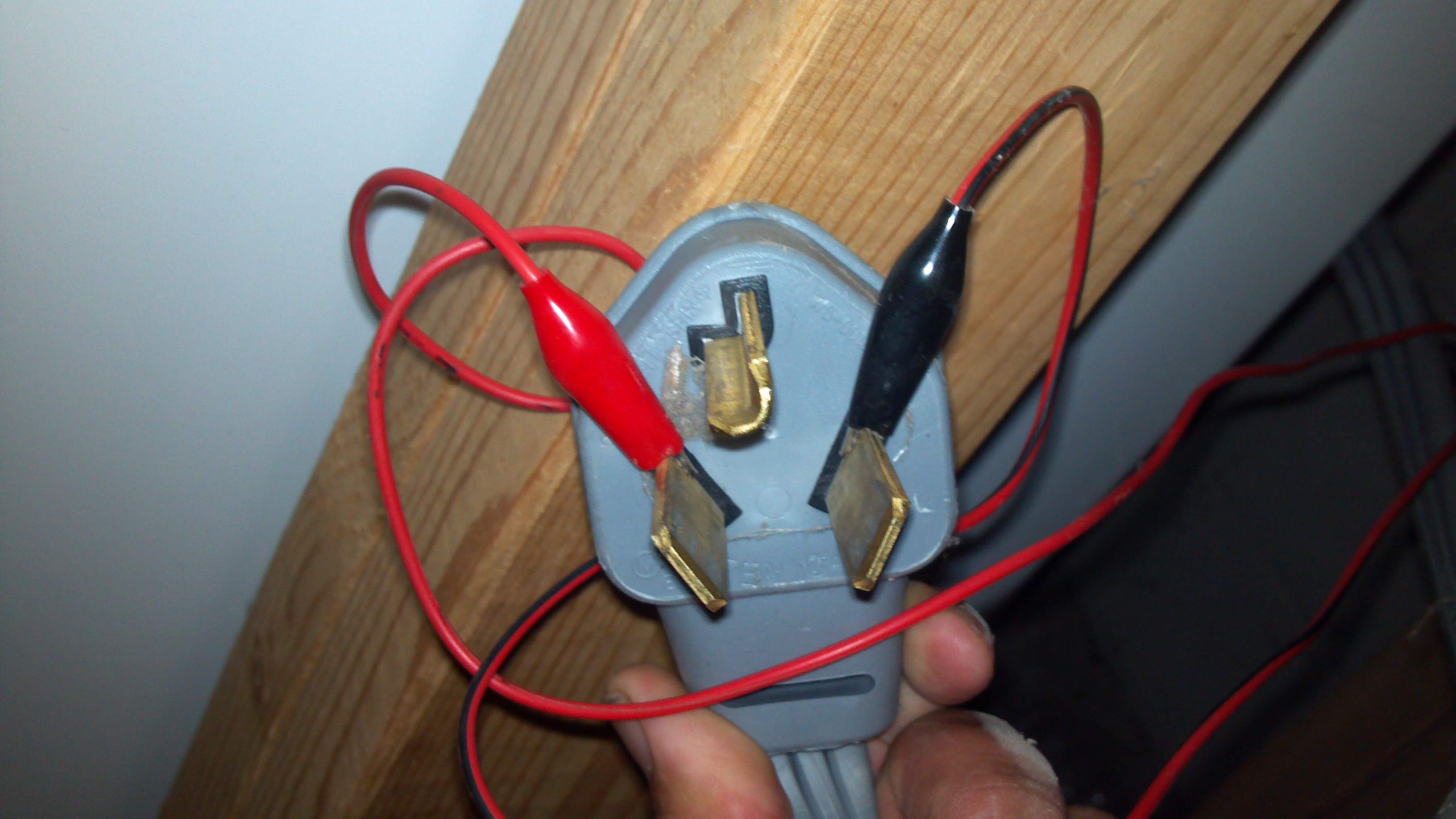

Joshua, one thing you could do if you want to rig up a "testbed" is get a 12 volt battery or 12 volt power supply, and at least a #57 lamp (typical old fashioned taillight) or a headlight from an old car, and put the diode in series with the circuit. One direction the lamp does not light at all. the other the lamp lights to near full brilliance (slight voltage drop). Just an idea, should not take too long to set up if you have these things. But this would test these diodes under a little bit of a load.
James K0UA
/ Thoughts on this used welder?
#109
Okay. Well, I've got good news. I did as you suggested with a tail-light and a 12 volt battery. I disconnected the post-end of each diode from the array and ran the bulb through it, then used the diode-check function of my multimeter. The results were different! Three of the diodes, the tester showed 0.702 volts. The third one, it showed 0.695. As I understand it, that's dead-on right for silicon diodes. I also checked the resistance of the diodes while the 12 volt bulb was running, and they showed 0.00 ohms. This seems to indicate that all the diodes are working correctly.
I also ran the bulb through the whole rectifier array, with the hot lead clamped on the wire leading into the array and the negative lead plugged into the + lug on the welder, and the bulb lit up brightly.
So... where does that leave us?!
/ Thoughts on this used welder? #110
So basically the current will only go thru the diode in one direction and not the other, that's important.
The voltage drop across the diode looks good. They usually fail by shorting or open circuit. Open would have full voltage drop across it in either direction and short would be no or very little drop. Sometimes, as James, alluded to, they will appear to be ok until a decent amount of current is passing.
