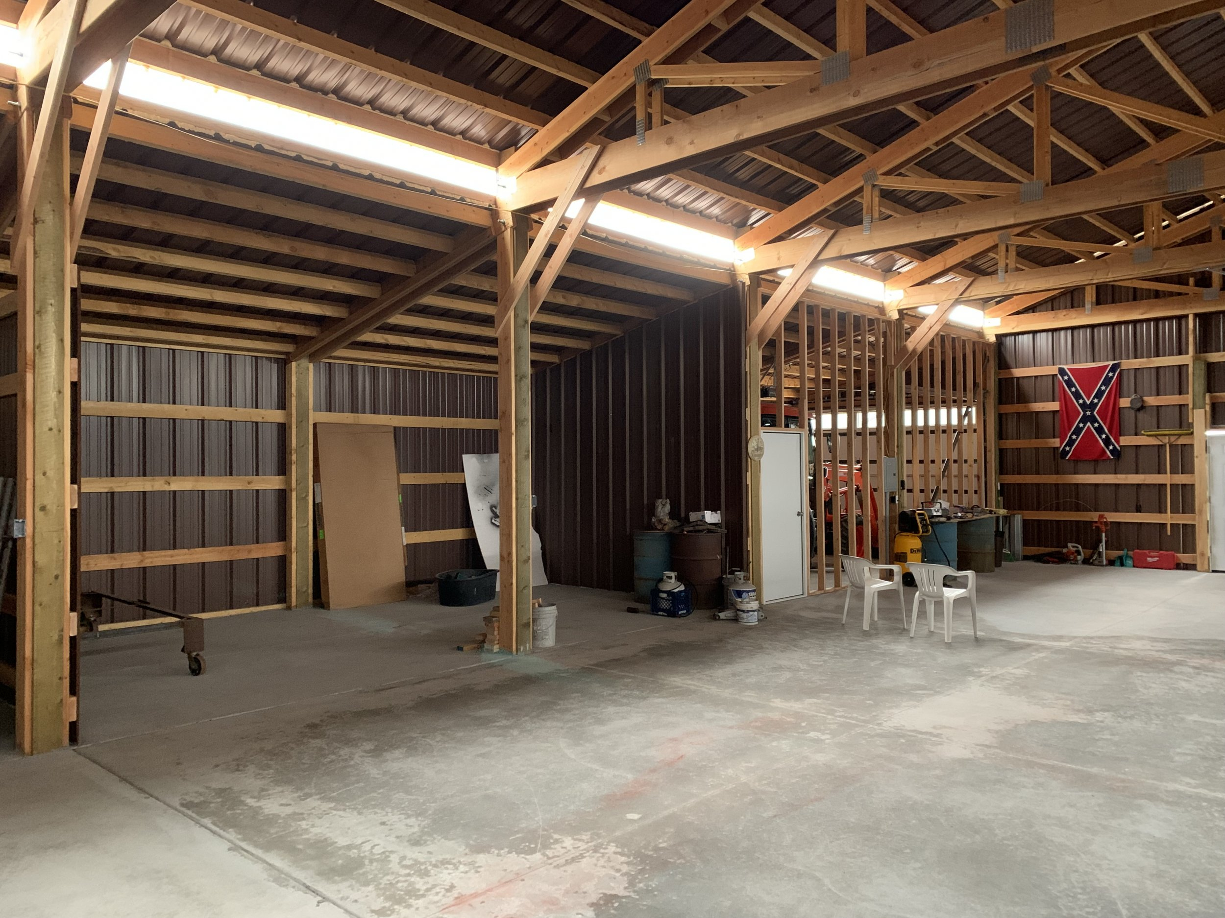

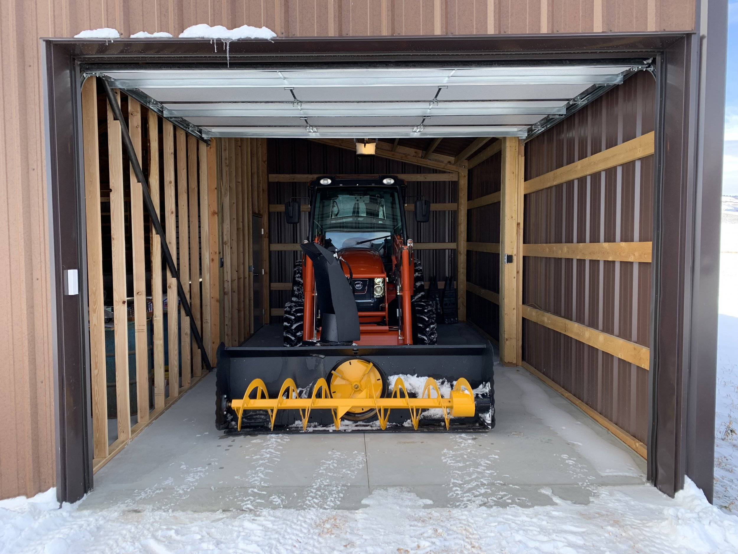

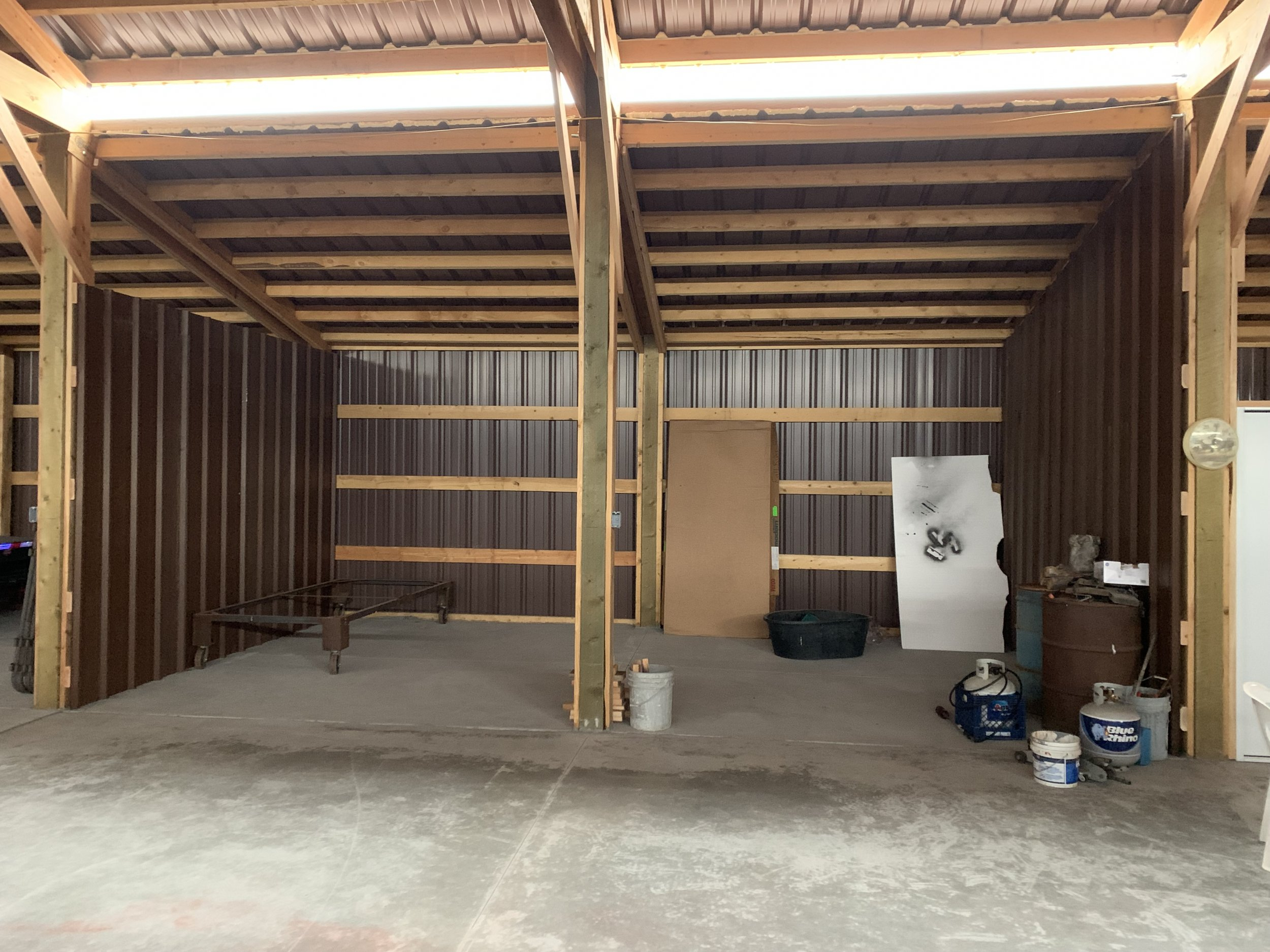

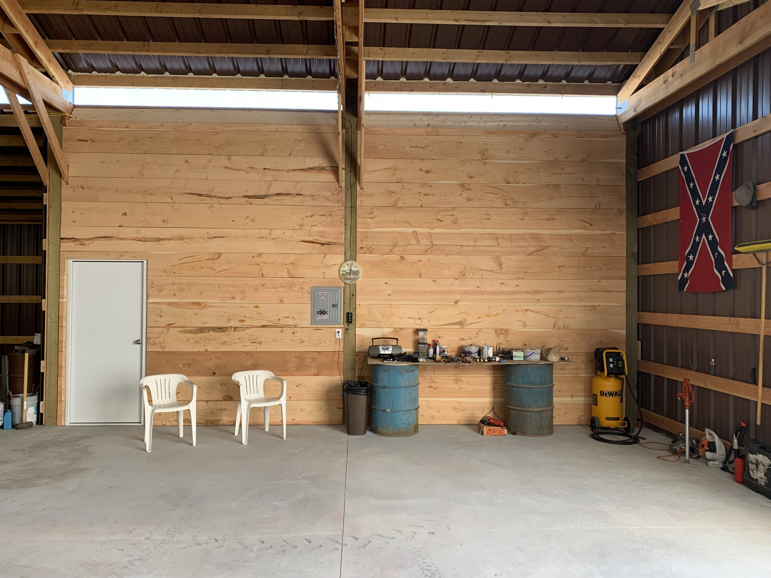

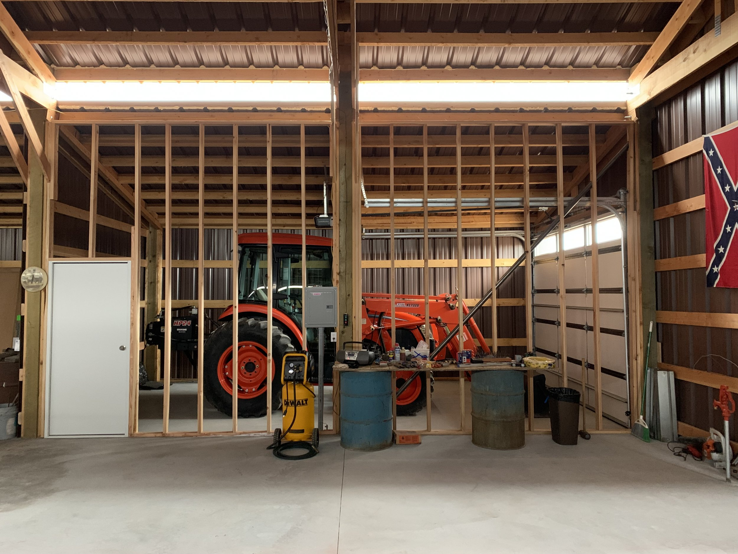

Now that the outside is completely done it's time to get the inside how I want it.
I needed a place to store firewood and a heated place for the tractor. Plan is to foam insulate the tractor area and I'll just use a 6' electric base board to heat it. I only want 40-50 degrees to ensure I don't have fuel/starting problems in the winter.
I'm waiting for it to warm up so I can continue the electrical work. I have most of the plugs done and some lights but still need more. Also a nice work bench where the blue barrels and plywood are.
Worth noting that currently the building has only a heavy duty extension cord plugged in on the back patio of the house running through the conduit into the panel in the barn. I'll run permanent power this summer after I get the hay shed done.

Someone ask what I was putting in the barn; well here's some of it. My enclosed snow machine trailer is supposed to go where the small flat bed trailer and 4 wheelers are. It will when I get a shorter trailer. (less tall) I'll rearrange the crowded corner later on. Last fall I was trying to beat a storm that was coming and I was just getting stuff inside as quick as I could.
I took the last picture to show how much light the translucent panels let in. There are no lights on anywhere for the picture.

Those panels really do let in a lot of light!!! I'm torn between doing something similar, and wanting to max out the insulation I put in the building, when I build mine. I love the look of your building too.
/ The last Barn. (maybe)
#96
Thanks Eddie,
If good insulation is your goal these panels might not be the best way to go. I would put in actual windows that you can insulate up next too.
If I ever insulate and heat this barn it will be with a used oil heater so leaking lots of heat out of these panels won't be such a big deal.
