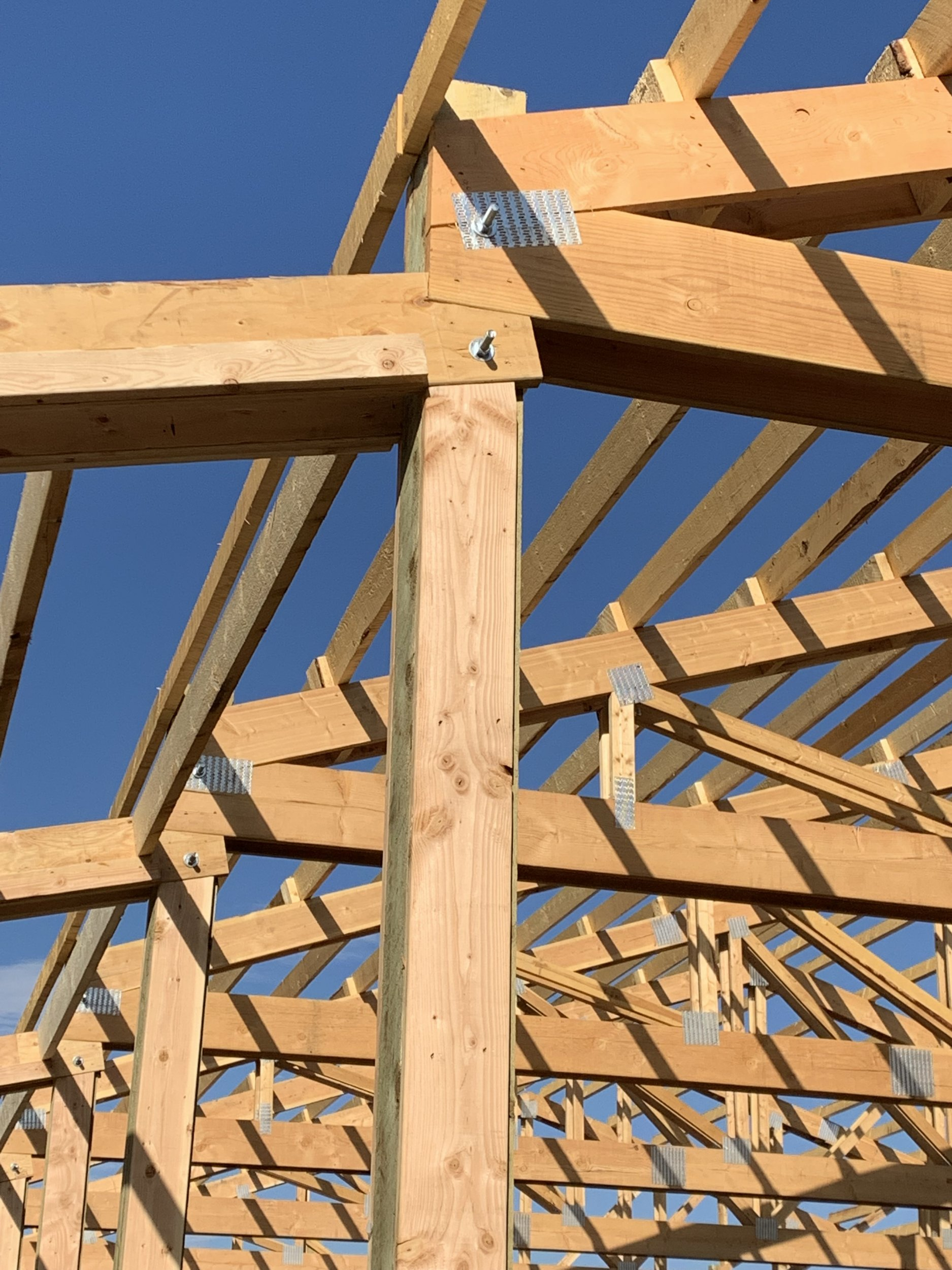

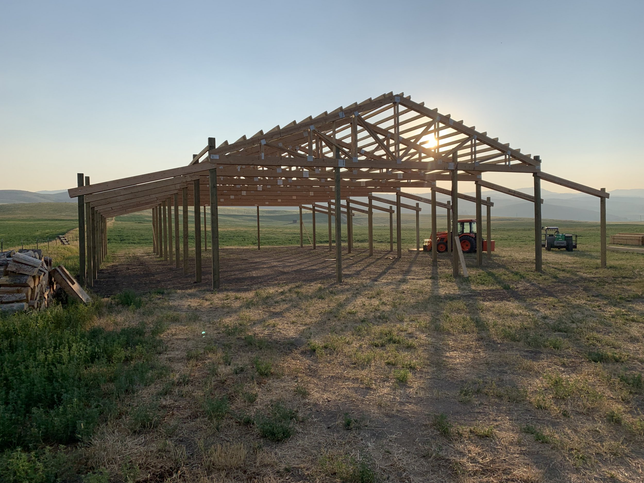

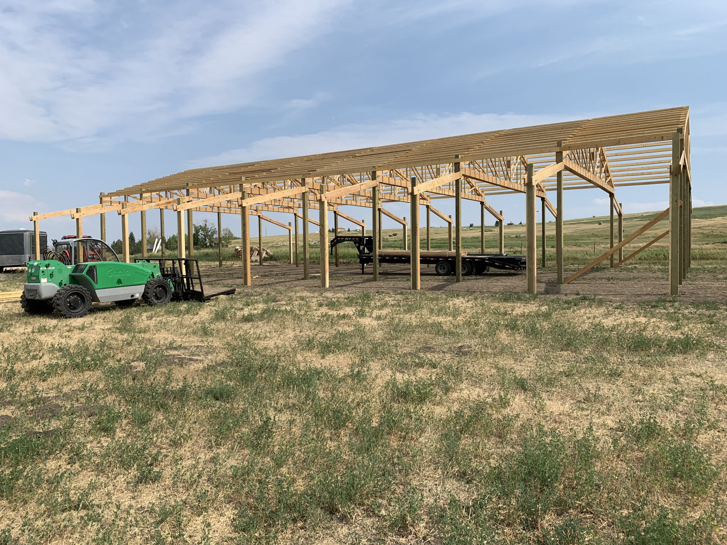

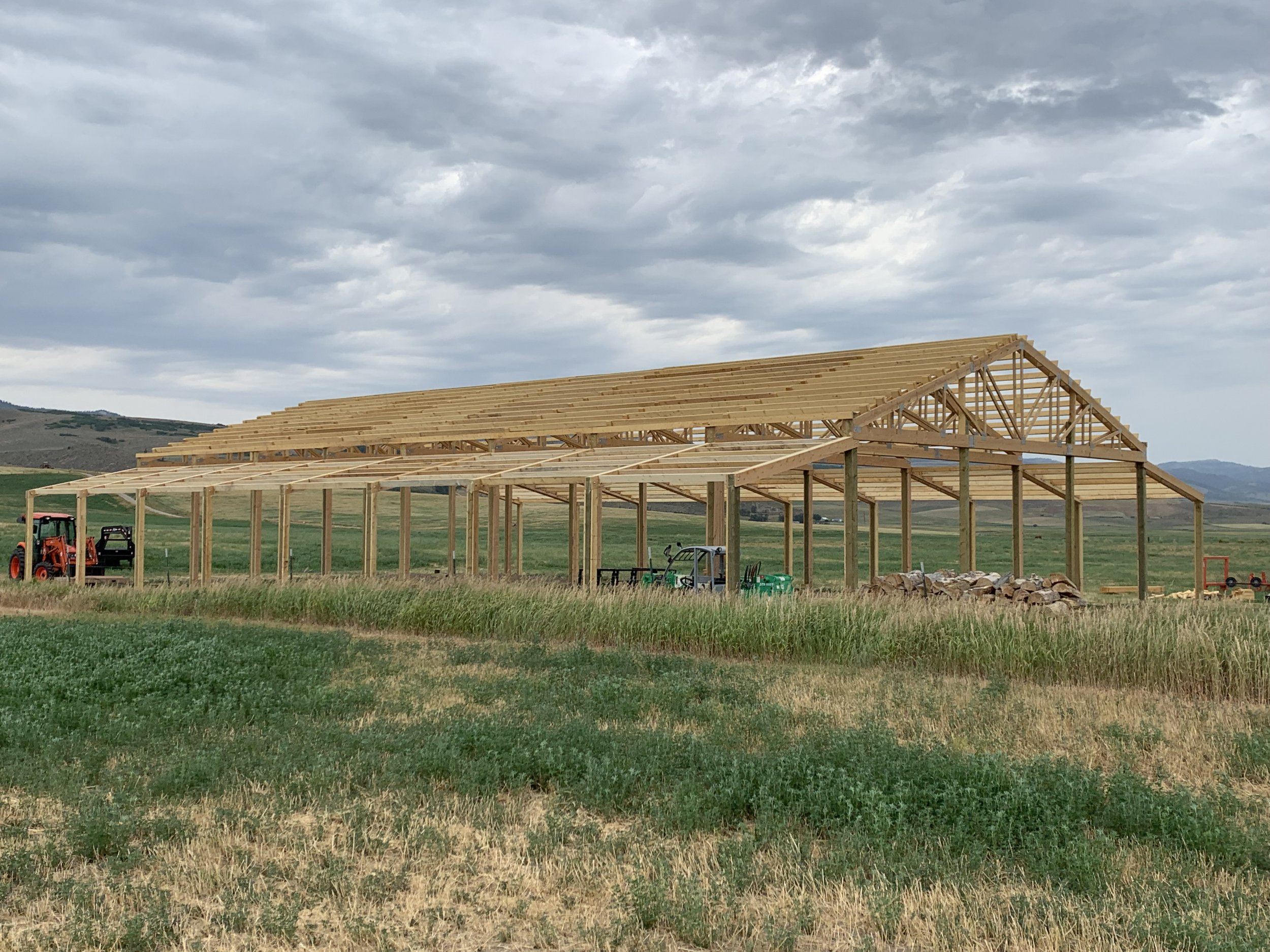

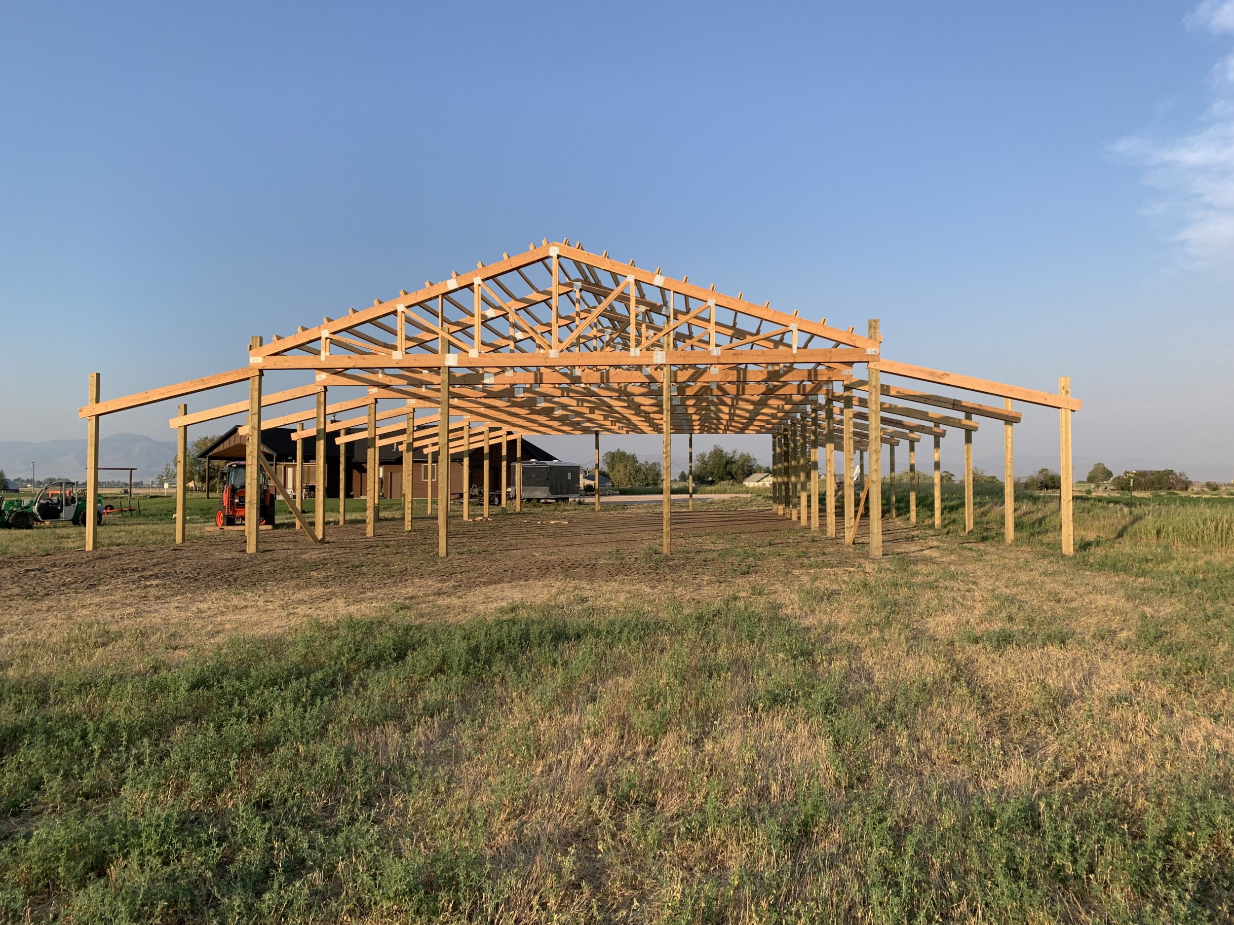

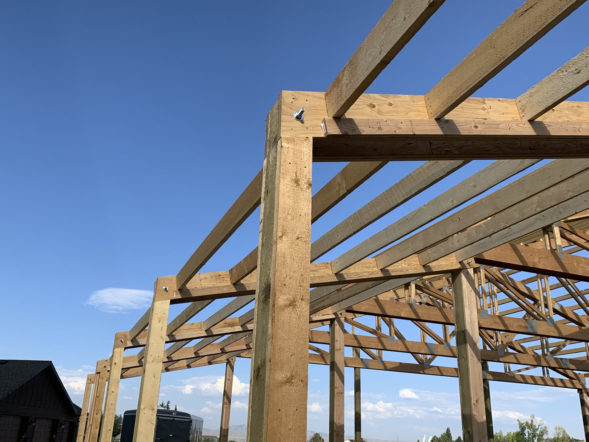

/ The last Barn. (maybe) #47

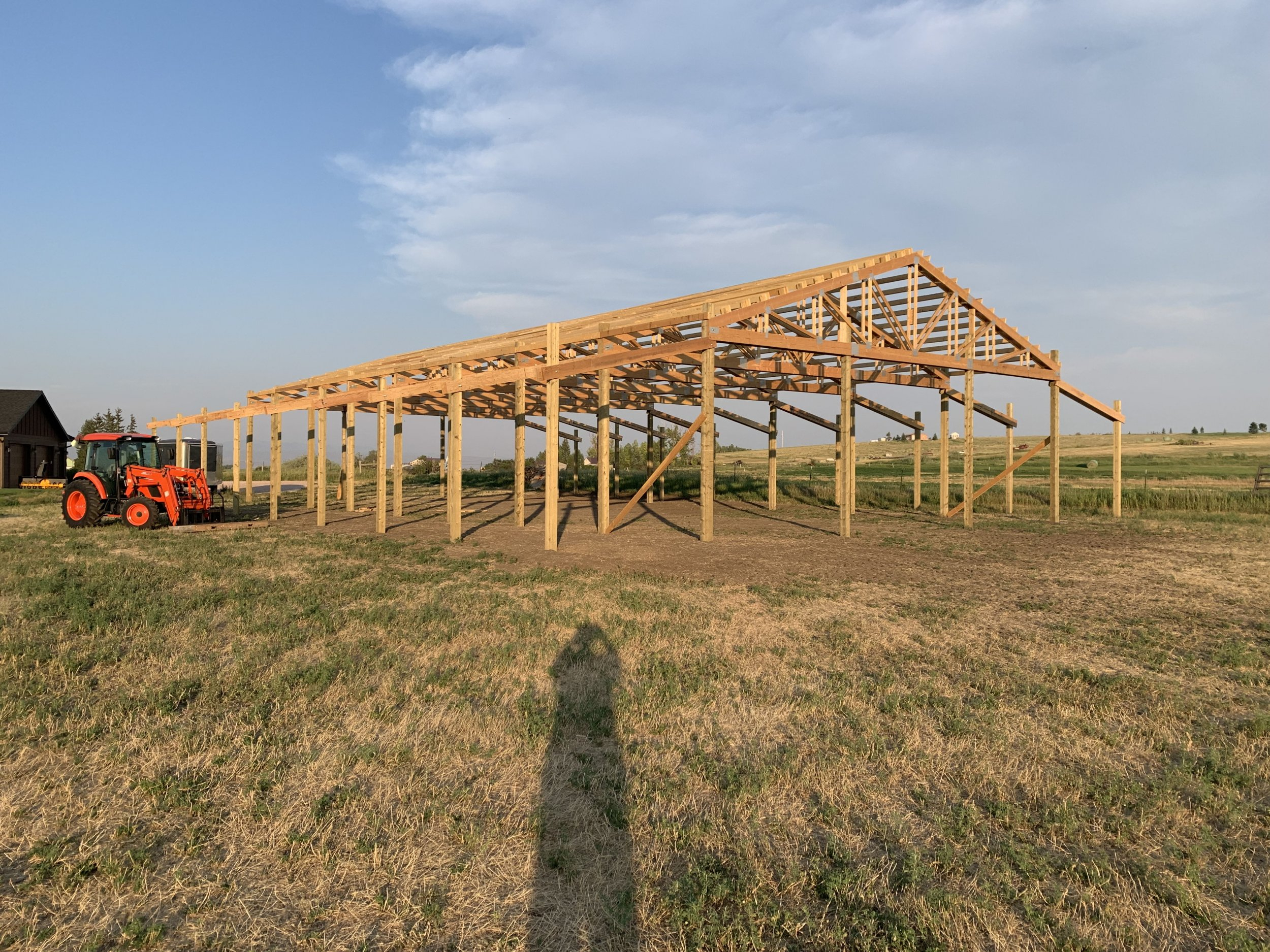

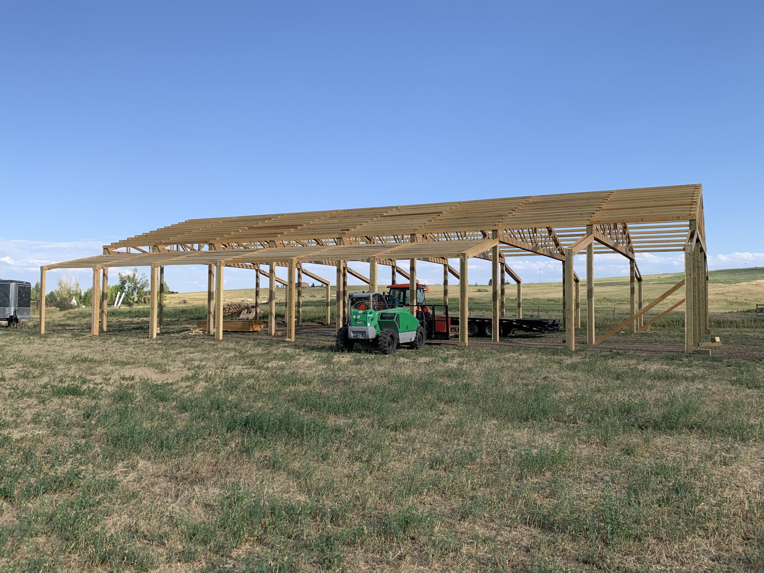

Excellent thread. Very interesting. Great description and PICTURES. Thank you. However, I am still amazed at the span of the trusses. I built a barn 30 x 50. I found it cheaper to have the trusses built for me than buying the lumber. Those are heavy trusses. Were you worried that the truss sections may be heavier than the equipment would be able to lift. Very nice, beautiful scenery.
#48
Did your buddy predrill all the screw holes in the panels? I always think that requires a LOT of confidence in the substructure construction. :)
No way, those purlins aren't that straight. o_O
If I would have had OSB maybe, but straight on the purlins that would have been a problem.
#49
Thanks
The answer is yes I was worried about the lifting strength of the boom truck. At times we had to help and push the sections up while not getting under them. :oops:
I did buy the trusses already built. I just hooked them together with the little boards then added the purlins and lifted them. Each truss weighed 450 lbs. So double that for each post add all the little boards then purlins, yes it was very heavy.
Not sure I mentioned it but the middle section is 45' wide, awnings are 12' inside measurements.

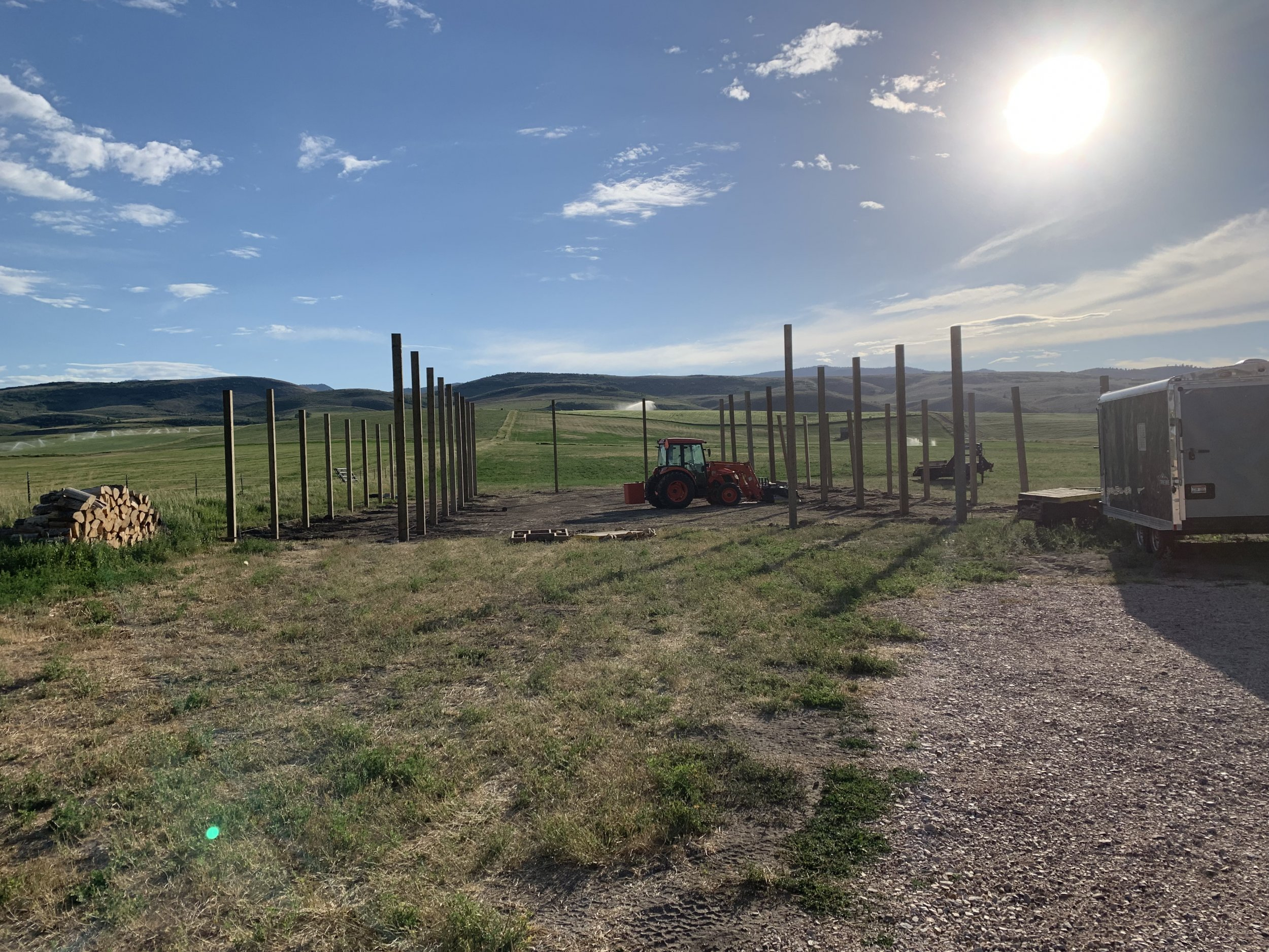

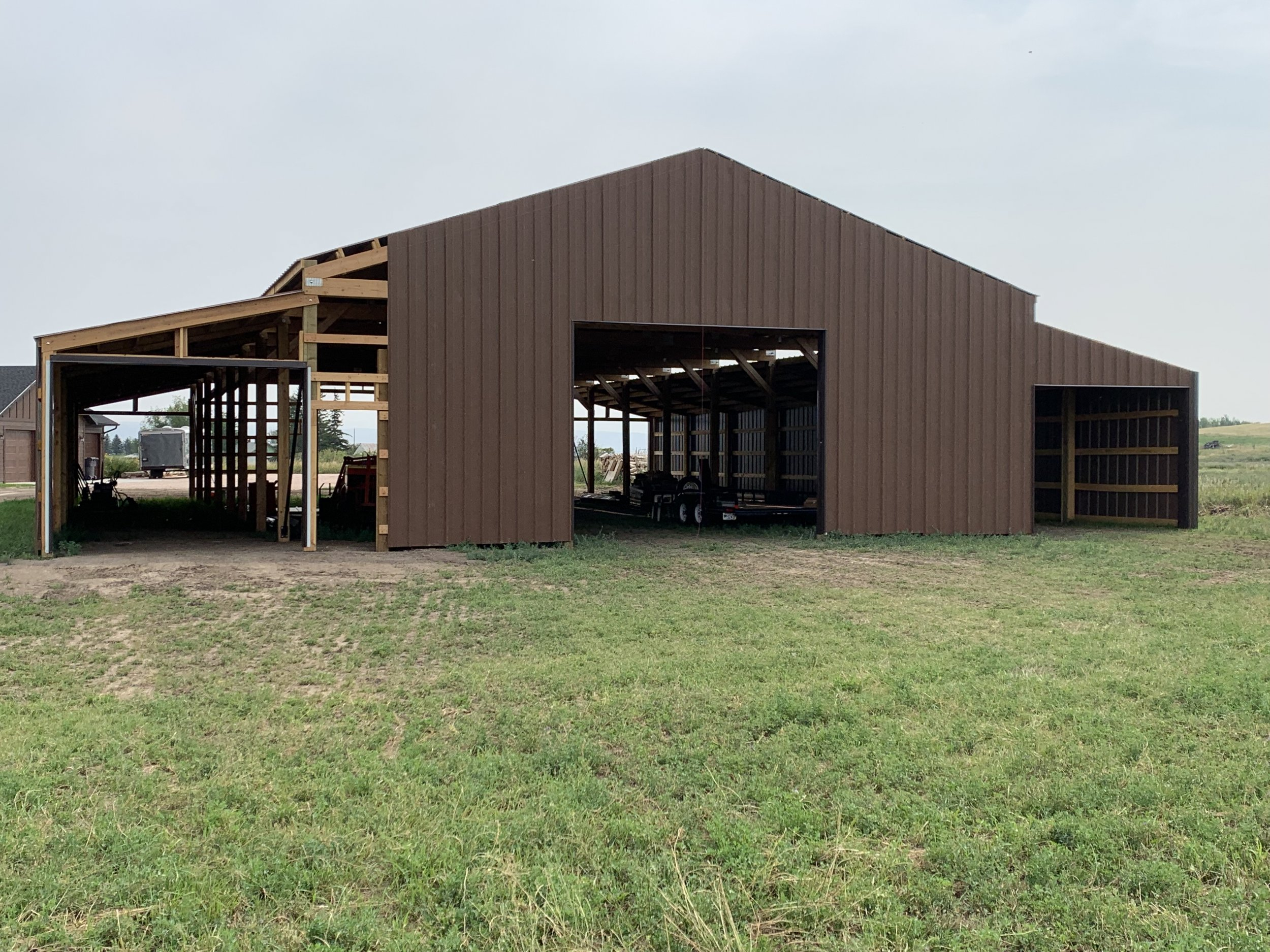

Hard to see but I added a hydrant (soft water from the house) so I could wash my truck/tractor in the shade. I run the line while the house was being built, just had to find it. It started raining while I was covering the trench, had to stop working.
#51

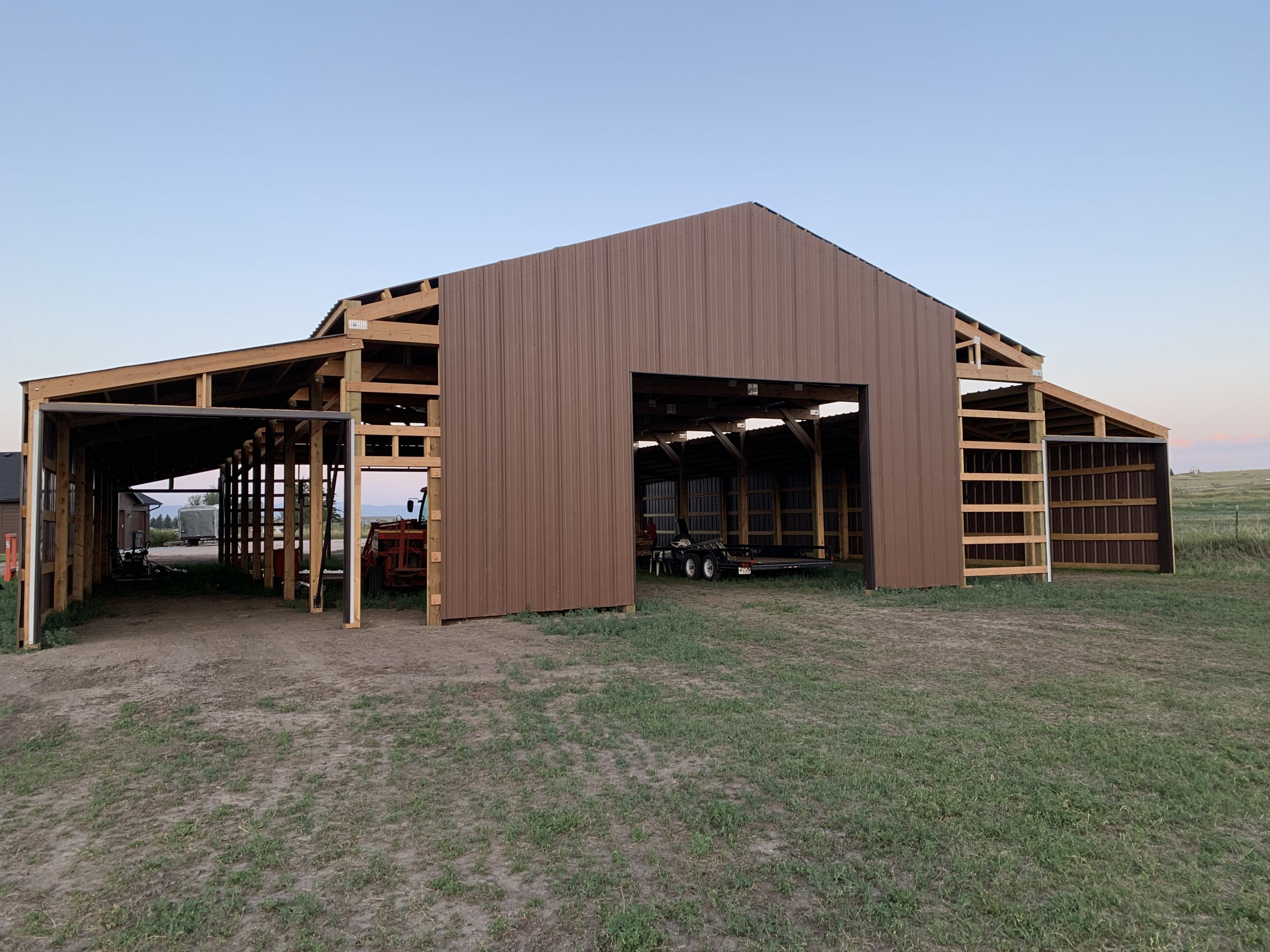

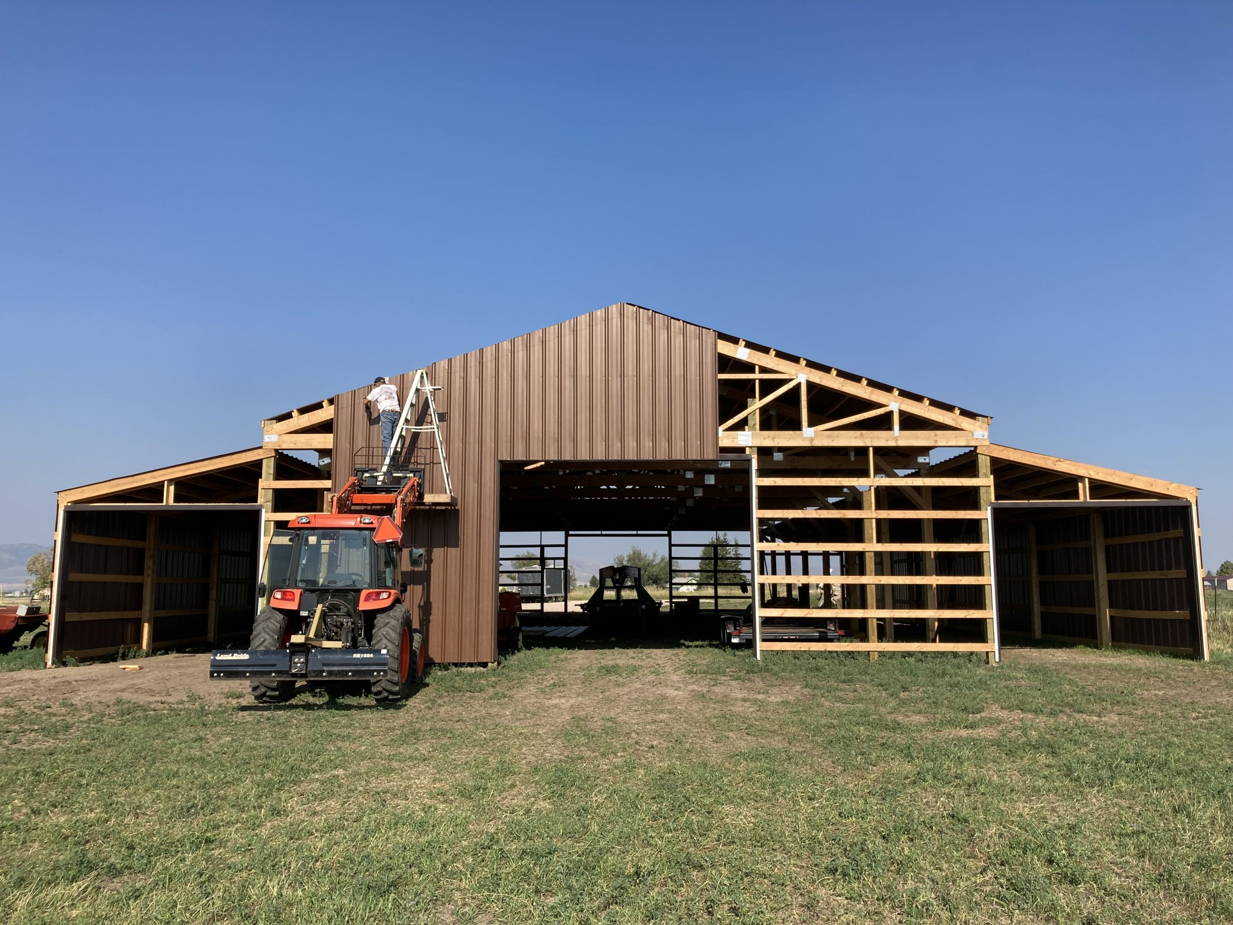

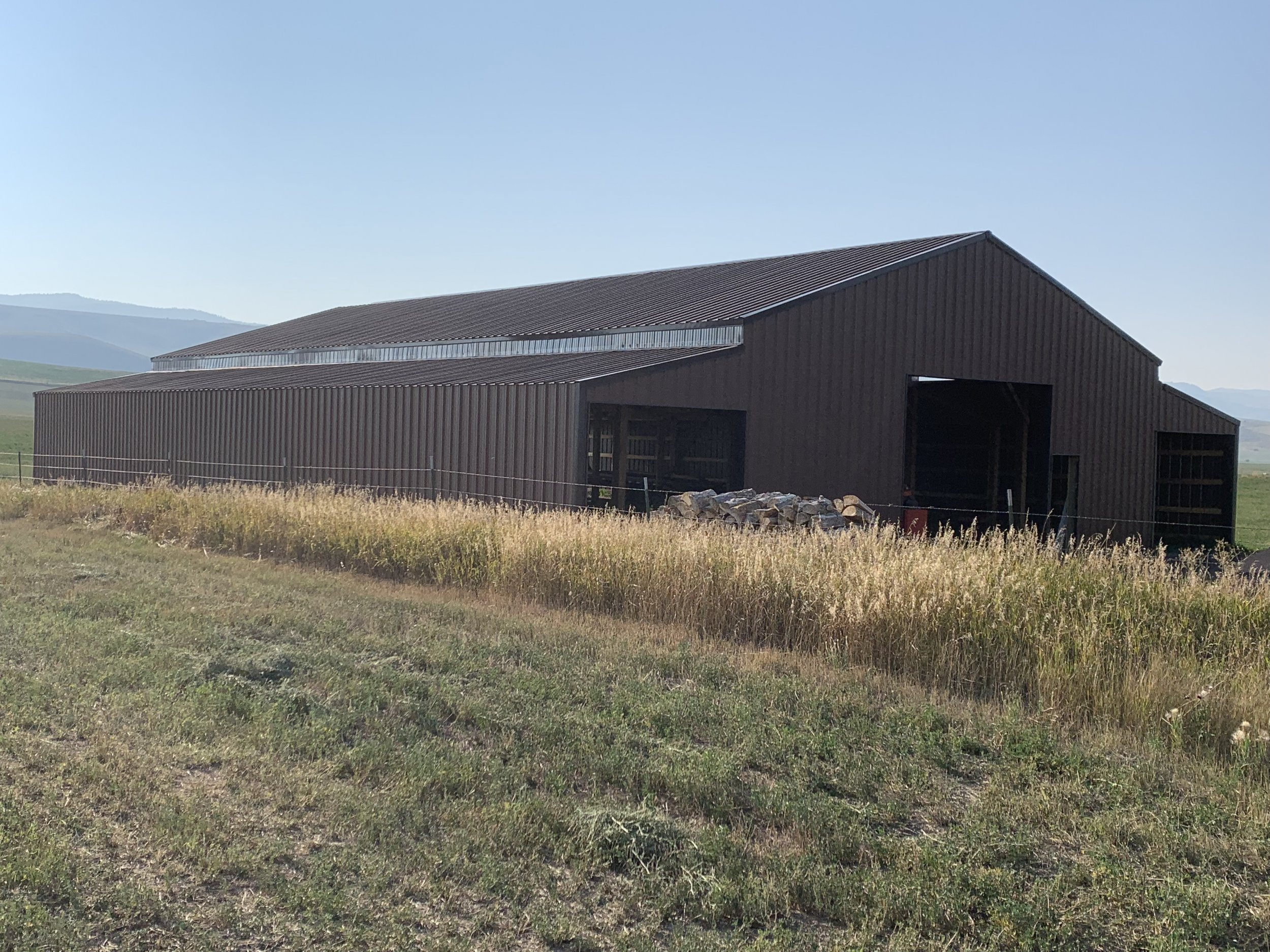

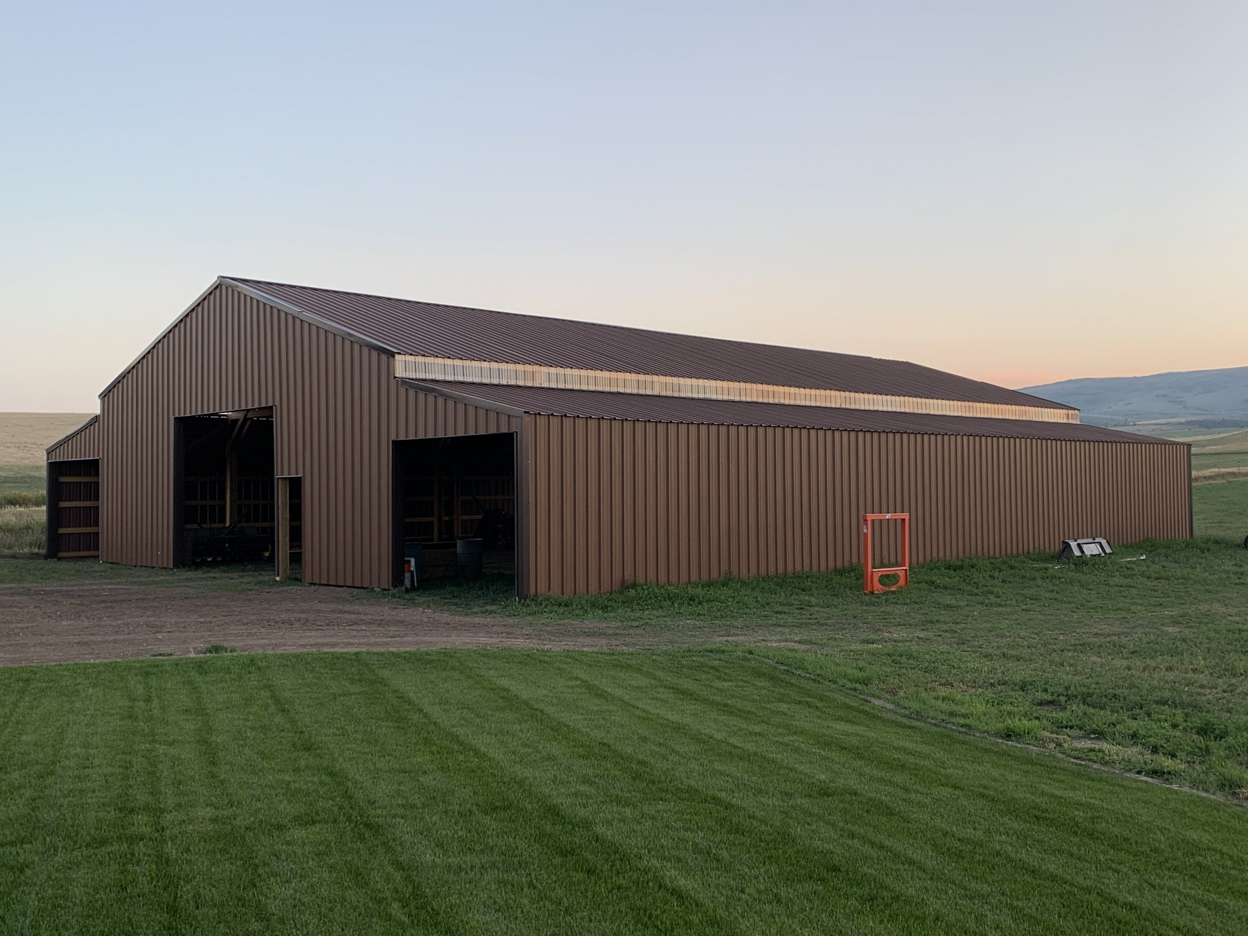

End wall metal time, the scary part. You'll see why, I didn't post pictures of the highest part so the safety police don't attack me.
I really wish the pictures could get the true color of the metal. It's called Rustic Steel and in person it looks just like rusty metal. In fact I took a bunch of pieces into a metal recycling place and the guy thought it was rusty metal until he took a good look at a piece.
/ The last Barn. (maybe) #52
I really like the color. With a building that large and that close to your house color would be critical so it doesn't overshadow everything around it. Great choice.
