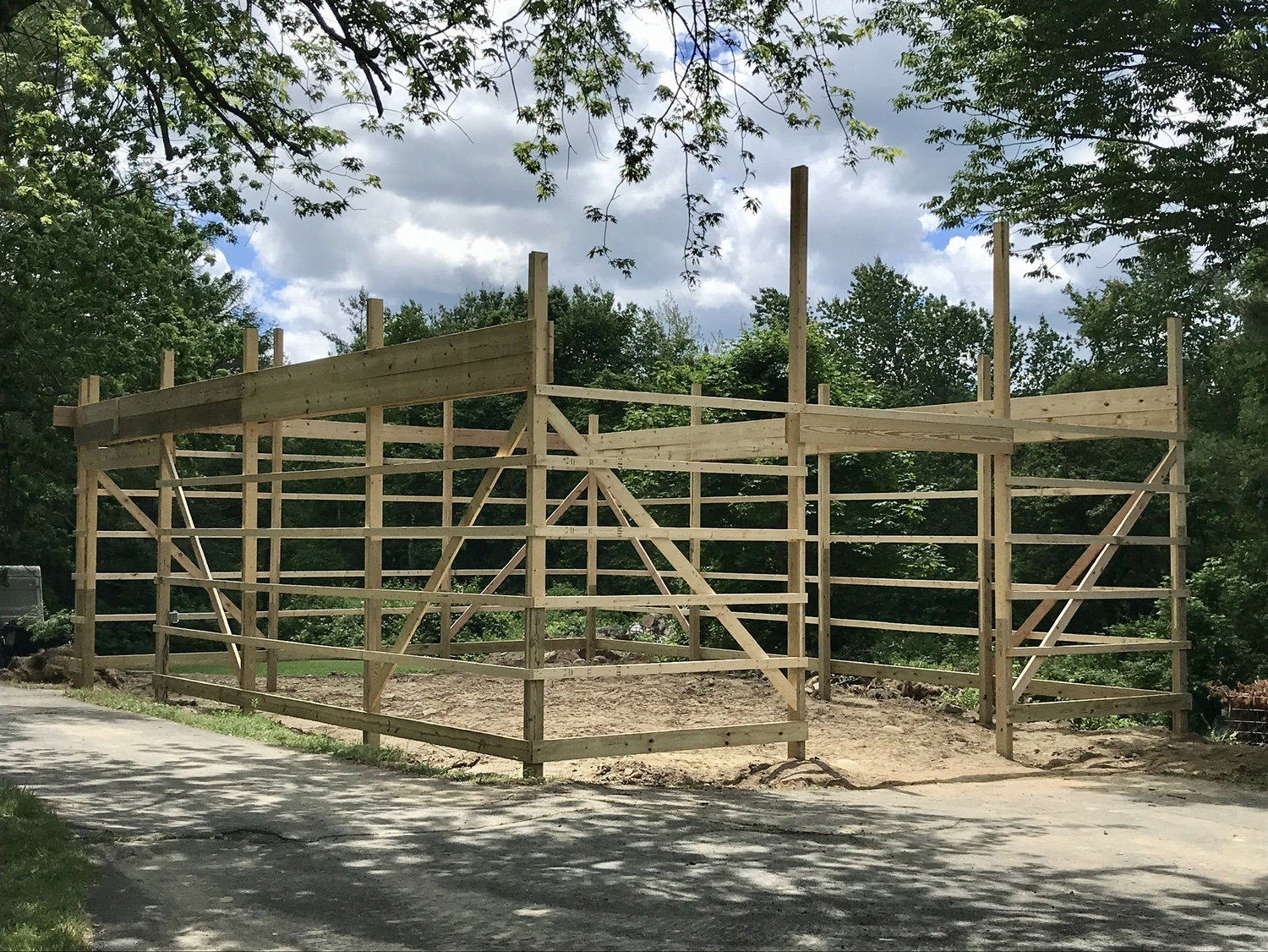

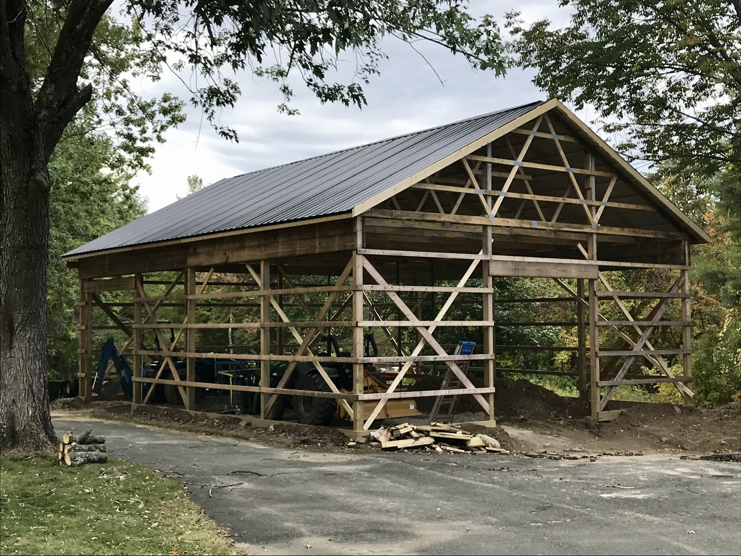

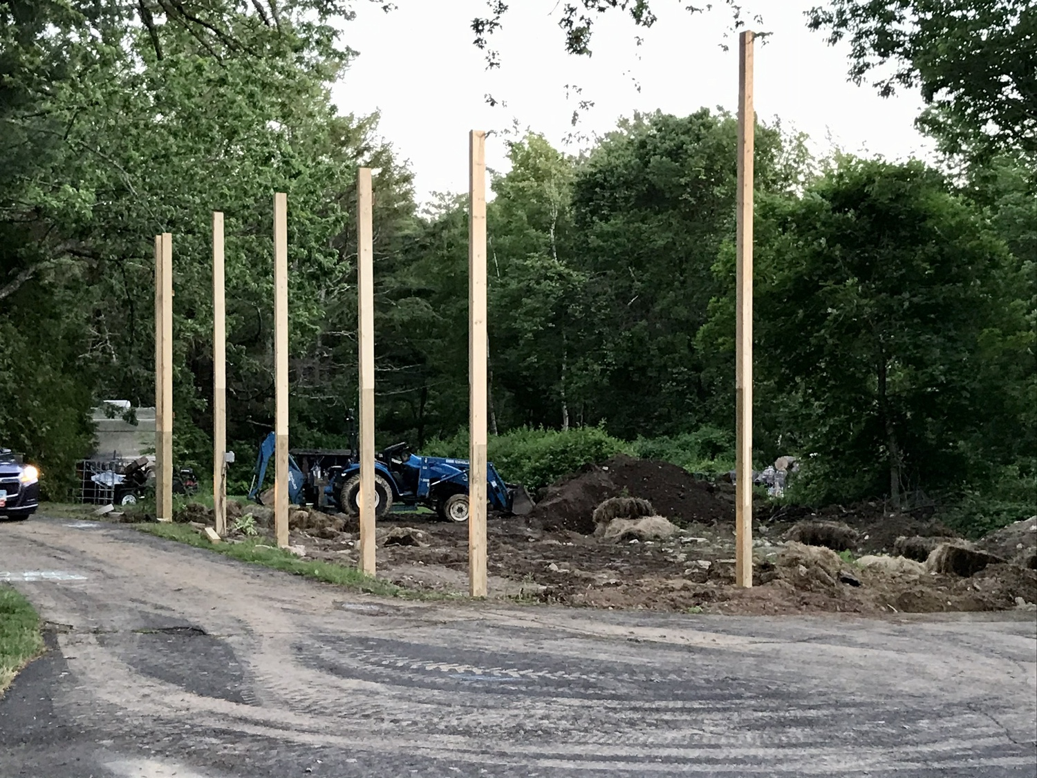

I built my 30x40x12 pole barn during Covid. Bought a complete kit from diypolebarns.com. They delivered the kit via semi truck and it had everything you need to complete the building except the tools. Poles were triple 2x6 glued together. 6/12 trusses, all lumber, metal siding, nails and screws included. Turned out better than I imagined.
If I were to do another one, I would seriously consider Versatube. Check them out too.
