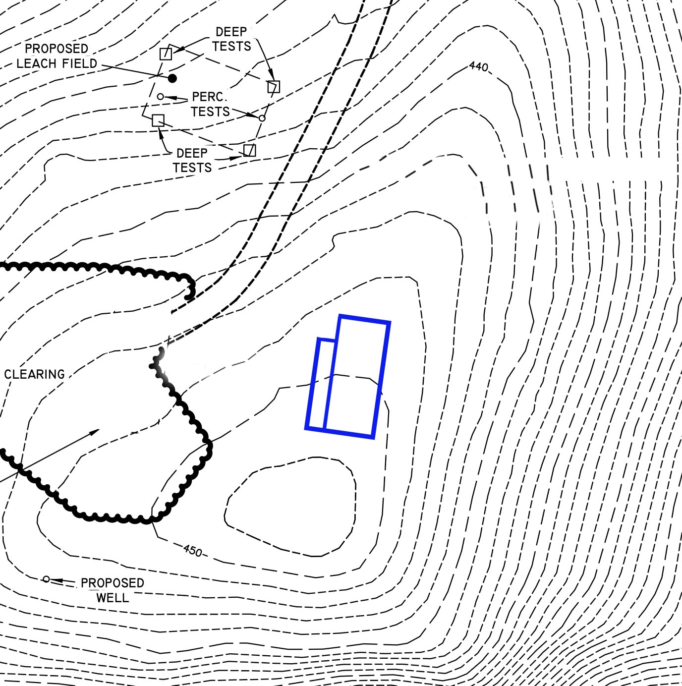

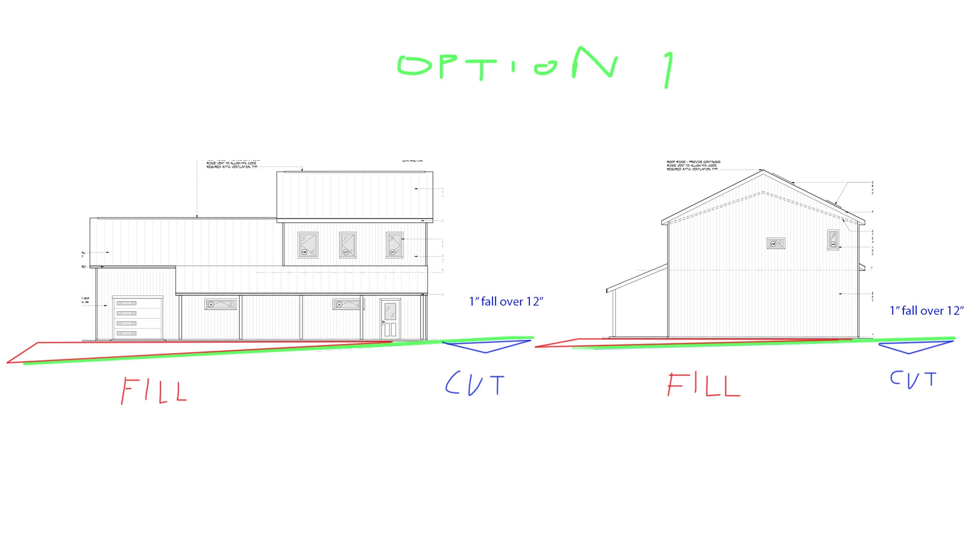

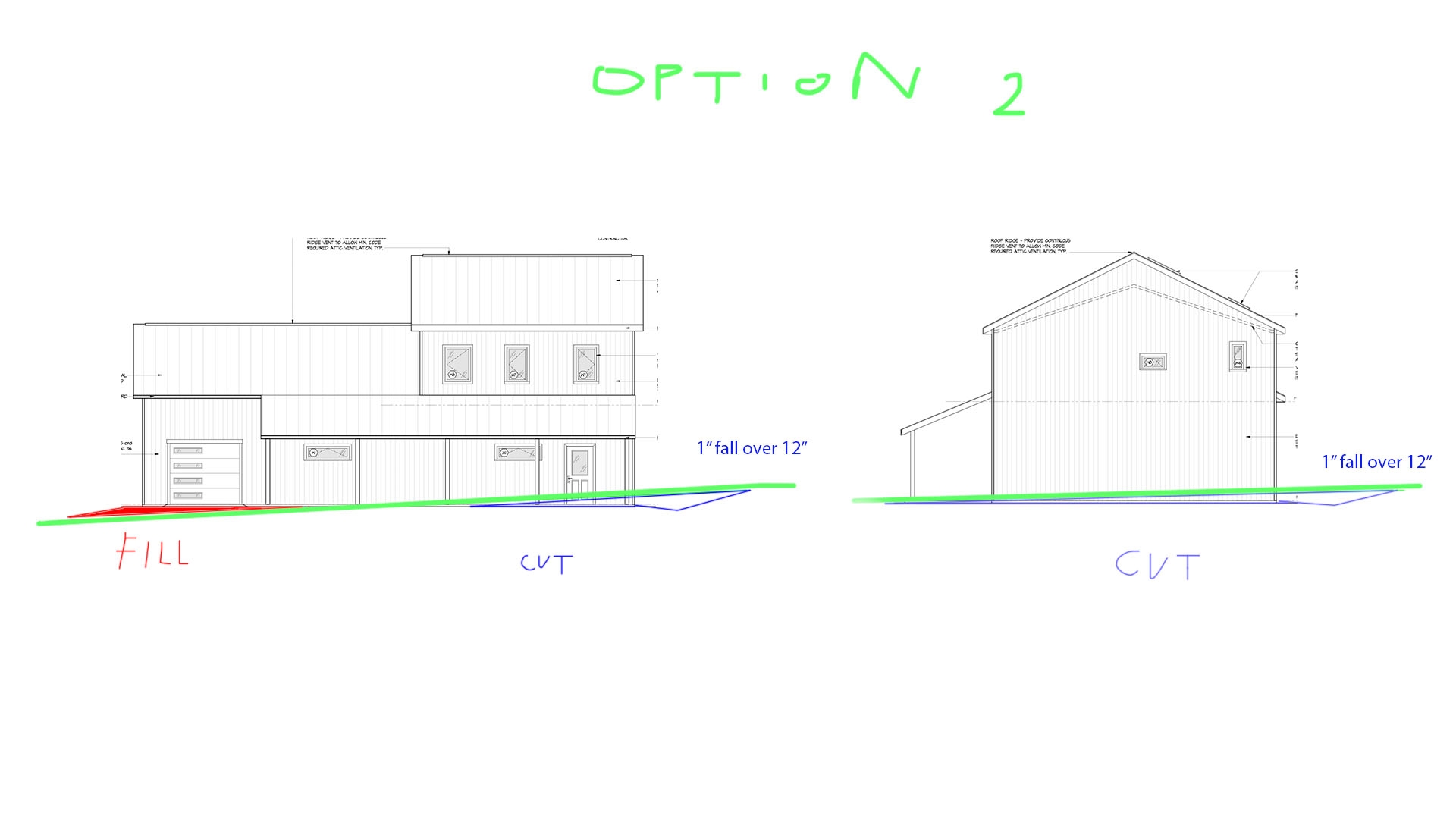

So my strategy will be to scrape off topsoil, spread and compact ROB up to 6" below highest side of grade (if needed, probably only on left side of building), and then spread and compact 6" crushed rock to match highest side of grade. Finished floor will be 8" above grade.

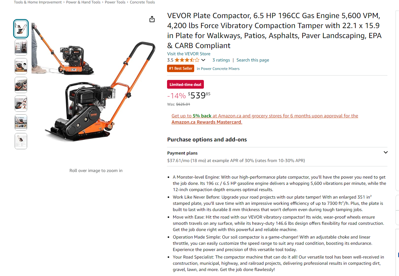

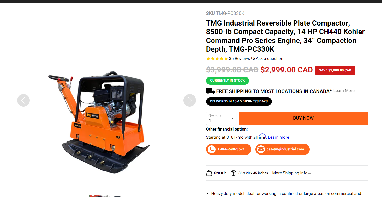

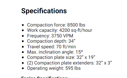

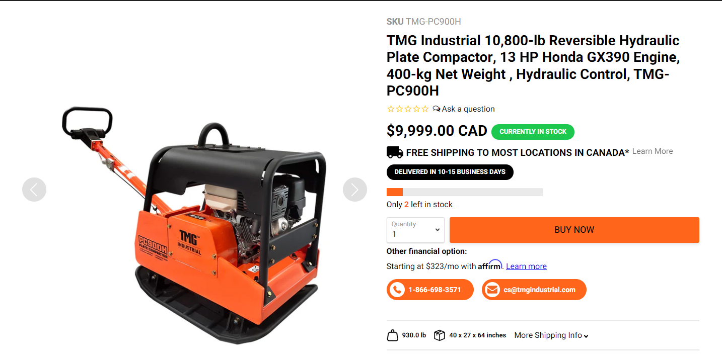

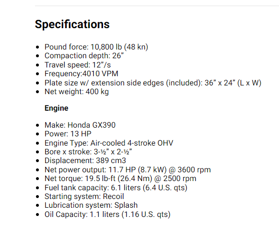

Plate compactors are not for building up pads. They are for patios and smoothing out gravel or sand. I had good luck renting one to smooth out ruts in a lawn that I created with a skid steer once. Ideally, you want a sheepsfoot compactor, so it mixes the soil while compacting it. The more you build up a pad, the harder it is to get compaction.
On the commercial jobs that I worked on back in the 80's, the Inspector would come out with a box that sent a signal into the dirt, kind of like sonar, that measured compaction. I think Code was something like 98% to pass. If we failed, the dirt was dug out, mixed with dry soil, or mixed with more water, and then put back in lifts. Usually it was a wheel loader that dumped it, a dozer that spread it, and a sheepsfoot compactor that went over it. Those lifts where about two inches, but sometimes, they where a lot less, depending on how far the dozer operator would spread it before the compactor went over it.
For pipe lines, jumpjacks worked, but they are a lot of work. When digging out stumps, I dump a load of dirt in the hole, then when it's up high enough, I start driving over that soil with my front tires and a load of dirt in the bucket. I do this until my tires don't sink anymore, anywhere in the hole. Then build it up to a mound so water sheds away from it. In my opinion, I doubt I'm at 90% compaction, but I'm can live with that for my own place.

I disagree, I have built many pads for many applications we used diesel heavy diesel vibratory plats to achieve compaction and we did achieve compaction and yes it was tested, is it the most efficient way No but can you absolutely use them, and we did, they both achieve the same result, with a roller you can go with thicker lift and achieve compaction quicker I am not saying otherwise ... We did 4 to 6'' lift for crush gravel 3/4 inch minus and 10 to 12'' for sand with diesel plats . The control test was done with each type of materiel used with a vibratory roller for reference point but after we would used heavy diesel heavy diesel vibratory inside excavations unless there was room to bring a roller, it is very hard to bring a roller inside a some excavation so lots depend on the size of it.

Next, was figuring out the finished slab height. A few weeks prior to starting, I had checked the elevation with a rotary laser and found that it was 40" difference from the high to low corner; much more than I had eyeballed. I then had a stressful couple days of constantly seconding guessing myself and trying to balance between raising the pad height to accommodate the high back corner and not paying for a ton of a fill.
I ended up bringing in around 180T of screened fill to level the pad. This is what the stone supplier was selling as their version of bank run at $14/ton.
