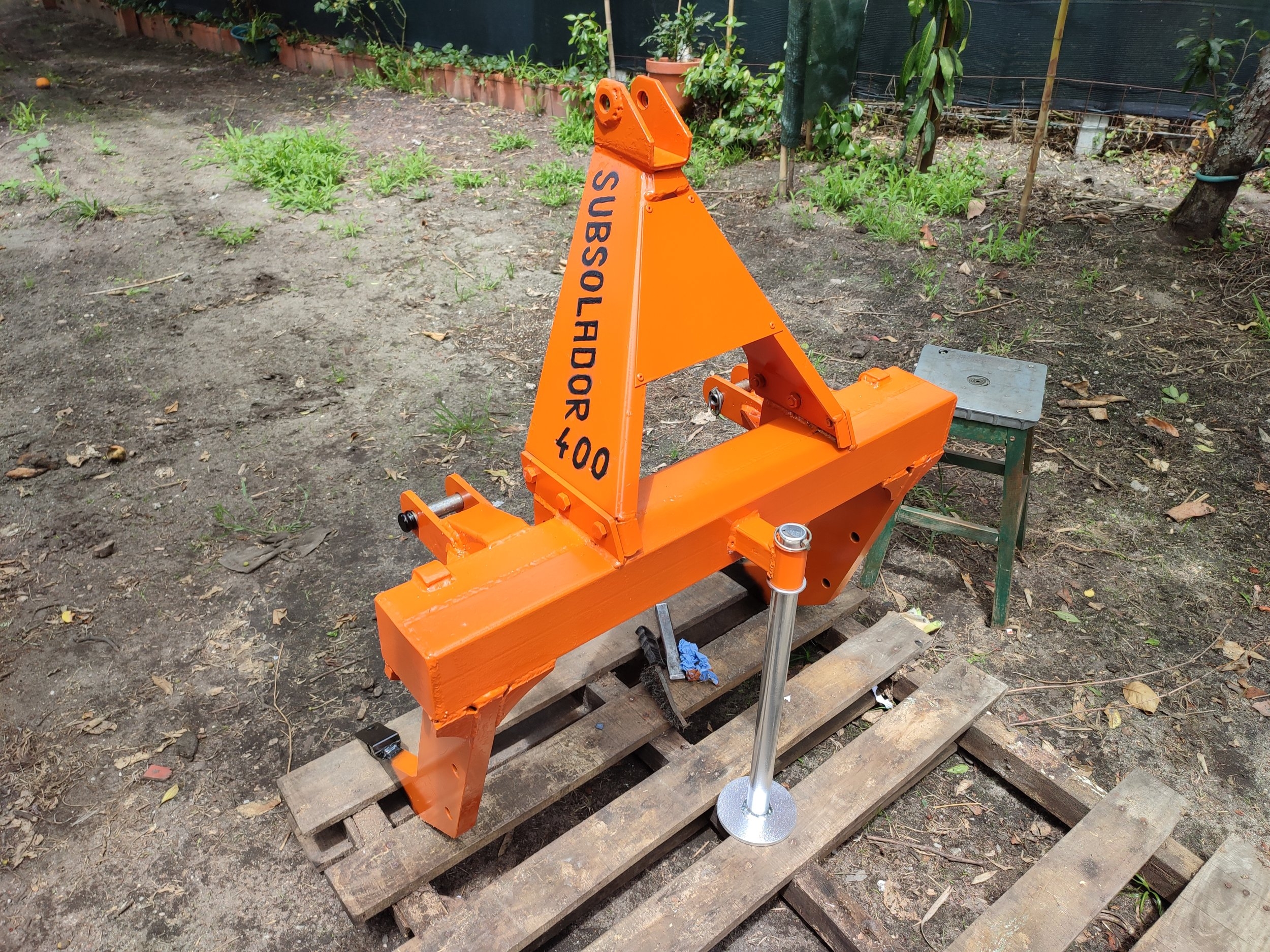

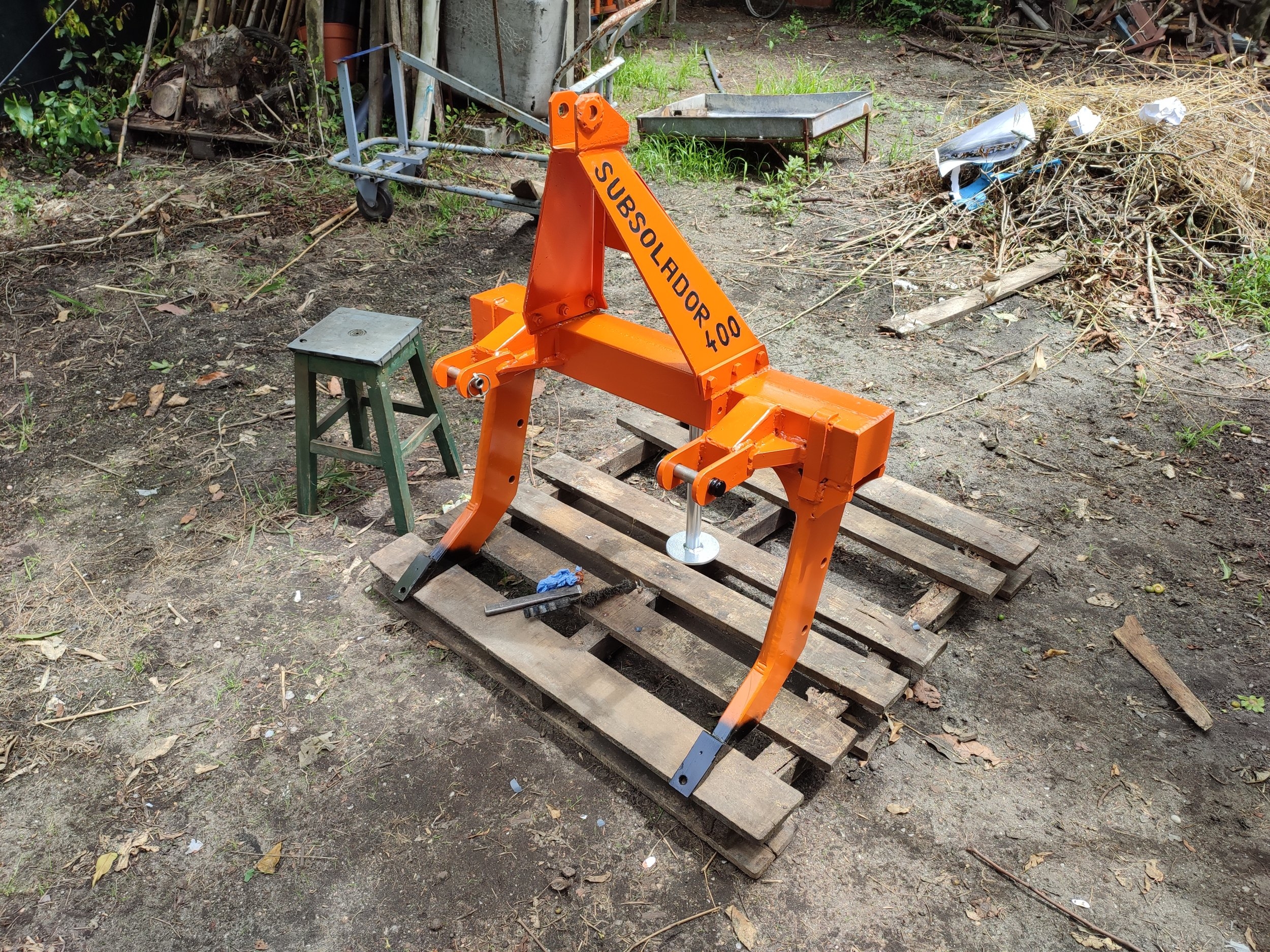

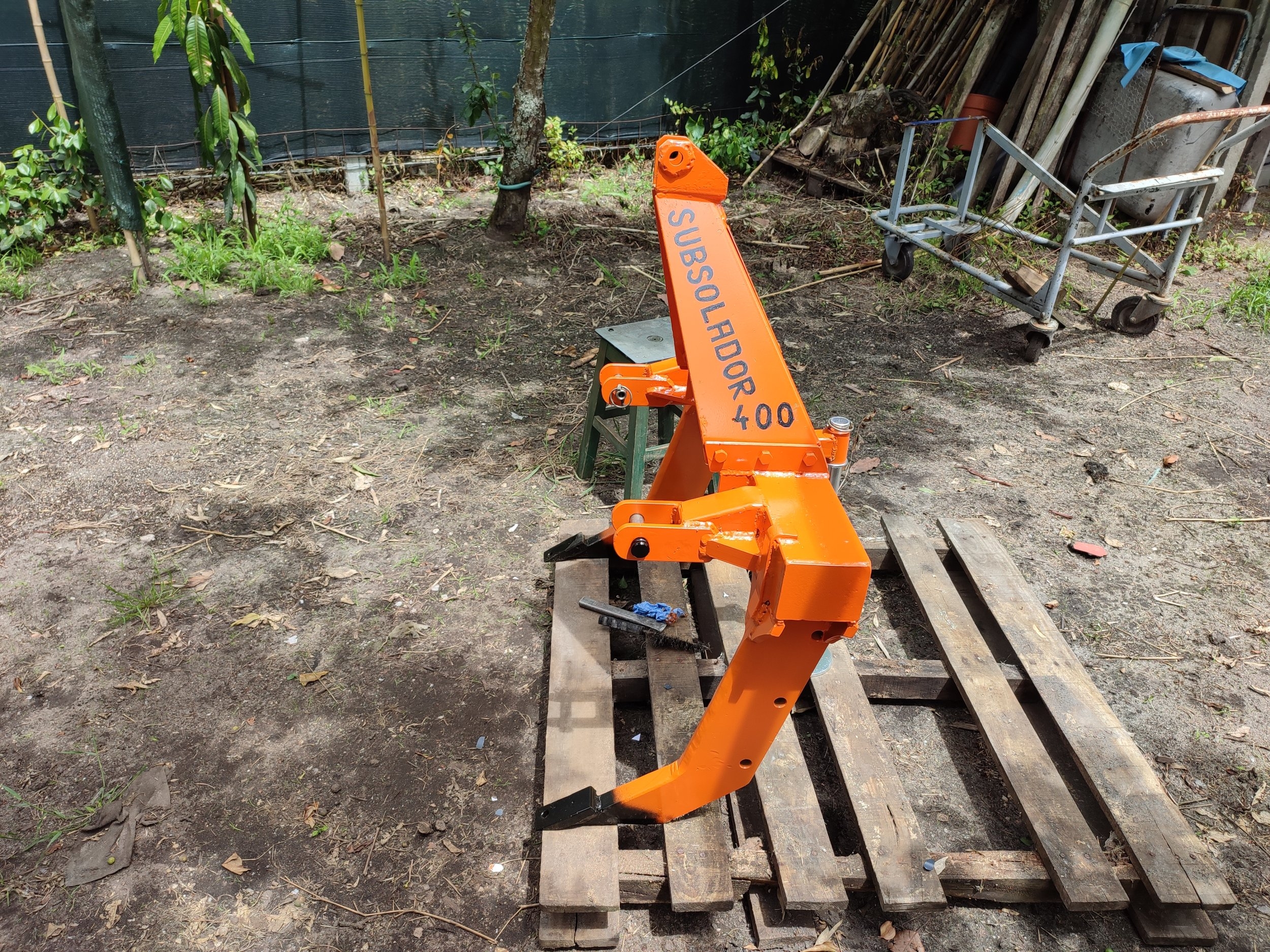

It's officially done. All nice and painted, just don't look too close. :)
More testing to go, specially with the draft control. Just checked the manual to tune the linkage for deep ground engagement work.
Today, I did use the rototiller on the olive grove, where I did all the sub-soiling work. It was a major improvement as the tiller went deep and everything went a lot smoother.

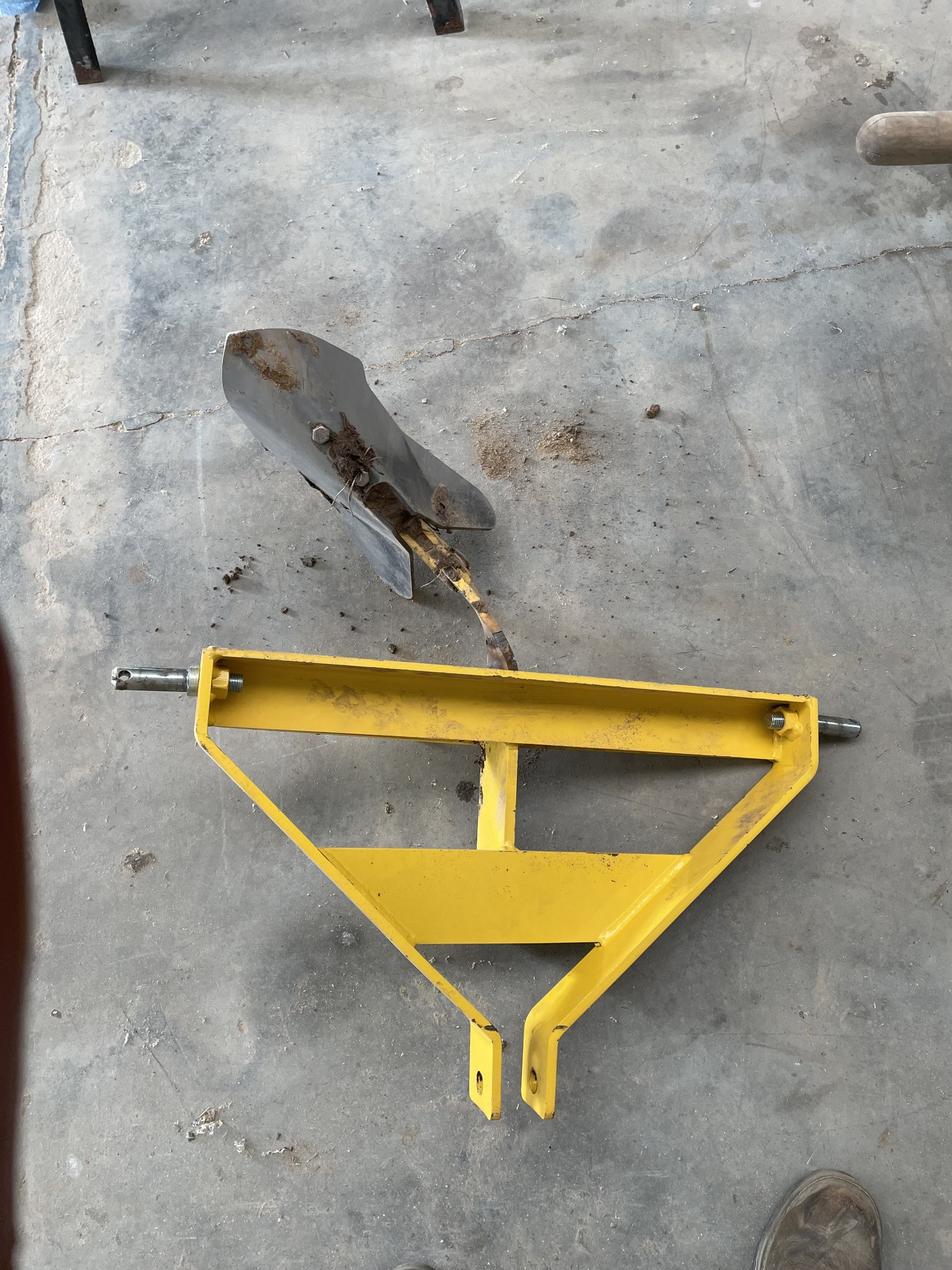

Looking rough but its all my 4025 wants. At times the beam will drag. Stump pulling bent the 10in frame
Plow is from root rake off a dozer.

I imagine the wide tip also requires quite a bit more traction to pull. How deep does it go?

Why "400"? This looks like at least a 500.

Well, that's the max depth it goes. 400 mm.
I've put a good amount of use on it. So far so good. Tractor pulls it very nicely.

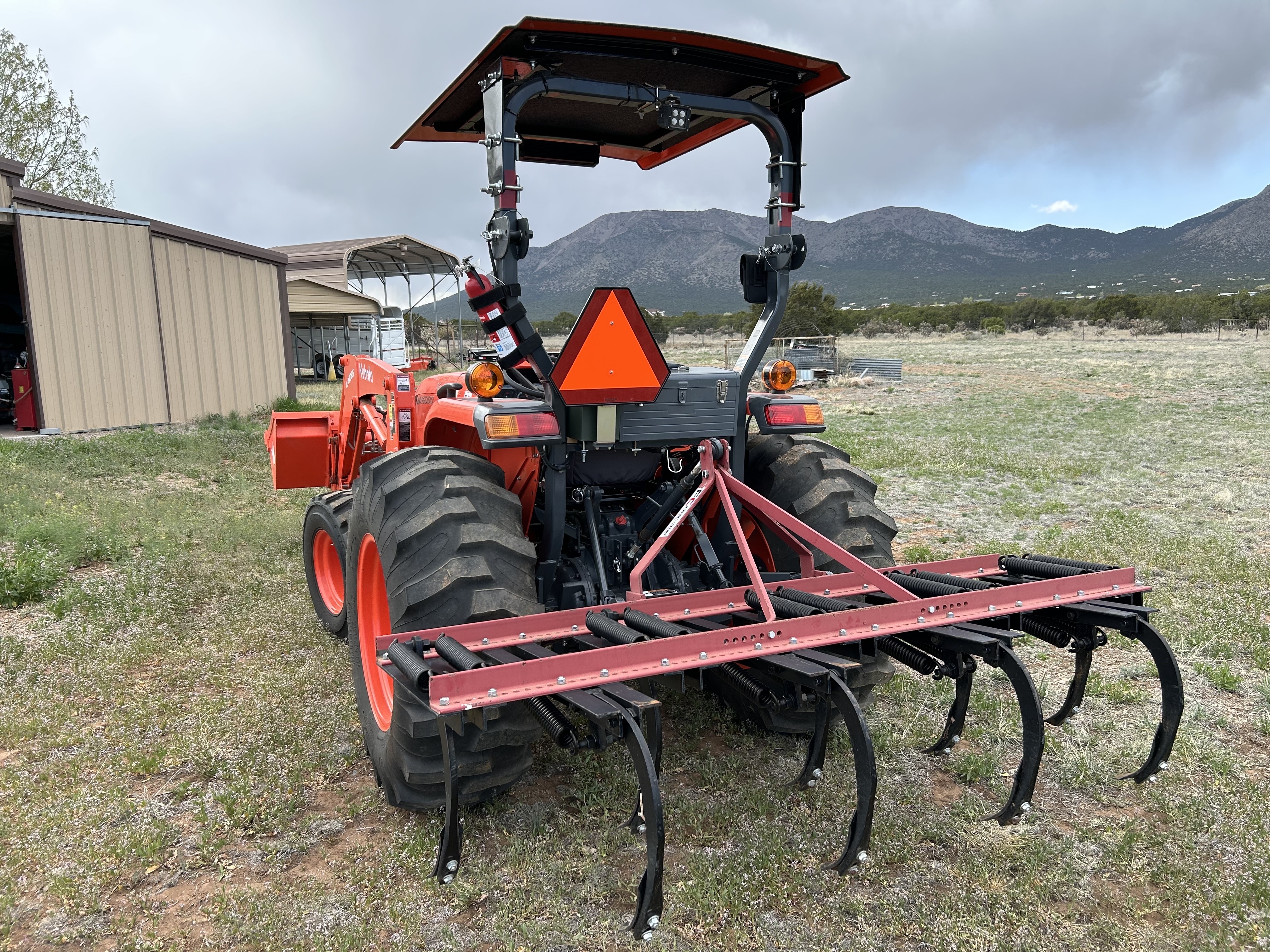

Take a look at the spacing on my implement. It has 9 shanks and is 7’ wide. The shanks can be sunk 17” deep.
That's a chisel plow, used for a little bit different purpose. At the time, I considered getting one of those instead of building the subsoiler.
Subsoiler also ended up suiting this soil a lot better. A chisel plow would have barely scratched the surface, now that I've seen how the subsoiler behaves.
