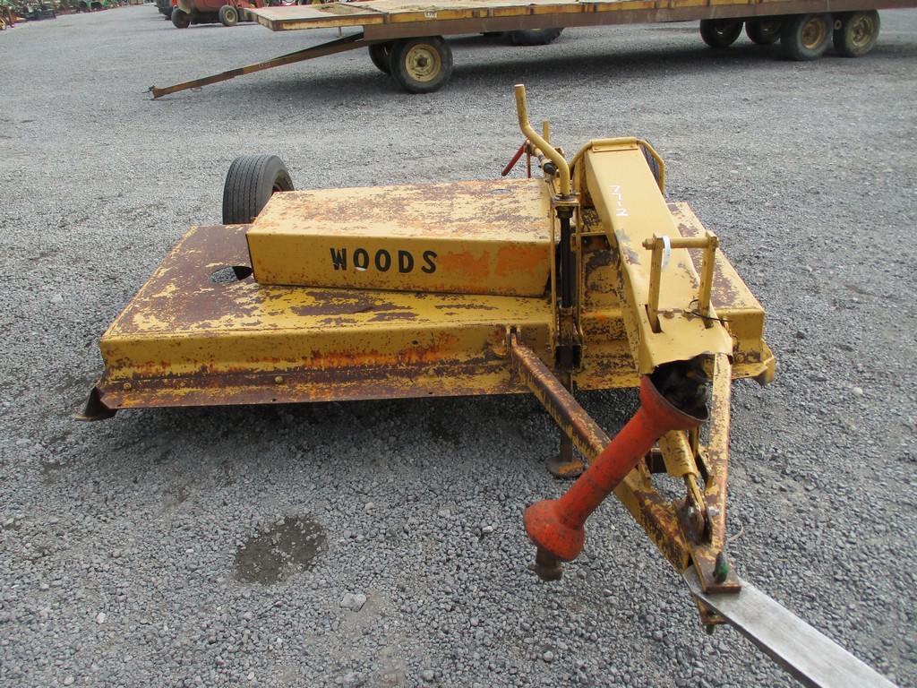

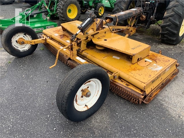

Not to steal the OP's thread by any means, but it does exist.
Absolutely! Been done before.
Woods sold the D80 in two offset versions: mounted and pull type too.
None of these versions back-sweep tire tracks though. ;<)

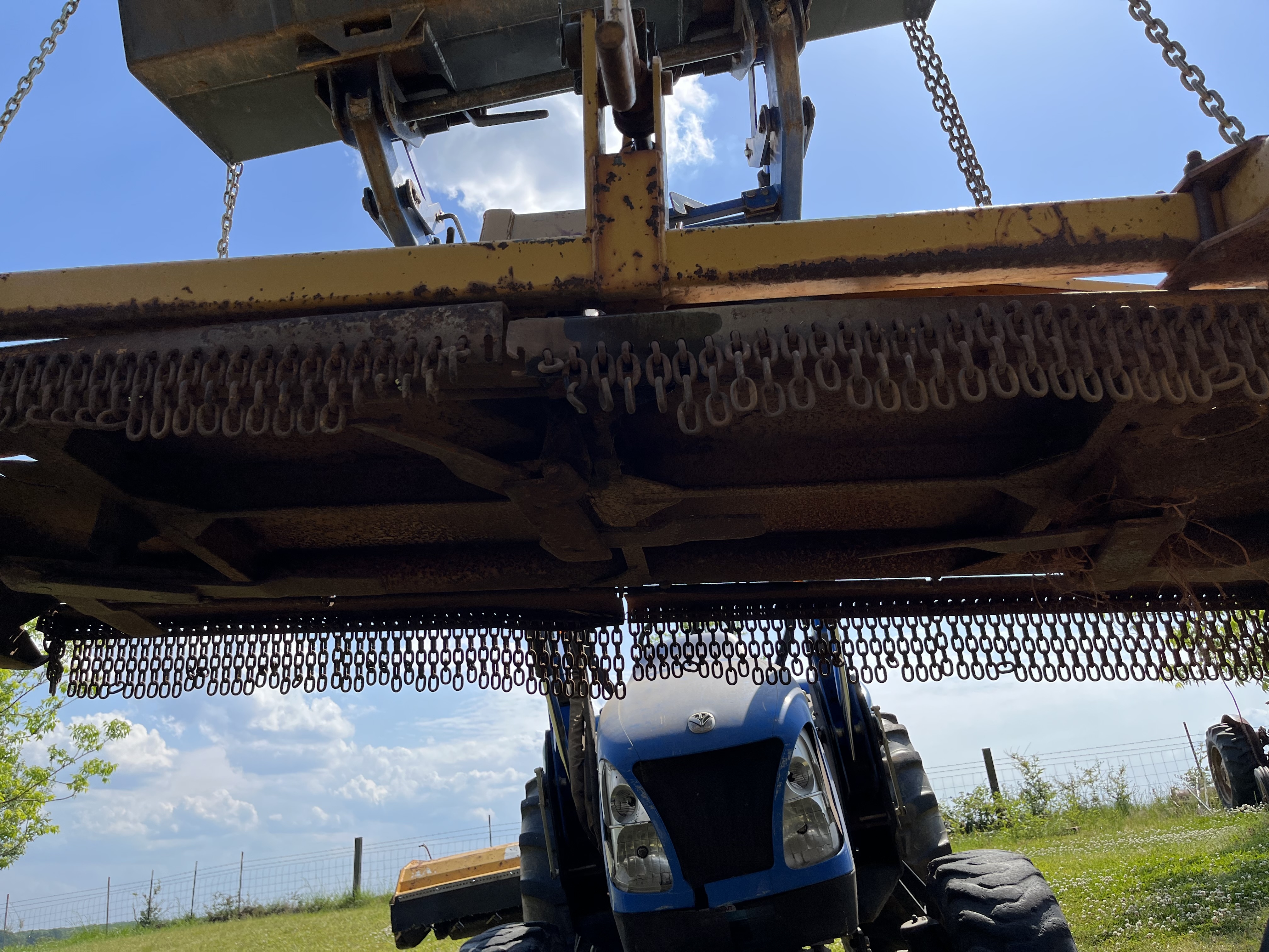

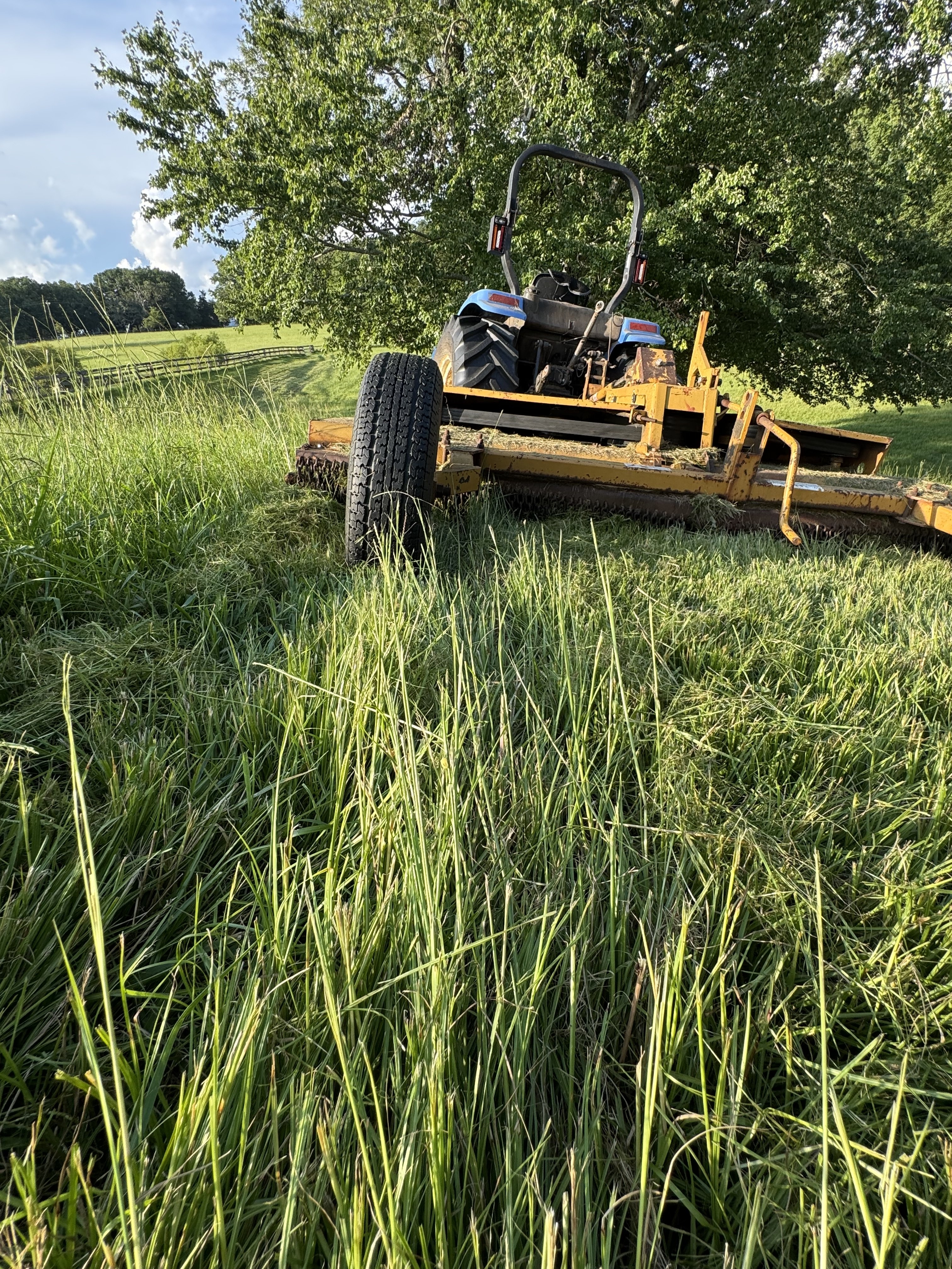

To the original poster that’s some great fabrication work.

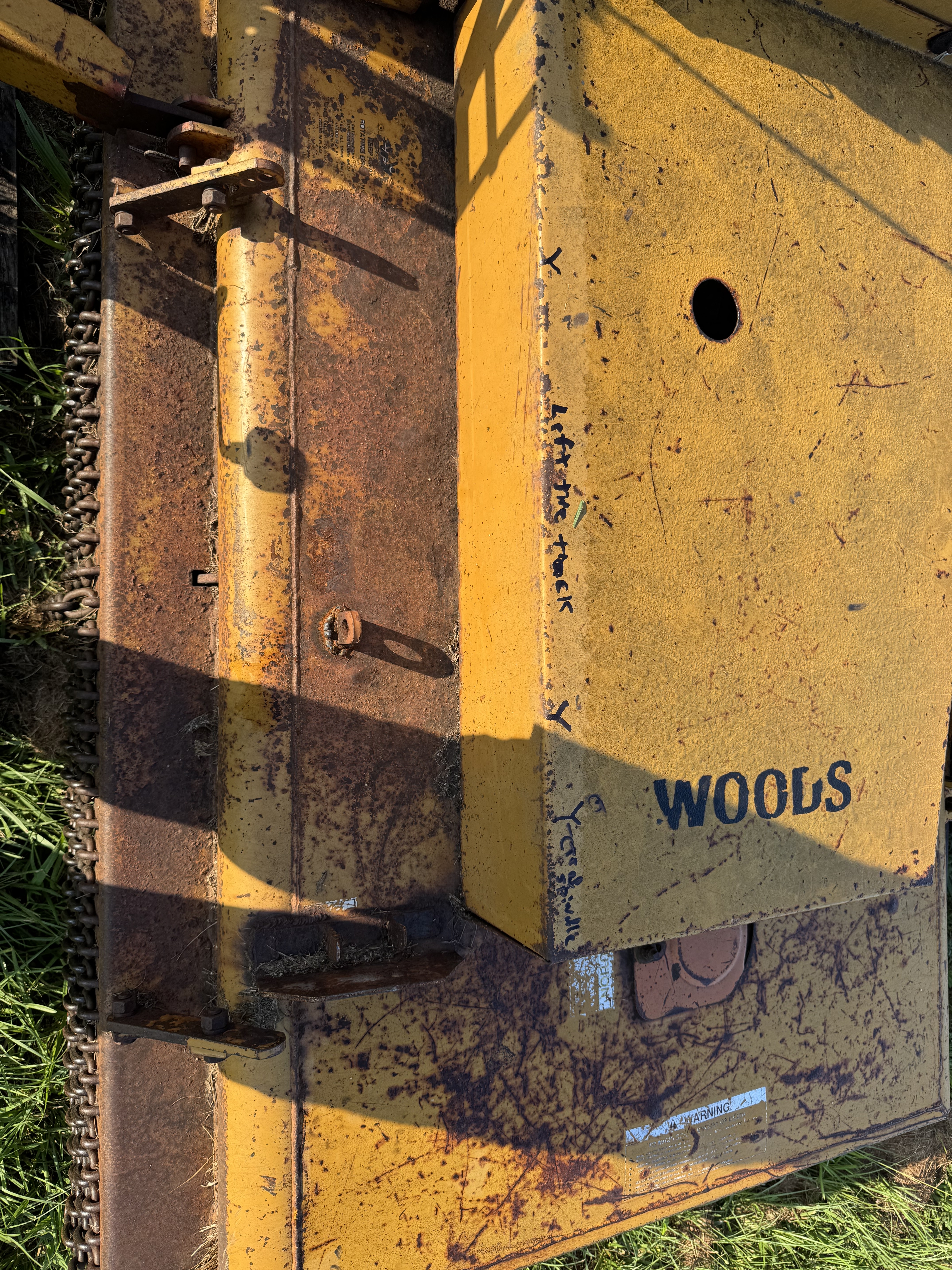

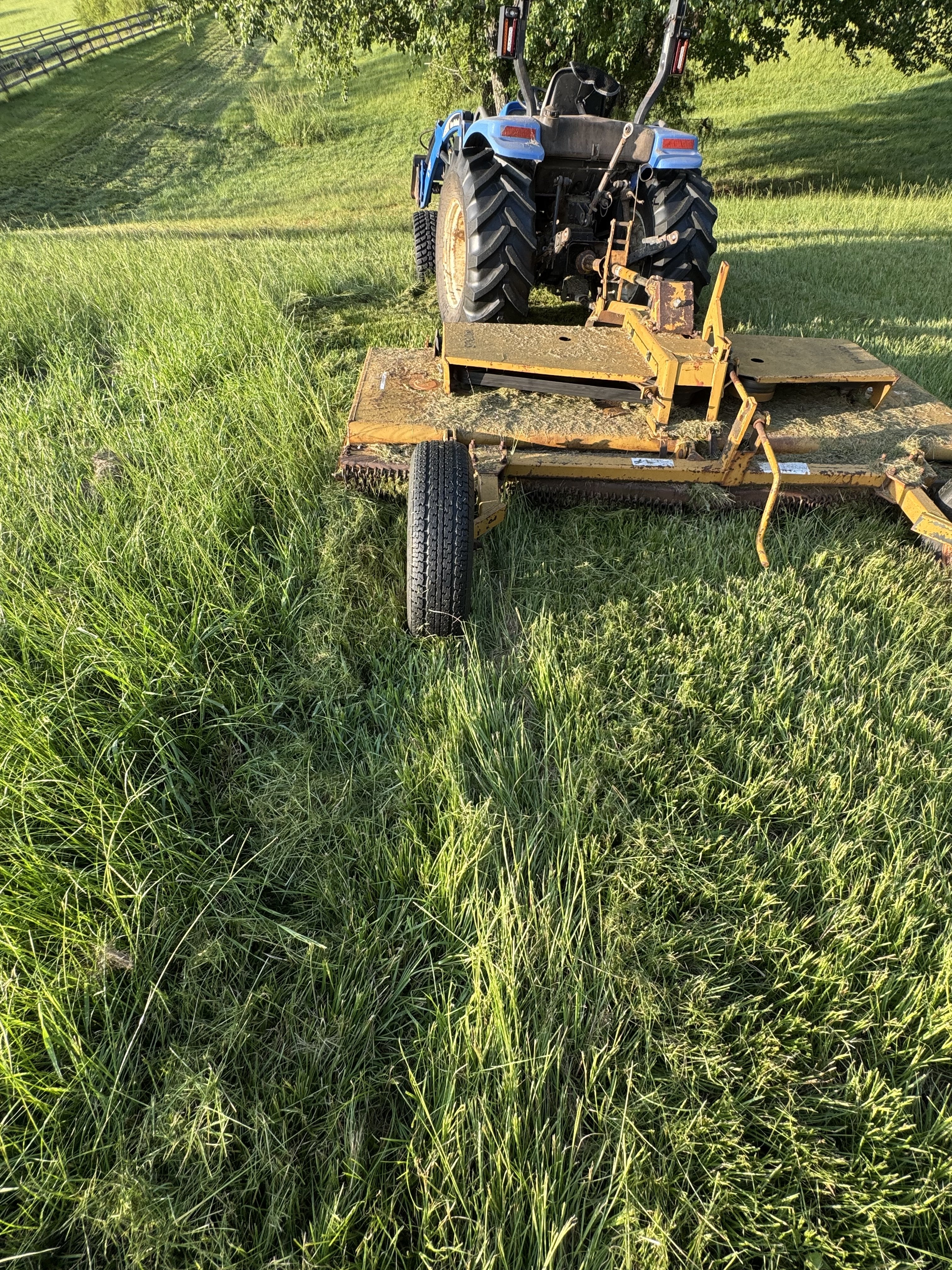

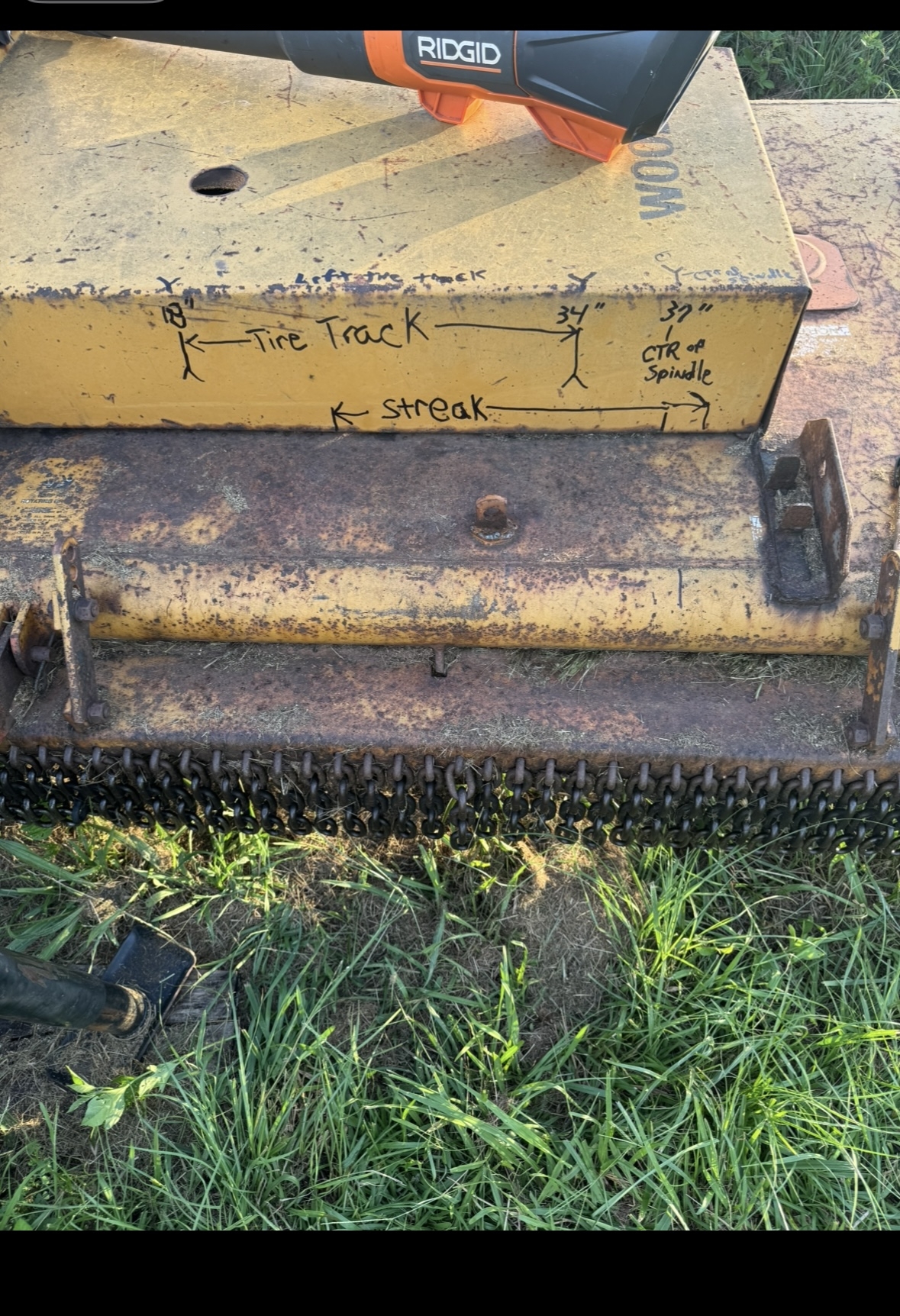

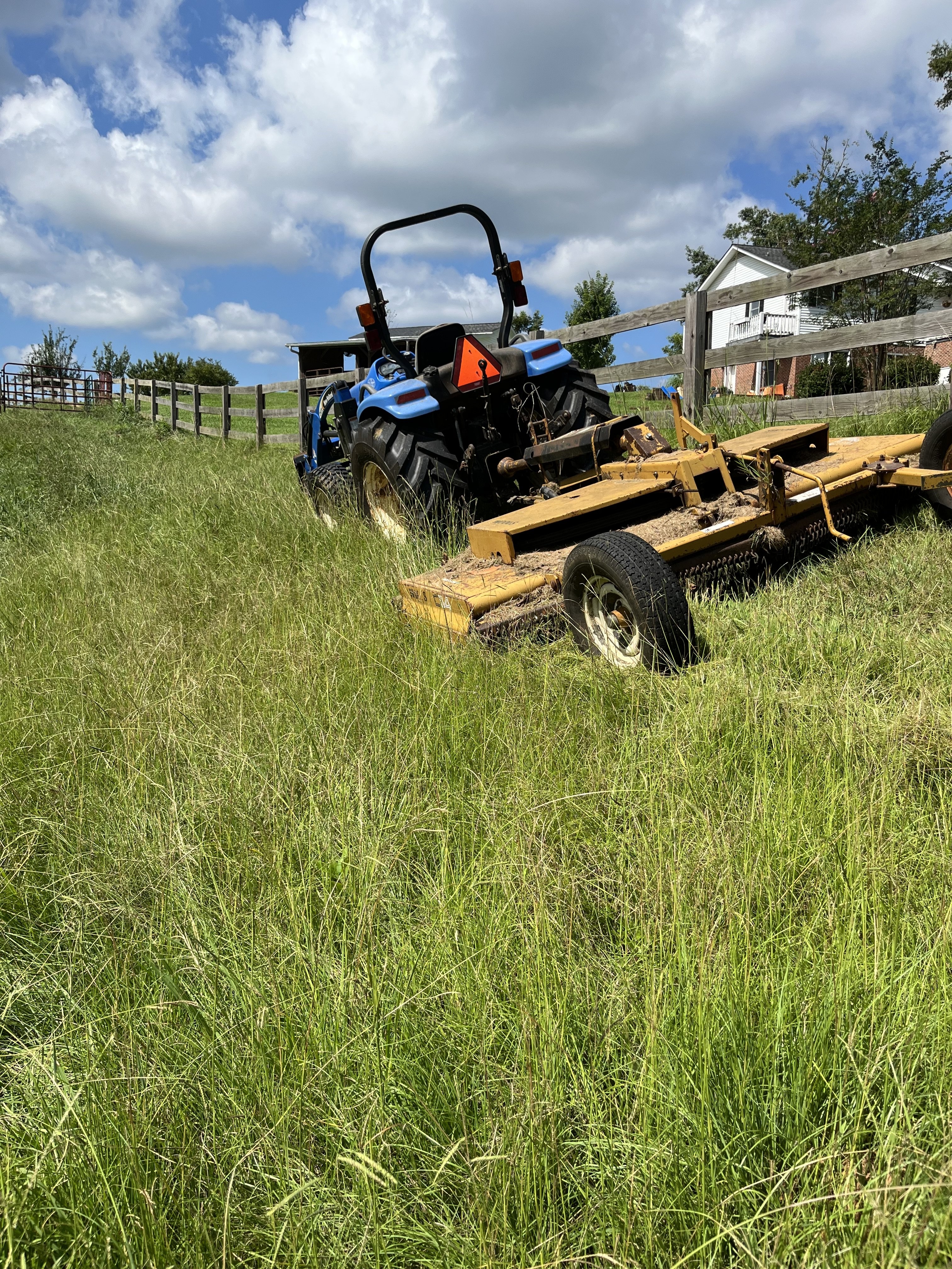

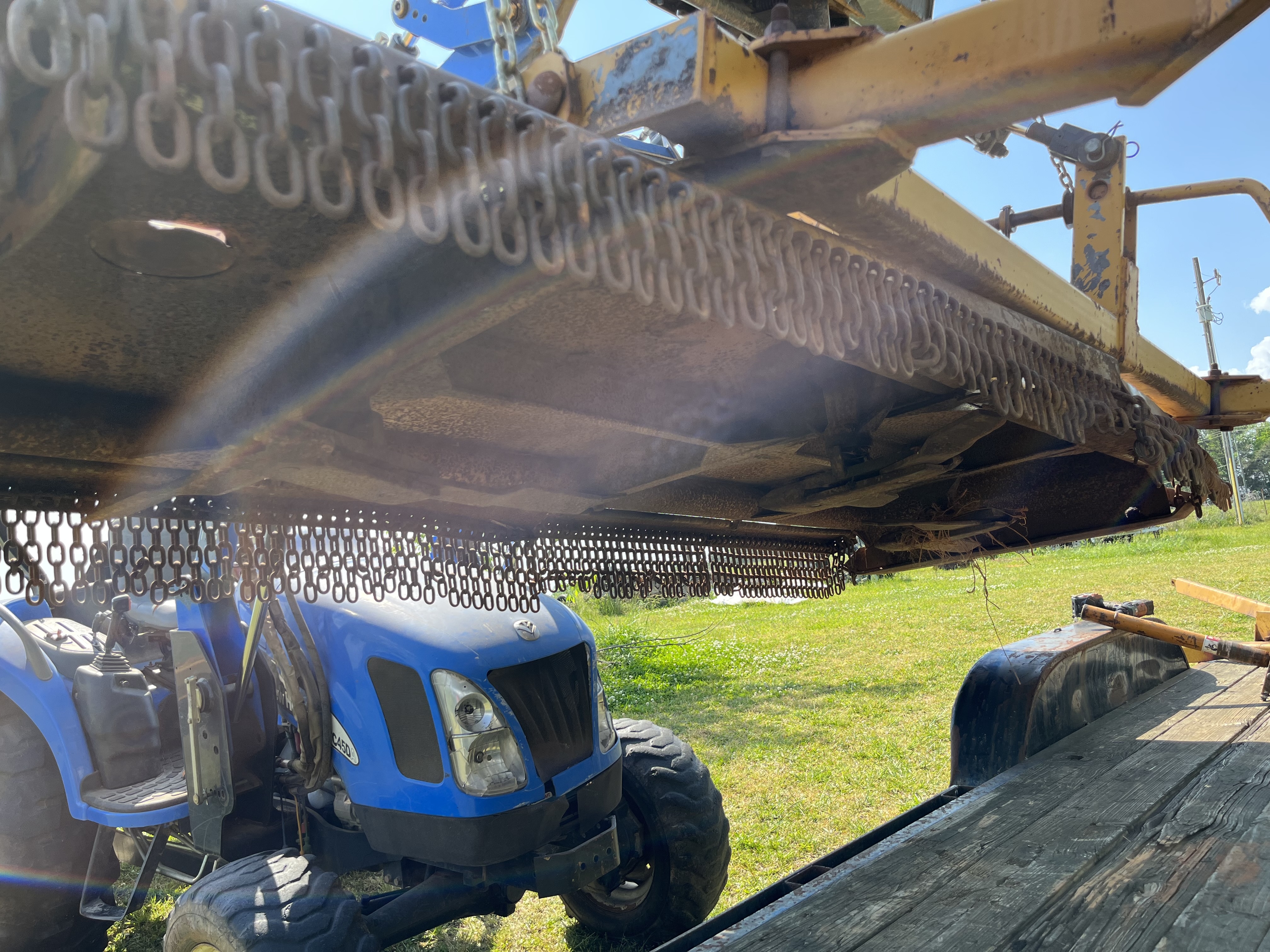

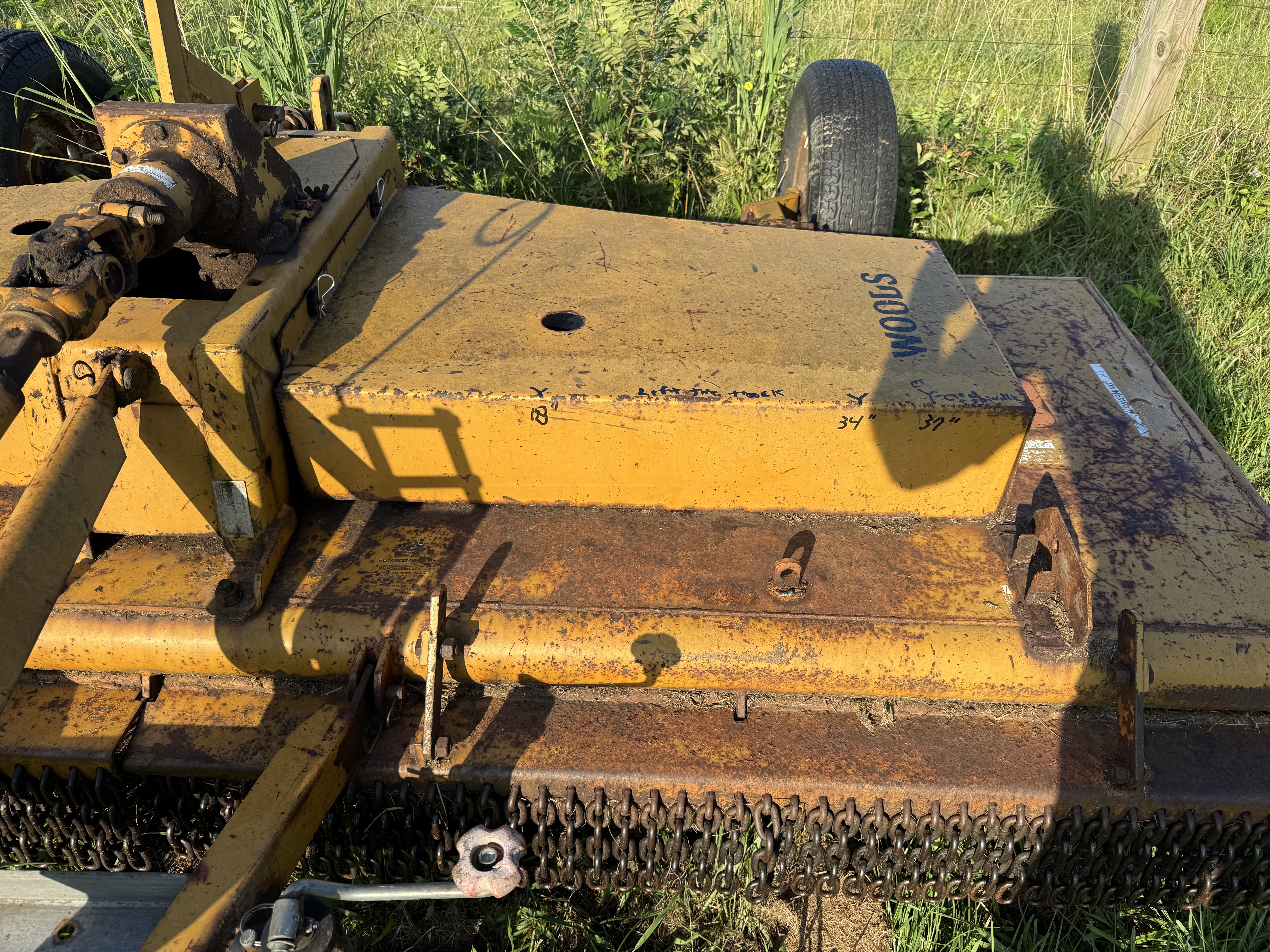

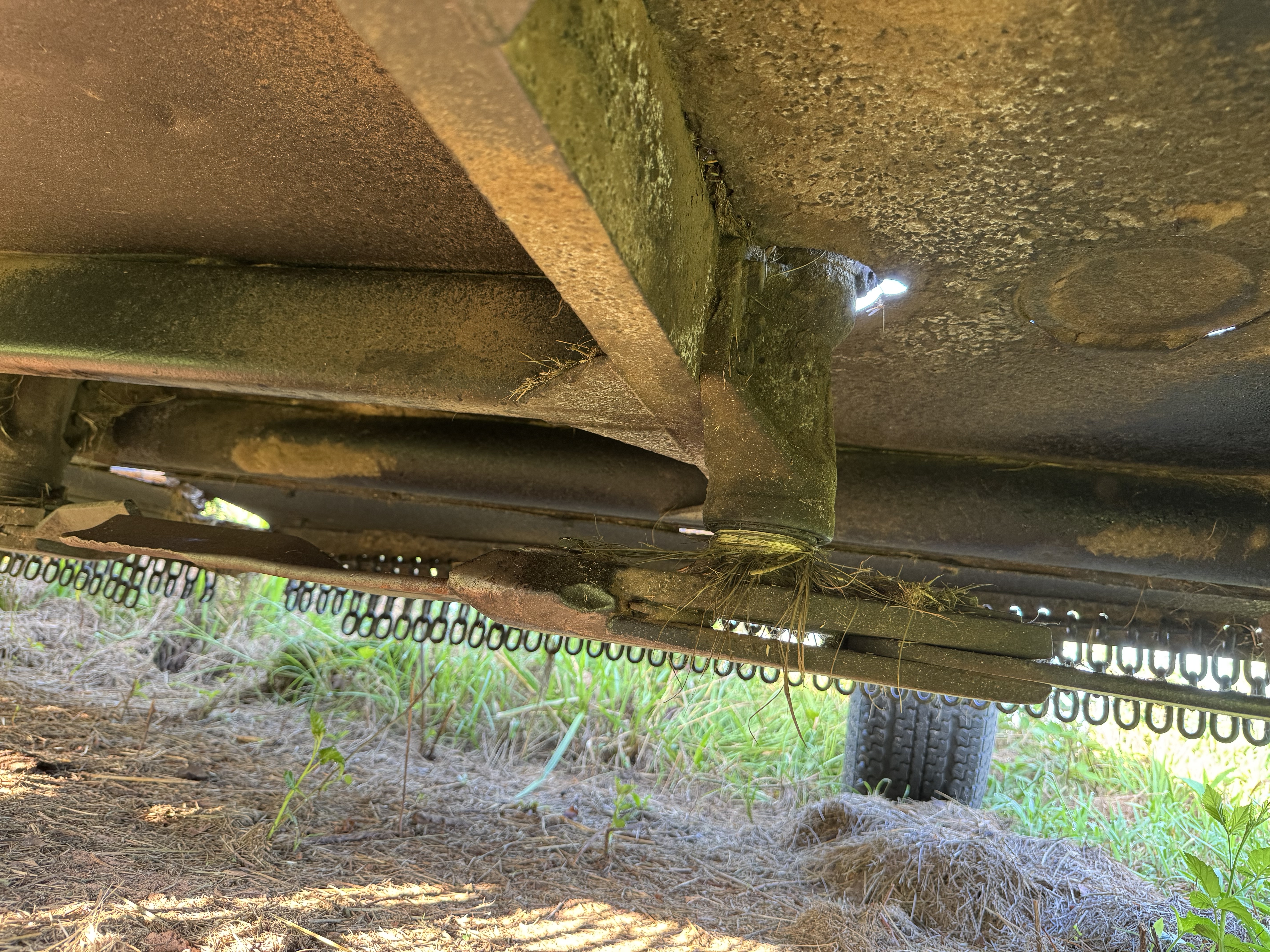

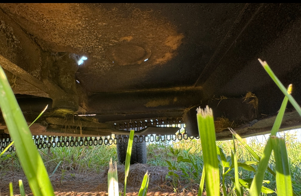

I have a Woods C114-1 that is a bigger version of the D80 Woods. It streaks on the left side. I am thinking about adding steel to smooth the air flow out and hopefully increase the lift.
Here are some picture of it. Do you think just sloping the sides and the front/rear would work or would it be better to just put baffles in like you did?

   / Hybrid Rotary Cutter Proof of Concept #35
My guess is you're asking about the baffle in the upper left? The bottom of the pic is the front of the mower. You can see how the RH spindle (front) would want to hand-off all of its discharge to the rear one... that was expected. Ring baffles were needed to isolate the chambers. In testing, the RH chamber (in the pic) discharged very nicely right out the back. The left chamber did not! It carried the material too long and slung it along the rear of the mower combining both discharges into one big wind-row... very ugly. To change that I inserted a "cut-off" baffle (upper left in pic). It is there in the flow field (about 3/4" from the blade wing) to create a high pressure wall. The material comes along the LH side toward a high pressure wall or veer out the back to "0" pressure.... so it goes out the back. Cut-off baffles work well but create noise.

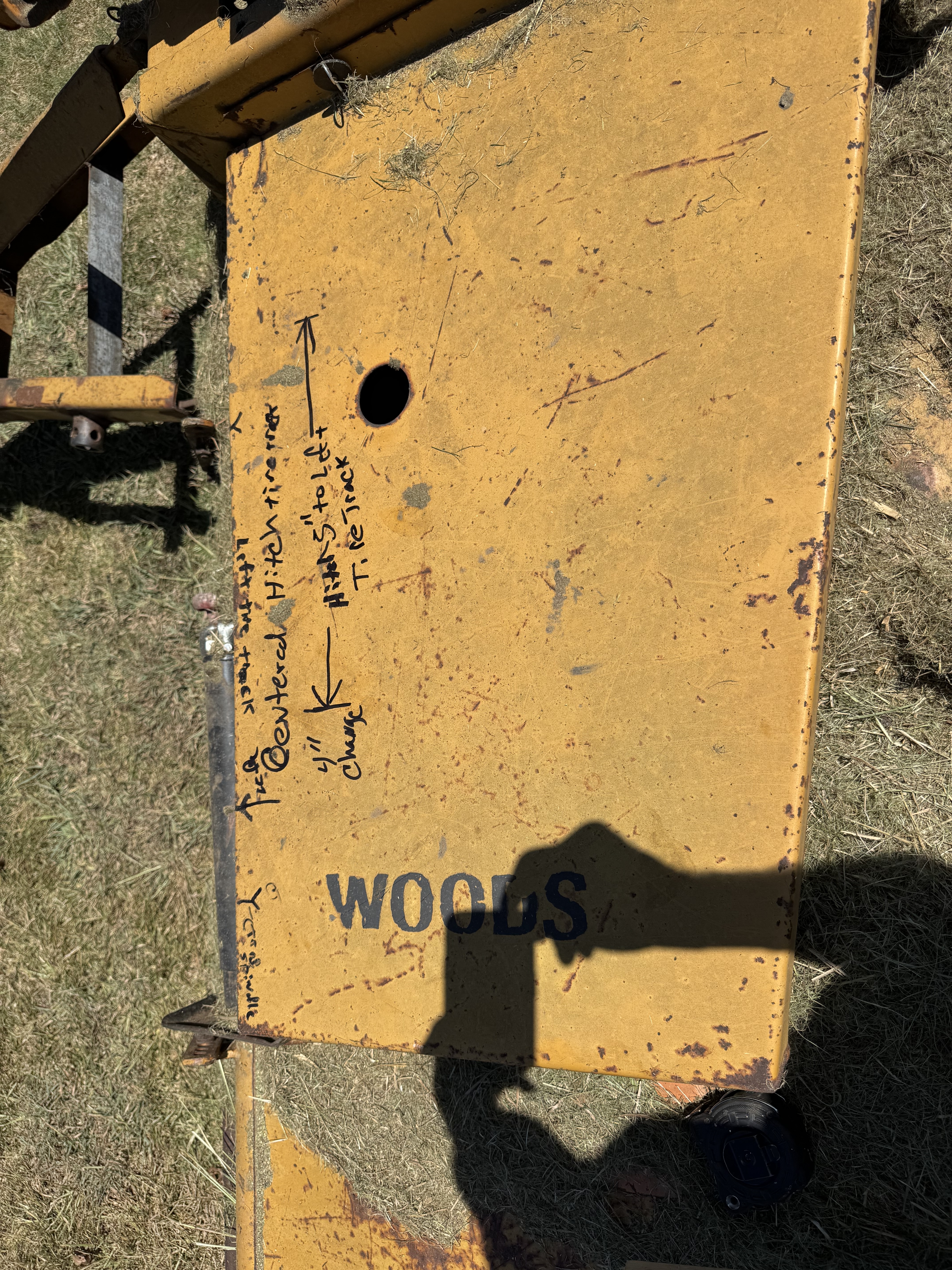

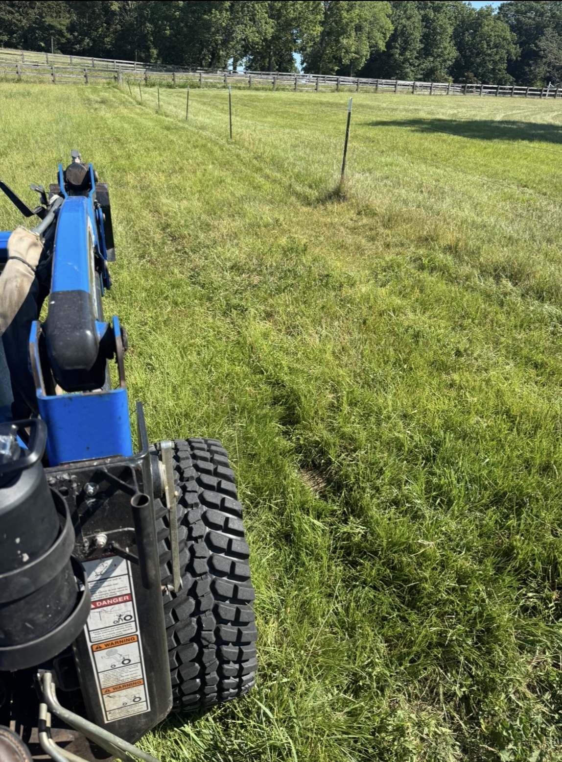

Thx so much!
A few questions:
  • It appears to be a 2 spindle, CCW rotation?
  • Does the LH stripe align with the LH tractor tire?
  • Where does the LH mower spindle align with the stripe? Dead center? Right? Left?
  • Just curious. Your mower looks symmetrical (not staggered). How do the 2 blade paths cross to assure complete cutting?
The mower appears to be centered with tractor. If your mower can shift, it would be most effective to move the mower to the right some so the LH spindle can back-sweep the tire track.
