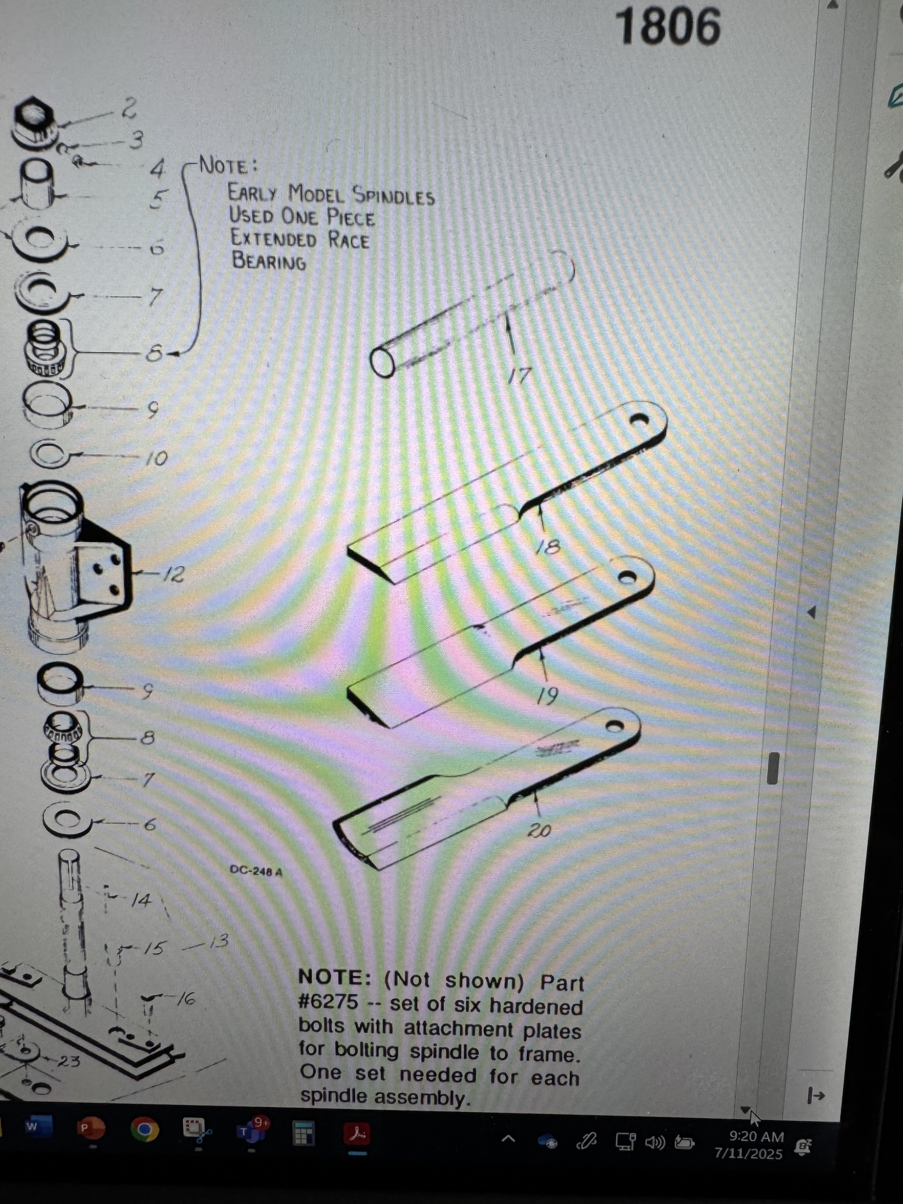

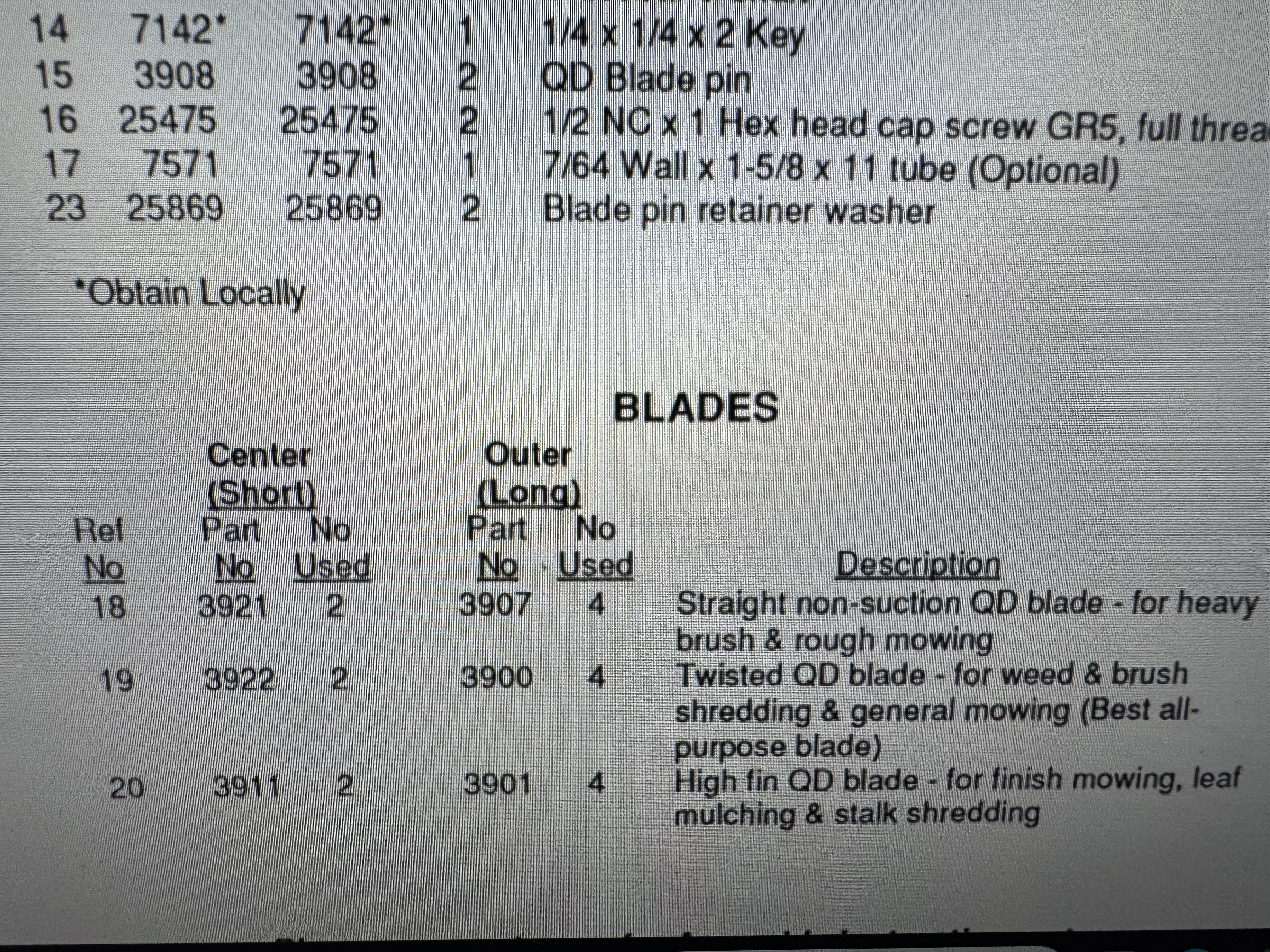

I was wondering about the blades on your cutter which seem to have high-lift ears welded onto them. Did you experiment with different heights/shapes of "ears", and did you do the welding on them?
   / Hybrid Rotary Cutter Proof of Concept #56
Woods makes three types of blades for the C114 straight, twisted and high fin. I have the high fin (lift) blades.
I have thought about adding more to the fin to increase lift.
Would you recommend adding the baffle first or increasing the blade fin/wing?

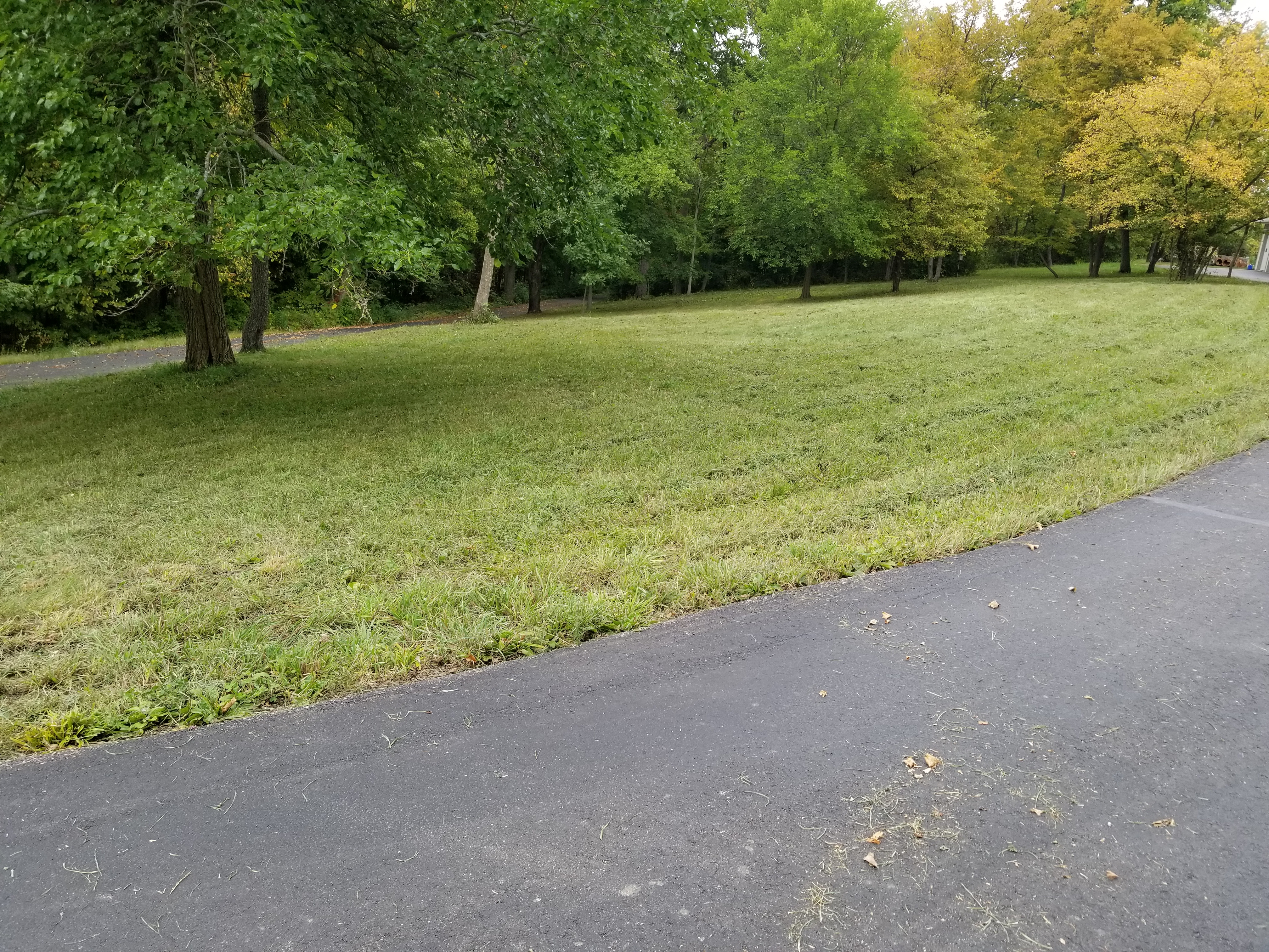

Yes, I had wings welded on. The stock Fred Cain 3' blades I started with were very low lift... just a small 'tip up' for a wing. Initial testing proved the concept very quickly as the tire tracks were back-swept nicely. The forward-sweep region (usually the weakest part of the cut) was pretty bad. As I mentioned before, the front blade was handing off all of its discharge to the rear and completely disturbing the cut as well.
Ring baffles came first. They separated the chambers and got the material flowing efficiently. The rings also add lift. The cut improved but the forward-sweep was still weak (right side of each blade on my CCW mower). The guy I used at Deere is now retired but still welded the wings onto my blades. The cut improved significantly.... a forward-sweep stripe is still present though.
After living with the mower though, there was NO CHANCE of ever going back to the single spindle... I wanted best cutting/safest blade for the long run. I contacted Haven Steel, maker of the Fred Caiin blades (and every other swing blade made) and had them make new blades. They are sized like the Fred Cain blade with a wing profile following our best JD blade... that's what I'm currently running.
In taller grass, a forward-sweep stripe is still there. It is a "hump" shape, not the ragged/uncut stripe my Frontier would produce if you cut full width. It is acceptable to me though. This is 20" cut to 4":
I'm finding that the job goes so much faster now that I'm mowing more often. The look improves as well.
Woods knows what they're doing. With 3 lifts already available, I would assume their high lift would be as good as you could get. I wouldn't weld on them.
First thing I would try is to shift the mower left to put the tire track to the back-sweep of the blade. The mower tongue is probably adjustable to shift the mower position. That would be VERY effective. If not, fab a ring baffle and tack it to the LH chamber. Be mindful of how your mower discharges though: side discharge? Rear? The baffle must allow somewhere for the material to discharge. Hope this helps!
