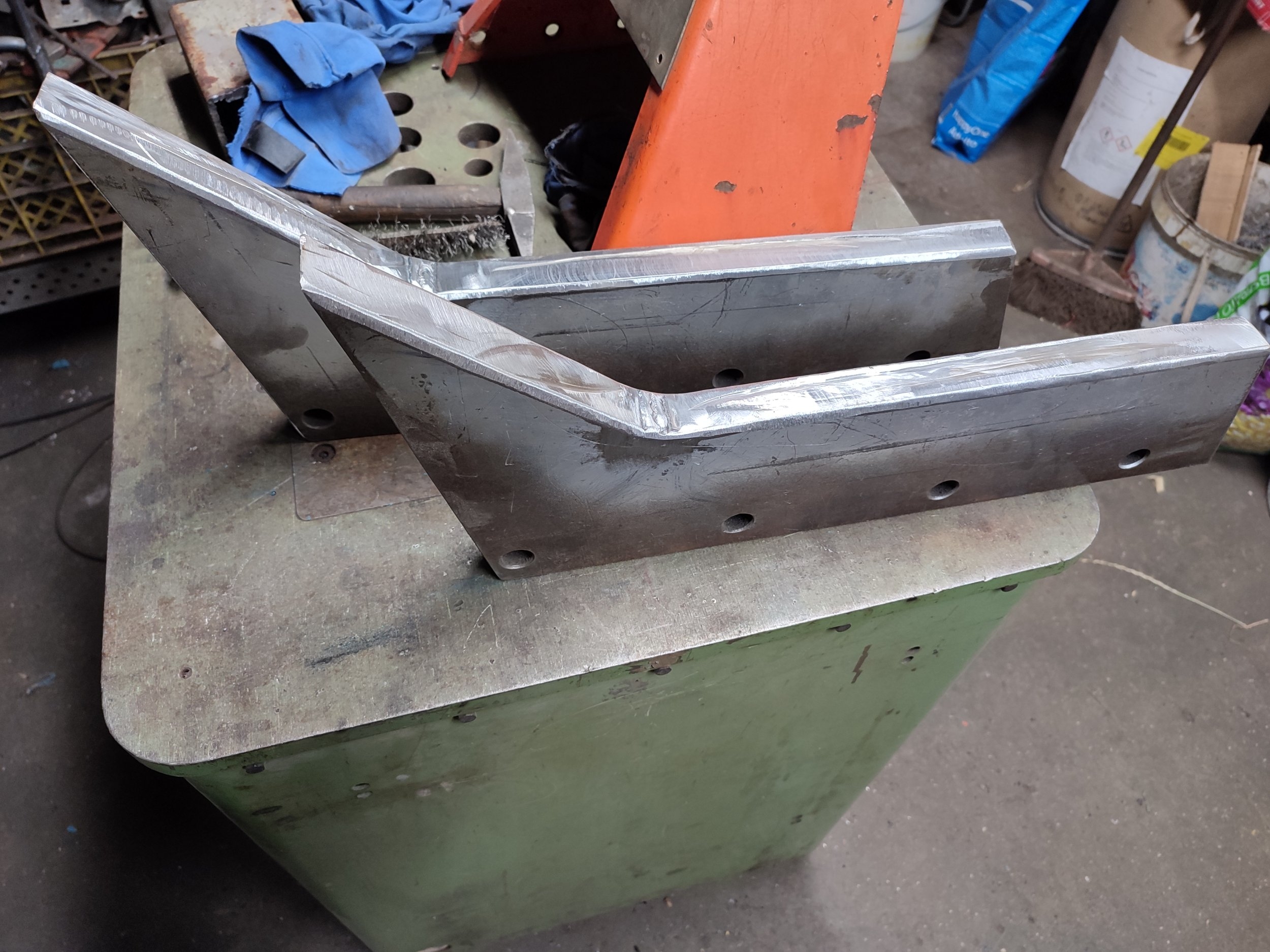

Got some decent progress made today.
Got the rectangular tubing for the main frame cut and capped the ends. Welded the bars where the A frame will bolt on to. Also got both shanks welded on the frame with most of the gussets as well. May add some more gussets yet.
Next, I'll work on the lower pin brackets and possibly a stand for when it's off the tractor.

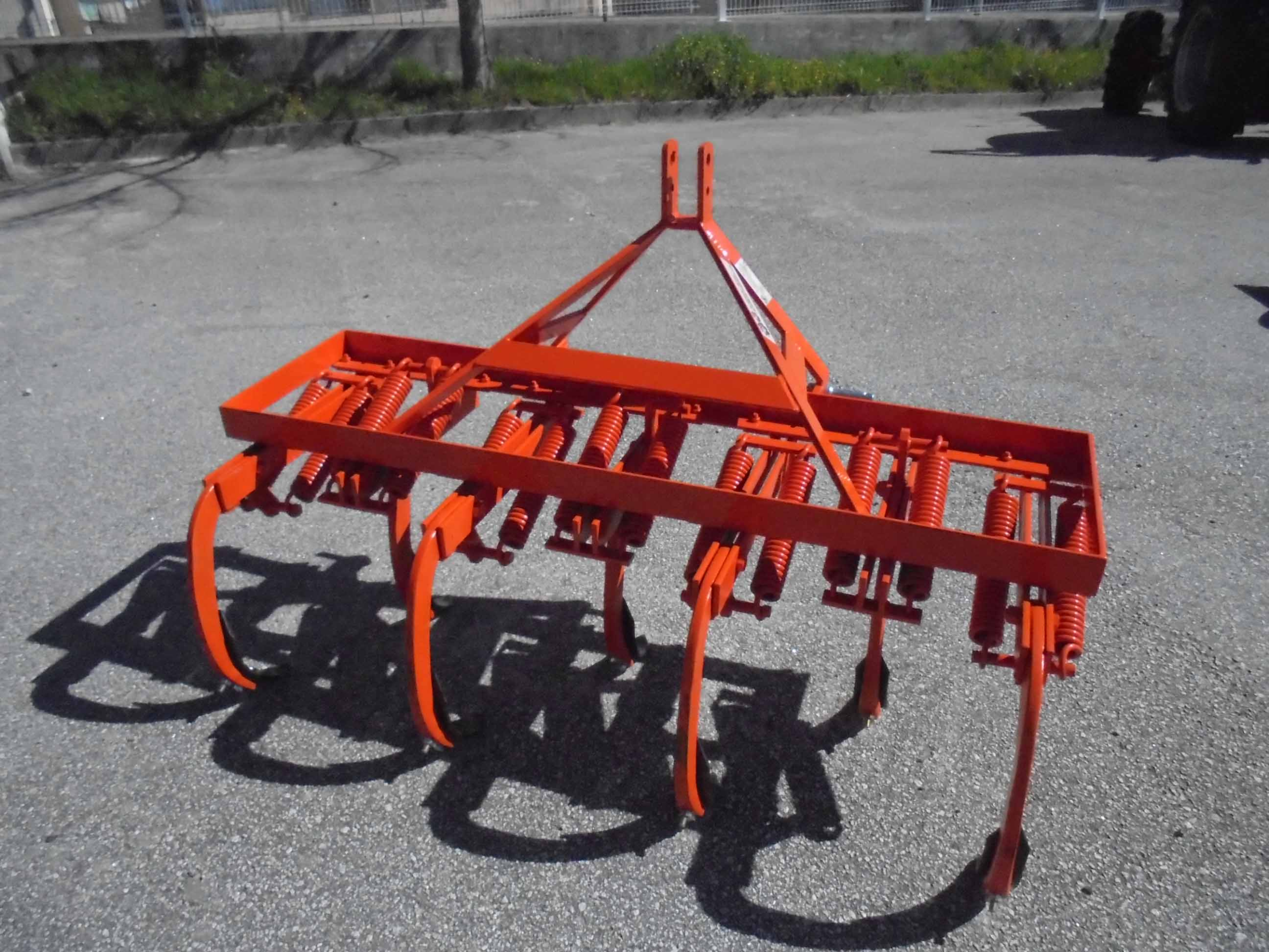

This more or less what I'm trying to achieve.
In this case, it's a Landini 2-55 with 50 HP, same weight and size as mine, pulling a 5 shank ripper about 11" to 13" deep.

That is closer to a chisel plow over here. They typically can go 12” or so. Subsoiler is usually pulled 24” deep or so. These pull much harder because you are normally plowing through the hard pan at that depth. If all you want to do is about 15” then I would think your tractor will pull what you built no problem. Especially with draft control. Look forward to seeing it in action!

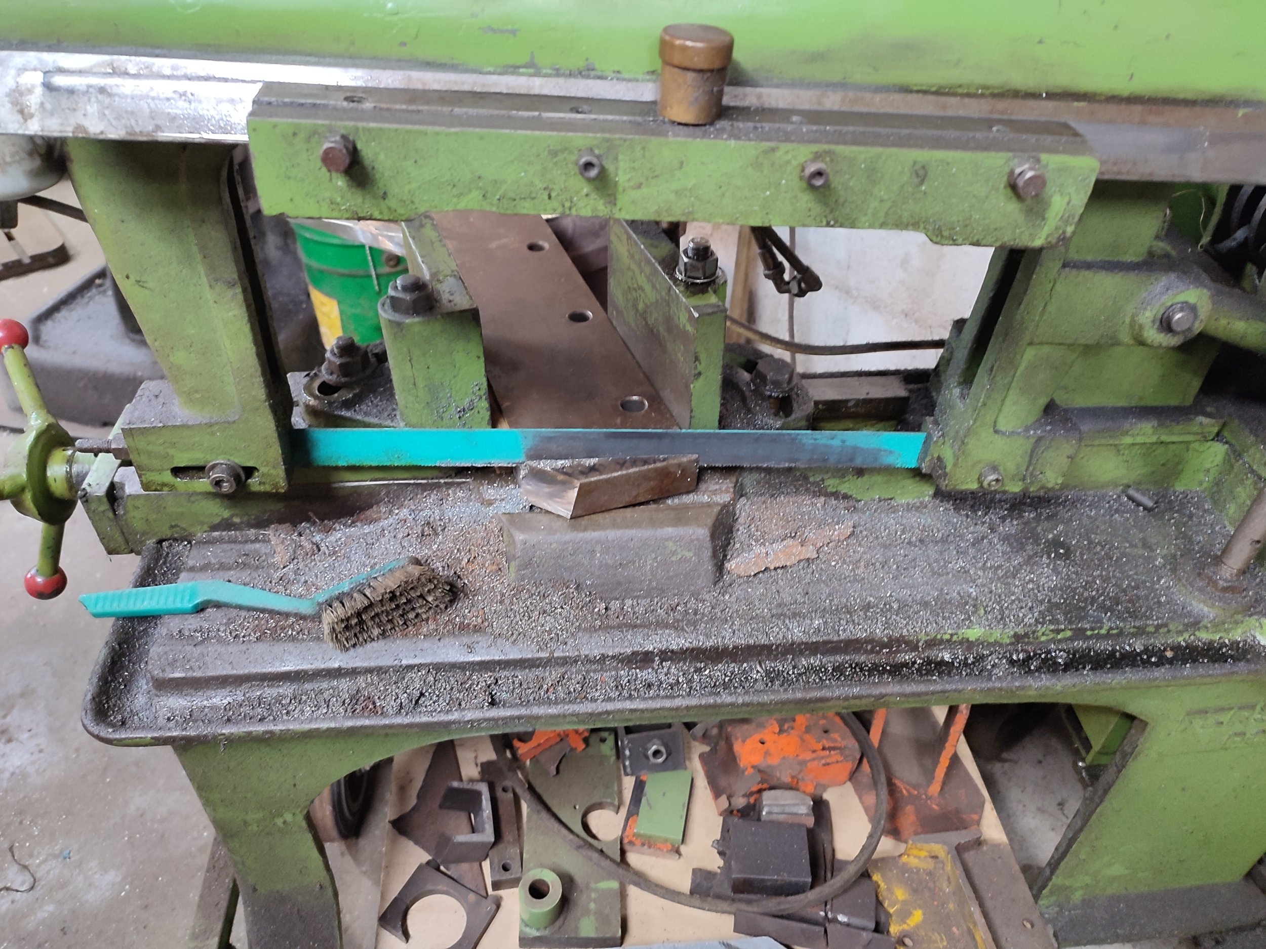

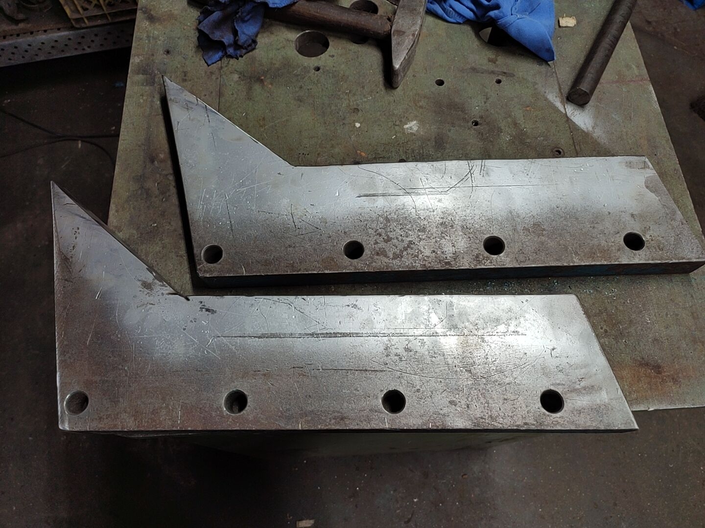

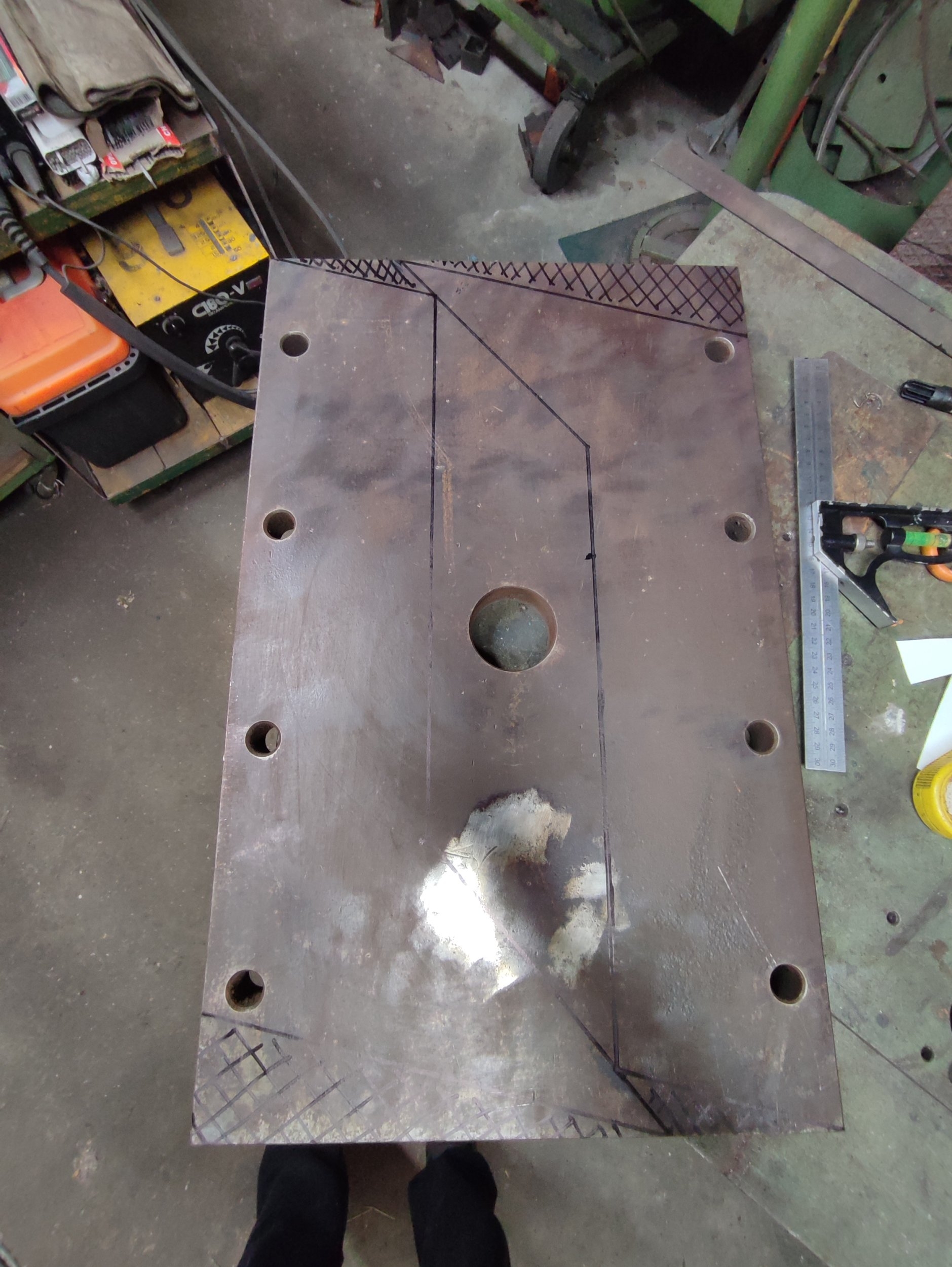

So far I have one shank cut with only one 7" cutting disc. I expect another disc for the bigger cuts on the other shank and for the small pieces, I think I can take care of those on my old power hacksaw.
The ground force is extreme in MI clay. See the picture below.
